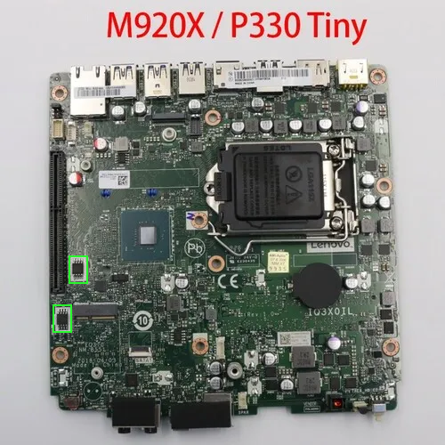

    Hello, I have a Lenovo M920x EQ370 NM-B551 IQ3X0IL Type 10S2 Model S04E00. Turns on but does not give video, this is the bios backup.
    Can someone help me, thanks.​

        you have to read both chipsets

              Thank you very much. Works well. There is another computer with the same problem. Rewriting the bios helped, but the serial numbers remained the same. Could you advise how to change them?

                    you have to merge bios files, 8mb and 16mb then use FIT to clean ME. To find out what ME firmware and what version of FIT you need, use MEAnalyzer.

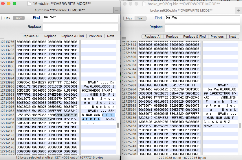

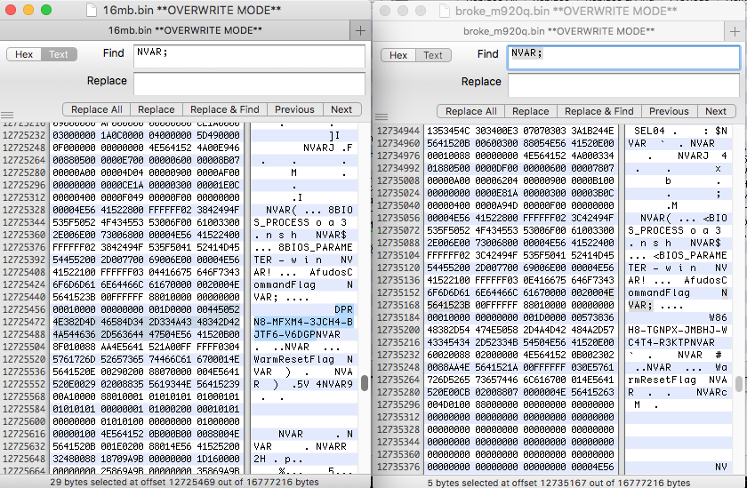

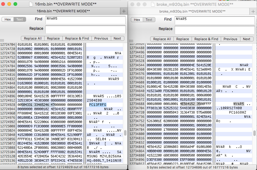

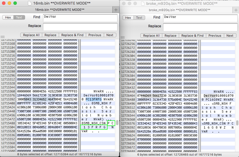

                                  open working 16mb file with hex editor (HxD) and search for text "DmiVar". Do the same with broken 16mb file and replace in working file DMI from broken file. Serial no. is in many places, you'll find it as PC13FRFG or P C 1 3 F R F G. Search also for text "NVAR5", SN is in that place too. Also win key you have to transfer it , search for text "NVAR;" or hex "5641523B"
                                    • 20709
                                    It might be easier to change the serial and model using the bios installer, just change the win key with the hex editor.

                                      If there`s any problems with the MAC address as well i made a TinyHexer script to copy the Gbe area from the old 16MB bios to the new 16MB bios
