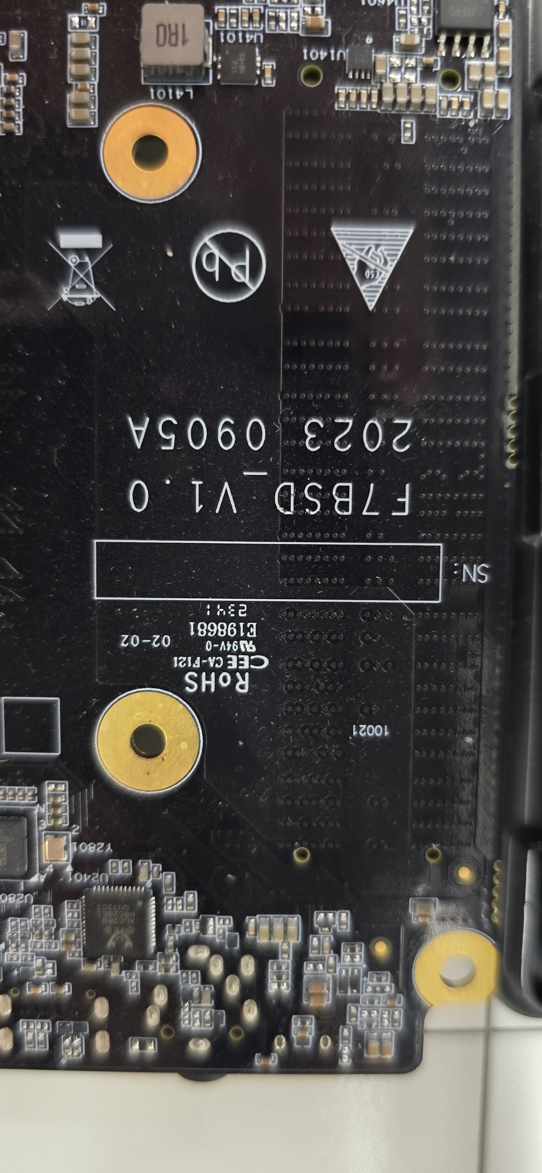

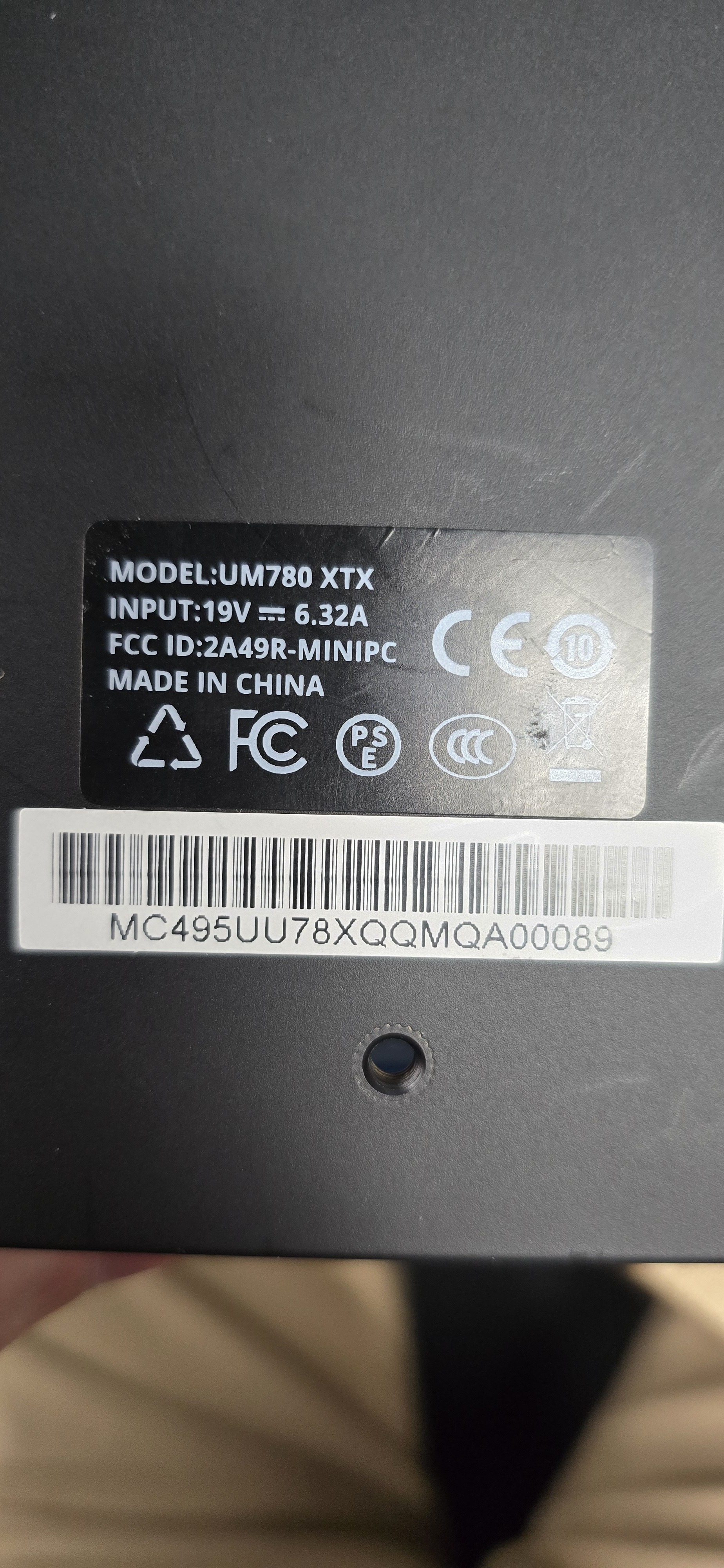

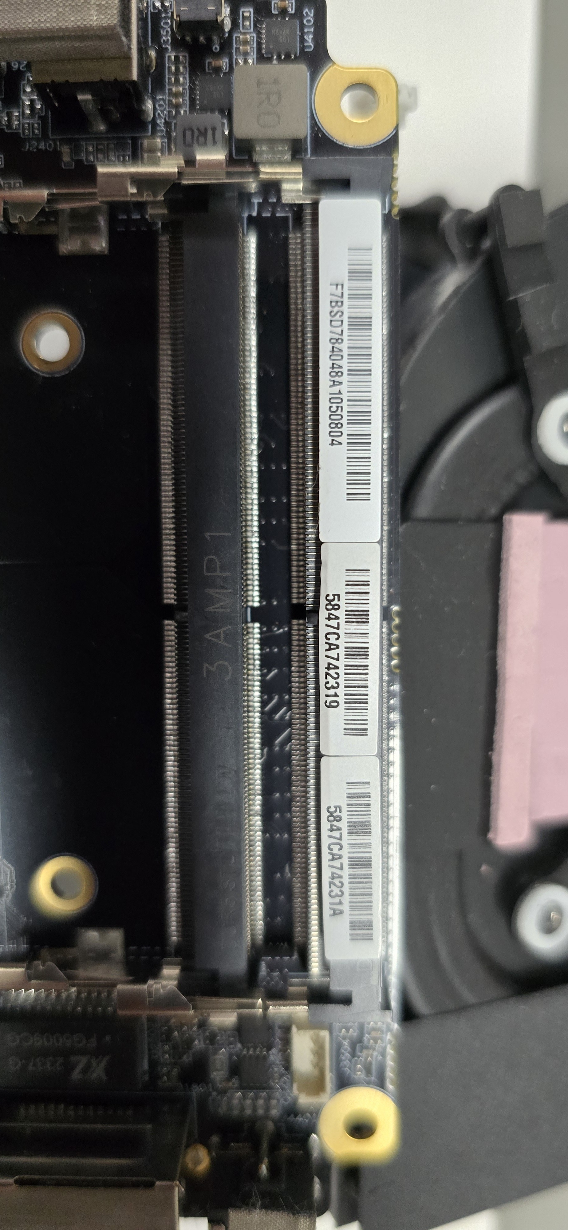

    Hello, Basically a customer tried updating his mini PC using a USB stick but it bricked the computer. I've tried flashing a new chip with a CH318A programmer using neoprogrammer and a ROM file from minisforum's website. From what I have read on the forum here, there isn't a readily available guide on how to serialize an existing bios to the motherboard. I have a dump from the original BIOS chip, I did an additional one and did the fc /b command to make sure no discrepancies were found. The machine model number is Minisforum UM780 XTX, machine serial is MC495UU78XQQMQA0089, Board Serial is F78SD784048A1050804. I have also attatched pictures of the serial number and the board serial. Please let me know if I can provide any additional pictures or information. Thank you.

    i dont know if the dump file is showing up so ill link it here::
