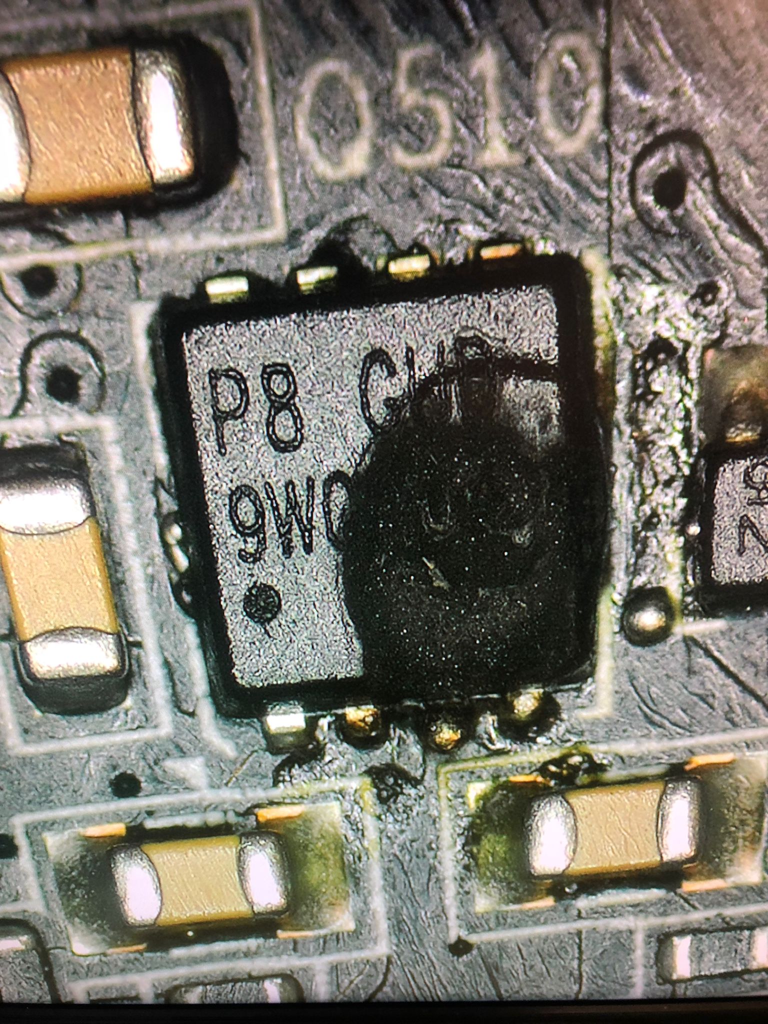

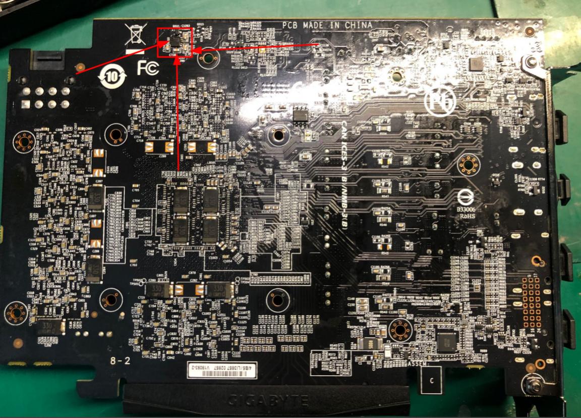

    Hello, I have a gigbyte 1660ti graphics card. The same part is burned in both graphics cards. Does anyone know the code of this part?

    EMF20B02V Should be a good replacement
