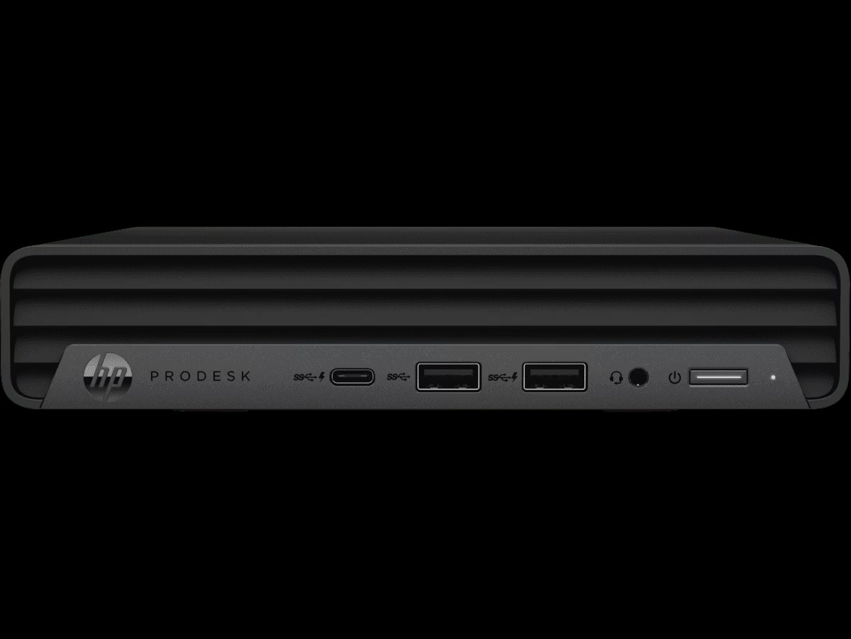

    Hi!
    There is a way to change a BIOS serial number for the computer:
    HP ProDesk 400 G6 Mini PC ?
    Thank you

    try with WNDMIFIT. https://www.badcaps.net/forum/showthread.php?t=69204

      Hi!
      Thank you for your answer.
      I try use the version 2.13, but dont work, the message error is: "This system board is not suported. Will not be able to set BIOS settings".
      There is a new DMI Tool version after 2.13 version?
      Thank you

        Re: Change BIOS serial number for HP ProDesk 400 G6 Mini PC
        I found version 2.14, but the problam is the same. I try use the "BiosConfigUtility64.exe" with /get and /set parameters. If I try change the serial number inside generated file, they show the message: "Serial number is read-only", and not allow change.

          another way is to put motherboard in MPM mode but you have to read your bios and write it with a programmer.

            And how can I put motherboard in MPM mode ?

              maybe this will help you..
              https://www.youtube.com/watch?v=9T57ktw8n3Y
                I try the steps from video and wont work :-(
                The message error is: "MPM access denied"

                  TRY
                  https://ftp.ext.hp.com/pub/caps-soft...it/HP_BCU.html

                    Hi! Dont work too, the same result: Access denied.
