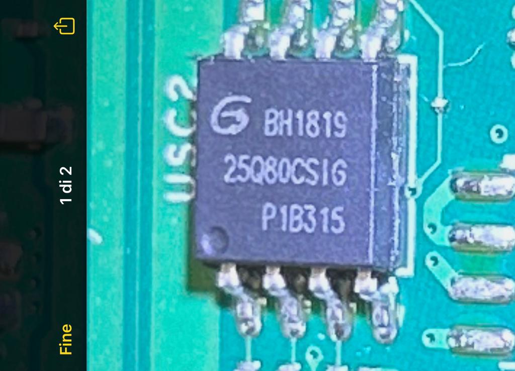

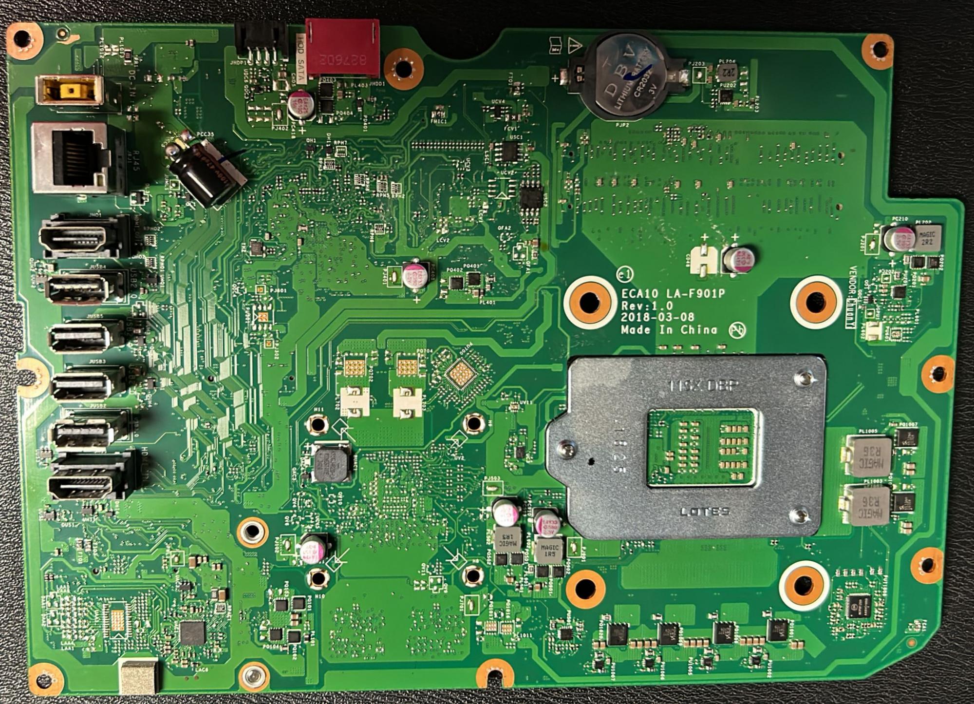

    good morning, I have rediscovered this problem,
    on this lenovo Lenovo v530-22icb
    ECA10 LA-F901P
    Rev:1.0 motherboard
    2018-03-08.
    the bios chip is g25q80c, i attach the photo (datasheet file 8mb), the file found on the lenovo web in the support is 16mb, therefore it can never be written in one of 8mb (25q80), does anyone have a correct file for this model?
    Thank you

    That isn`t the bios chip,its somewhere else.
    The GD25q80C is 8M-bit = 1MB = 1024K-Bytes. Datasheet: https://cdn.badcaps-static.com/pdfs/...2a6a33f84f.pdf

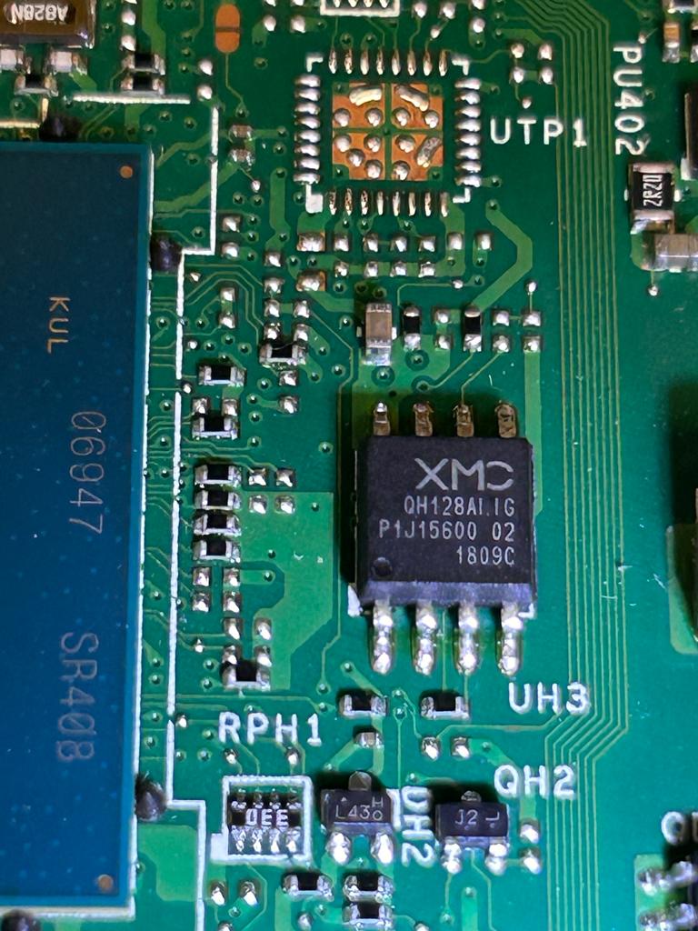

      Re: Lenovo v530-22icb ECA10 LA-F901P bios
      is this the bios?
      • hardware1
        • Sep 2021
        • 2948
        • N/A
        Originally posted by topline
        is this the bios?
        Yes, it's the right one, its size is (16MB). Take a good Backup from that chip (2 times or more) before flash it with another BIOS file.

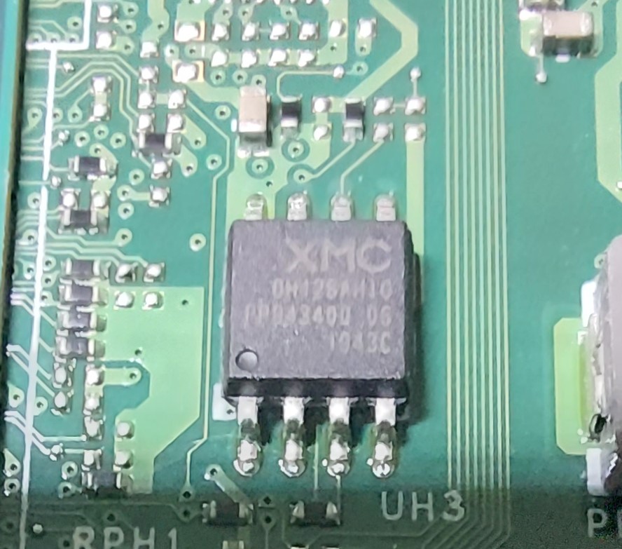

                                        • to5it0
                                          Need Clean BIOS/EC Bin File for Lenovo ThinkPad Yoga 11e 2H1703-27220F Rev. A Marked as U2501 on the motherboard.
                                          by to5it0
                                          Need Clean BIOS/EC Bin File for Lenovo ThinkPad Yoga 11e - Stuck with 0275 Error CMS
                                          I am attempting a repair on a Lenovo ThinkPad Yoga 11e that is currently stuck at boot with the error: "0275 error CMS" even after setup new bios battery and will not allow me to enter the BIOS/Setup.
                                          This is a critical issue that I believe requires flashing the BIOS chip directly using a programmer (e.g., CH341A/RT809H), as standard software updates or resets are not possible.
                                          I have opened the laptop and identified the main BIOS chip...
