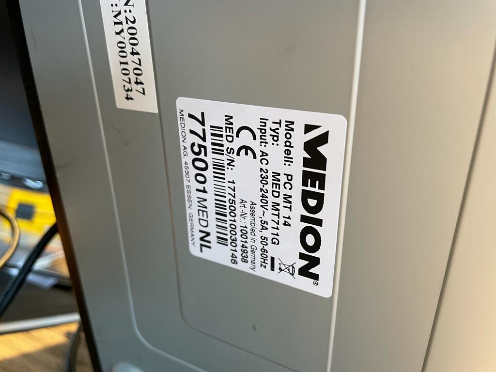

        The Model number is PC MT 14
        I have added a picture with the full details

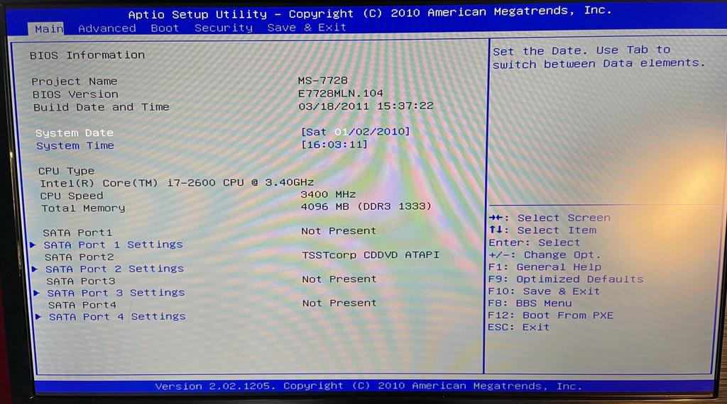

                    Today i have flashed the 4MB bios file to the version 1 mainboard
                    but no luck the welcome screen is freezing and there is no way to enter the BIOS settings.
                    we are 100% sure that the mainboard is good
                    because the owner update the bios with the bios upgrade from the Medion site
                    for the version 2 mainboard so the old data is lost when upgrading....
                    • mapino
                      • Feb 2023
                      • 7
                      • Nederland
                      Re: Bios Dump request MS-7728 V1.0 MBoard
                      !! Update !!
                      got it working let me explain how i did it
                      I combined 2 Bin files worx+backup file 2MB witch i found on the harddrive on the pc where the updathad gone wrong
                      i copied the contens of the backup file in the Worx file on addres 00200000 to the end ran the checksum and flash it back on the Chip
                      and the MS7728 version 1 booted
                      as you can see on the picture the version is different its E7728MLN.104
                      now i need a newer version... for upgrading
