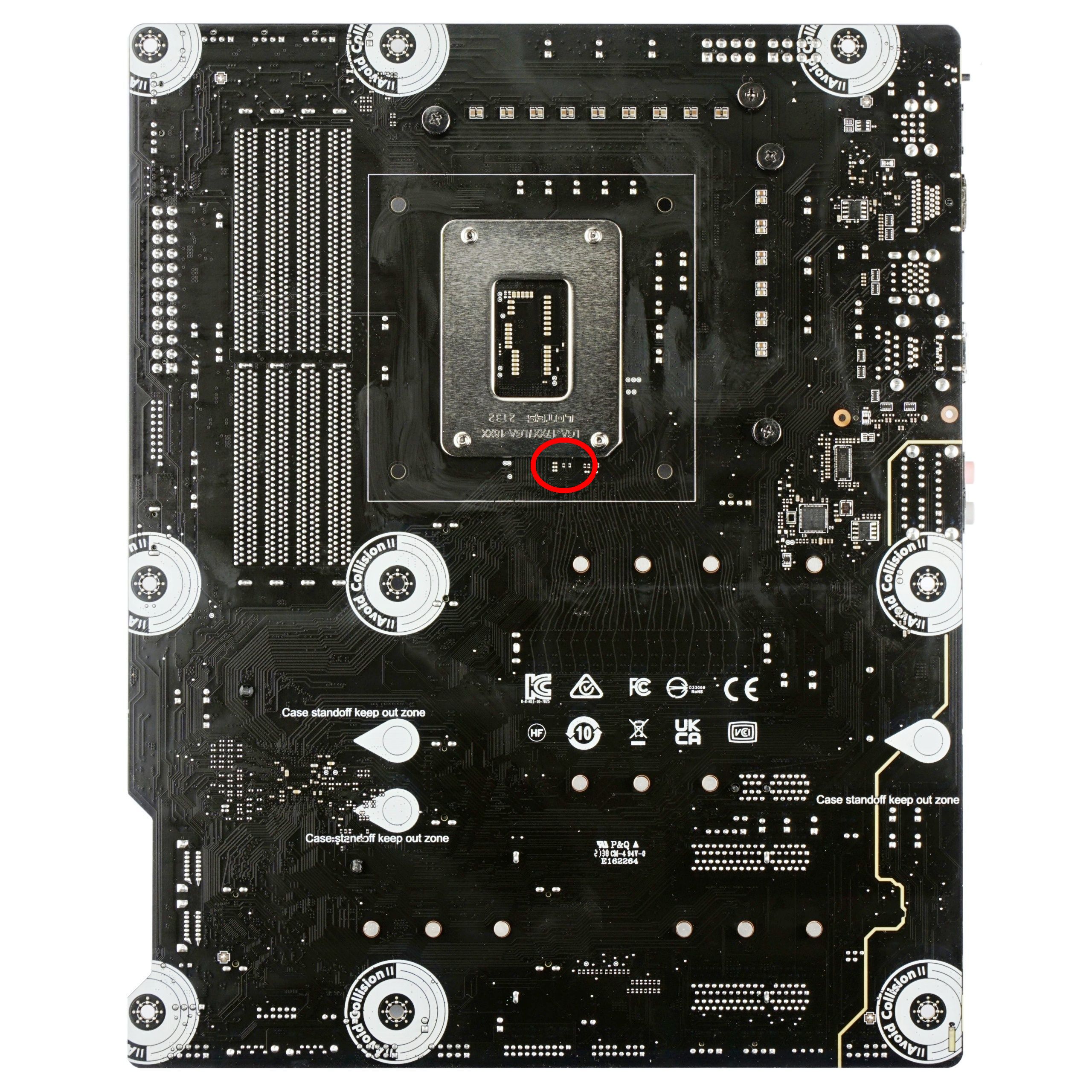

    Looking for a boardview/schematics for MSI Z690-A PRO (MS-7D25) - would appreciate if somebody could post.
    Alternatively if someone could kindly measure the two missing components on this first image below (probably resistors):
    Second image for orientation on the place on the board:

    Re: boardview/schematics for MSI Z690-A PRO (MS-7D25)
    Have determined the components by buying a second broken board. It came out that beside the missing components on the frist board both boards have broken Z690 chipsets, so seems these boards are some kind of chipset killers or just these Intel chipsets are some kind of crap produced by Intel. Have got now new chipsets from Ali, will try to replace them. But funny is, that at least the first board the chipset in broken only partially, as it generates correctly SLP_S3#, but hangs then later on communication with CPU, and CPU VCORE is not initiated at all.
