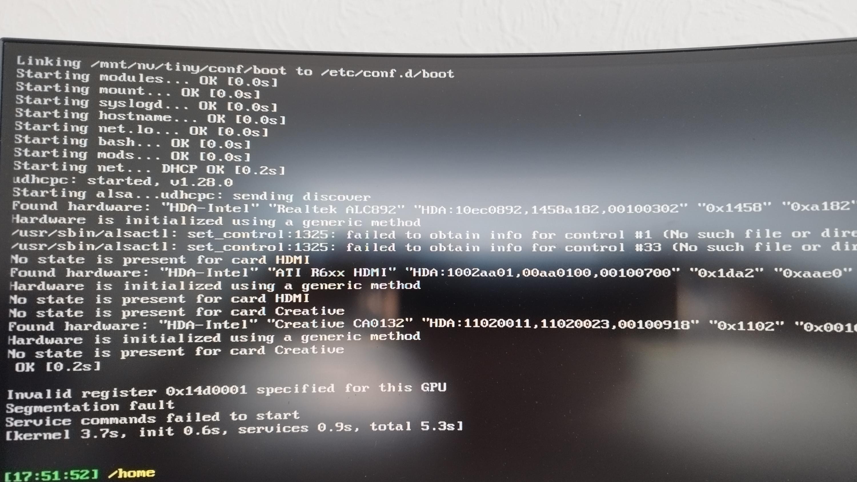

    Hello
    I have a sapphire RX 560 OC in 4Go which gives me artifacts everywhere and makes a white screen.
    Attempting to update the bios always the same
    I was able to try the MATS software that many of us use.
    Indeed, I have an error like on the pictures, the test does not work.
    It seems not to read the GPU
    Do you have an idea or other software?
    Thanks a lot

    Re: Artefact RX 560 Sapphire memory test attempt fails?
    I have the message invalid register 0x14D0001 specified for this GPU
    What does it mean?
      mats is only for nvidia.
      find "lord of gpu"
        Use TServer for all AMD cards.
          artifacts everywhere its a vram issue.you can try to reball vram chips.
