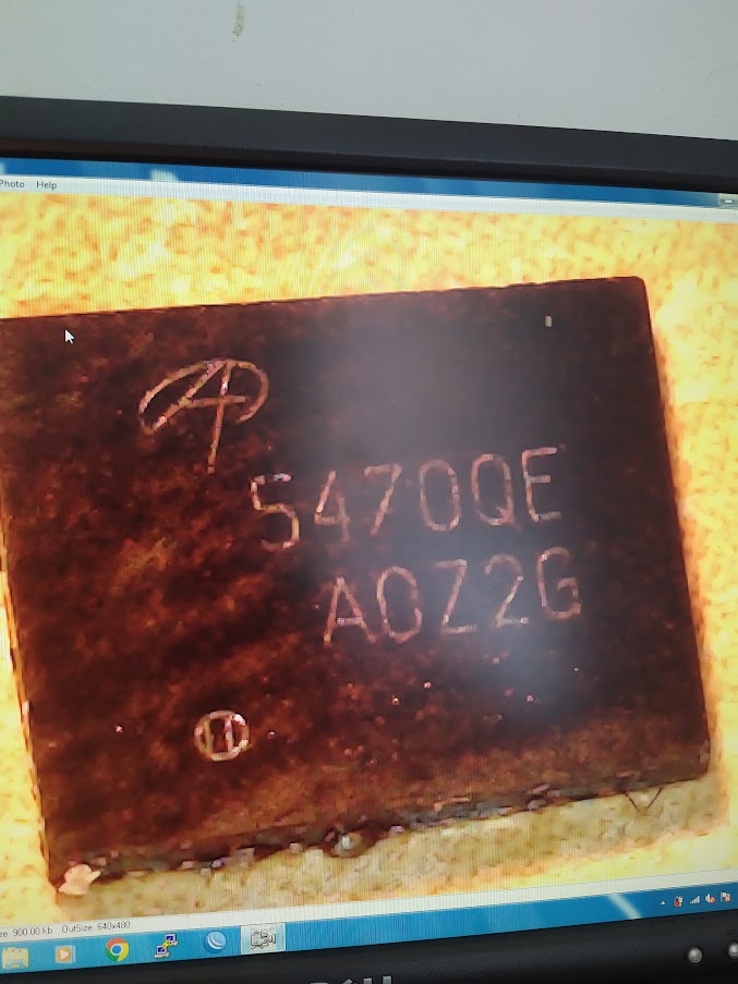

    MSI RX6900XT MS-395 r5 - i fcked up - when measuring i shorted TOUT/FLT with BOOT on DRMOS. now i dont have main VGPU
    what can be bad? did i burn XDPE132G5D ?

    god bless AMD for fusing everything. i find that my short blown one of OptiMOS and 20A fuse. after MANY usoldered/soldered capacitors and coils and three hours of work my mistake is repaired.
    But this OptiMOS i cannot find to buy. I have this AON5470 with same layout from RX6800. Have anybody datasheet for it to check if have enought current to use it?

        The 5470qe is probably a custom chip, no datasheet/public offer available, only solution is buy another broken card and use it as donor. You can try to write to Alpha&Omega, but wouldn't expect a helpful response. Remember that MOS devices can change and hold some time state during measuring from non-conducting to conducting and vice versa only due to the applied measuring voltage (gate must be included, state depends on polarity applied to gate), so sometimes it's possible to measure completely different values, and this must not mean, that the device is broken.

          guys anybody know where can buy this TDA21490 ? Best from ali or ebay

              i canot find this chip anywhere. who kows where i find this TDA21490
              or i find simillar HIGH CURRENT ic ISL99390
              have somebody datasheet with pinout to compare these two?

                Hi, my RX 6800 is shorted. I have to find 5470QE. Unfortunately, none is selling it. How did you find it? Is TDA21490 proper and equivalent?
