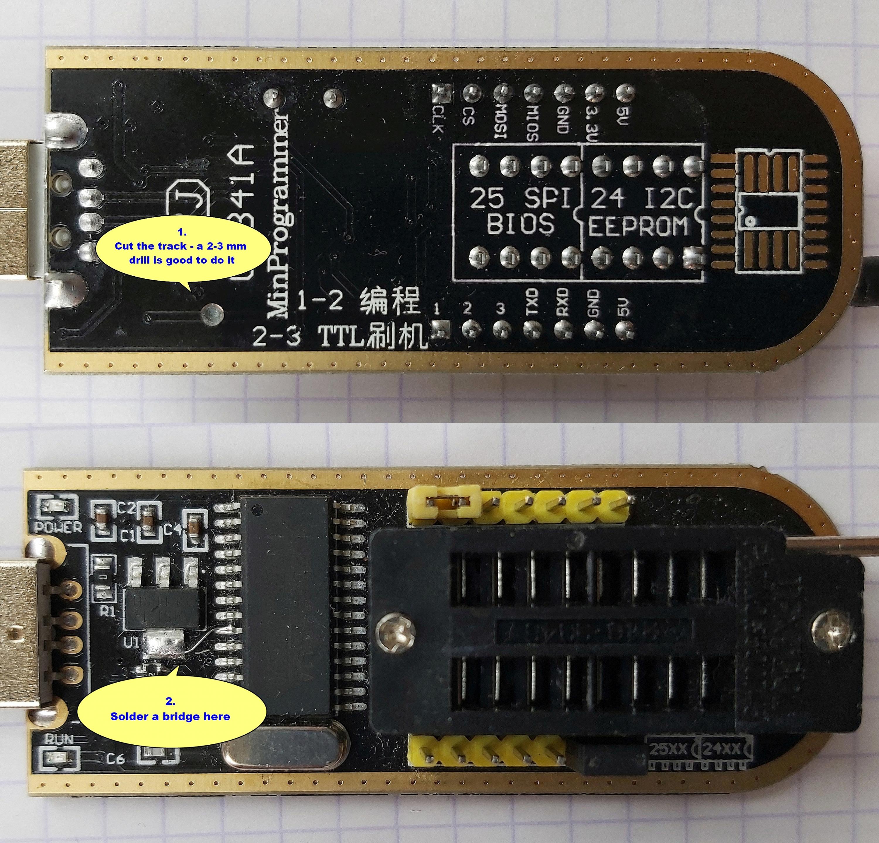

                Which programmer do you use ? If you use CH341 it has a design flaw and can destroy the 1.8V bios chips. It is good for motherboard bios chips (3,3V), but not for graphic card bios chips. It's hardware needs to be modified in terms of the voltage which is applied to the bios chip during programming/reading. There are some instructions how to do this in the net, if you don't find I can post a picture of my modified device.
                  its a CH341APro not sure if this model has the flaw I will take a look, Thanks for the info.
                  checked with meter and sure enough 5v out on pin 1 -_- i'll look for the guide to correct this issue, much helpful.

                    The instruction to modify the CH341 I found once on the net is not very clear, so I made a new one here, its to be done in a few minutes:
                    However what I observed is that after this change the in-circuit reading/programming of bios chips of motherboards does not work any more, so maybe it would make sense to make this with a switch to preserve this functionality.

                      • 21848
                      Re: MSI RTX2070 code 43
                      Using a CH341A with a powered USB hub can help.
