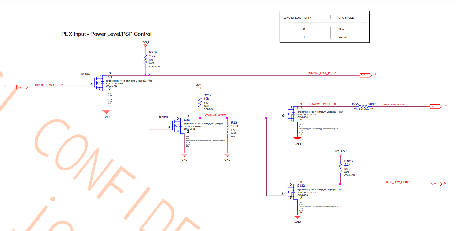

    Need help with zotac 1070 mini
    Not recognizing the 8 pin power adapter.
    Iv received this card with a cracked Cristal
    And missing ram and mosfets/ bios chip.
    I had a nother card with a crack in the pcb but good Cristal and chips.
    I replaced all chips and Cristal
    All my voltiges are there.
    The card will post with an error that it's not detecting the power adapter.
    I installed new bios chip an flashed it with the 3 bios files I found.
    Still the same thing.
    Theres no blown fuses and the power from the 8 pin goes to this chip ina3221
    I have checked this ina3221 power ic
    Pin 1-12v
    2-12v
    3--0v
    4-3.3v
    5-0v
    6-3.3
    7-3.3b
    8-380mv
    9-3.2v
    10-3.3v
    11-12v
    12-12v
    13-650
    14-12v
    15-12v
    16-3.2v
    Iv spent hours trying to solve this problem.
    I'm at a dead end.
    Can any one here help me track down this problem?
    I would really appreciate it.

    This is something to do with the sense pin in the 8 pin connector, look at some similar schematics, you are using an 8 pin power connector right, it won't work with a 6 pin one?

          Re: Zotac gtx 1070 mini Not detecting 12v 8 pin
          Iv tried 3 other motherboards no luck.
          I shortedot theses pins one at a time
          1 -2 11-12 14-15 and no change.
          Im looking at the sense components but I have nothing to reference from.
          Iv chased it back to pin 4 VS on the 3221 chip.
          I'm still confused on how this works as I can not
          Read any voltage coming from the sense
          Pin.

            Hi, this means that INA3221 is almost sure not the problem. INA3221 does monitor 3 voltages and 3 currents. The current is sensed on a shunt resistors, one for each pin pair. The voltage is sensed same time at one of the pin of the pin pairs. You will probably not measure any significant voltage difference between these pin pairs, as the shunt resistors have very low resistance, eg. 0.05 ohms, and the voltage difference between the pin pairs is somewhere in low mV range, if not uV. The shunt resistors usually are quite big, flat smd components, ca 4 x 8 mm, easy to find.
            I would look deeper into the PSU presence logic, my guess would be there is something wrong with it. I had once such a case with a similar card, but I do not remember exactly what was ther reason, and if I manage to solve this. I will look if I have some records done for this case during the weekend, as I have to review some 50 repair protocols.
              Thanks for getting back to me!
              Iv changed ot the shunt resistors still with same problem.
              Iv been looking at the- power level psi control-on a gtx 1080 scamatics as I can find anything for this card.
              I'm still trying understand how it senses the 8 pin power conector.
              Iv chased through the logics on this but seems to stand out.
              I appreciate all the help!

                As far as I remember it's just one line in the 12V connector which is normally high, and if PSU is connected, it is just shorted to ground via the PSU cable inside the PSU.

                  Here you can see an example card which is same family of GPU, see page 41, signal name is INPUT_PEX8_DT1. The asterisk means Active Low. You can search this signal in the schematics, and see where all it goes to, I suspect finally it goes after some logic also to the GPU, so if not activated GPU can think there is no 12V power connected.
                  Maybe in this case it would be worth to compare both cards arround the 12V logic so deep you can trace it, voltages with powered cards, resistances non powerded. Even if the other card is missing some components, you might have luck and this part of logic will still work on both cards. Its some blind travel, but w/o at least a boardview there os no other choice.
