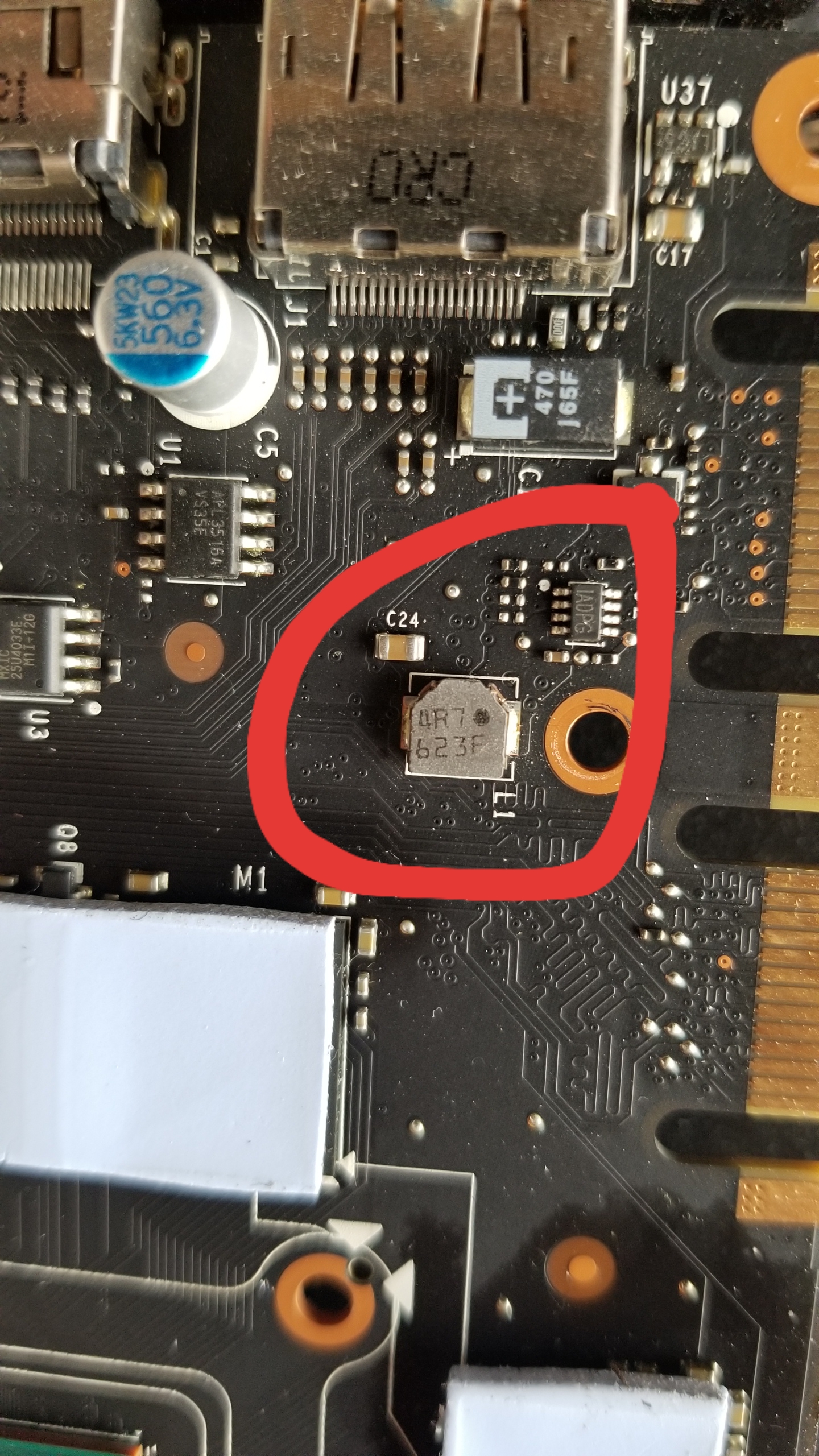

            The one with 5v on
            Me neither, probably one of those coils on the back of the card.

              Re: MSI aero GTX 1070 voltage gone after a while
              Oh please ......
              There are no coils with 5 volt. So prolly it is linear regulator, the catch is I only have around 20 secs window before it shuts down. Like playing cat and mouse

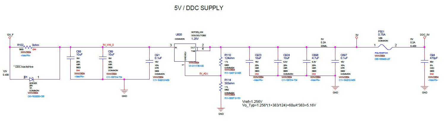

                Maybe this helps?

                  I was wrong the chip which generates 5v is mp1475
                    I tested this on egpu box. That 5volt chip shuts down because after a while 3.3 volt supply is killed, which feeds to it's EN signal,
                    3.3v rail is supplied from PCIe pin.
                    Egpu box works normally, confirmed with other GPU, flawless
                    Oscillator beside GPU chip works fine, confirmed using scope
