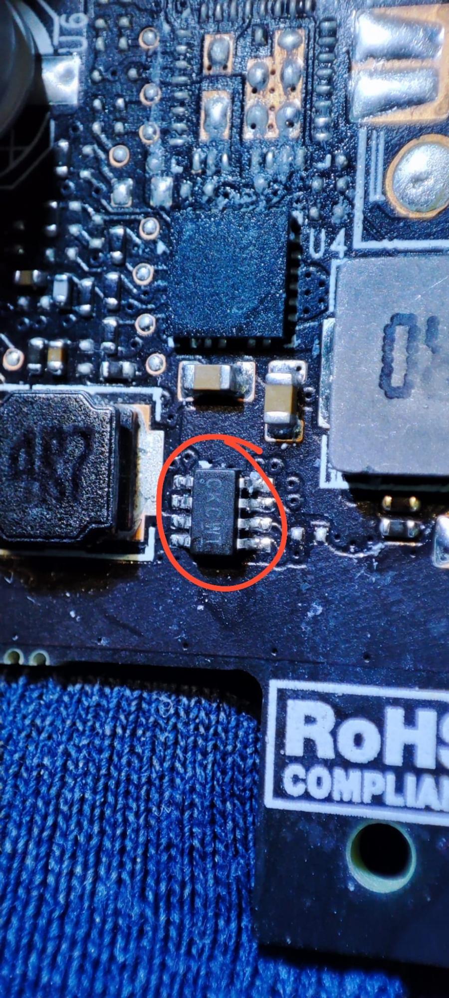

Hello , I have this 3060 EVGA card that doesn`t work . Measured for shorts and resistance , seems ok . Powered it up but doesn`t work , GPU chip is cold . Though this part circled in red is getting very hot and pretty fast so I suspect this is the reason . Can somebody help me discover what this part is . Maybe a data sheet or a similar part ? Thanks

do you have a boardview or schematics for this card ? I got no voltage on most rails unfortunately and I don`t know ehere to look .the only thing that I can notice is that that part is getting really hot and I presume that is the main factorComment

Yes 5V is usually the first rail to come up, so if you don't have that...I looked at this one from dicky96's discord serverAttached Filesif you find these attachements useful please consider making a small donation to the site

actually it is a very low resistance on the coil near the hot chip - like a short - maybe it is a short somewhere and I cannot trace it (been measuring fuses and all seem good though)Comment

Well ideally you would inject something like 0.8v@3a on this coil and see what gets hot, but you'd need a lab type power supply for that. This could just be a shorted capacitor, which you maybe able to spot on close inspection.Comment

Luckily I have oneComment

The same voltage regulator got hot around 3,5a on 0,9vComment

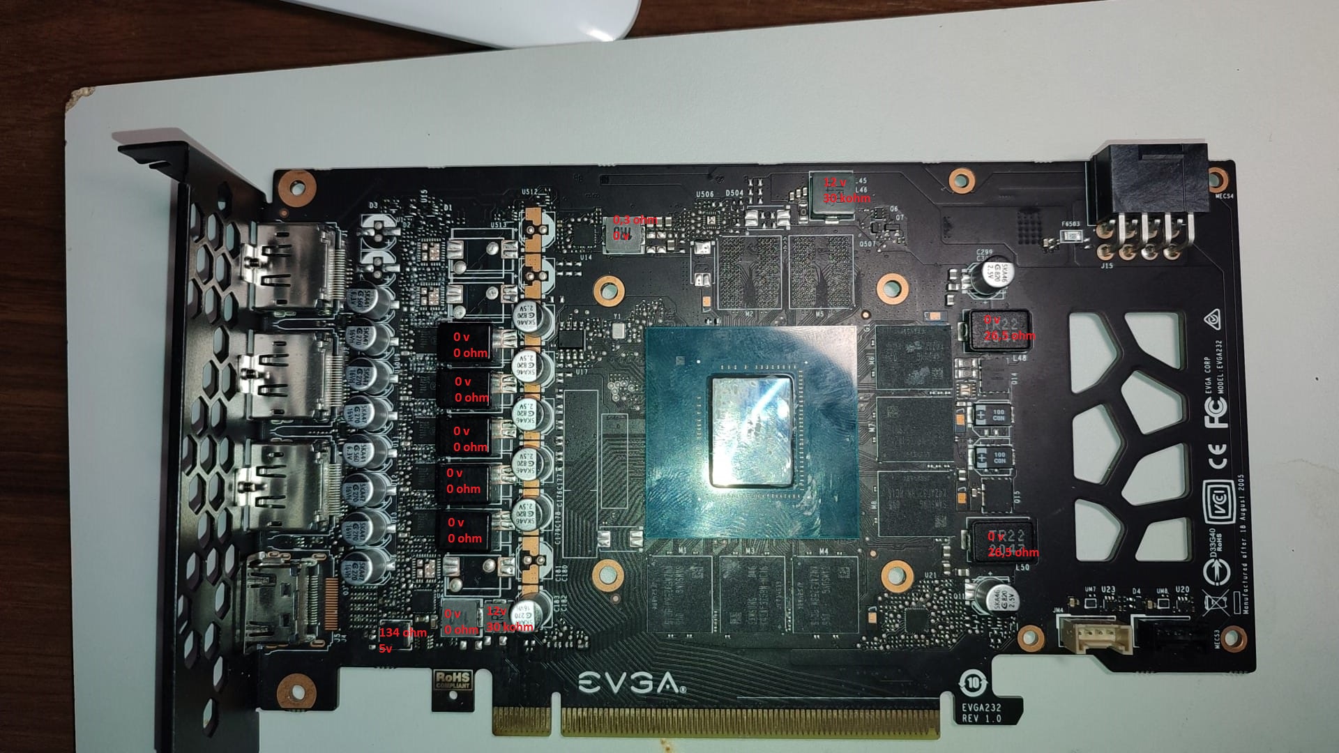

Changed that little part but still nothing . I am blocked here with nowhere to go . This is what I got on multimeterAttached Filesif you find these attachements useful please consider making a small donation to the site

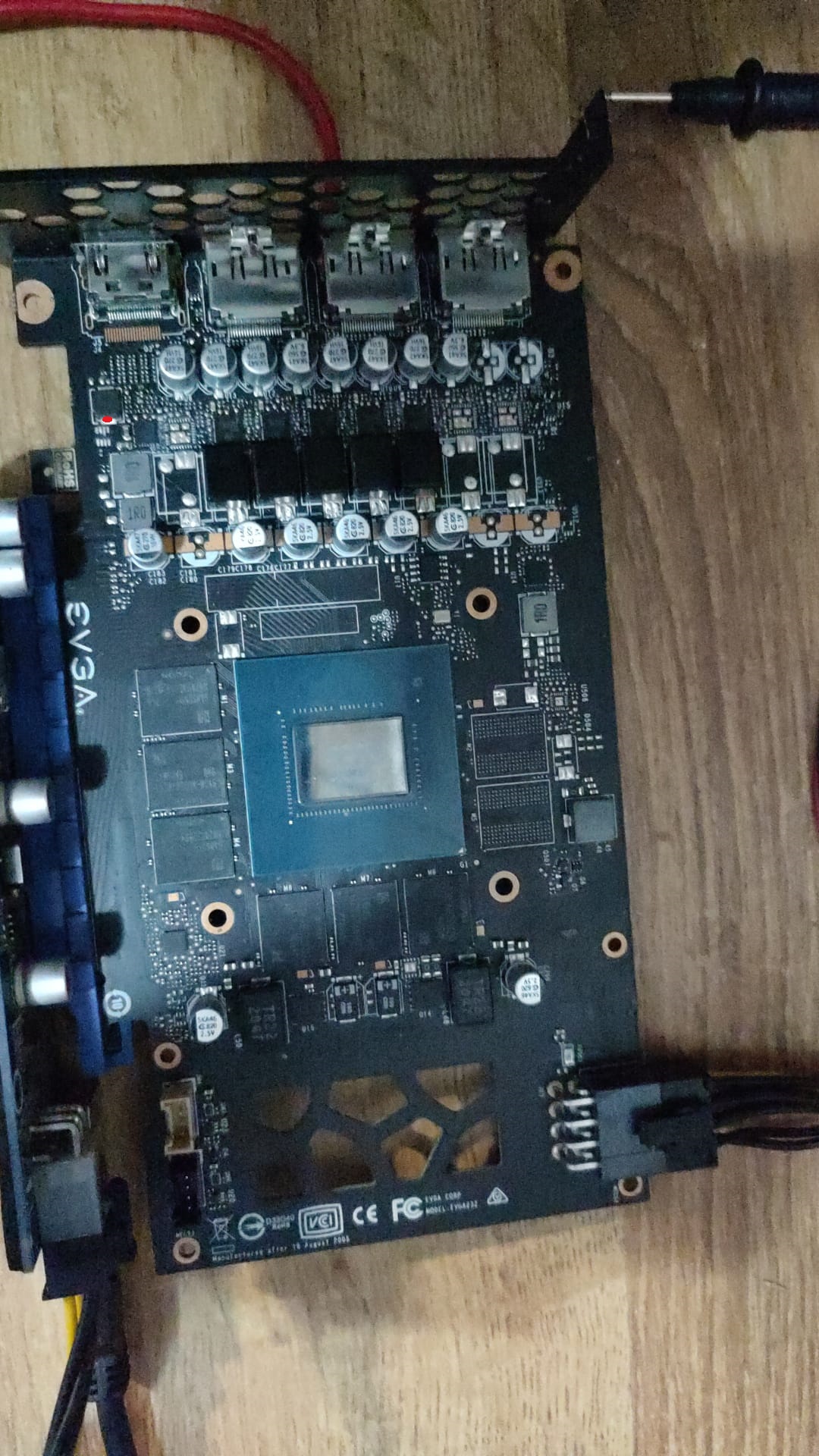

Another fact that I have discovered . All the pair lanes from the front of the card pcie measured in diode mode gives me the result 0 . I fear that the GPU chip is gone . If anybody knows better please tell me if it`s wrong or rightComment

i have exactly the same issue... i find that MP1475DJ doesnt get the Enable Voltaje, and the UP9516 #PART U14 "PEX SWITCHER" The same hasnt enable voltaje....
i have order the 2 ICS and will change it.... i will publish my result asapComment

I sent it to a friend in Slovenia who masters the GPU repair and he said that the GPU chip is bad , sadly...Comment
