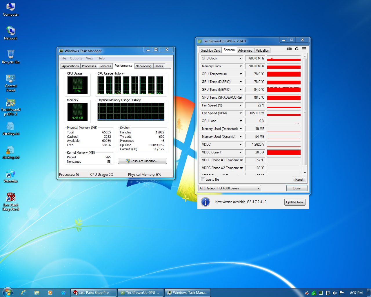

    I've never seen a GPU run this hot and still be functioning (this post created from it)!! It's not artifacting or any other noticeable malfunctions within Windows, and Windows is at idle....nothing going on. I tried it in 2 machines, same result. It's exhaust vents & bottom side of heatsink bracket are so hot you can't touch; it will burn you!! WTF is wrong with this thing?!?
    Scary high temps and pulling 28 AMPS! ...and ZERO GPU load! It's not even ramping up fan speeds.....not that it would help much; it shouldn't be this hot.

    Yup, that's a proper Radeon HD4870 (or 4890) for ya - always running hot enough to burn you. FWIW, the HD4850 (based on th same GPU chip, but ran at lower V_core voltage and frequency) also got equally hot with their single-slot coolers.
    ... but that's under load. Idle, it should be running 50-55C or maybe 60C if the case/room is really hot (which I don't think is the case with your setup.)
    With that being said, did you check the thermal compound under the heatsink?
    ATI actually used some pretty good quality stuff that didn't pump out / run away and didn't dry out too much over time. So I suspect the thermal compound is OK. Still, you may want to check, just in case. If OK, don't repaste - just smudge back some of the old compound from the edges of the GPU die back onto the die, if the compound is nice and moist still. Otherwise, if it isn't, then just add a tiny bit of AS5 onto the old compound.
    Also, try running the card in a computer with Windows XP and install the latest XP drivers from ATI (the drivers only - skip installing Control Center) to see if that changes anything. If not, I suspect something may be wrong with the VRM or perhaps someone did a volt mod for the V_core? Check voltage going to the GPU with a multimeter and see if it agrees more or less with what GPU-Z is reporting. Stock max V_core for HD4870 should indeed be around 1.25-1.27V or thereabouts.

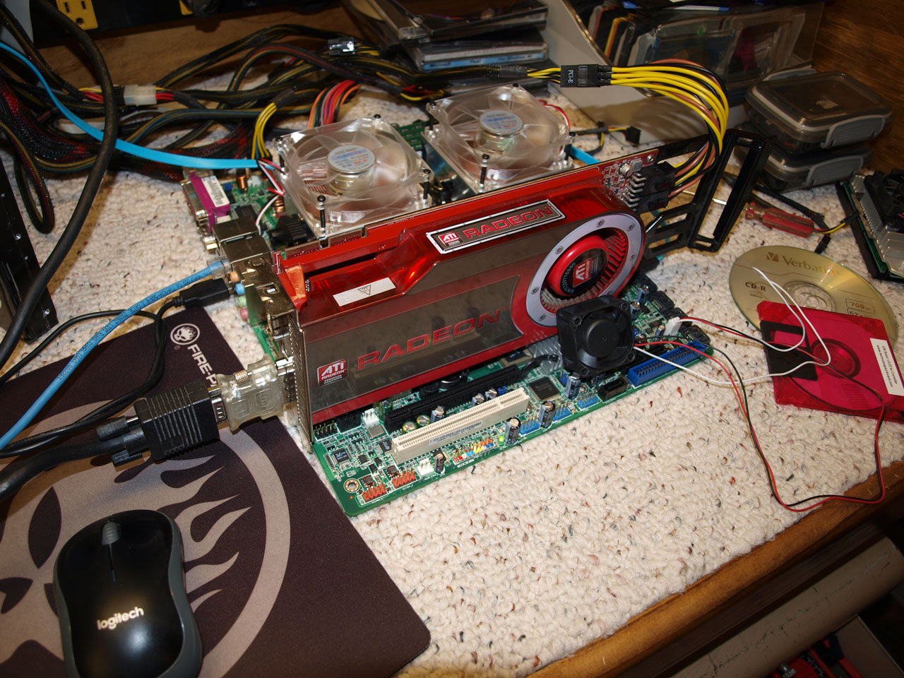

    It's also strange that the fan is not cranking up. I did a test on an HD4850, where I wired the V_core feedback to an external pot and started playing with the voltages. As I neared and went over 1.280-1.30V, the card's fan got really angry with me, lol, and started revving very high as I cranked up the voltage. On that note, backup the current card's BIOS with GPU-Z and compare it with Radeon Bios Editor (RBE) to the stock BIOS of a reference HD4870/4890 - particularly the voltage and clock tables, along with fan profile.
    And if you don't find anything wrong with the card, install MSI Afterburner and put on a custom fan curve, similar to how is shown here
    (^ Though don't copy that exact curve, or you will get a very loud and obnoxious fan. That's something I did for a different video card. IME, for HD3800 and 4800 series, I find it best to usually put the first point on the graph at 40C and 25-30%, then a point at 50C and 40-45%, and then a final point at 65C and 100%. That keeps these cards nice and cool... albeit with the fan very noisy under full load, but otherwise pretty tame when the GPU is idle.)

            Just an update on this heating element GPU, it seems to be stable. I've been abusing it in a closed case all morning long. Of course it's toasty hot, but its been flawlessly stable. It's in the T5400, 875w Delta built Dell PSU with multiple +12v rails. If I have it mapped correctly, each GPU power connector is on its own rail.

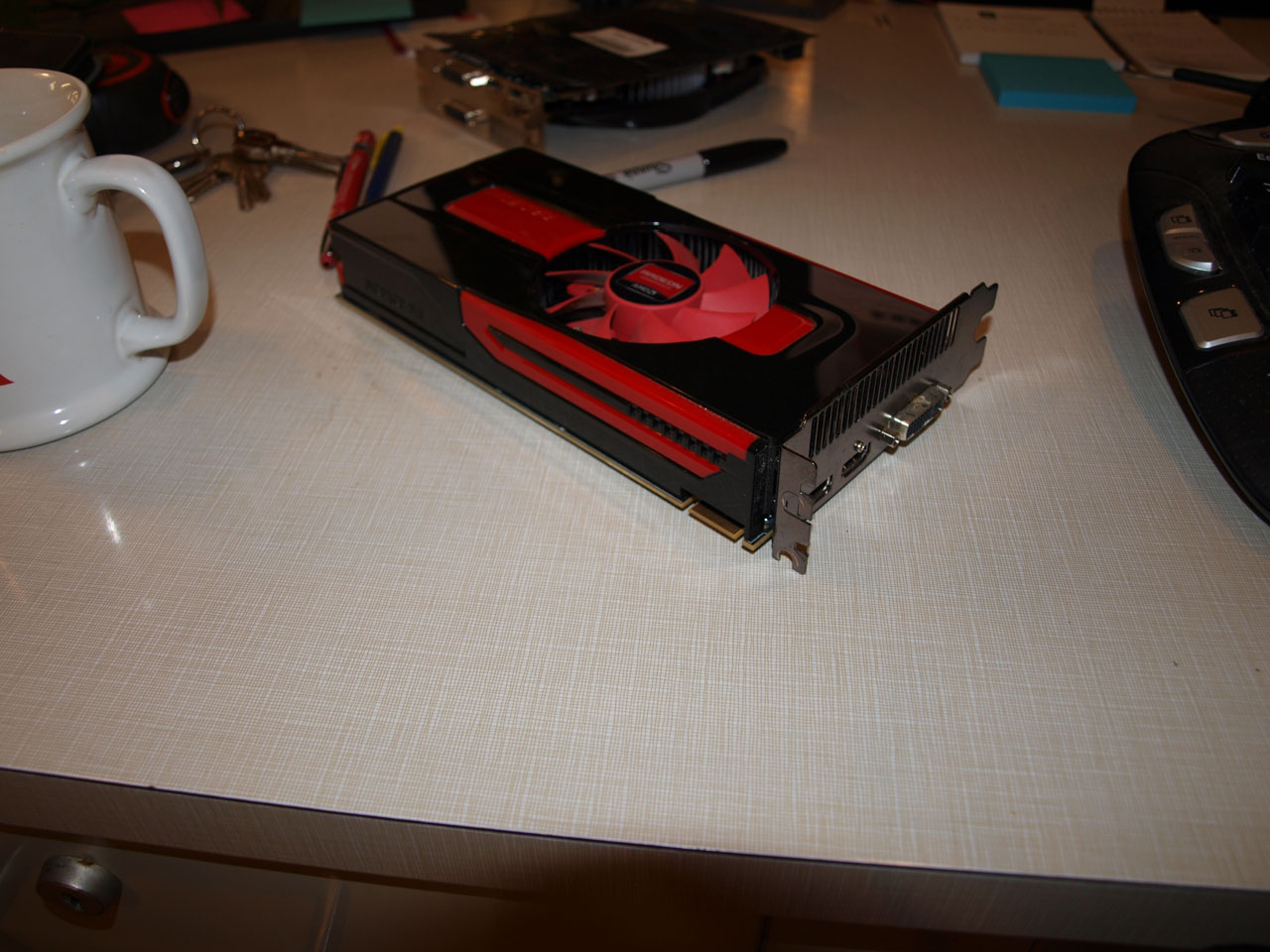

            I did find a Radeon HD8760 2gb in a goodie box I had gotten a while back....it works fine....but looking for a mate to it, it's apparently a $150 card....definitely out of the budget for this build....
              Yeah... that's a bit too much.
              I think we determined that HD8760 is pretty much the same thing as an HD7770 GHz Edition, but with 2 GB of RAM. You can get an HD7770 for 1/3 of that price... though at $50, that's still a bit too much, IMO.

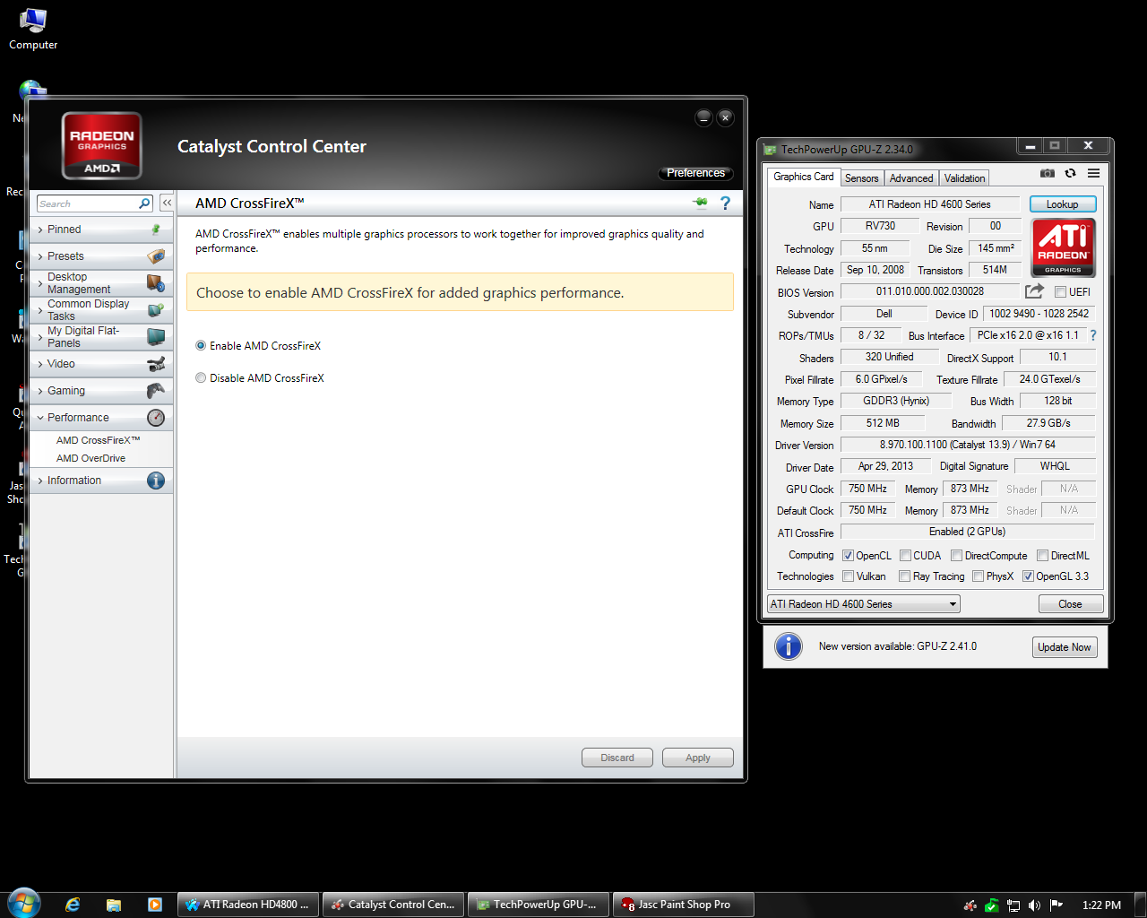

                I moved the single-slot 4600's to the T3400 system; which is a socket 775 running a modded lga771 x3363 @ 2.83/1333....the fastest it can take, it won't run 5100 or 5400 series xeons. Has the max of 8gb ECC ram, and now these GPU's. Definitely better than the Quadro NVS 290 that was in it.
                The T5400 is still pending; but running the hot-runner this thread is based on, but these other GPU's didn't go to waste atleast.

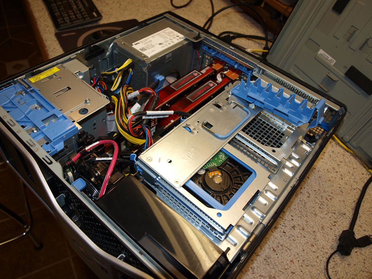

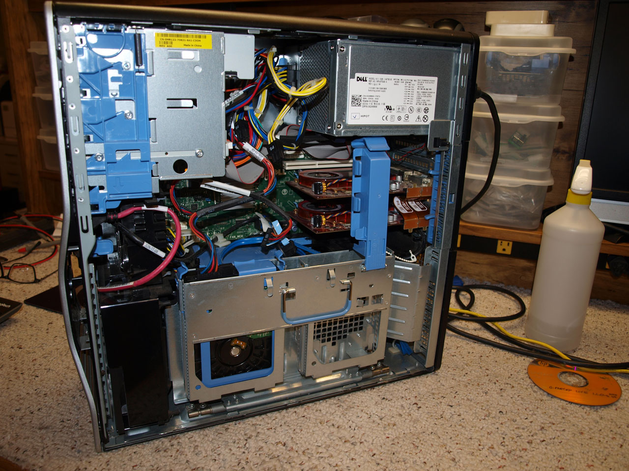

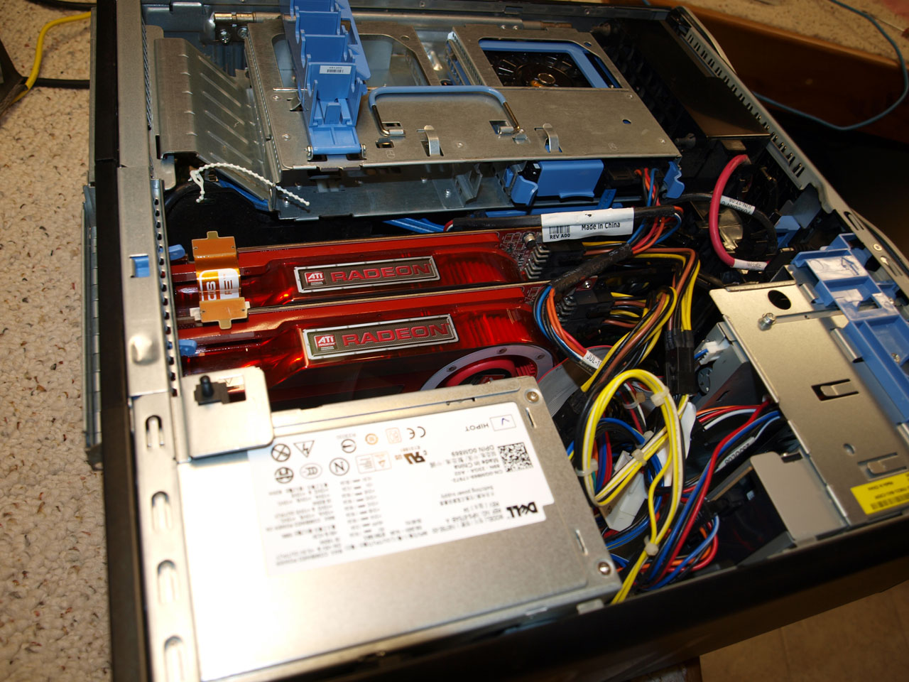

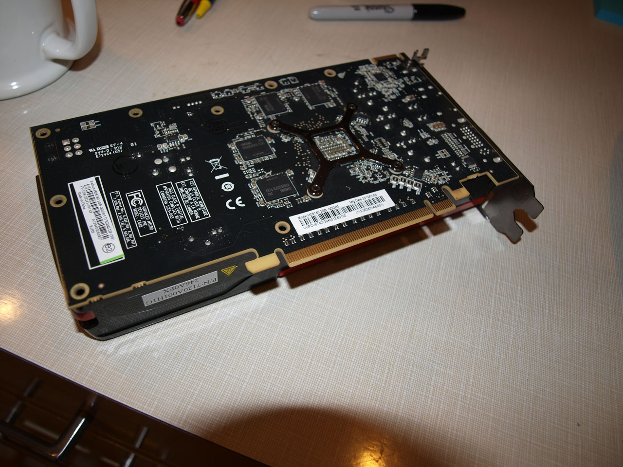

                    The repair of the damaged one has been deemed successful. I've been abusing both of them for a few days, they've been fine. Temp-wise, they're within 5~10* of eachother at any given time....damn these bastards run hot!
                    So firmware hacking? hmmm....I'm open to the idea, but have never done it before with a GPU (I've modded plenty of motherboard firmwares).
                    but here we are....

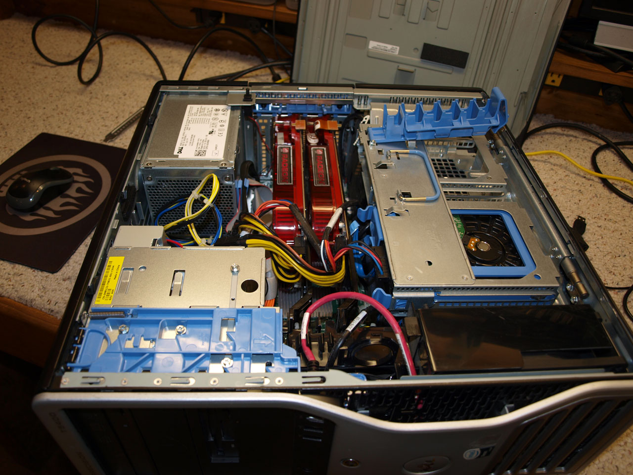

                    This is the Precision T5400. FWIW, the 'windows experience' score (for as little as that means) went from 6.8 to 7.4; 1 GPU versus 2 in crossfire....
                      Oh, for sure! That Quadro is a 4-ROP beast with only 16 shaders and not very fast core clock. Just a single HD4670 is approximately 350% faster than it, according to TechPowerUp. So two of these in CF is probably anywhere from 350% to 400% better. It will do nice with older games.

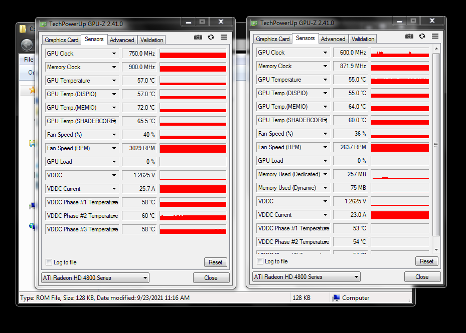

                      Eh, I wouldn't call it hacking, as it really isn't that complicated. I mean for me to say that - a guy that prefers not to diddle with software (especially firmware and BIOS updates, unless absolutely necessary) - means this really is pretty easy.
                      At least to get your feet wet a little, you an try the fan mod for now. Then later we can worry about under-clocking & under-volting:
                      Step 1) open GPU-Z and backup/save BIOS to file (hit that button with the gray arrow icon on GPU-Z in the upper-right corner.)
                      Step 2) open Radeon Bios Editor [RBE] (download online) and hit "Load BIOS..." button, then load the BIOS file you just saved from step 1.
                      Step 3) click on the "Fan Settings" button in RBE and change the "Tmin (C)" temperature to a lower value. Tmin is the minimum temperature the GPU core needs to hit before the fan starts ramping up in speed. Depending on the vendor and the cooler used, this can vary... but IME, regardless of cooler used, I like to start mine at around 45C. Next, change the "Tmax (C)" temperature to something more sane. Stock is typically around 100C for these cards , which IMO is a bit ridiculous. Tmax is temperature where the fan will hit 100% speed. I like to keep my cards under 60C at all times... but from what I remember from my tests, that's an overly-ambitious goal with these HD4870 cards. As beefy as the cooler may look, it's actually not quite adequate for the 150W TDP of these cards - not if temperatures are to be kept lower. So if you put Tmax at 60C, I think you will find the fan to ramp up very quickly with any moderate 3D load, and thus the card will likely sound like a jet engine... though it will stay a lot cooler compared to the stock profile. Trying something like 65-75C for Tmax should make it a little more quiet but maintain a lot lower temperatures than with the stock profile. Of course, that's assuming your card's stock values for Tmin and Tmax were actually higher than what I suggested above. If they are lower, then a volt & core clock mode might be the only thing to help the temperatures here.
                      Step 4) When you're done diddling around with the options, hit the "Save BIOS" button. Don't worry, this step won't flash the card's BIOS yet - you're just saving the modified BIOS file.
                      Step 5) Flash the modded BIOS onto the card. You can do this with ATI Flash or with ATI WinFlash. The latter is for doing it under Windows running. Generally it's better to do it without the OS... but for these older Radeons, I've never had a hitch doing it through ATI WinFlash. Regardless of which option you choose, it's probably best to do it with only 1 video card installed in the system.

                        By golly, that was easy!! It also worked! Still a hot-runner, but fans ramped up I'm far less concerned about it! 100% a success! Thanks for taking a waning/failing project and helping make it a go! Fans obviously more audible, but not ridiculous/obnoxious! Well done!
                        The image is 2 instances of GPUZ; reflecting the temps of both GPU's. MUUUUUCH BETTER! ...but I noticed that the clock speed of one is 150MHz higher than the other.... Perhaps it's a 'speedstep' kind of thing....I noticed they both fluctuate core speeds between 600~750MHz, GPU 2 more than GPU 1 is lower....I guess one is bootstrapped; much like a multi CPU system, one is always favored over the other.
                            You're welcome!
                            Yeah, whoever made RBE and GPU-Z - kudos! Just a little tweaking to the fan profile can make quite a difference for these cards.
                            I still can't figure out why ATI/AMD let the temperatures go so high before ramping up the fans. Sure it keeps the cards quiet... but when they die, they will be quiet forever. And these high-end HD4800 cards do fail quite a lot after enough thermal abuse.
                            Seems like you tamed them a little more now. 55C for idle temps is still a little high. However, perhaps that has to do with the cards not going into full idle mode (IIRC, around 150 or 300 MHz core clock and ~1V on the core instead of 1.2xx V.)
                            Yeah, that's normal and indeed kind of like Intel Speedstep. All "modern" GPUs do this to conserve power (well, since like 2007 or so.) Newer cards are just more aggressive about it.
