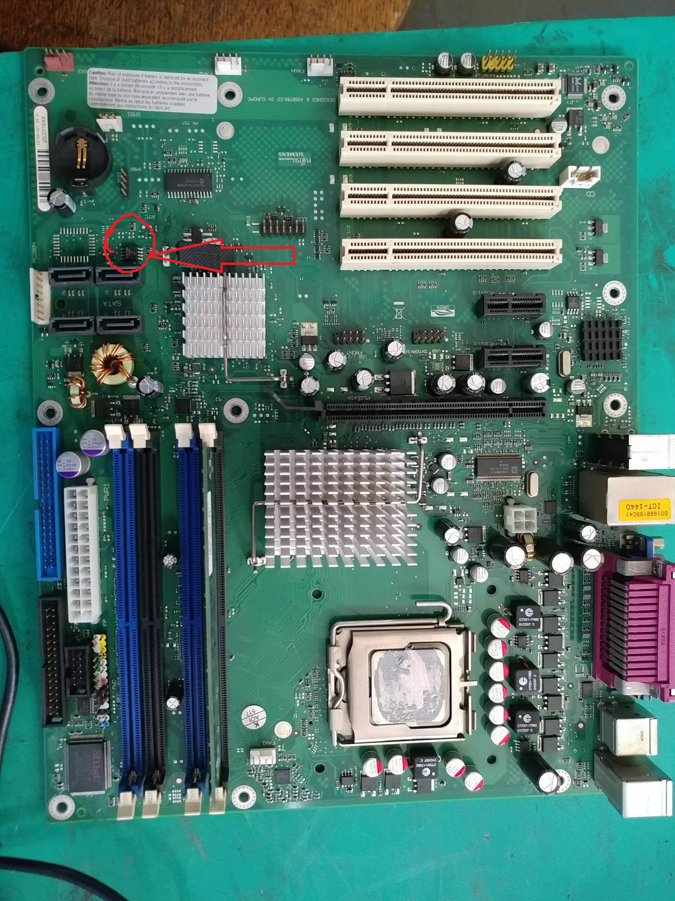

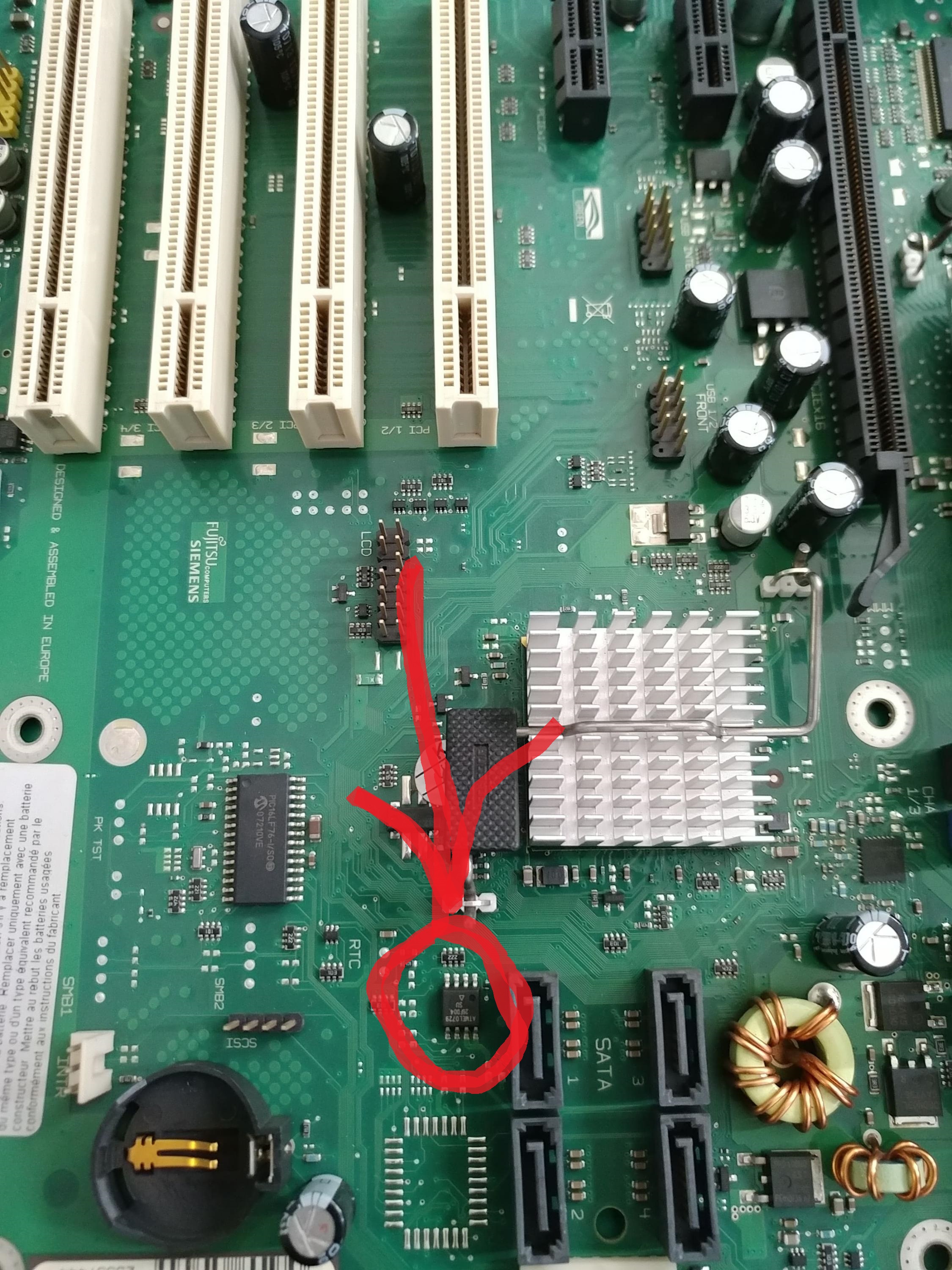

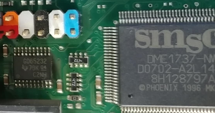

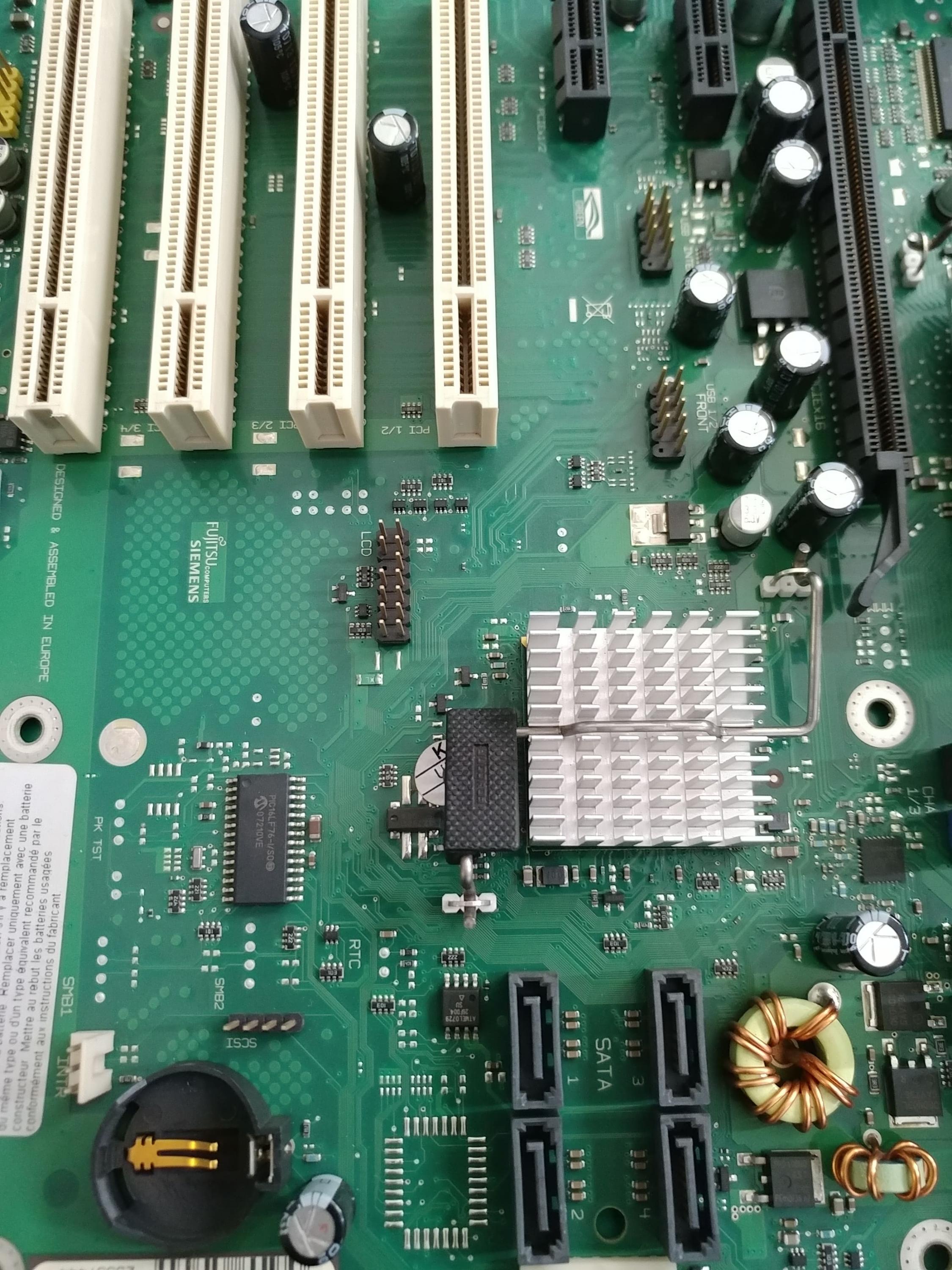

    I have a Fujitsu motherboard D2156 that cannot post. So I suspect that BIOS became corrupted. However, I'm not able to locate a chip on the motherboard that could be the BIOS. The pictures are shown in the attachment. I have no idea where BIOS is located. Recently I have reprogrammed BIOS chip on Asus motherboard and it was 8 legs chip from Winbond.
    However this Fujitsu board is pretty different.
    Any help would be highly appreciated.
    Thank you!

    Re: Locate BIOS chip on Fujitsu motherboard
    it looks it is him.
      Originally posted by andreynew1
      it looks it is him.
      Thank you. I suspect this could be it. It is written on it ATMEL0729, 26F004, but there is also one more chip that has also ATMELxxx on it.
      Is it possible it has two?

        look here maybe
        or otherwise gives the ref of the big microchip next to the cmos stack

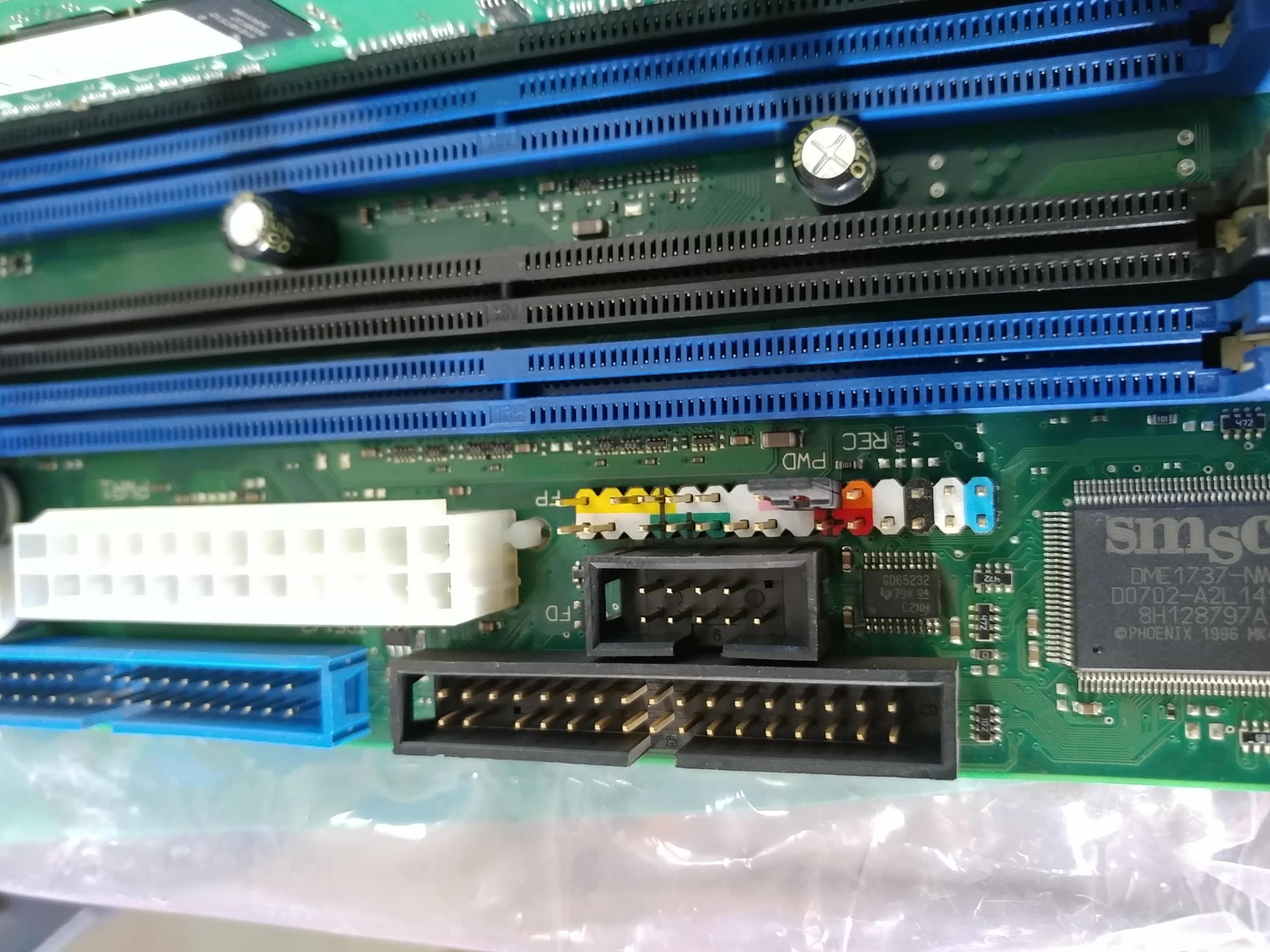

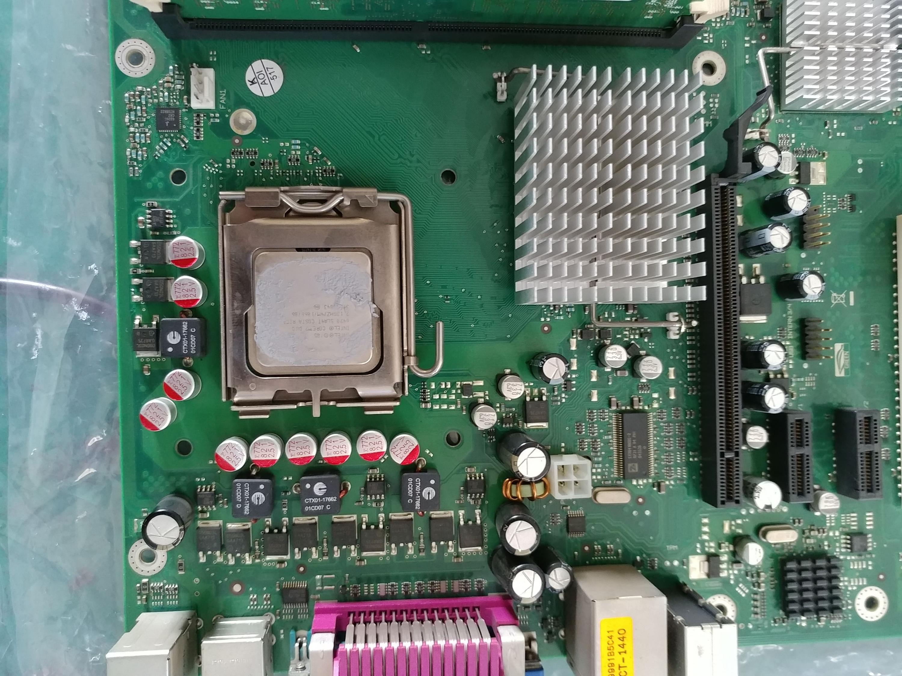

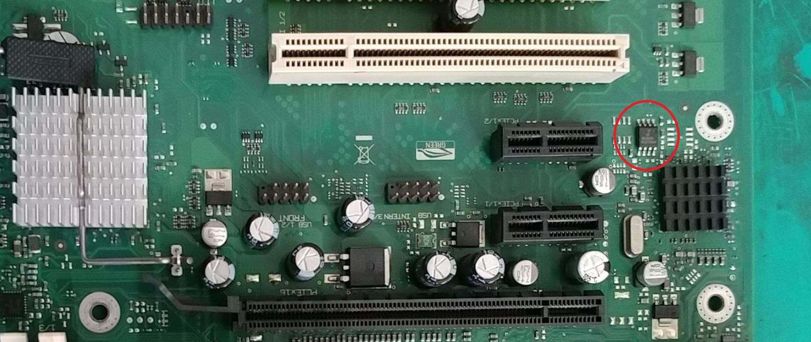

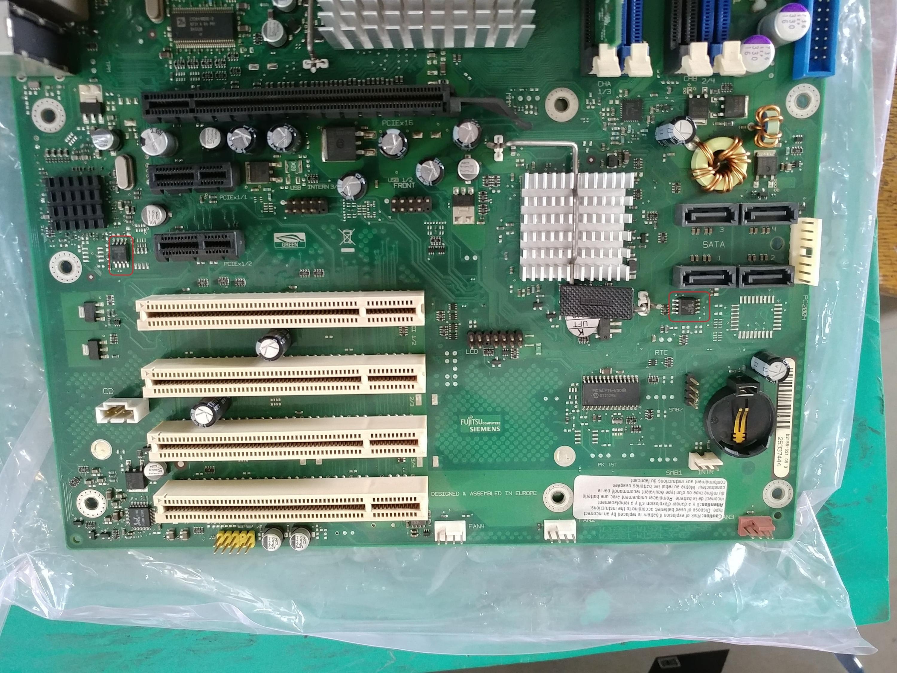

          Here are more detailed pictures.
          The problem is that I cannot find a single, unique 8 legs chip on the board.
            226F004 sounds like it could be a BIOS chip
            https://www.alldatasheet.com/datashe.../AT26F004.html

              • 21597
              That should be it on the 3rd picture, its near empty PLCC32 pads .

                Post the full PC model number and motherboard part number,including any revision ,such as D2156-S2
                  Hello and thank you for the reply. Full motherboard name can be seen on pic 3. It is D2156-S21 GS3
