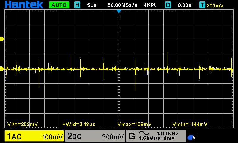

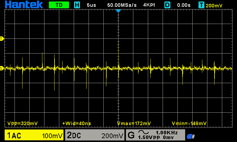

                    Re: Gigabyte RTX 2070 error 43 but no artifacts, crashes on driver load
                    Oscilloscope graphs of Vcore (NVVDD). Included a known working GTX1080 for comparison. This is at idle, of course, while the card is working fine.
                    So, changing gears here a little bit . . . assuming it was memory, like everybody insists it is . . . how would you go about figuring out which VRAM module is bad? I cannot generate any memory errors using MATS, can't run MODS, and can't load any drivers to run other tests.
