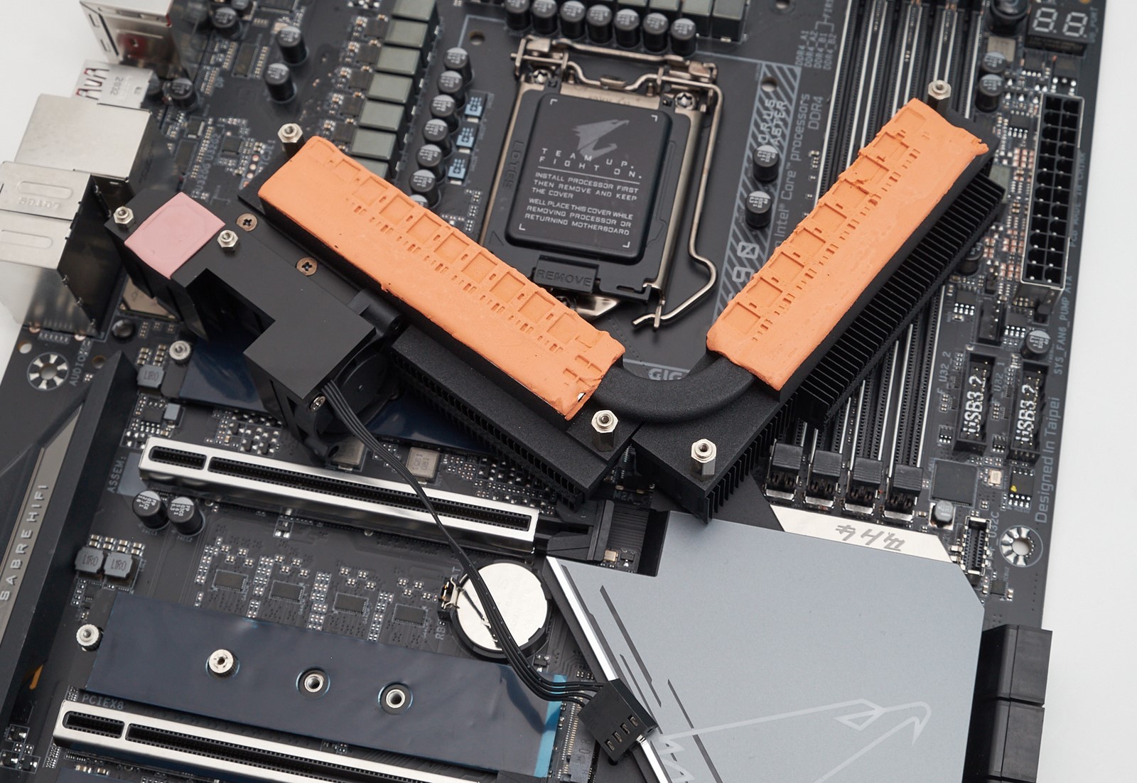

    Hi, does someone know what model of that little VRM fan is in Z590 Aorus Master motherboard, I would like to buy that board but I heard that fan is a bit loud so I would replace him with A4x10 from Noctua, is that ok idea ? What do you think ?

      It's not fan for video card. It's a little buzzer on VRM to be exact it cools Aquantia LAN chip.
      And it's not hard to find replacement for it I bought Noctua A4x10 a way more quieter fan, but question is will this fan with 5000RPM and static pressure of 1,95 mmH₂O be ok for it. Because now this default fan is around 9800RPM and loud as f... when it's on high RPM, and it is PWM fan but I can't controll it via motherboard. I even ask gigabyte to fix that and they told me this:
      This fan is non adjustable or non controllable. It is by hardware design.
      I don't know how much static pressure does it have because I still didn't disasseble the board, and on internet there is no info. of that fan model. And what my main concern is if my Noctua replacement fan will cool as good as that default one.

          Can we see a picture of the original fan and also the hardware/heatsink it's supposed to be on? Perhaps that way we can find an alternative replacement.
          That said, if a fan is not completely burned out, I *always* try to repair it.
          Sleeve bearing fans can be cleaned and lubricated - even sealed ones, if you're willing to take on a slight challenge of opening them (they aren't too hard to open once you get the hang of it, but can be if you've never done it before.) And if it's a ball bearing fan, you can either replace the bearings or repack them with grease in some cases (Topcat has written a good method on how to do that and what supplies to use - I can try to dig up that post if you're interested.)

              Fan is new, but it's noisy as hell. It's new motherboard Z590 Aorus Master. I will disassembly board again in few days and found out what fan brand is, but I will sure replace it with my A4x10 from Noctua cause it's less noisy and maybe better air pressure, but that I still need to check.
              "So that's either poor design decision or a good one (for saving on the manufacturing costs.)"
              I bold what I personally think it's right.
              Here is picture

                Well, in that case, I don't know if your new fan will be able to improve things that much more. When it comes to these small fans, you really do need to run them at high RPMs if you want to push any significant amount of air. So if your new fan doesn't turn as fast and is more quiet, it probably won't be pushing as much air either... and that leaves a question whether the CPU VRM will still remain properly cooled.
                I also see the original fan is 4-pin PWM... so there should be something controlling its speed (otherwise, they could have went with a 3-pin or even a 2-pin fan.) Thus, if your replacement is not a 4-pin PWM fan, you might end up with even more noisy results.
                All in all, I think the CPU VRM cooling design is just crap. What were they thinking placing a small fan like that in there? They should have just extended the heatsinks and just relied on passive air from the CPU cooler. Or if that wouldn't have been enough, they should have made the heatsinks flatter and used a bigger (50, 55, or 60 mm) thin overhead fan at lower RPMs... and it probably wouldn't have been more expensive. But I guess it's all about looks and performance these days, not about making a product that lasts.

                  The fan is not for the VRM it is for the Aquantia AQC107 10 GbE controller

                    Gigabyte was lying. I clear cmos now for the second time and now I can normally adjust fan, it was stuck for some reason when I flash bios I couldn't do anything to it's speed. But now I can regulate RPMs normally.
                    Don't know if it's OK to change that fan for A4x10 from Noctua, what do you think ?
