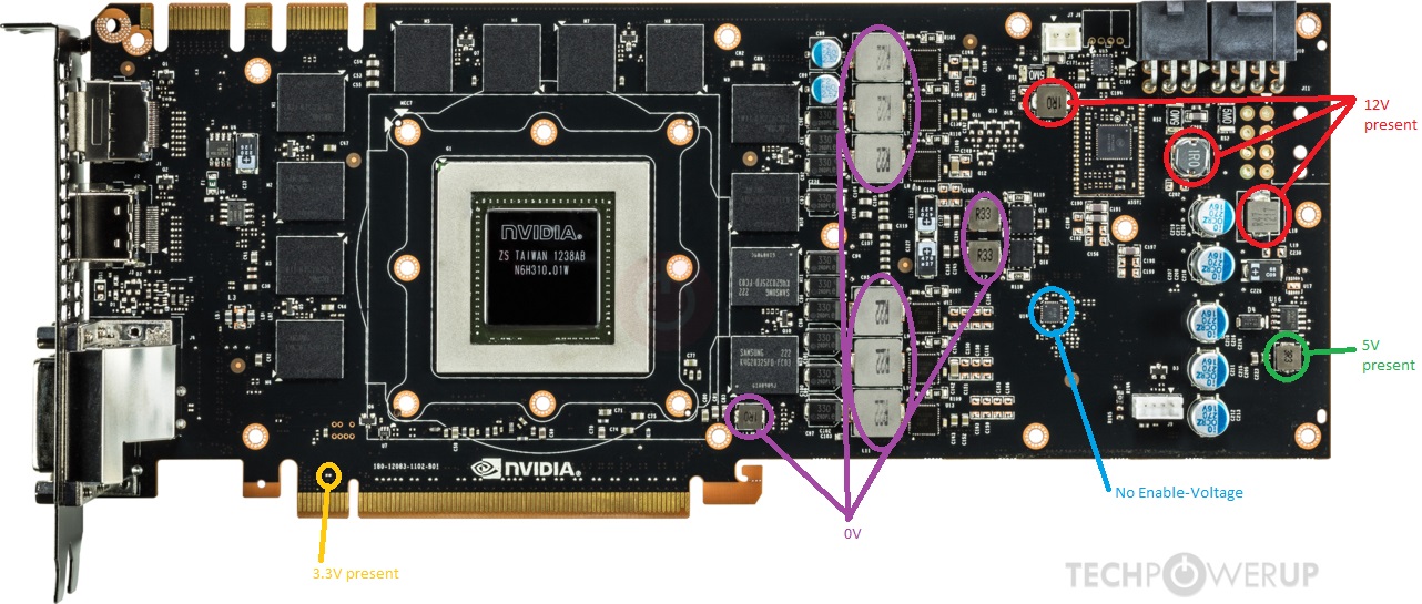

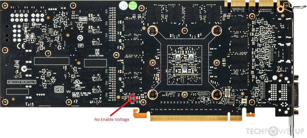

    Hi guys,
    I have a inno3D GTX780 on my bench which has a defective GPU VRM Mosfet Sic780. I removed this and wanted to test the card. The card doesn't give any picture and is not recognized by windows. So I measured the main voltages and there I saw the culprit. Some voltages are missing as you can see in the attached images. The two PWM-Controllers do not have an enable voltage. Now my question. Does anybody know where the enable voltages are generated?
    Best regards

    Re: inno3D GTX780 no picture, not recognized
    Yes
    One of the three GTX780s I looked at had no EN signal like yours, The EN voltage is derived from the 3.3V or 12V on the PCI-e connector. On mine, once I fixed that by fitting a patch wire because I could not find where the faulty track or resistor was, I got the card to boot but had artifacts on screen.
      Thanks for your answer. The linked thread I do know. So I will try to find out the faulty component. I think this will be difficult because till now I can't trace back where the signal comes from or should come from. I will test again and keep you informed.
        In my case it was a broken PCB trace or via I think.
        You have to have the power coming in from the PCI 12V/3.3V to the GPU before anything of the other VRMs will start up. I think the 3.3V acts as a standby supply to the GPU BGA itself.
        On mine, I had to bridge it out with a piece of wire, then the card powered up. There were also some missing capacitors behind the GPU
              Video cards don't really have "standby" rails. However, they do have at least one secondary Vcc for the GPU chip, which is responsible for powering the sections of GPU that read the EEPROM/flash chip. This (or these) secondary rail(s) is also what allows video cards to display simple messages, such as "power cable not connected" if the user forgets to plug in the power cable. The secondary Vcc rail(s) is typically powered from 3.3V on the PCI-E connector.
              So essentially, 3.3V is needed for both the card's EEPROM/flash chip and secondary rail for the GPU chip (typically generated from an LDO or two.) Once the GPU chip has read its EEPROM/flash and initialized and communicated with the PC, only then it may send a power signal to its VRM controllers to start all of the main power rails (GPU V_core, RAM V_dd, GPU V_tt.)

                I found the failure. The NCP4206/4208 does not start if there is a missing driver mosfet. I wanted to start the card with just 5 of 6 phases but the phasecontroller doesn't start. So I soldered in a working mosfet and the card is running again.
                Summary: 1 defective SIC780.
