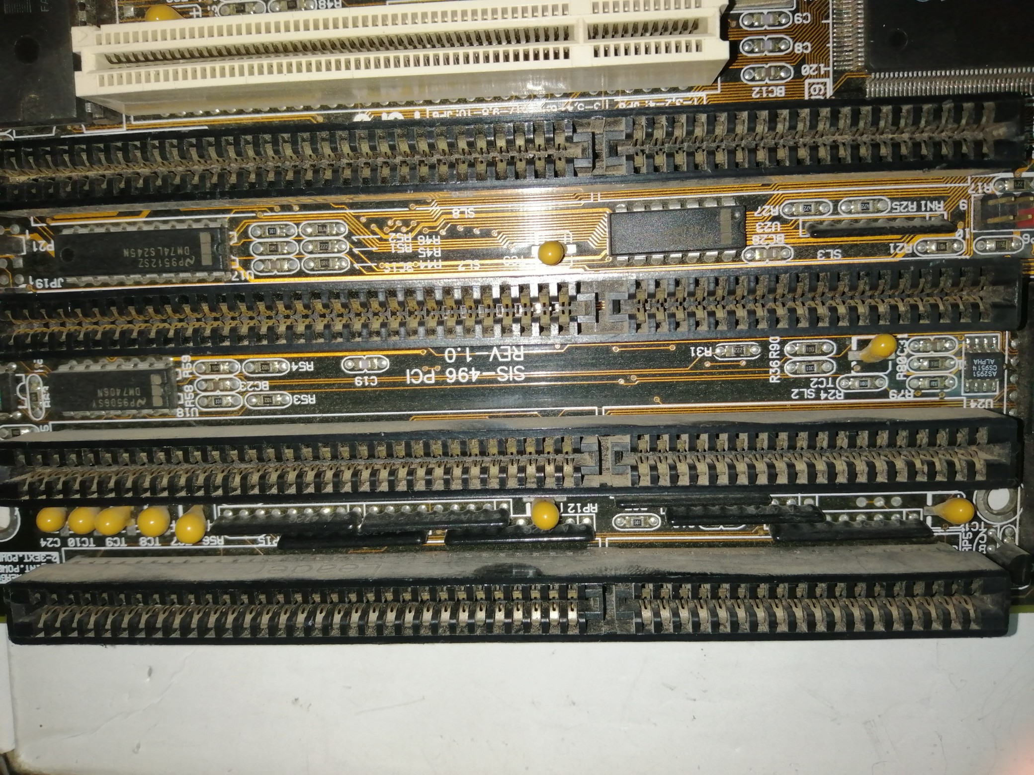

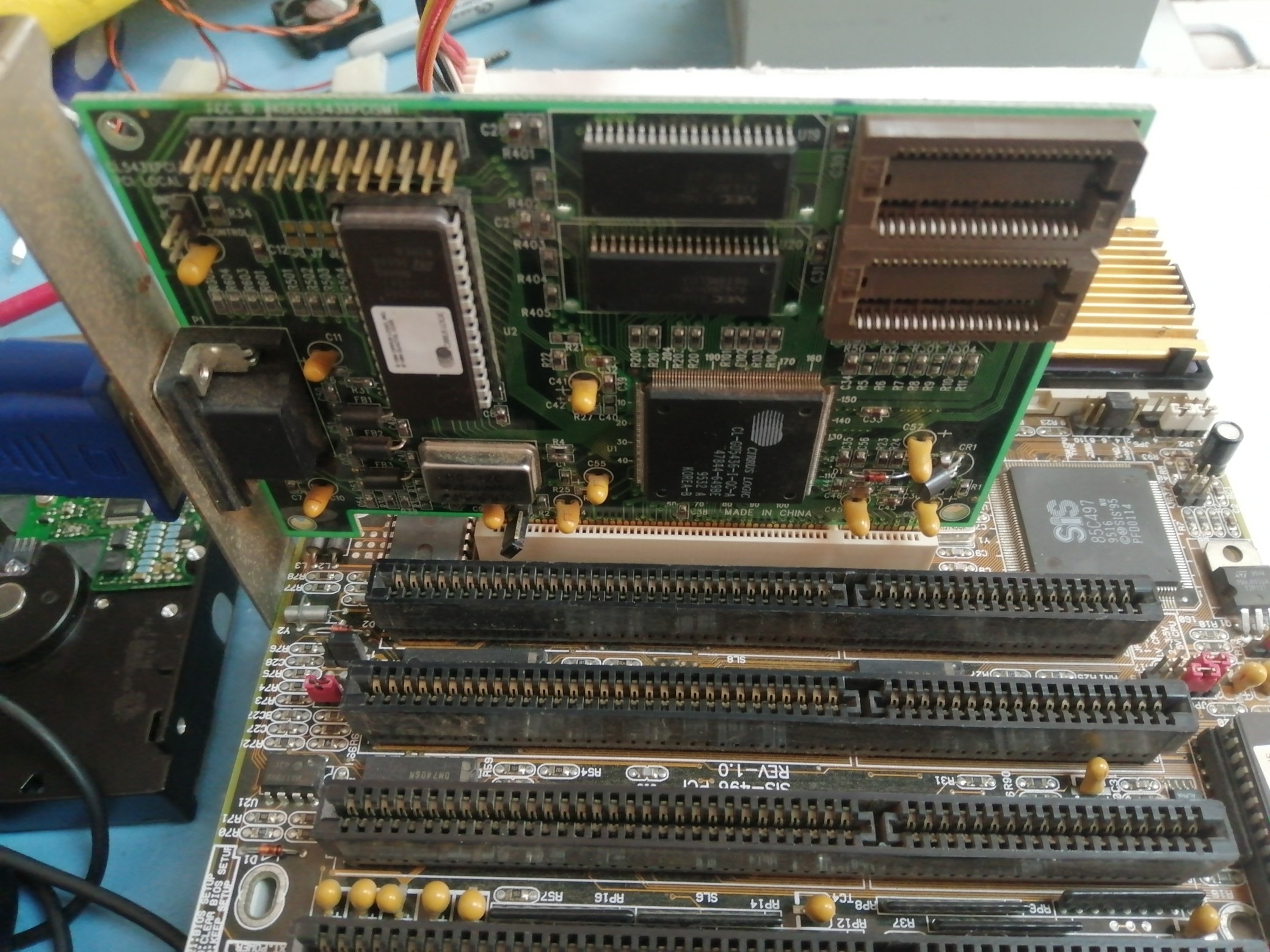

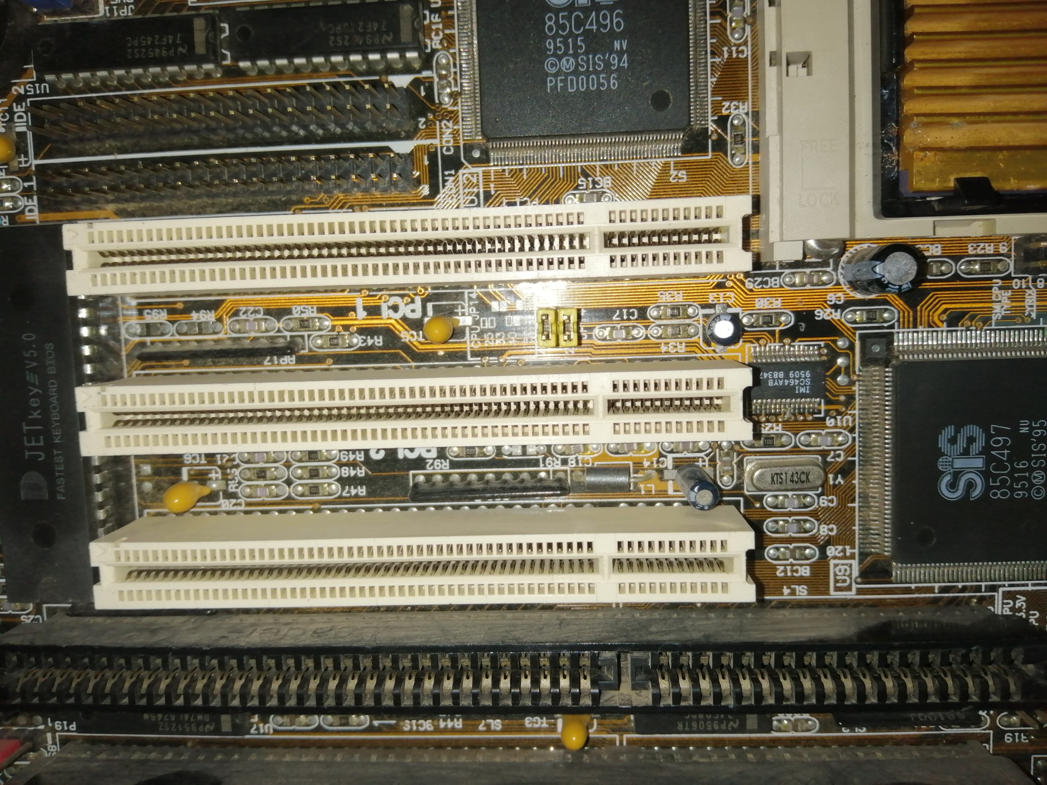

    So I have this 486 DX4 100 on a SIS 496 motherboard. And it works - but only if I put the graphics card in the PCI slot furthest from the CPU. I didn't try a sound card or IO card in the other slots, mainly because I don't have a hard drive of small enough capacity this would work with, unless I could persuade it to work with a larger more modern IDE drive. Therefore I don't have an OS installed.
    All the PCI slots look OK and I don't see any other obvious damage. Could it just be something in the BIOS? It would be nice to save this from the trash as there are not so many around any more. And it is somewhat collectable these days.
    I hope some of you have more experience of such old hardware.

    Ahhhh... OK I got it working. I was going to meter out all the PCI slot pins according to this guide
    https://www.slideshare.net/neilfarle...y-pconlinever2 (slide 17/45)
    which explains which pins are in parallel on all slots, and how the other ones are connected - so it should be useful for troubleshooting a faulty slot.
    However just before I started I then had the bright idea of putting my POST diagnostic card in each PCI slot to see what it did, and I found I got the same sequence regardless which slot I used. A bit puzzled why they behaved differently (slot 1 and two gave the typical beeps for missing graphics card) I put the VGA card back in and found it now works OK in slot 2 and 3, and intermittently in slot 1. I tried reinserting it a number of times in slot 1 and that didn't help too much but I did the same reinserting the POST card a number of times and slot 1 now also seems to work OK
    I also found a (slightly noisy) CPU fan for the heat sink, the original one was seized up.
    So to continue I think I will now try to see if I can get it to recognize an IDE HDD so I can try installing Windows 98 from CDROM (which I have - but I only have 8Mb or RAM so maybe that isn't going to work). Or Windows 95 but I read that is more tricky without a bootable DOS disk. But I do have floppy drives and one floppy disk.

      Yeah, on motherboards this old, you can expect the connectors to be a bit tarnished at this point. In fact, some cheaper motherboards didn't have really good moisture protection on both the connectors and the traces, so do check both sides of the board carefully for any possibly corroded traces. Some old boards like these also had supercaps or rechargeable batteries to keep CMOS, and they would leak and destroy contacts too... though yours looks to be safe from that.
      Also, remove and reinsert any jumpers too - they may have developed bad contacts too from sitting for so long.

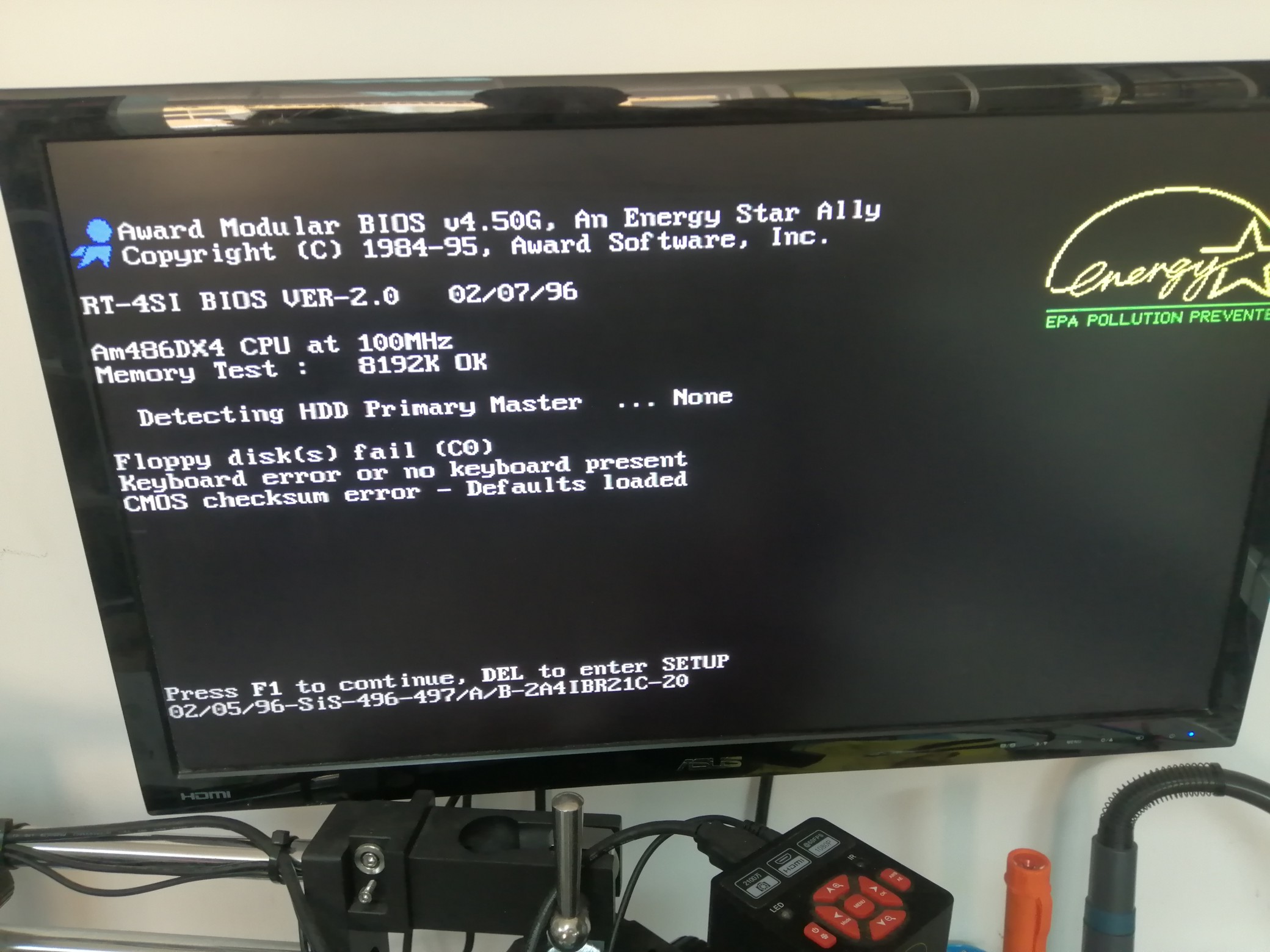

        Hmm yeah I'm not quite out of the woods yet with this one. I had problems getting it to autodetect a hard drive. The smallest one I have is 20Gb and it would detect that (as 8.5Gb - which is OK as this 486 board seems to be a late model that supports LBA) but after trying to get it to detect a CDROM, I can't get it to detect any IDE device anymore.

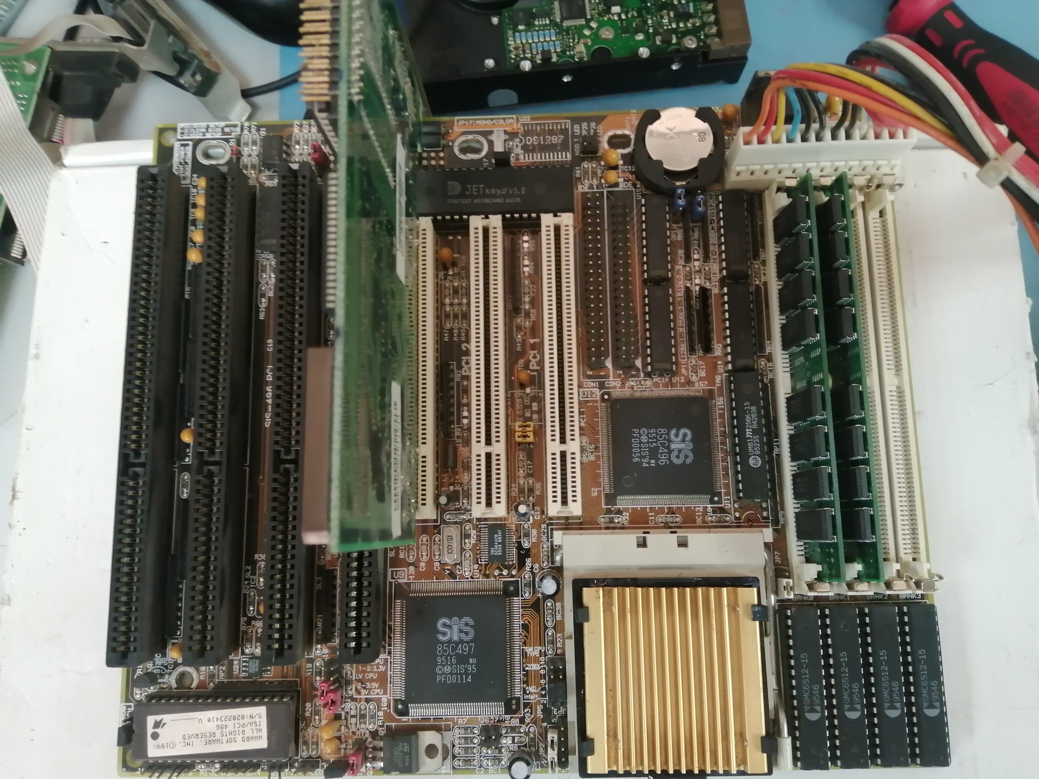

            Oh yeah - The PSU. It came with the motherboard, CPU, RAM, SVGA card (can't really call it a GPU) and MultiIO with cables. There was no AT case or anything else. It just came in a cardboard box of bits at the flea market and I am pretty sure I paid no more than €10 for the lot. The sound card is one I had lying around for a while, from the same flea market - condition unknown as of yet.
            Anyway I fixed the PSU last year (though I don't remember what was wrong with it now) and all the caps look good - not bulging - but not checked other than that. I will check for noise on the voltage rails on my scope tomorrow. Anyway there are not so many caps so I could change them. The mobo originally worked (well it booted to the BIOS screen) once I fixed the PSU but with the problem with the PCI slots and I left it on one side for maybe a year.
            Other than that yeah, I may have damaged the IDE controller. Something definitely changed after attaching the CDROMs to find a working one, but having said that all the CDROMs, the HDD and the same IDE cables have been on another rig to test since, and no damage occurred to that one, though two of the CDROM are now in the trash.

              OK. So I got a 2Gb CF card and an IDE-CF adapter... and the motherboard will will not detect an IDE device is attached
              Bear in mind the board originally detected my 20Gb HDD as an 8Gb HDD, but for some reason after I tried to detect a CDROM it will not detect anything any more. The HDD and CDROM work OK on another PC, or at least non of the CDROMS I tried damaged the other PC though I threw two of them away for not reading disks properly.
              I will try the IDE-CF adapter on another motherboard on Monday to check it is actually working but it was new so I guess it will be
              Anyway I had a look around the 74F244 tri-state buffer drivers that connect between the IDE connectors and the 85C496 Chipset but I couldn't really work out what I was supposed to be seeing on my scope when trying to detect a Hard Drive. it's like only one side of the buffers has any data, the other side is floating, even though one of the EN pins is enabled on each buffer IC. Also only 14 of the buffers have data signals on one side - the other two don't.
              Again I'll post some more details on Monday, but for now I thought I would google to find out how IDE actually works. Based on the premise that if I know what is supposed to be happening it will be easier to work out what is not happening
              I can find a pinout for the 40 pin connector, but when I google for 'how does IDE detect a Hard Drive' is not telling me what I want to know
              So I would have thought this was easy enough to find out, but can someone tell me - How does IDE detect a hard drive's parameters? What happens to make it do that?

                The good news is, it's working
                But I am not exactly sure why
                I tried my 2Gb IDE-CF on a test rig and it detected just fine. So I put it back on the 486 on secondary IDE this time, and it didn't detect. Then I did BIOS defaults, saved that, and it started to work on both IDE secondary and Primary.
                This is I did the BIOS defaults several times while trying to get the 20Gb drive to recognize, after it stopped detecting, but the 486 board was having none of it. Even after I used Seatools to set the 20Gb to 2Gb

                      Maybe you have a bad PATA cable, those used to be a bit problematic specially if you are using the original ones!
                        it looks like those hard disk size detection issues are due to the bios being unable to detect the hard drive parameters properly. the 8.5gb limit u are getting is typically of the addressing limits of the chs addressing method. try going into the bios and set the hard drive parameters manually and saving the settings. i remember bios software back then wasnt too smart and u had to set the hard drive parameters manually in the bios or else the hard disk wont be detected properly or it becomes not useable by the os.
                        also make sure the cmos battery holder contacts are not tarnished and the battery holder legs are making good contact with the through holes on the mainboard.
