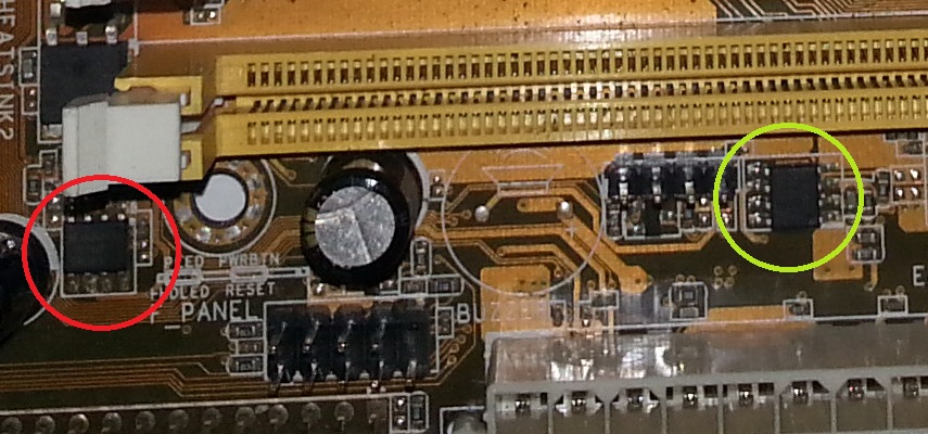

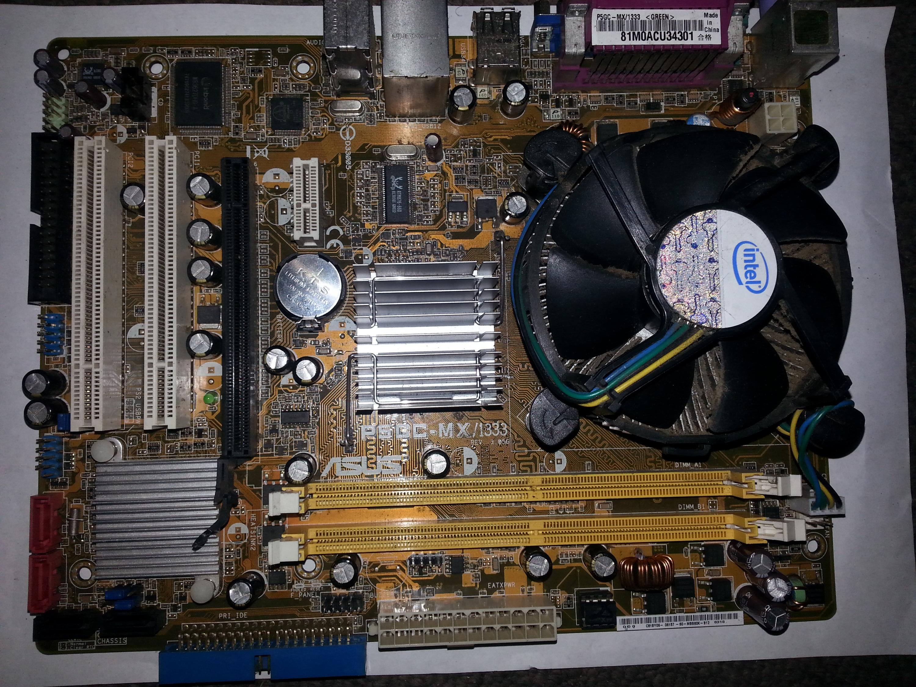

    Was just after a case, but it came with this board.
    Replaced the dead CMOS battery, and reset the RTC RAM with the jumper
    The green light on the board lit up, when the PSU was plugged in,
    and the CPU fan spins, and the green keyboard lights flash once, when turning it on - but no BIOS beep or video.
    Cannot power down the board when holding down the power button - it can only be powered down by using the on/off switch on the back of the PSU.
    Draws 27W with just the hard drive connected.
    In the vicinity of the RAM, there is two AT9173 Bus Termination Regulator (driver?) chips.
    Here is the measured voltages on the pins:
    From the close up photo,
    The chip on the left, circled red
    (and according to the pinout on this diagram : https://pinouts.ru/Memory/dimm_ddr2_pinout.shtml)
    My multimeter measurements are:
    1. IN 3.41V
    2. GND 0V
    3. REFEN 1.06V
    4. OUT 1.06V
    5. VCNTL -0.01V
    6. VCNTL 5.12V
    7. VCNTL 0V
    8. VCNTL 0V
    The chip on the right, circled yellow
    1. IN 3.41V
    2. GND 0V
    3. REFEN 0.03V
    4. OUT 0.05V
    5. VCNTL 0V
    6. VCNTL 5.12V
    7. VCNTL 0V
    8. VCNTL 0V
    These measurements don't seem to align with the "typical application" schematic that is shown in the datashheet
    https://pdf1.alldatasheet.com/datash.../AT9173EG.html
    There is two RAM slots, and they both only have 0.05V on the VDD and VDDQ pin.
    The two MOSFETS, that are on the left hand side of the slots, are not shorted
    Any ideas as to what's gone bung?

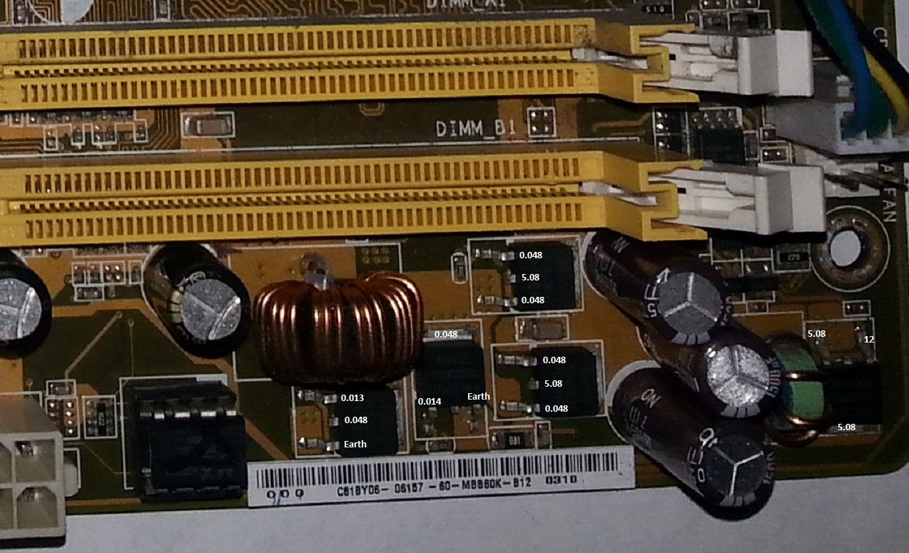

    I'v attached a close up of the MOSFETs on the bottom right corner, and and texted in the voltages that are present when the PSU is turned on.
    Looks like they are not being switched on
    The coil is attached to the drains of the two MOSFETs that are closest to it, so it's only got 0.048V on it
    Also noticed that the capacitor that is attached to pin 4 (OUT) of AT9173 is dented inward - could that be causing the the chip to not turn on?
    The two MOSFETS, that are on the right side of the RAM slots, have no significant voltages on them.

      Being an LGA775 board, I suggest to remove the CPU and inspect the CPU socket for bent pins - especially the corner rows on all sides.
      Also, looks like you got the better version of this board - this is the P5GC-MX/1333, which I think supports even 1066 and 1333 MHz FSB CPUs (whereas the regular P5GC-MX only supports 533 and 800 MHz FSB.) And you got almost all Panasonic caps to boot (with the exception of the three KZG above the RAM... which can be suspect, but I'll give them a pass for now - I think they would have bulged if they were, as KZG pretty much always do when they fail.)
      As for the voltage measurements you did... looks like the upper MOSFETs in the RAM VRM (for Vdd rail) are getting proper voltage (5V), but just not being switched on. Can't say yet if that's normal or not though. Generally, there should be 1.8-2V for the RAM, regardless if RAM is installed or not. But if the power-up sequence is held up for whatever reason, that may be why there is no voltage there, so it doesn't necessarily indicate a problem yet. And you really need to test with RAM to see the proper voltage.

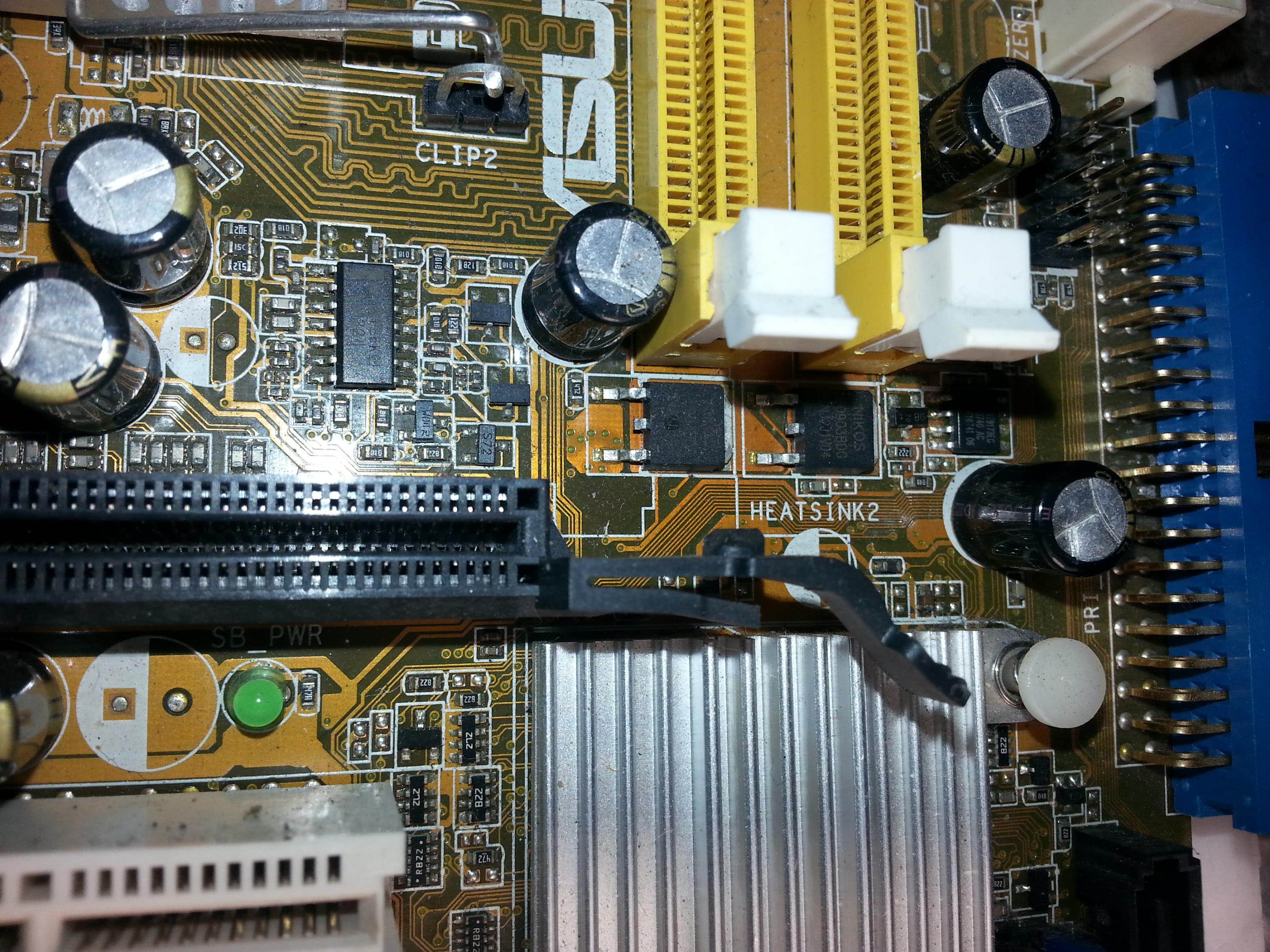

          Also checked the four MOSFETS that are above the CPU and in-between the two horizontally installed output coils
          (in the first photo, you can see a coil and top two MOSFETS just above the heatsink fan, and the tip of the other coil a bit further along underneath the input coil)
          GDS from left to right, top then bottom
          1.3mV 12.07V 1.3mV
          1.3mV 12.07V 1.3mV
          0.7mV 1.3mV 0.7mv
          0.7mV 1.3mV 0.7mV
          So, they are not being switched on
          And on the right hand side of the CPU there are two more MOSFETs and a lesser wound horizontal toroid
          G : D : S
          1.3mV : 12.07V : 1.3mV
          0.7mV : 1.3mV : 0.7mV
          So these other MOSFETS are not being switched on either

                  In general, though, that bigger toroid/inductor by the RAM slots is your RAM V_dd/V_ddq rail... or sometimes called V_dimm (depending on manufacturer, I guess.) It's the 1.8-2.1V that goes to the RAM. Then there is also another rail for the RAM (V_tt... which is usually 1/2 of V_dd/V_ddq, so about 0.9 to 1.0V) to keep all of the contents when the PC is in use or in standby. This RAM V_tt can be found on all of the small quad array SMD resistors by the right RAM slot (you'll see these SMD array resistors are tied to the same trace on one side - and that's the RAM V_tt). As for CPU V_tt, that's easy on this board - it's at the Source of the TO-252 MOSFET on the lower-left corner of the CPU heatsink / upper-left corner of the NB heatsink. Or, if we use this picture as a reference...
                  https://www.badcaps.net/forum/attach...1&d=1604982040
                  ... that MOSFET is located in the upper-left corner of the CPU heatsink and upper-right corner of the NB heatsink. CPU V_tt should be around 1.2V to 1.3V for LGA775 CPUs, if I still remember correctly. Supply for that MOSFET should be the 3.3V rail from the ATX connector (and found on the Drain pin.)
                  As for the two MOSFETs under the RAM slots... one is for the NB Vcc voltage, and the other for SB, I think. But that's the part I don't remember well, so I'll have to check my own P5GC-MX. I have to service that system anyways - the last few KZG caps I left on it have finally hatched too. They aren't on any important rails though (two being USB port GP power filters, so no biggie.) Anyways, you won't find any significant voltage on these MOSFETs on your board (both on the Source or the Drain) if your RAM V_dd is not coming up.

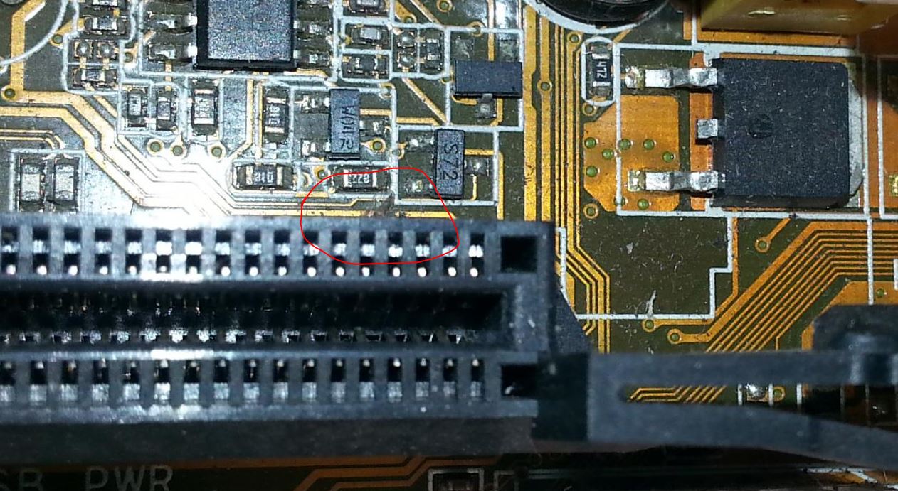

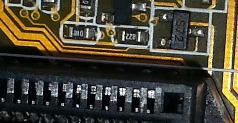

                        Looks like a trace is damaged too, unless its a dead insect or some other shit
                          The trace is good. Was just some dust that was causing that effect

                                  Re: ASUS P5GC-MX - No memory, no boot
                                  Yes that's ok, I was just confirming but in fact no reason for that to be the problem.
                                  Not sure why the RAM power rail isn't created then, voltages look good but indeed no output. Maybe the buck controller itself is bad.
                                  • socketa
                                    Asbelowsoabove
                                    • Jun 2014
                                    • 661
                                    • samsara
                                    In the first post i mentioned two AT9173 chips, and the datasheet says "The voltage output of the regulator can be used as a termination voltage for DDR SDRAM"
                                    The REFEN pin of one of the chips is being pulled low (i think that's you you say it) and i think that that is causing the chip to shut down.
                                    Someone posted some info on this thread:
                                    http://********/viewtopic.php?f=224&t=24455&start=30
                                    the site is vlab . su
                                    (the link wont post properly)
                                    Start Quote:
                                    These boards have a trick ...
                                    The microcircuit between the southern and the at9173eg memory slots flattens it in every possible way ...
                                    If the voltage on the fourth leg is less than the working one (1.05V), then the board does not start, the percentage is heated, the South is abnormally cold.
                                    If the voltage is more than 1.05V, then the board works but constantly hangs, the SOUTH heats up more than usual. in the picture 1.08 tupanul when I did the picture. on other Asus there are RT9173C which I install ... there is also RT9173B it is not desirable to install it (for the test you can) it is 1.5A.
                                    And you are not mistaken again maybe 1.25, not 1.05, I have 1.06, according to datasheet 1.25
                                    No, there is exactly 1.05 V. In short, I fucked with such a motherboard as the author had with the same problem, but only initially, on my LM324 on the 4th leg, the voltage was normal (something about 11.5 V). Prots also warmed up but on the 15th leg of the PCI slot - it was "0" V. That is, a stuck reset. I began to check the generation on quartz. There was no 25 MHz quartz at all as well as a network controller. There are only 2 quartz left - RTC and 14.3 MHz near the RTM876-660 clocker. So there was no generation at 14 MHz quartz and it was decided to replace it. And voila, the mother came to life!
                                    End Quote
                                    Unfortunately, these chips are not on the PDF, because the PDF is for a different version board
                                    • piernov
                                      • Jan 2016
                                      • 4435
                                      • France
                                      The DDR power rail VDDQ is required before the termination voltage VTT can come up. VTT is referenced from VDDQ since VTT is half VDDQ. Also VTT is only required when actively talking to the RAM in S0 state. It's not required in S3 state when just refreshing it (while VDDQ is required to keep RAM content alive).
                                      On the schematics the chip for DDR VTT is PWU4. It's a CM8562 not an AT9173 but it does the same job.
                                      The other AT9173 on your board powers the ICH core well at 1.05V so that's fine since you measure 1.06V on it. Difference from the schematics here is that on your board it's derived from +5V, while on the schematics it's derived from +1.8V_DUAL and regulated by PWU1 (LM324) so in your case it's present even though RAM power rail is missing.
                                      • socketa
                                        Asbelowsoabove
                                        • Jun 2014
                                        • 661
                                        • samsara
                                        OK, thanks for clearing that up.
                                        So the next step would be to try and replace POU1?
                                        Is it common for these to fail?
