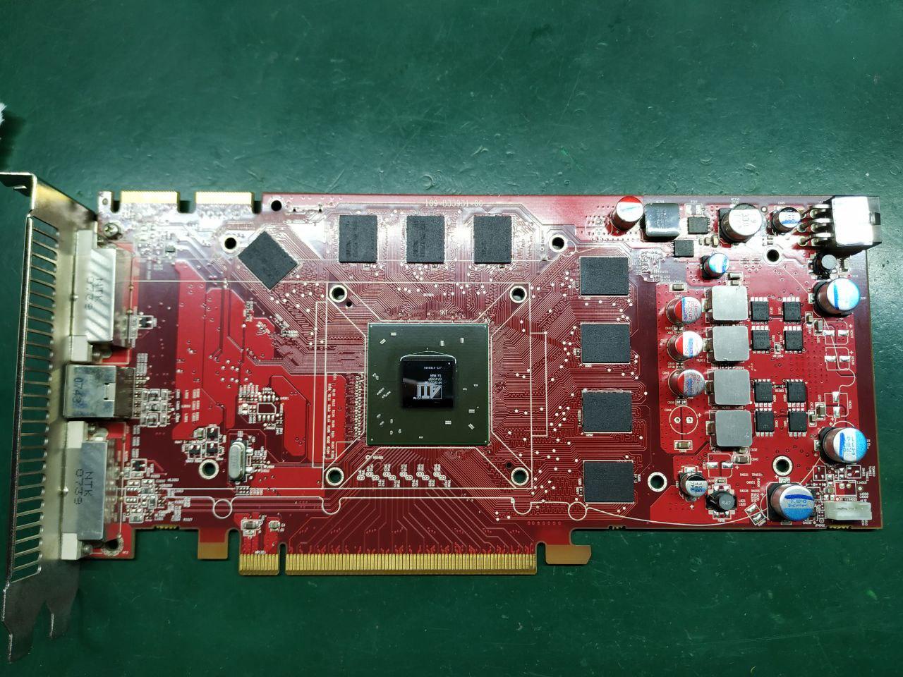

    Some moths ago i bought an old radeon 3870 for my retro pc project, i tested it for 20 minutes with futurmark and everything was OK so i dedided to put it in storage while i was gathering the rest of the components (dual core 939 platform).
    This week i finally got the rest of the parts and started to assemble the pc, but first i had to do a proper cleaning of the card and new thermal paste had to be applied, after assembling it, the card seemed to work fine but ramdomly after maybe 7-10 minutes artifacts appeared on screen (some vertical lines but no BSOD or crashes) if i move a window affected by these lines to a working area, the deffect persist only in the area of the affected window.
    So i thought it was a problem with the VRAM framebuffer, maybe a cracked solder joint caused by the heatsink pressure (first time i have broken a card while cleaning it), therefore i decided to reflow the vram chips, i placed the card in a preheater at 130ºC, covered the VRM and GPU chip with foil tape and applied FLUX to the VRAM chips (kingbo rma218), i carefully reflowed chip by chip with the hot air station with no nozzle, air at 50% and 380ºC, i made sure the solder melted by carefully poking with a tweezer on each chip, after leting it to cool down and reassemblig the card again, this time more artifact showed up.
    At this point my theories are:
    A) The flux residue is causing a defective behavior
    B) I damaged some chips with the heat
    C) Maybe the problem was the GPU chip
    D) Poking around with melted solder balls isn't a good idea (i was very carefully, all chips seem to be in place and varely moved them, so this posibillity is unlikely i think)
    My options are:
    A) Reball the ram chips (i have never done this before)
    B) Replace the video chips (K4U52324QE-BC08)
    ¿Any advice/suggestions?
    Thanks in advance.

    Artifacts is almost always GPU fault.
    And by that, it's probably not a BGA fault between the GPU chip and the PCB, but rather the GPU chip die and GPU chip substrate.
    This may or may not be fixed by a reflow (but is usually worth a try, if you have nothing else to try.)
    With that said, there is no point in using flux. I stopped using flux a long time ago, and there has been zero difference in my reflow success rate. Flux is needed only if putting on a new chip or if there is a legit reason the BGA could be bad (like, for example, on LGA 775 motherboards with warped PCB from the coolers.)
    As for the RAM chips... I have not see a RAM chip go bad on a GPU - not unless killed by bad VRM/MOSFET or severely overheated.
    So now that you reflowed the RAM chips and you have more artifacts, I'm not sure what could be the issue. But nevertheless, first I would suggest to check all of the black SMD resistors around the RAM chips - make sure none were moved from the reflow or cracked when you removed the heatsink by accident. If no issue are found with those, try reflowing the GPU chip.
    And regardless if you get this HD3870 to work or not or you buy another one, just keep this in mind:

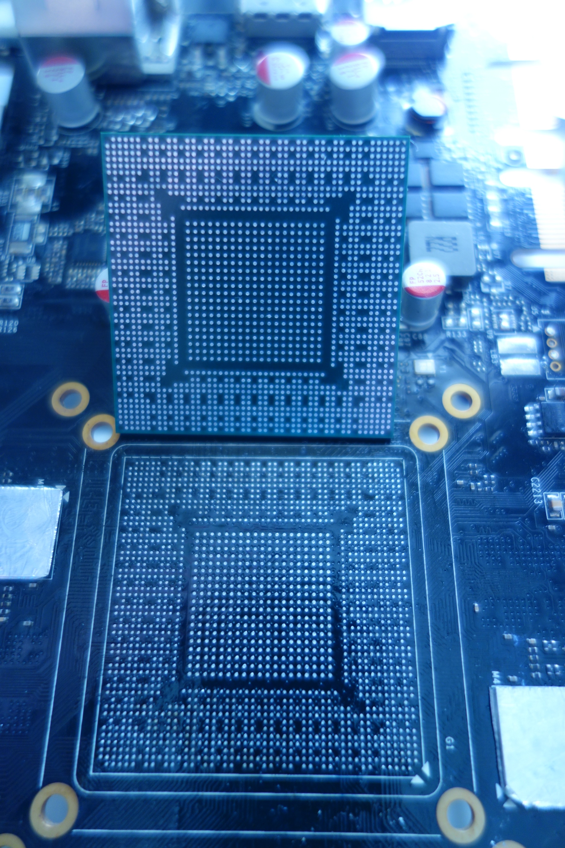

        Incidentally I have a 3870 x2 with the secondary GPU artifacting and crashing depending on the application… Main GPU still works fine funnily enough. You'd expect the main GPU to die first, but it may have to do with the cooling system: single blower over the 2 GPU, one with aluminum heatsink the other with copper heatsink. Before repasting it it was going over 90°C in matter of seconds so I didn't check anything else. Went ahead, repasted everything, cleaned heatsink, replaced thermal pads… well now GPUs seem to hover around 90°C even after a long time, but quite sad that the secondary GPU is dead.
        Will try to heat the GPU later to see if it makes any difference, I don't think it will though. I usually do 200°C for a minute or two btw, never actually reflowing as there is more chance of destroying the balls than anything. Obviously it won't fix anything, maybe just resurrect it for a few hours/days.
            From what I've seen on most of those X2 cards, it's almost always the 2nd GPU that dies mainly due to the cooling system, as you noted.
            In particular, most of these have a blower fan that blows air across the two GPU heatsinks, first through GPU 1, and then through GPU 2. GPU 1 gets the nice, fresh, cool air. GPU 2 gets the already heated air from GPU 1, and thus can't get cooled as well.
            Not all ATI/AMD X2 cards are like, but at least the ones with the blower fans seem to be.
            On a related note, I recently acquired a dead Sapphire Radeon HD4850 X2. This one has individual heatsinks and fans for each GPU. But the heatsinks are super tiny - maybe good for 40 Watts TDP each at most. A very under-clocked and under-volted RV770 GPU (HD4800 series) will still dissipate around 80 Watts fully loaded. So, it's not surprise that GPU failed at all. I haven't tried reflowing that one yet, but it's coming up on my to-do list, soon.
            I tried an HD4870 yesterday, and it was still a no-go... though that one may have other issues.
            200°C won't do anything for the ATI cards of that generation... but give it a try and let us know how it goes.
            From my personal experience with the HD4850/4870 cards, none of them came back to life until I really cranked the temperature up. Usually 220°C minimum for at least a minute. On most that I fixed, I had to heat them until the PCB was just about to start to crackle/popcorn from too much heat.
            Unlike nVidia cards with the bumpgate issue, where not much heat is required to bring them back to life (or kill them completely), ATI/AMD cards from the HD3k and 4k era will take on a TON of heat before anything happens.

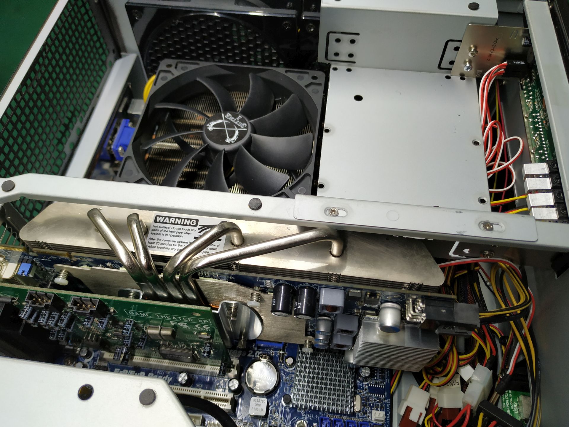

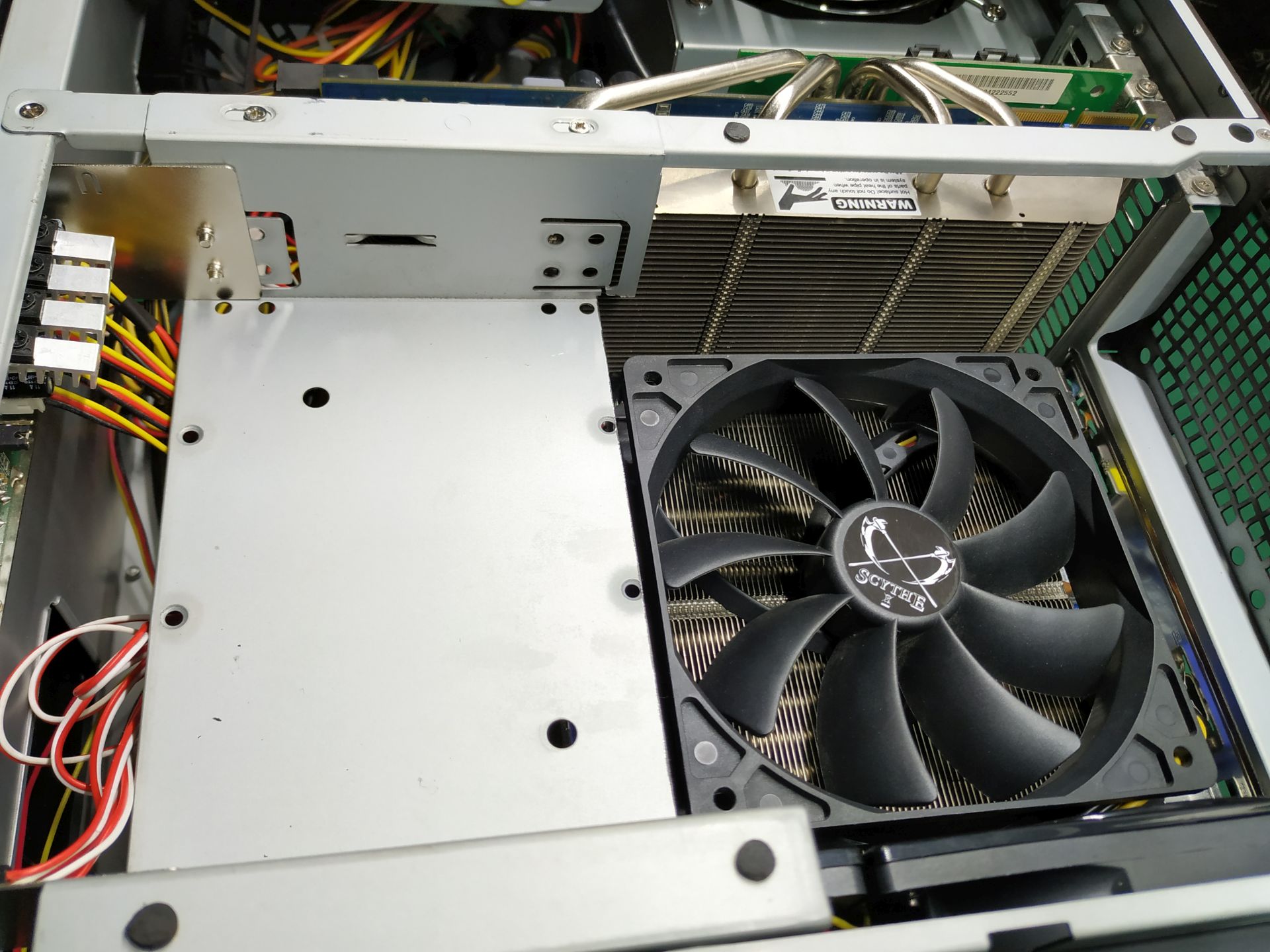

            but the working one is pasively cooled, in fact i expected this unit to fail as i expected higher working temperatures on a pasive VGA however it seems to be working just fine, i should replace the thermal paste, but after what happened to the first unit it's better to not mess with "temperamental" GPU chips.
            Passive-cooled HD3870?
            That mush have a pretty big heatsink then.
            I love passively-cooled video cards! - that is, after I put a large fan on them. Even if the fan is not so large and doesn't move a lot of air, the difference between some air movement and none is still grand. Even a tiny air movement often improves the temperatures drastically (on top of that, without any significant noise.)
              It's quite big as you can see in the photos i'm not sure if i should add a fan and connect it to an available fan channel of my scythe kaze server or take the risk of replacing the thermal paste.
                Looks similar to the heatsink on my Radeon HD7950... except mine has a fan on it. Of course, the HD7950 is rated for up to 200 Watts TDP, while the HD3870 is 106W. But with no fan and just relying on air movement in the case... I think the cooling capacity of that heatsink will be severely reduced.
                You should put a 92 or 120 mm fan on it... or a pair of 80 mm fans... and run them at 5-7V constant. This will keep them virtually silent while greatly improving the performance of the cooler. Probably won't see more than 60C under full load. Or use a controlled fan header that bumps the speed up with GPU load, and you may get even below 50C under full load with a little higher fan speeds.

                  I always put a fan on any passively cooled GPU. It makes a very big difference and actually is enough for the card to stay cool under any circumstance.

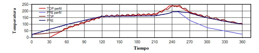

                      Today i had some time and i decided to reflow the card using the attached profile in my DIY reballing machine but unfortunately it didn't have any affect at all, it's a pitty, i guess at least i have a nice paperweight

                        u probably need higher temperatures to reflow the solder bumps between the gpu die and substrate but the risk is popcorning the gpu like momaka said.
                          IDK, looking at the results of the temperature profiles that cpt.charlie posted, it seems the GPU chip should have reached proper reflow temperatures.
                          So maybe it's just dead. Or maybe multiple reflows could get it to finally work.
                          Or yet another maybe, perhaps cpt.charlie turns out right and the RAM chips are the cause of the issue. Unless the incentive is purely to satisfy curiosity, though, it doesn't look like any further troubleshooting will be attempted. Though if you are still curious, cpt.charlie, let me know. I do have a HIS Radeon HD3870 that appears to have a dead short-circuit on the RAM Vdd power rail, and it's not the RAM. My HIS card (lol, that sounded funny) is basically a reference card. What's neat about the reference card is you can remove some jumpers to separate the RAM Vdd into two parts - the one that goes to the RAM chips and another that goes to the GPU. The one that is shorted on mine is the one that goes to the GPU chip. So it may be a bad/shorted ceramic cap somewhere. However, I suspect shorted GPU. RAM chips read normal resistance, though. So seeing that you have the tools to remove/reflow/reball BGA, if you do want another HD3870 PCB to play with, let me know.

                            Your profile is ok, but I'd go a bit slower.
                            Do you know the history of that card? Has it been reflowed maybe before you bought it?
                            If a BGA fails it's mostly the solder. Mostly, not saying it'll never be the bumps but that's rather an exception. Was more a problem during transition from lead to lead free period probably.
                            Reflowing MIGHT fix it but although it was still working that card probably already had bad solder connections. It'll only get worse over time.
                            Every heat cycle can add to it. Not only starting and shuting down but also the varities while working, iddling, working...
                            Your last test might have "cracked" it after cooling down.
                            Reflowing can even make it even worse instead of fixing it as heat = oxidizing.
                            Solder balls and/or -pads can be oxidized, still touching each other but not making electrical contact anymore due that oxydation. Air = oxygen might still reach it also making it worse when shelving it a long time.
                            Possible the flux won't get under it to remove the oxydation meaning reflowing something that doesn't take solder anymore = fail.
                            I'd reball it. Most BGAs fail on solder not internal.
                            If not fixed, can still try the memory later.
