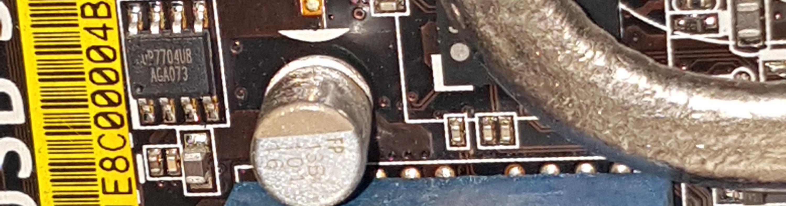

    i have this board , that doesnt detect vga card.
    But while heating a caps it boot fine.
    how can i search this cap on the market ??
    i read on it
    FP
    13bx
    101

      Re: Asus P8P67 Evo vga problem
      this is the cap
        Do any of the solder joints on that cap look bad?
          I see a heatpipe next to that cap. Are you sure that heating the NB/SB heatsink (whichever this heatpipe connects to) also won't make the board start?
            The cap looks like a 100µf 16v conductive polymer (nichicon)
              its a 100µf 16v i asked to aswo and i have ordered it
