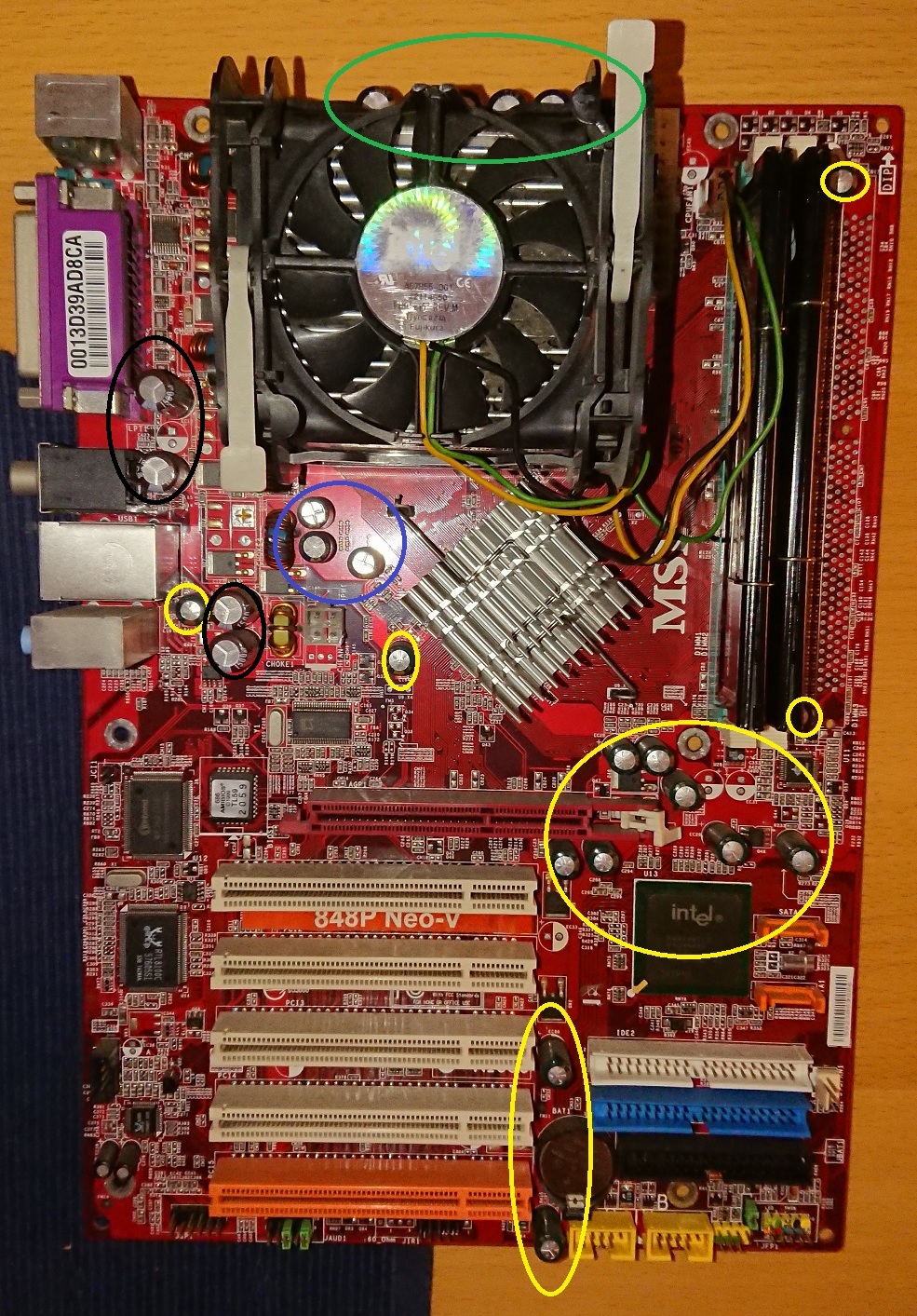

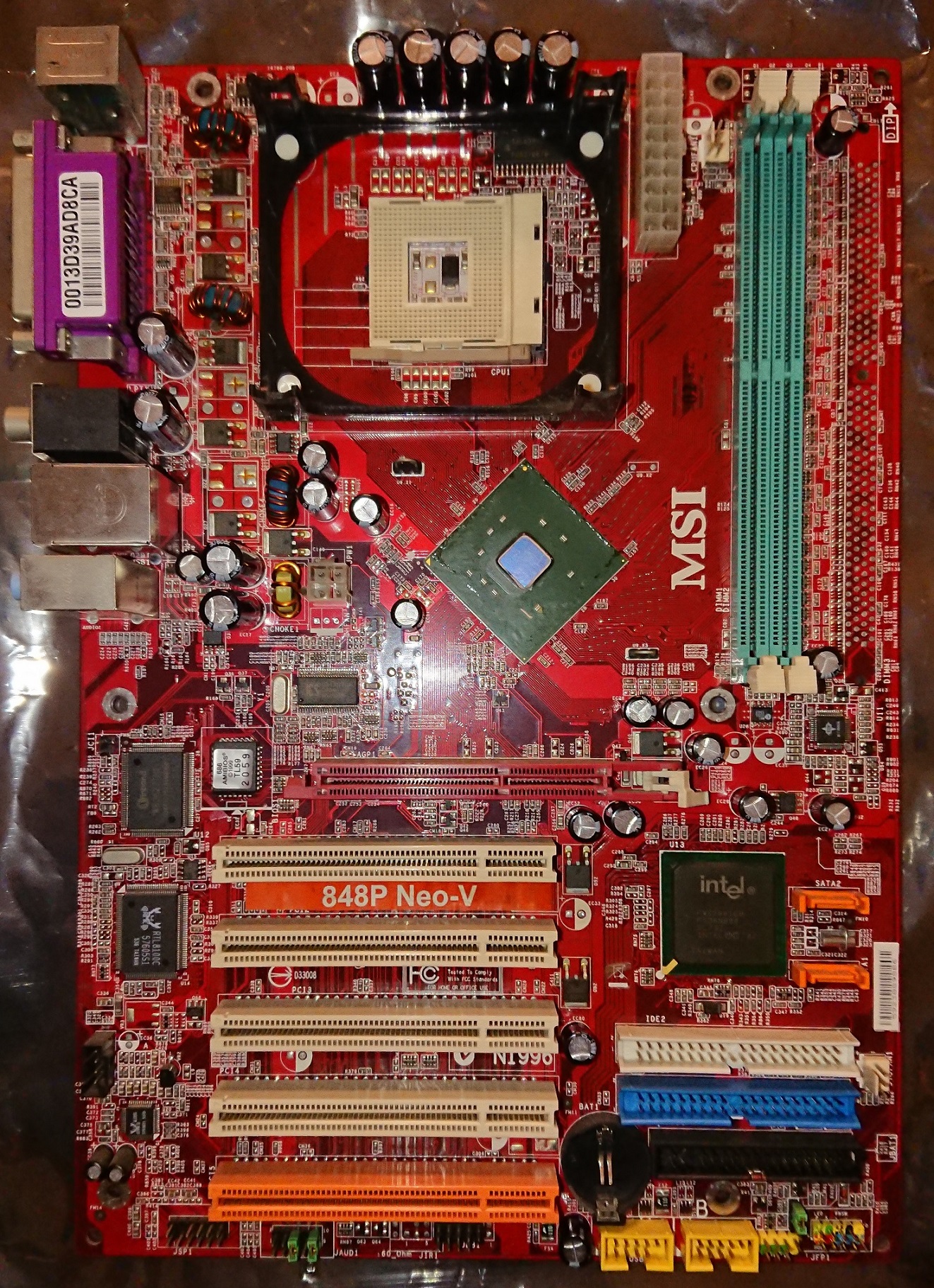

    I just recently got an MSI 848P Neo-V board, that I was planning to use as a basis for a P4 retro PC (due to a competent BIOS in terms of handling IRQs and PCI DMA through DDMA), and as soon as I got it I noticed that most of the caps had started bulging, no visible leaks though. The board POSTs perfectly fine, but I really don't feel like using it for any length of time with clearly bad caps.
    I have never (I know, I'm ashamed to admit it as a lover of old PC hardware) re-capped a board, and it's all a bit overwhelming. What I have done is find out what caps are on the board;
    Yellow: 13x1000uF, 6.3V (Teapo, SM series?) - all of them bulging
    Blue: 3x1500uF 6.3V (OST, RLX series) - one of them bulging
    Green: 5x3300uF 6.3V (OST, unknown series - can't see any markings) - none bulging
    Black: 4x1500uF 16V (United Chemi-Con, KZG series) - none bulging
    Plus 2 100uF 16V caps of unknown make - due to their size I'm not really looking to replace them though.
    And I've ordered a few replacements (only for the series' bulging so far, i.e. the ones marked in yellow and blue), what I didn't consider at the time of ordering was the ESR values. I don't have equipment (planning on handing it over to a local repair shop experienced in computer solder work, they don't supply their own caps though) to measure it, and therefore ordered caps I thought would be an ok replacement. I'd love some thoughts (and potential replacements for the ones marked in green and black) - unfortunately it's not too easy to find good suppliers here in Sweden, so I'll throw the main options I've found out there!
    Replacements;
    Yellow: 13x1000uF 6.3V (Nichicon, VZ Series - UVZ0J102MPD) - ordered and received
    Blue: 3x1500uF 6.3V (Rubycon, ZL Series) - ordered and received
    Green: 5x3300uF 6.3V (Nichicon, VZ Series - UVZ0J332MPD) - not ordered yet
    Black: 4x1500uF 16V (Nichicon, PW Series UPW1C152MHD) - not ordered yet
    Are these decent options? (I know the Rubycon ZL's should be, as I've seen them mentioned in a ton of places here. ^^) If not, any suggestions on alternatives, preferably available from a Swedish/Scandinavian supplier? I'd of course prefer to use the VZs I've received if at all possible, as well.
    I'm not looking to push the 3GHz Prescott higher than stock in terms of clocks and voltage, and I'm planning on using 2xCorsair CMX512-4400C25 (specced at 2.75V), an FX5700 (again, stock specs) and a couple of PCI cards.
    Using a known working (albeit not a high quality - might replace it soon) Corsair CX400 with low mileage to run it.
    Thanks a LOT in advance for any input!
    /Chris

    sorry to be a party pooper but none of the caps u bought already are suitable nor will they fit.
    the nichicon vz series u bought are general purpose caps and their ripple current rating of 390 mA RMS are unsuitable for motherboard use. the 1000uF general filter caps on motherboards typically need a ripple current rating of around 1000 mA RMS or so and they will have to be at least of the low esr or low impedence type with high ripple current rating.
    the rubycon zl series u bought are the wrong size. the ost rlx caps there seem to be 8x20 mm in size and the rubycons zl caps are 10x20mm in size. u bought caps that are too fat and they may not fit in there as there are two caps situated side by side with each other on the board.
    the teapo sm caps should be replaced by 820uF 6.3v panasonic fr, rubycon zlh or chemicon kzm 8x11.5mm caps. the drop in capacitance wont cause problems for general filtering of the minor rails.
    the 1500uF 6.3v ost rlx caps should be replaced by panasonic fr, rubycon zlh or chemicon kzm 8x20mm caps again.
    the 3300uF 6.3V ost caps are used for the cpu vrm output and the only replacements available are 2700uF 6.3v caps from panasonic fr, rubycon zlh or chemicon kzm in 10x23mm or 10x25mm size. the decrease in the capacitance *could* affect overclocking of the cpu but since u said u arent overclocking, this wont be much of an issue.
    the 1500uF 16V kzg caps are a problematic series as well and they are used for the cpu vrm input. replace them with 1500uF 16V caps from panasonic fr, rubycon zlh or chemicon kzm caps in 10x20mm size.
    you may also have heard of the term "polymodding" if u have been reading around this forum but i have to say this board is not suitable for that as i see the blue vrm coils around the cpu having many turns on them which means the cpu vrm design uses a low switching frequency and therefore prefers high capacitance rather than ultra-low esr. u are also using a prescott cpu which is known to run hot so the cap series i stated above are 6000-10000 hour caps which should last the longest under the heat of the cpu.

                    Got it back today (22nd of feb) with new caps (Panasonic 105C FRs) soldered on, and I gotta say I was pretty impressed with the solder work (to my untrained eye at least) - leads look nice and short on both cap and flip side of board, no excess/lack of solder, no visible heat damage anywhere, no stray solder... and it boots up and seems to be working fine!
                    I'm really grateful for all the input, thanks again!
