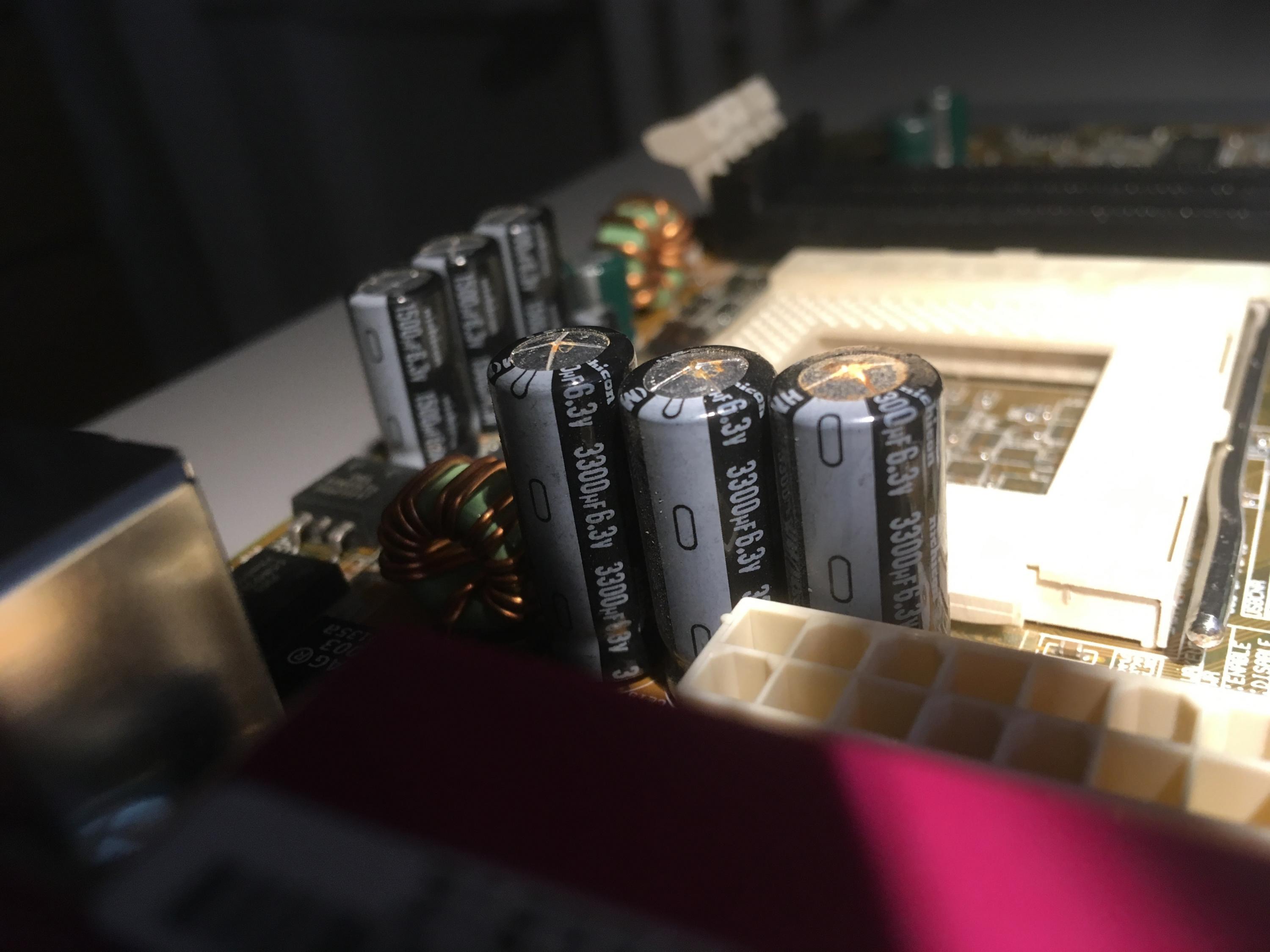

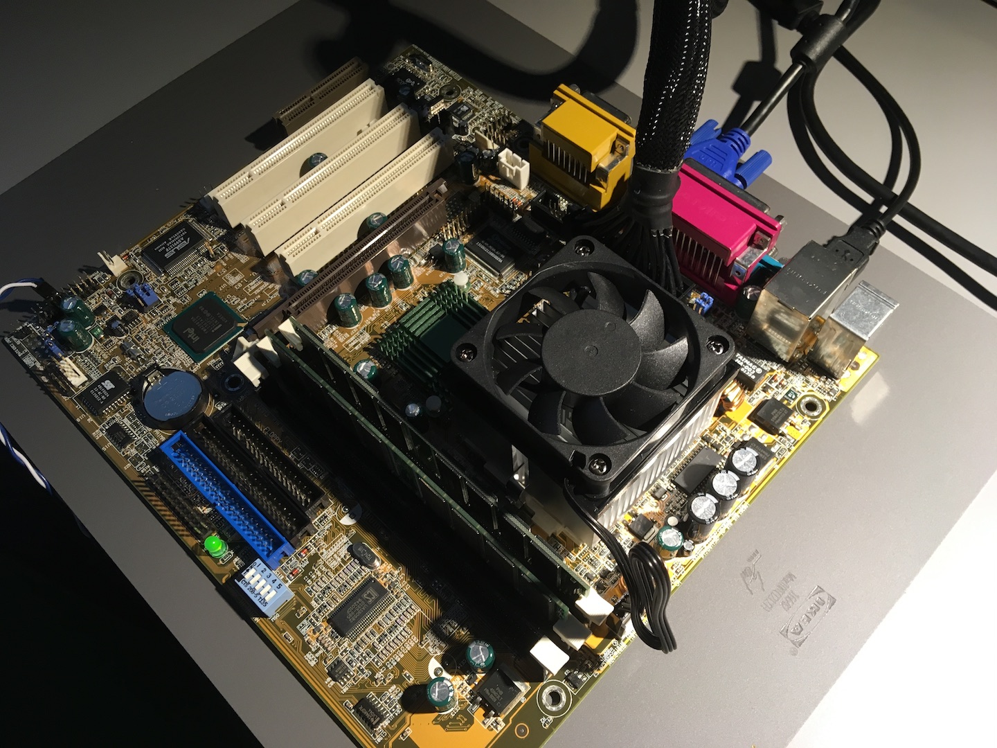

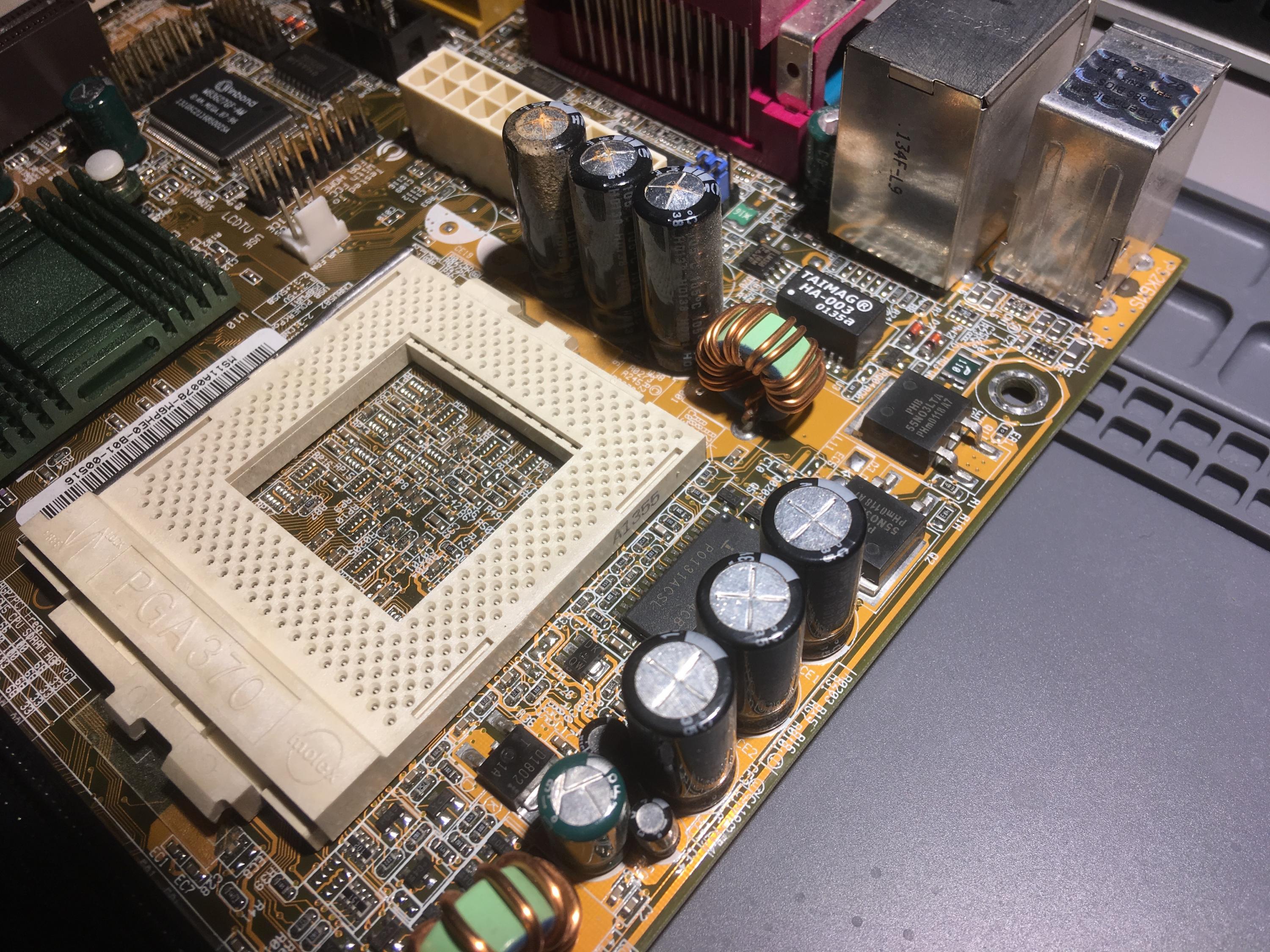

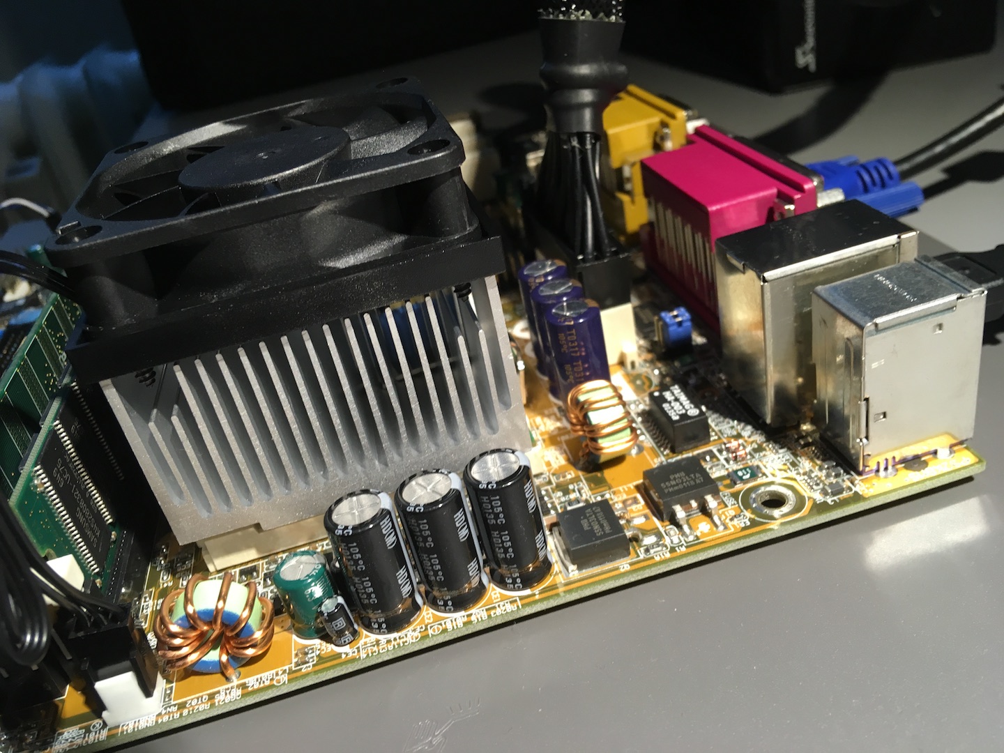

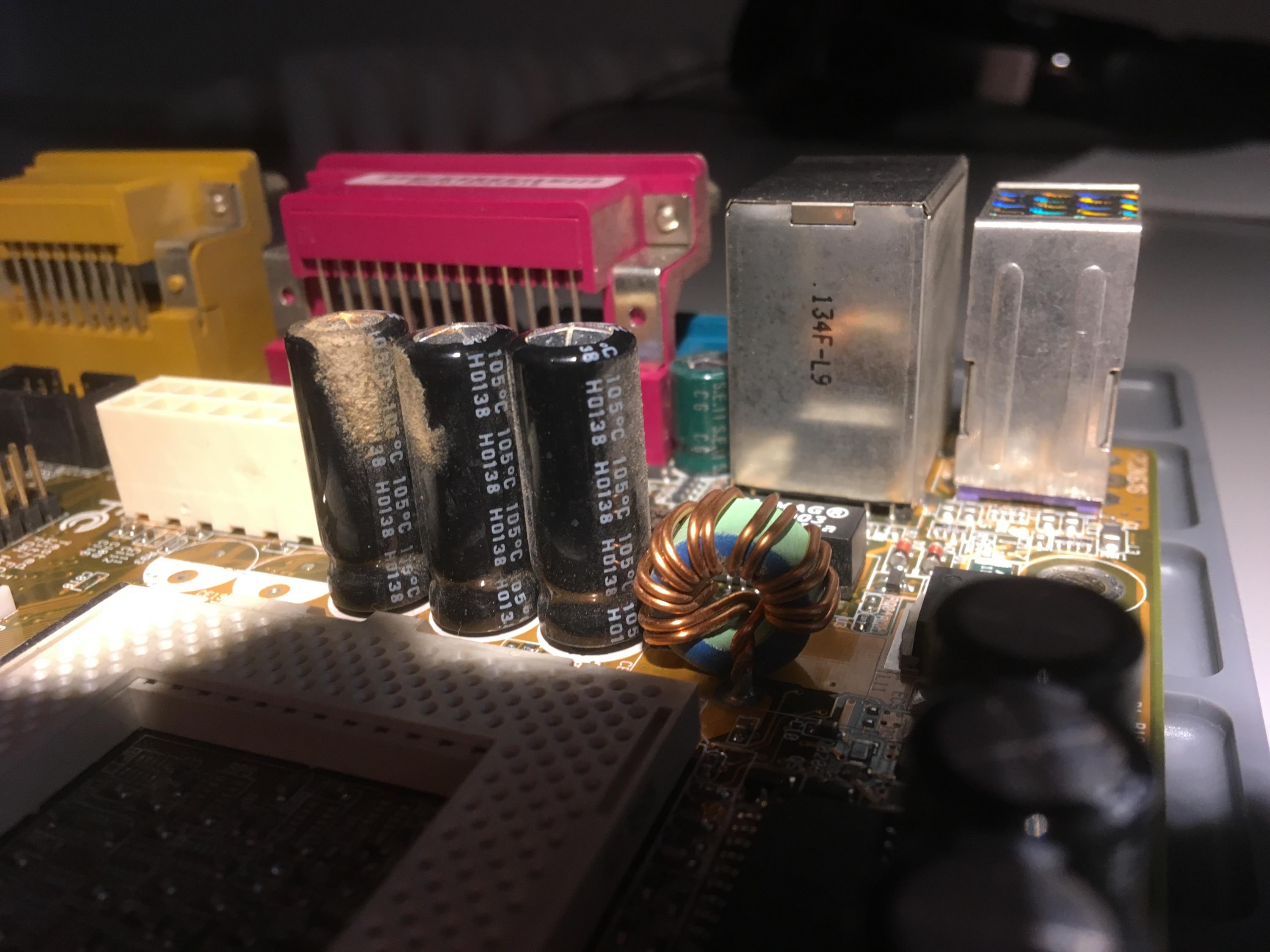

    Hi everyone, I need your help with finding proper capacitor replacements for this quite rare board which I got recently. 3 caps are obviously bad, but board still works. I'm not sure if I should replace also 3 on the other side which looks good. This is my first MB capacitor replacement job.

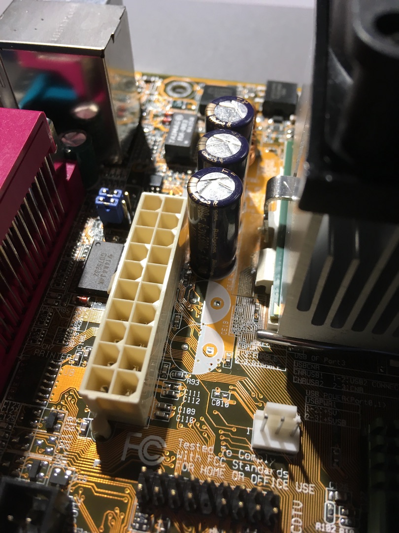

    Bad caps:
    Nichicon HM(M) H0138 3300uF 6.3V

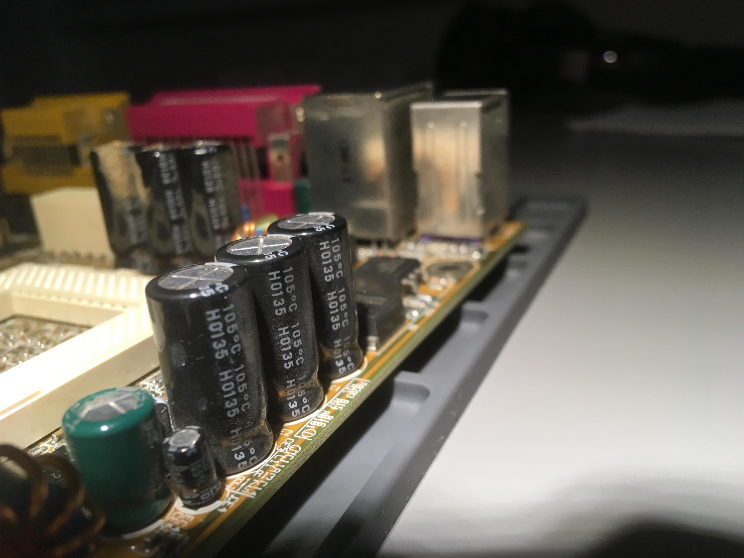

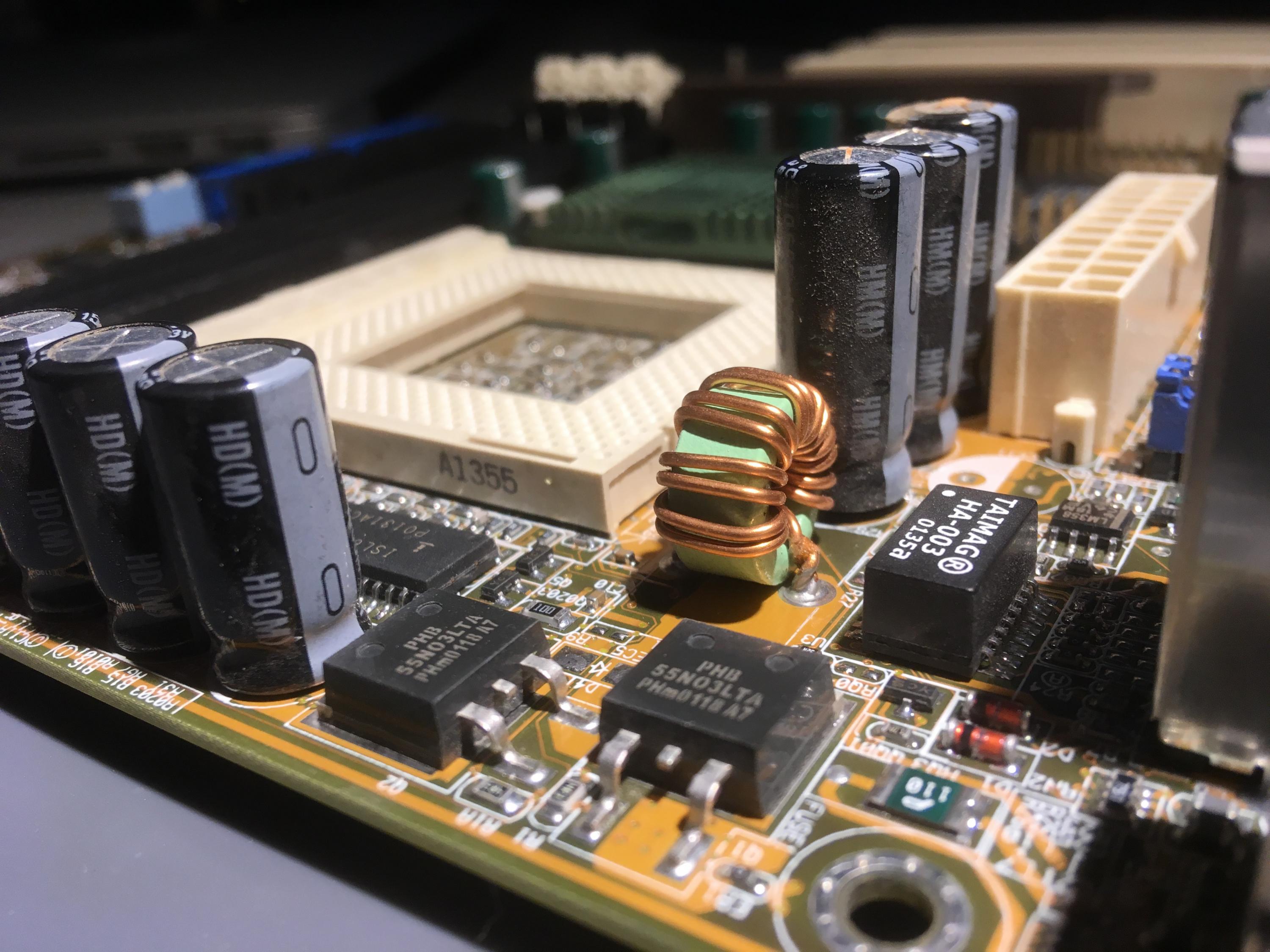

    Caps not sure if I need to replace:
    Nichicon HD(M) H0135 1500uF 6.3V
    I'm from Central Europe so I'm pretty much limited to ebay to buy high quality replacements.
    Thank you for your help.

    The three defective capacitors on your board are made by Nichicon. The company had a batch of defective capacitors from 2001 through 2005 affecting their HM, HN, and HZ series. The 6.3V, 3300 uF ones you have appear to be HM series from 2001 (as indicated by the H01xx date codes). All three of these capacitors should be replaced.
    Meanwhile, the 6.3V 1500 uF Nichicon HD capacitors are not affected from this problem. However, since this board is rather old now, it may be a good idea to replace all of the electrolytic capacitors. Of course, this will also depend on what you need the board for. If it's a critical task (like running an expensive machine), then you should replace all the caps. Otherwise, you can get by just by replacing the Nichicon HM capacitors and maybe the Nichicon HD capacitors, just in case (Nichicon HD series are fine in general, but still not as reliable as other brands with equivalent specs, like Rubycon ZL, for example).
    For replacements of the Nichicon HM capacitors, you can use Nichicon HM again, but just with a newer date code (ones made after 2005 are not affected by this issue). Nichicon HN or HZ will also work. Or, if looking for another brand, Rubycon MBZ and MCZ are directly equivalent to HM and HN above. But because this is an older motherboard, even series like Panasonic FM and FR should work okay.

    Also, DO NOT use your motherboard with the bad capacitors like that, even if it appears to work fine, as this can cause damage to the MOSFETs, RAM, and sometimes even CPU. Turn off power to it and wait until you replace its capacitors.

      Board will not be used much. I want to keep it mainly for preservation purposes. I bought it very cheaply with 1.4Ghz Tualatin P3. So it's probably enough to replace just those 3 for now. The rest of bigger caps on board are made by Sanyo. These 6 are only Nichicon brand ones I was able to identify.
      I will definitely ask Behemot and try to search elsewhere for replacement you have suggested. Thank for the warning about eBay, I was already little suspicious.
      Board is already disconnected and waiting for the repair. The only reason I know that it works is that I bought it as a fully functional machine and I have discovered bad caps right after initial testing.

            Success story here!
            Nichicon HM caps were replaced with used Rubycon MBZ provided by Behemot.
            Board is now water cleaned and works perfectly! Good as new.
