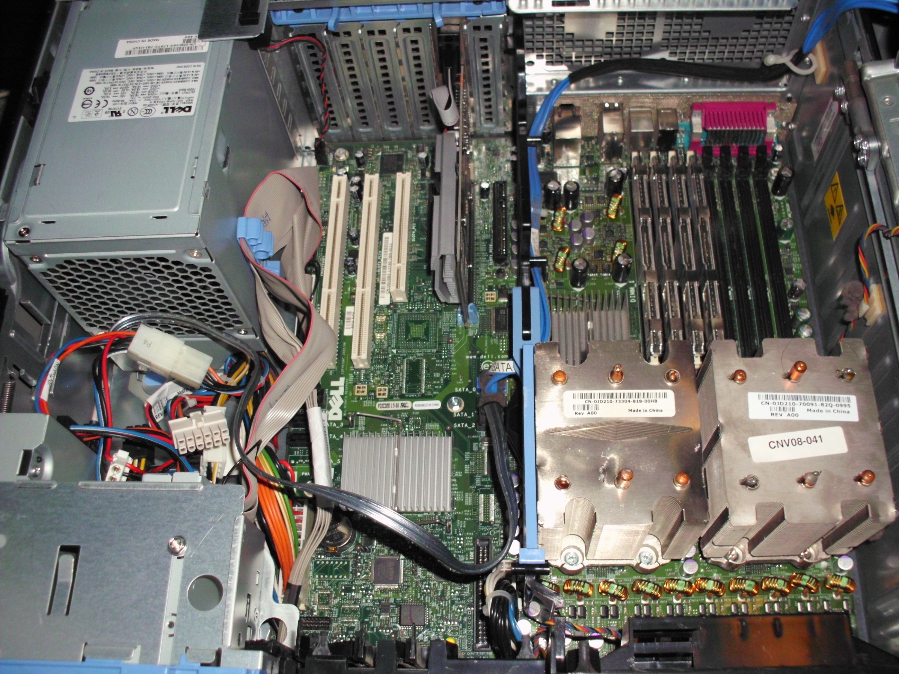

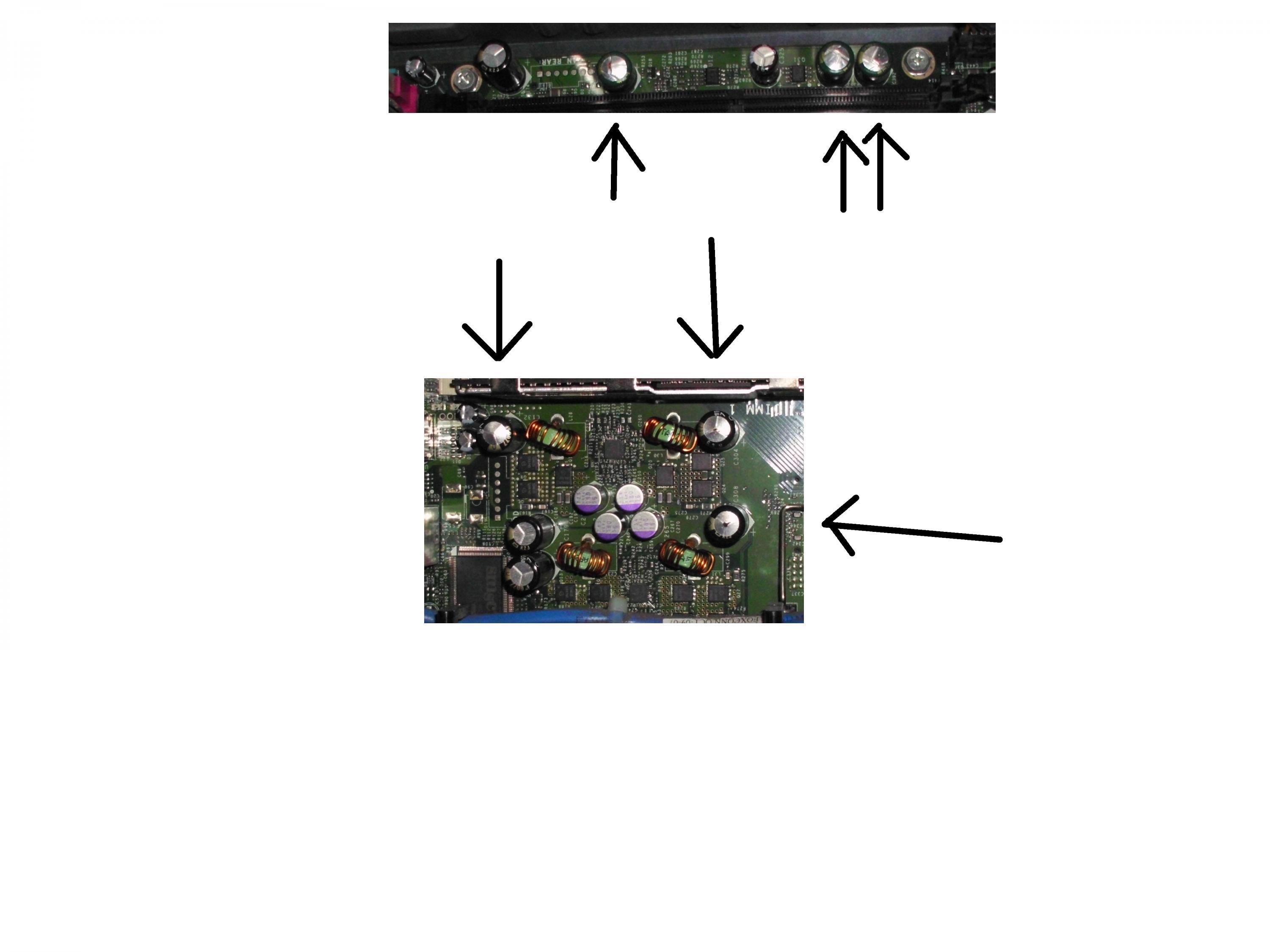

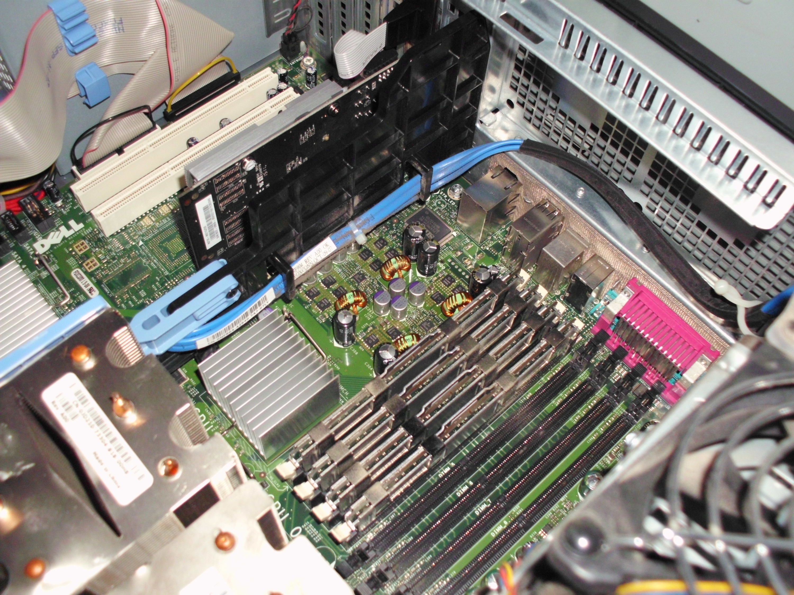

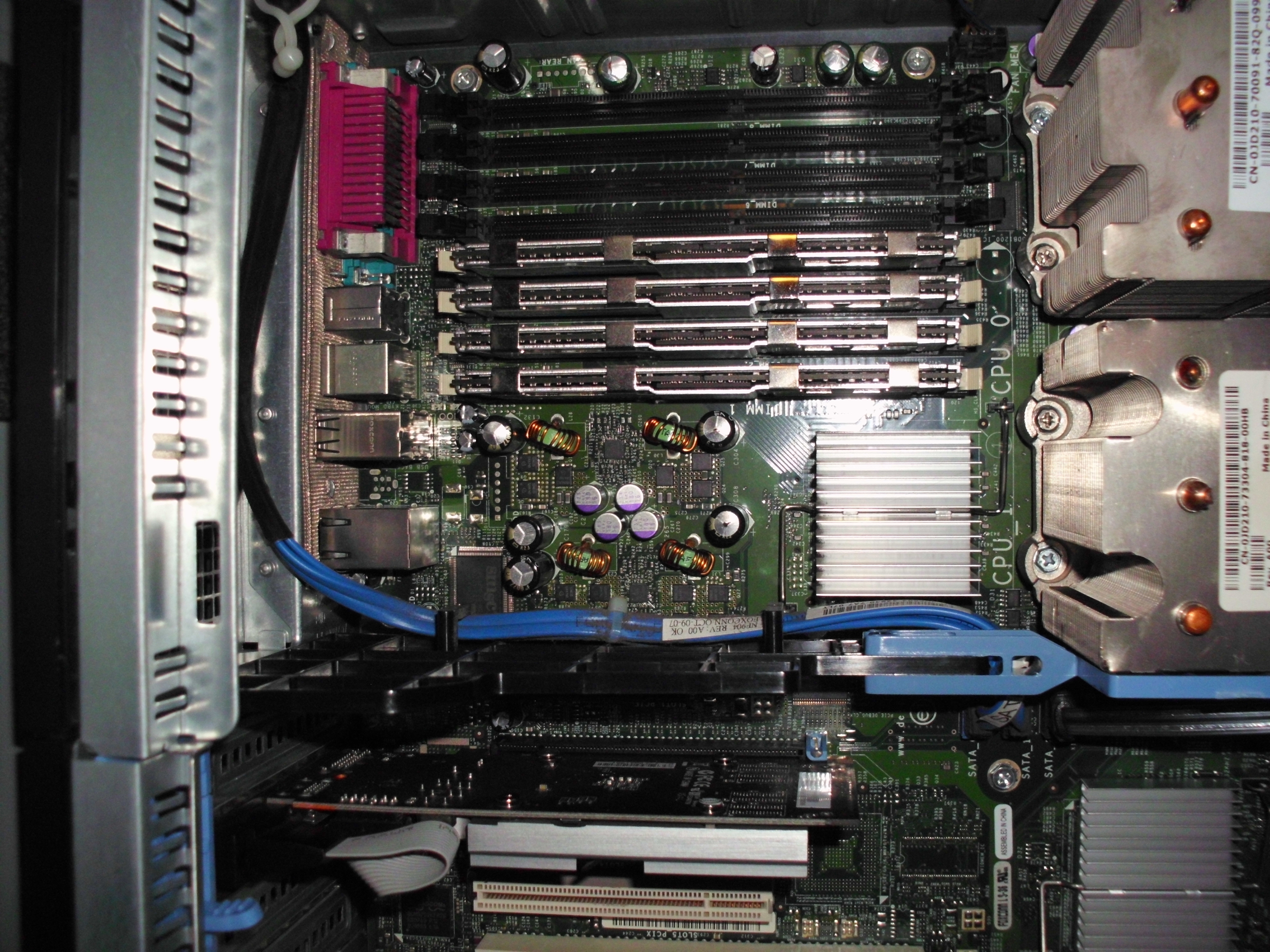

    I have some bulging caps here
    3 KZJ 2200uf 6.3v, these are the gold caps https://cdn.badcaps-static.com/pdfs/...8ea064adf5.pdf
    i can not tell what the green ones are (edit: sanyo 1500uf 6.3V WF series https://www.badcaps.net/forum/attach...7&d=1313180606 )
    Should i replace them with ones that can handle a higher voltage?
    What should i replace them with?

        I think I managed to find very close electrolytic caps
        Do those look like good replacements?
        With the WF caps I am only changing the bulging ones (all 3 in the 490 and 2 of 6 in the T3400)
        With the ZKJ caps I am replacing all of them, bulging or not (6 in the 490 and 7 in the T3400)

          I'd also look into the cooling for those FB-DIMM's
          They run very toasty so might be what killed those Sanyo caps...

            Sanyo’s (Suncon) WF series is failure prone, especially whilst under thermal duress. It’s debatable that heat killed them, but KZJ is a known dud series too and have also failed in these toasty machines. FWIW, those Precision 490 (and 690) boards use MCZ, KZJ, and WF interchangeably in the position that those 1500uF 6.3V caps are in, and thus far I’ve only seen WF and KZJ go bad there. Those T3400 machines (and all Dell motherboards that have a similar layout) also use KZG, KZJ, MCZ, HM (post-2004 datecodes), FL, and WF interchangeably for the 820uF 6.3V caps, and I’ve only seen WF and KZG bulge so far (haven’t seen a 820uF 6.3V KZJ bulge anywhere but in a USFF Dell, but I’ve seen quite a few of them go high ESR with no signs - the larger diameter and/or taller 6.3V KZJs OTOH are more prone to bulging).
            Your replacements look good.

                If two of the six have bulged, the other four may not be far behind. Any capacitor can fail without symptoms, so preemptive replacement is sound.
