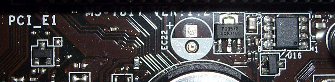

    I have a troublesome motherboard. It will not start. PSU I believe is OK, and have swapped for like PSU and system still fails to power up, leading me to believe its a motherboard fault.
    No activity from power switch invokes the PSOK/PON line on the ATX.
    If I short the ATX green line to GND (for PON), the CPU and PSU fan spin briefly, then stop. There is a constand 5VSB line from the PSU into mboard.
    It is very difficult to trace anything on the mboard, but I have found what I think are two suspicious things;
    1) the 3.3v lines on the ATX connecter on the mboard all seem to be grounded - the 5V and 12V lines are not - I assume this is incorrect.
    2) I have found a SOP-8 chip that seems to have two grounds, one on pin 5 which is correct, and also on pin 7, which is supposed to be the VOut - I assume this is incorrect? This is close to the USB pin outs section.
    I dont think the two can be tied together - a vout and 3.3 line in would compete, so is there something common that could link the two which could be grounding them?

        Can you take a picture of the SOP-8 chip and its surroundings? What is its part number?
        What is the actual resistance you measure between this Vout and ground, and between the 3.3V line and ground?

          As for the SOP, its by the realtek, and I have removed it, and tested pins and the two are not grounded to each other when off the mboard so I dont believe the realtek or this sop8 were at fault. I cant recall the sop8 ID so would need to have a look at it again, but this doesnt seem important now
            Re: Ms7817 (msi h81m-e34)
            The sop8 was a uP0104S pgp51w. It was pins 8 and 6 grounded not 7 and 5 as previously mentioned

              I have a H81M-E33 which is a MS-7871 ver 1.2 which won't start.
              Installing a PCI-E post card, no 3.3vsb was present.
              If you look at p24 of the schematic you'll see pin 6 and 8 are grounded. You'll also note that it shows that U16 has 9 pins not 8 - pin 6 is listed twice.
              On my board, tracing from the 10K resistor then pin 6 should be Vout.
              My board is also missing EC22 (see attachment0 and the pads for this are shorted too.
              Can't find a datasheet for up0104s.

                  U16 has 9 pins not 8 - pin 6 is listed twice..
                  Or 9 is the pad on the back

                    If +3VSB is shorted it's usually the Ethernet controller.
                    Check if it's heating up.
                    Otherwise, inject voltage, and search for the component that's heating up.
