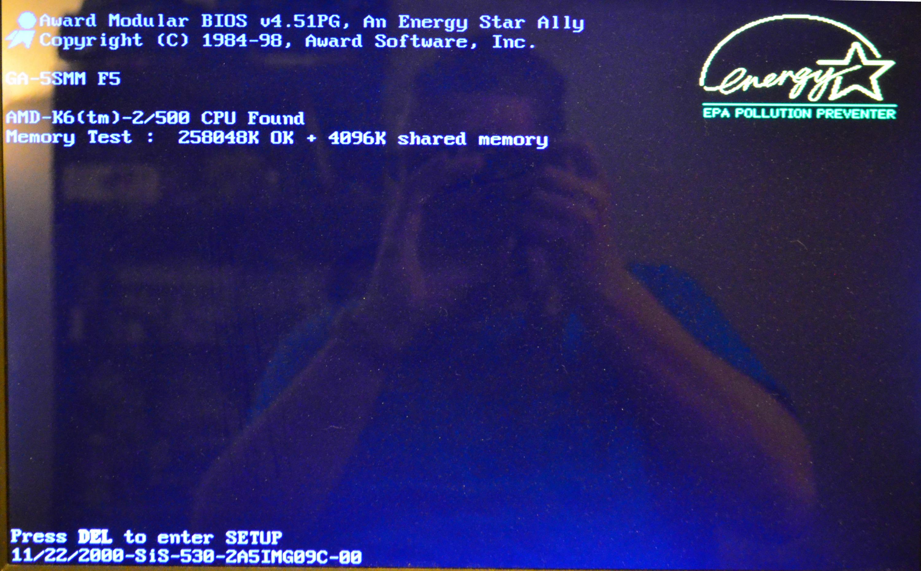

            Honestly you've probably already tried everything I'd recommend. I happen to have one of these old boards and I had a similar issue with a bad stick of ram, but if you've already tried multiple sticks of RAM that should rule out that issue. Incorrectly set DIP switches and jumpers are also a common issue on old boards like these, but it sounds like you already checked that as well. If you haven't already it might be worth wile to try cleaning the RAM slots and any PCI/ISA slots you are populating with a cue-tip and alcohol or contact cleaner (the same for the contacts on the sticks/cards as well). Also note this board uses CHOYO which are known for being problematic and failing without bulging so bad caps is a possibility.
            If the battery leaked on the board causing corrosion it is also possible it may have caused some damage.
            Aside from the so-so caps and lack of AGP slot this a decent board capability wise for a MATX board of its era if you are building a retro system since it is
            MATX form factor (AT was still common when this board was new), has 3 PCI and 2 ISA slots, 3 RAM slots and supports AMD K6-2/K6-III (I have a K6-2 500MHZ in mine and 512 MB RAM) CPUs in addition to Pentiums and the original K6, but as Caspian noted unless you are going to run Windows-98 or earlier on it and old software/games that won't run on newer hardware, you'd be better off picking up one of the many P4 era (or even Core2Duo these days) boards that are going for next to nothing these days.
