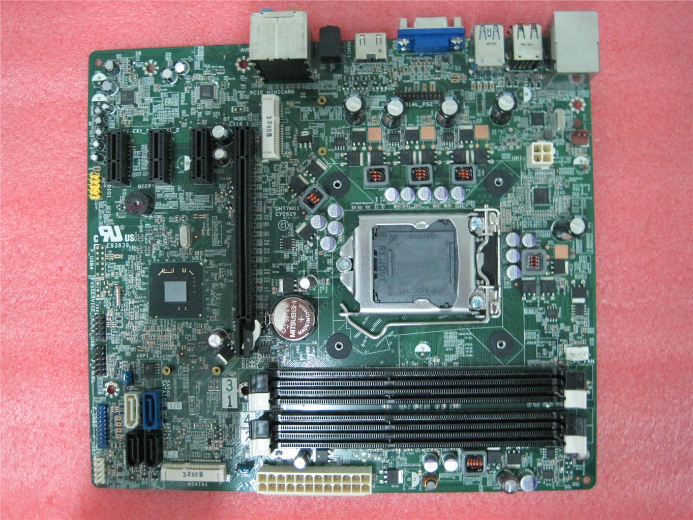

    Hi All and Happy New Year
    I friend left his Dell PC at home to check out a boot, POST problem
    Does anyone know of any known issues with capacitors on a Dell XPS 8500 motherboard capacitors?
    I took a look at them and they are KGZ series. I ask about as this unit is not booting properly and is always giving memory errors, installing a brand new memory module did nothing and it posted properly at will with its original memory set.
    A search produced no results. Oh and it is a 2012 model.
    Thnk You.

    Re: Dell XPS8500
    KZG is a known bad series of capacitors from United Chemi-Con, so probably you read the text wrong (KGZ doesn't exist).

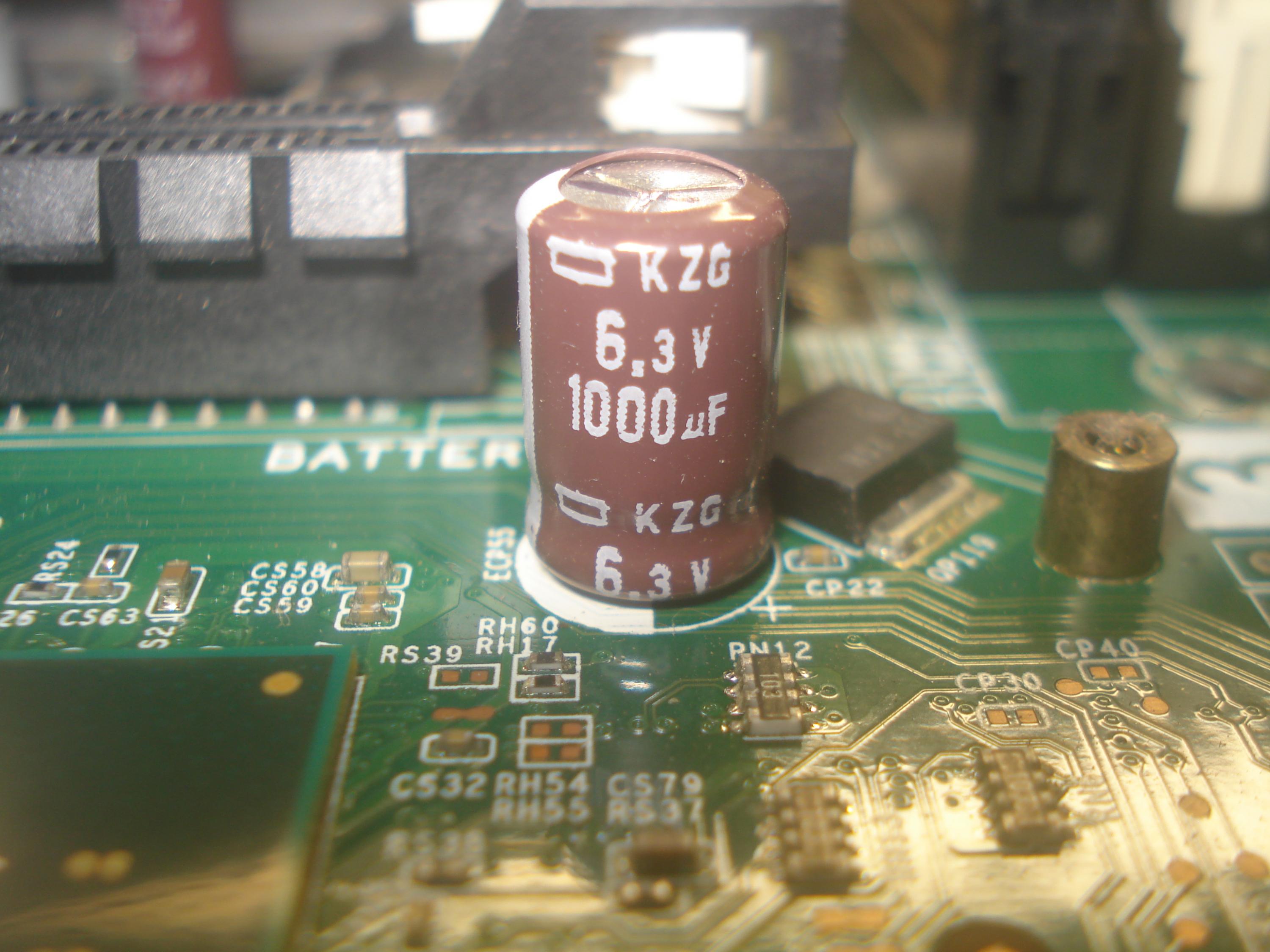

        Re: Dell XPS8500
        Today took off the motherboard to do a recap but something is off. A 6.3v 1000uF KZG. Could be a typo on the label or a batch of fakes.
        I cannot find the value on the data sheet for this series type

          Re: Dell XPS8500
          It's common for large customers to order custom capacitors, so they are probably not fake.

            Re: Dell XPS8500
            Probably not a counterfeit (not that it would matter much with the dreaded KZG series. ). See the attached engineering draft.
