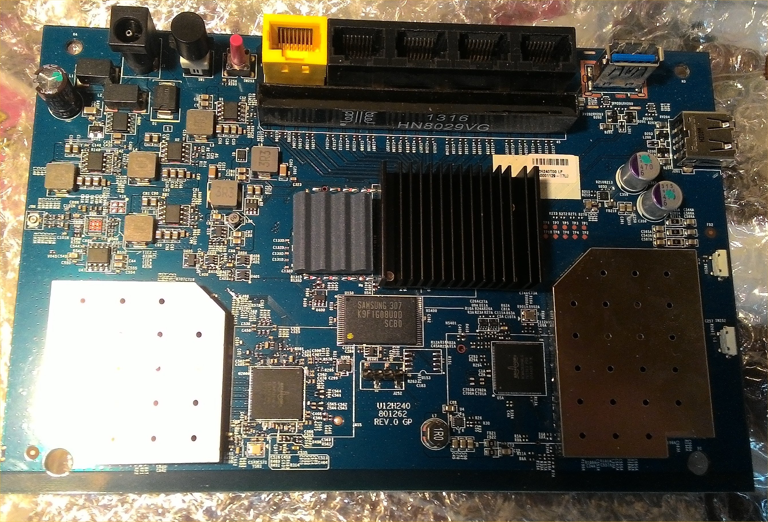

    i picked this router up at the local goodwill for $4, brought it home and tested it out, seemed to work ok, so I flashed it with the recommend Kong build of dd-wrt, still working good.
    I then unplugged it to move it to another location and when I plugged it back in it was bricked. Completely unpingable.
    Tried a different power brick with similar ratings from another working router and it made no difference.
    Took the router apart and hooked up a serial connection and there was no output.
    I unplugged it for a while and then plugged it back in and it started working again. Worked great for several hours, so I thought maybe dd-wrt was causing some issue when powering off,
    so I flashed back to the stock Netgear firmware and then did a factory reset for good measure.
    Turned the router off and then back on and again bricked.
    I leave it unplugged for a while and it works again until the next time it's turned off.
    I only see 3 caps on the board. 1 330uF 16v near the power plug and 2 solid caps that I think are 470uF 6v on the opposite corner of the board.
    None of them look like they are bulging or leaking, but I know that doesn't necessarily mean that they are good.
    Does the symptoms this router is having seem like the caps are likely the problem?
    Maybe something else in the power section?
    thanks

        Re: Netgear R6300v2

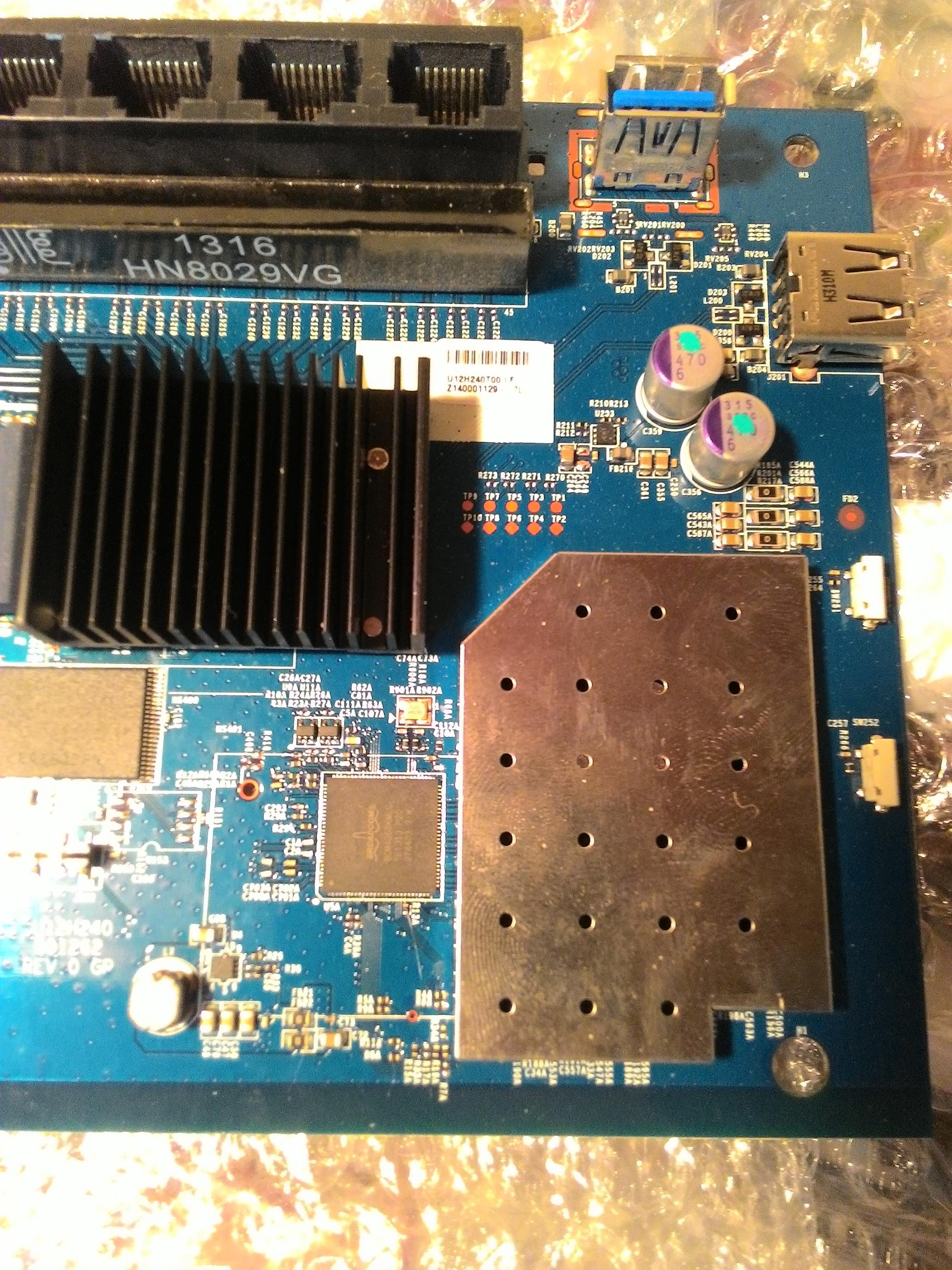

        The silver caps with purple are Sanyo SEPC - a high quality series of polymer caps, so it's unlikely those are the cause of the issues.
        Meanwhile, the brown cap show in this picture...
        https://www.badcaps.net/forum/attach...7&d=1514693903
        is made by United Chemicon - another popular good Japanese brand. That said, they did have a few series that are known to go bad and these are the KZG and KZJ. On the other hand, series like KY, KYB, KZE, KZH, and KZN are very good. So depending on which series of Chemicon you have for that cap, that may or may not be the source of issues.
        Other than that, I can't say what could be wrong with the router.
        Maybe the main chip under the heatsink has bad/weak BGA? Maybe the RAM itself is going bad? Or it's possible that even the Flash memory chip (that holds the firmware) is starting to go bad. Unfortunately, I don't have any tips on how to troubleshoot the router to test the above items. I'm hoping that someone else does, though.

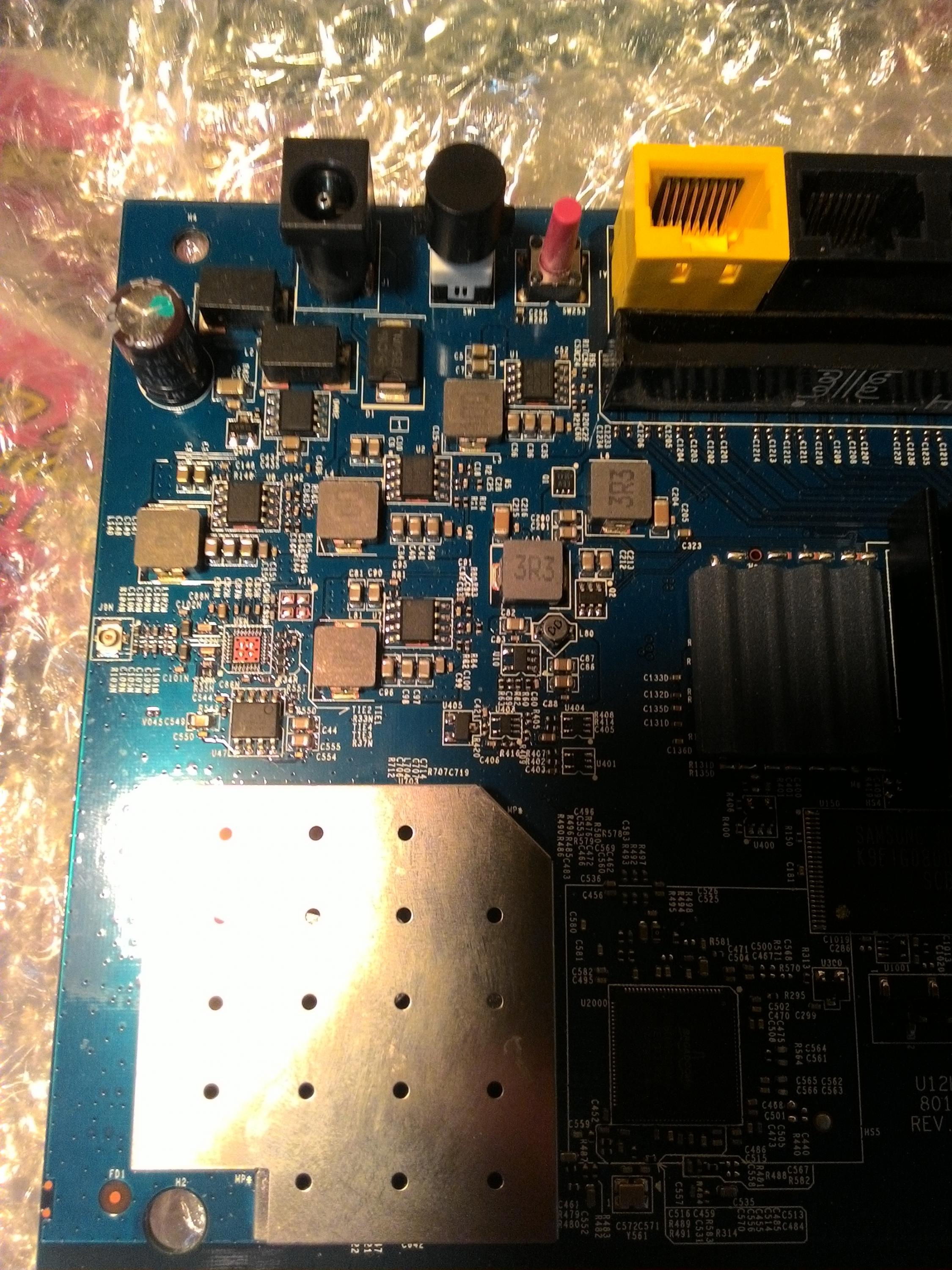

            I replaced the 330uF 16v cap with a Panasonic FM series and it made no difference.
            The router had been running for 3 days strait streaming content to a HDTV without a hiccup, then I unplugged it and replaced the cap and it is now bricked again.
            I'll keep messing with it and it will eventually come back to life.
            I hate to throw away a AC class router, but I don't know what else to try.

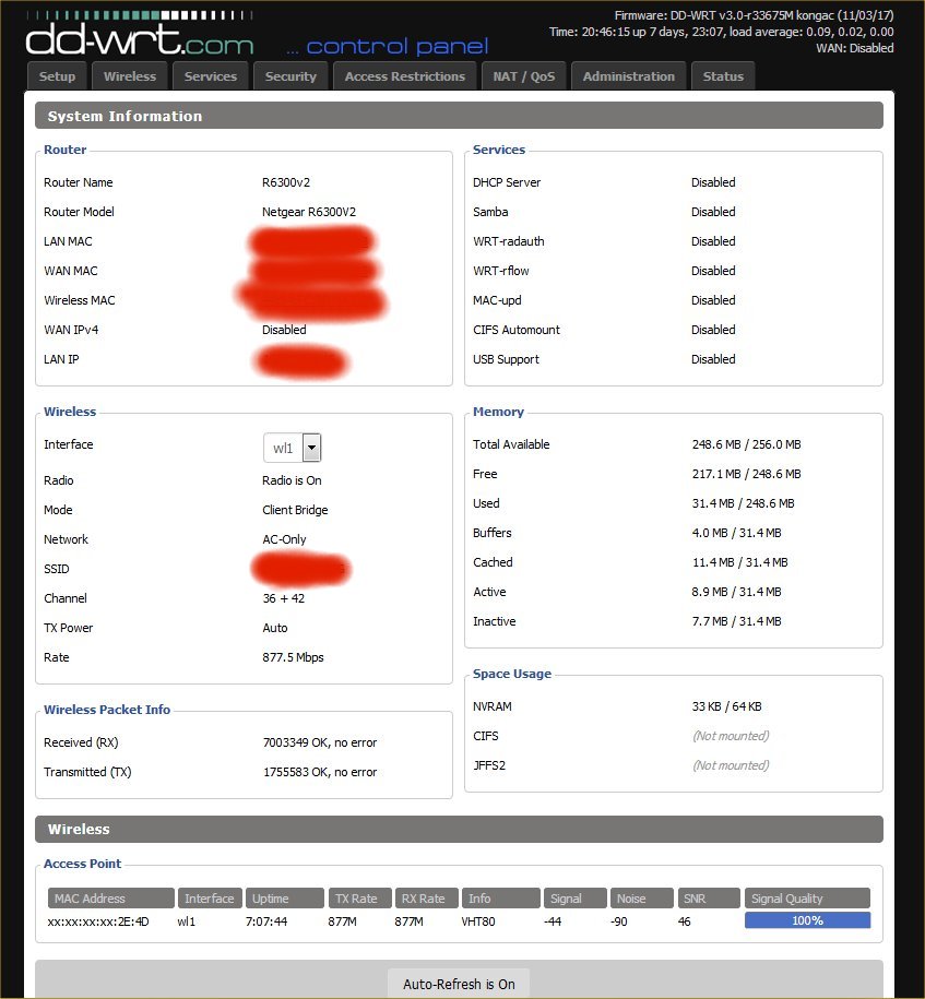

                                  In my case it's not that it needs rebooted, but the exact opposite. When I mess around with it and finally get it to boot up it will run flawlessly for however long it is powered on.
                                  If I unplug it or powercycle it with the on/off button it bricks every time.
                                  To get it to come back on I have to mess around with plugging/unplugging it while waiting 10-30min in between..sometimes it takes all day of doing this before it will come back to life.
                                  Attached is a pic..Almost 8 days uptime with 0 errors., but if I was to go turn it off and then back on it would brick.
                                  I did replaced the 330uF 16v cap near the power plug with a Panasonic Fm, but I didn't replace the solid caps on the opposite corner of the board..Should I try replacing those?
                                  thanks

                                        I'm not sure exaxtly where to test voltages at, but at the 330uF 16v cap, near the power plug, I get 12v when plugged in and power button off. It drops to 11.7v when power button is on while bricked and 11.6v when powered on and not bricked.
                                        These voltages seem about right?
