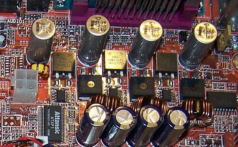

    Hi All,
    I recently purchased a used Abit NF7 with AMD 2.0 ghz as a backup board for a Shuttle AN35N-Ultra I was having trouble with (that's another story, down the road). The NF7 wouldn't boot. No speaker code beeps. No spinning of fans. It has two LED's, a red one to denote power is getting to board, and a green one to denote it is booting(I think). Only the red one lights up.
    The power supply is new. An Antec Earthwatts 650 (which is currently powering this post message) The processor is good (is running to post this message). All hardware connected to the NF7 at attempted boot time was in good working order.

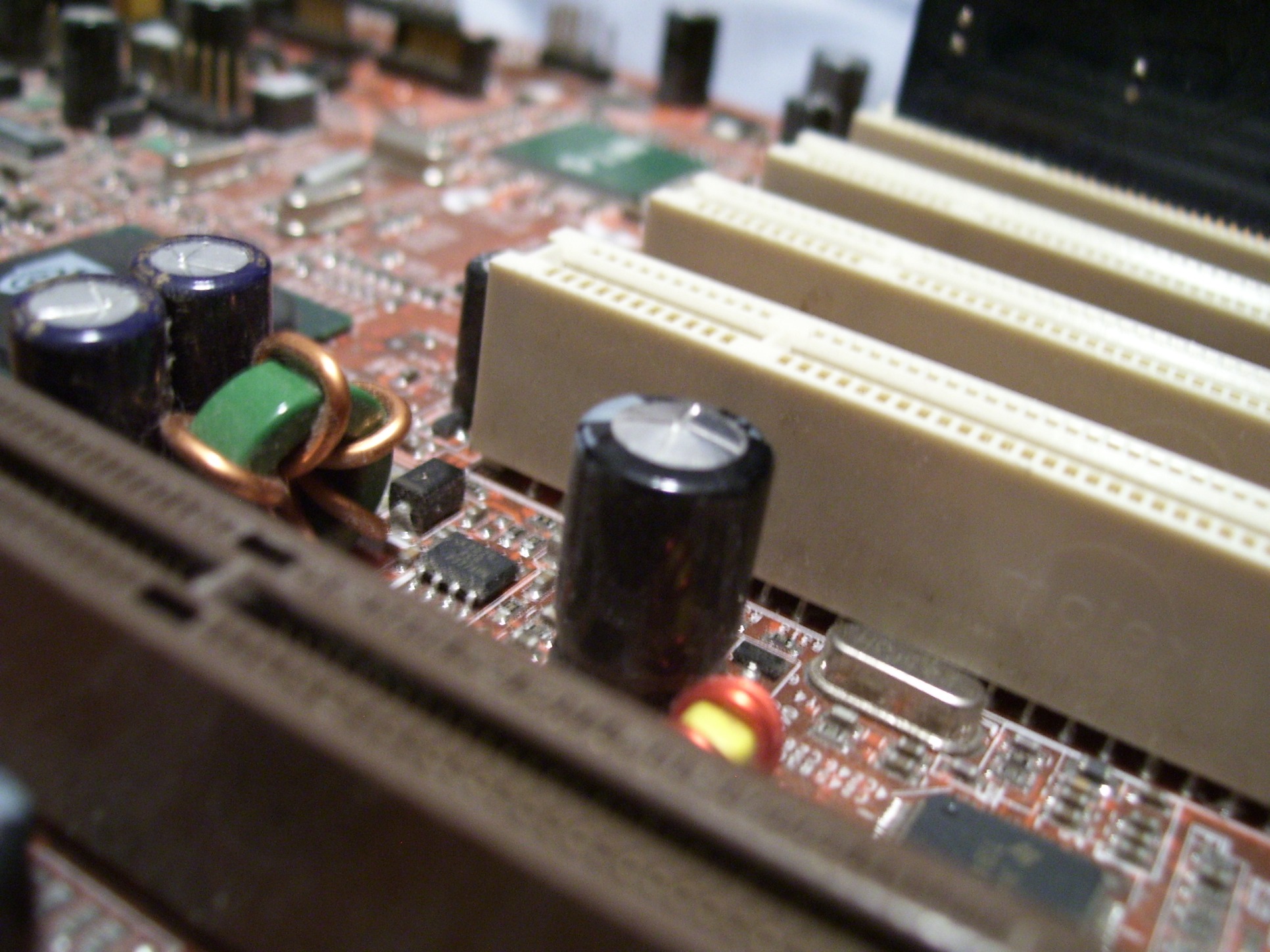

    All of the caps on the board are Rubycon except for the one's in the picture I've attached, 1200uf @ 16v. with a strange insignia. Could someone help me identify them? I saw no leakage on any of the caps either at the top, or the bottom. Is it likely that any of the rubycon's failed?

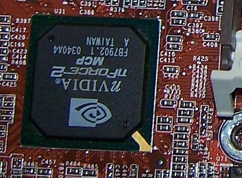

    The other pic is of the Southbridge. It has a brownish area in the middle of the chip which can't be cleaned off by either water or isopropyl alchohol. Could this be a telltale sign of a roasted chip?
    Thank you in advance!
    Richard

    the caps are nichicon and your sb is cooked.
              Most of the times when capacitor are popped on top , there are dead.
              I have a abit nf7 v2.0 with Rubikon Capacitor and one nichichon Capacitor.
              The nichichon cap. is close to the agp port.
              Last week, my mobo stop to work properly. the computer was starting , the red and green light on board was ON but i had no signal on the screen. So i take a look at the (most of the time , look the cap !) and i found the nichichon cap was popped.
              the nichichon cap is supporting 6.3v and 1800uf (micro-fara). i took measure of the cap and it show me 1320uf on 6.3v.
              Huummmm, a capacitor worth 20 cent and the old mobo worth 80 USD$ on ebay.
              So, i decide to buy some cap at digi-key online and replace the old one.
              I was sceptical about that but 20cent + 8$ shipping its very cheap to try.
              So i try it and ..... IT WORKS !!!!!!!!!!

                I believe it is the Nichicon HM. The later NF7 mobo uses Rubycon MBZ for its AGP 1.5V DC-DC input capacitor.

                              I've never traced out that board, but it's possible that 1 unique cap near the AGP slot might be the only cap on the AGP power supply output. If so, it might be overstressed with higher power cards.

                                That cap is for NB/SB power supply. Have seen it bloated and mainboard failing to boot. Replaced and it works like a charm.
                                I've replaced it with a 2200uF panny, it's a bit bigger, but I don't think it'll matter much.
