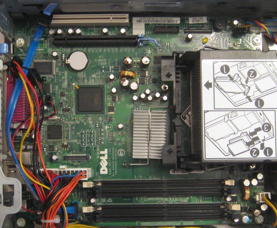

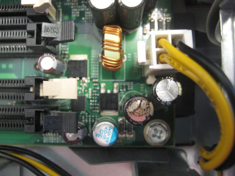

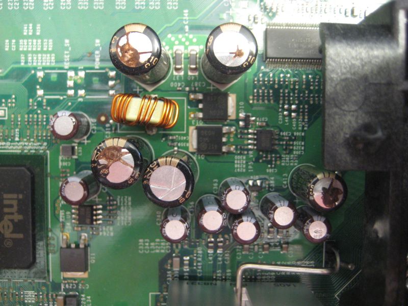

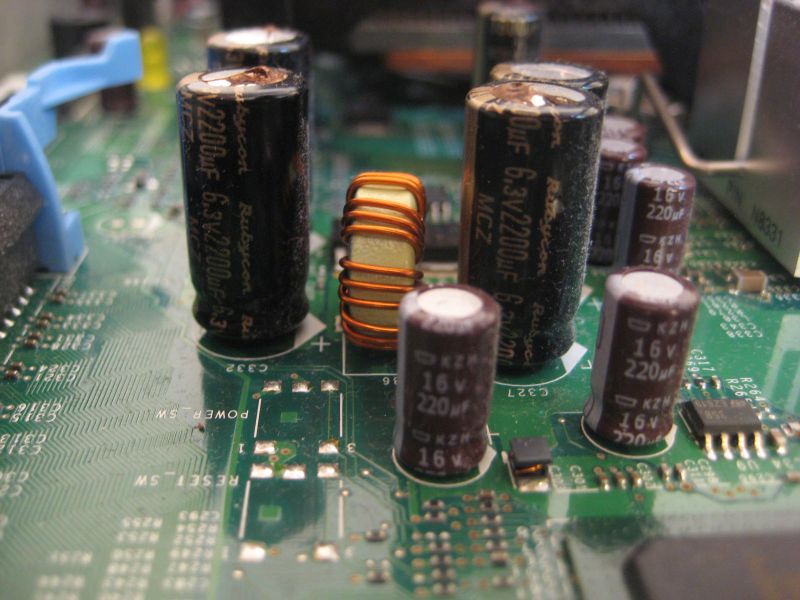

    Dell Optiplex GX620 with Oozing Rubycon caps
    Unit is a Dell Optiplex GX620 tower with an Intel Pentium-D945 3.4GHz, 3.5GB RAM DDR2 and a 250GB SATA drive.
    Units does not boot up. MoBo (see pic 'mobo') has two clusters of oozing caps, one around the CPU/GPU (see pic 1) and one around the extra 4-pins 12V power plug (see pic 2). All caps are Rubycon, see pic 3.

    Re: Dell Optiplex GX620 with Oozing Rubycon caps
    Yep, nothing new here. Bad Chemicon KZJ and RUbycon MCZ in a Dell mini-bake oven PC. Those Pentium D chips put out a lot of heat, and in a small case, just about any regular electrolytic cap will cool. So if you do recap it, you might want to use polymers (i.e. polies). And maybe see if you can add an extra fan in the system or otherwise optimize the cooling. Generally, those Dell cases have decent cooling, but it's just that the P4/PD CPUs they use produce too much heat for that case.
      The OP specified that it is a tower, which sounds like a mid tower case to me, not a SFF or slim (thin) desktop.

      Just giving you a hard time. Not trying to make fun of you.
      I'd say what accounts for the failures is that Rubycon MCZ simply don't handle heat well, and Chemi-con KZJ are unstable even on the shelf.
            Looking back at the O/Ps pictures, it does appear that this is an SFF or USFF desktop and not a full tower. Look at the motherboard - it has only a PCI-E and a PCI slot. The full tower has 4 slots.
            Nevertheless, those MCZs would have likely blown even in the full tower. I just got two of these OptiPlex GX6xx and GX7xx machines (I think one was a GX620 and the other a GX760), and one of them has similarly-blown Rubycon MCZ caps. When I eventually get around to it (might be in the early spring due to cold weather right now, and I need to do a full clean-up and de-dusting of these towers outside), I'll see how the cooling is in these towers. I'm thinking that reversing the front 120 mm CPU/case fan (so that the tower blows hot air from the front and takes cool air from the back) might be better for the motherboard's cooling. But that's just a theory in my head right now.
              You're right, it's a SFF machine (not USFF). No wonder they failed. Even the slim desktop version has 4 slots IIRC. Part of the problem is an inadequate cooling design, but the other part of the problem is that MCZ are just really sensitive to heat (not “plague” capacitors though). For an example (I'm sure you know this), in the HP DC5000 and D530 SFF computers, the MCZ in the VRM out are almost always bulging and leaking, often before any of the Teapos bulge, but the FL are never bulged.
                Yes, they are sensitive indeed. But when well-cooled, they will last a very long time and not give problems at all, unlike Chemicon KZG and KZJ, which will fail on their own, with or without use.
                Similar ordeal in the HP DC7700 (and possibly DC7600 and DC7800) boards. I got a board from a DC7700 "mini" tower (not SFF or USFF)... i.e. mATX board. All of the Rubycon MCZ caps on the high CPU side along with the many elsewhere on the board were bulging and leaking. The Rubycon MBZs next to them were fine, though. However, I'm pretty sure it wasn't a bad batch of MCZ caps, because the board had quite a bit of darkening of the solder mask on the underside of the chipsets and also around the VRM area, implying that the tower had either poor ventilation or there was a Pentium D fireball in the CPU socket (or both ).
