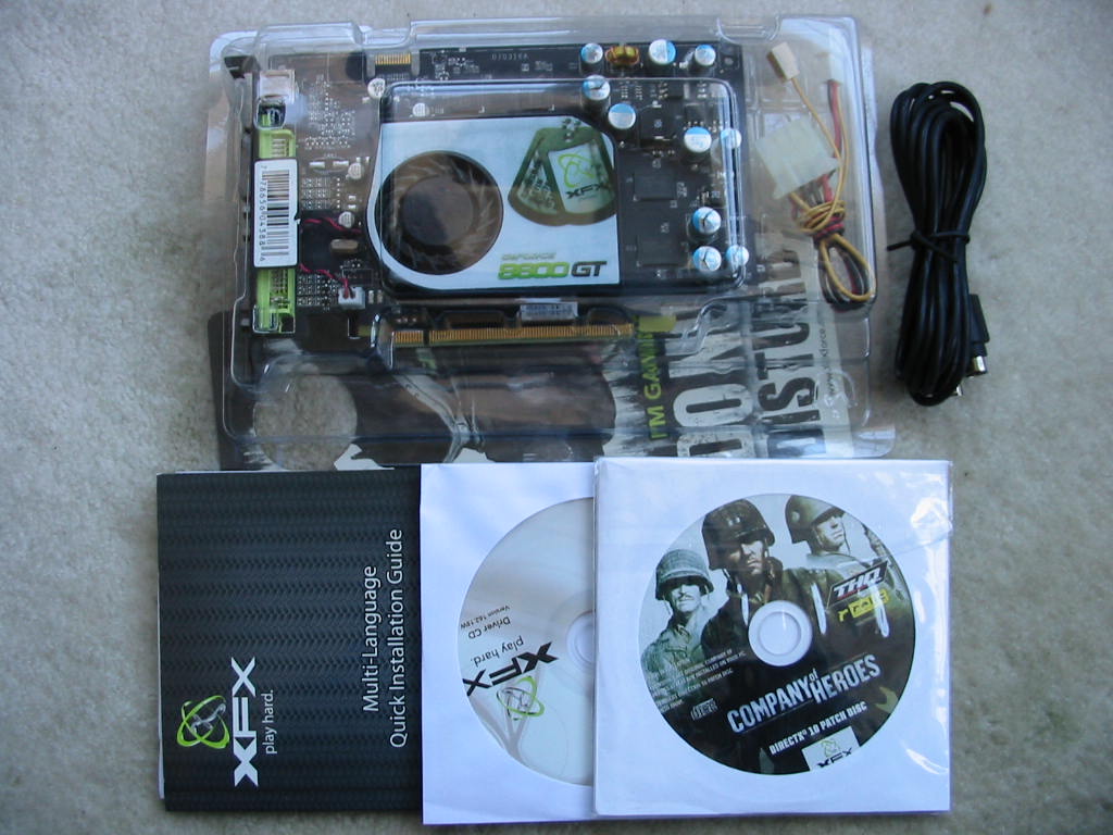

    This 8600 GT came with pretty much all of the original box contents (including the game, “Company of Heroes”). I am the type of person that likes to keep original boxes, cables, and CDs with my hardware, so I find this awesome!

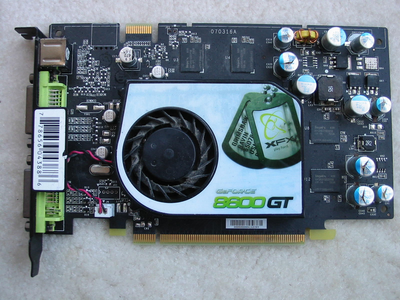

    Now let’s see the card from up close:

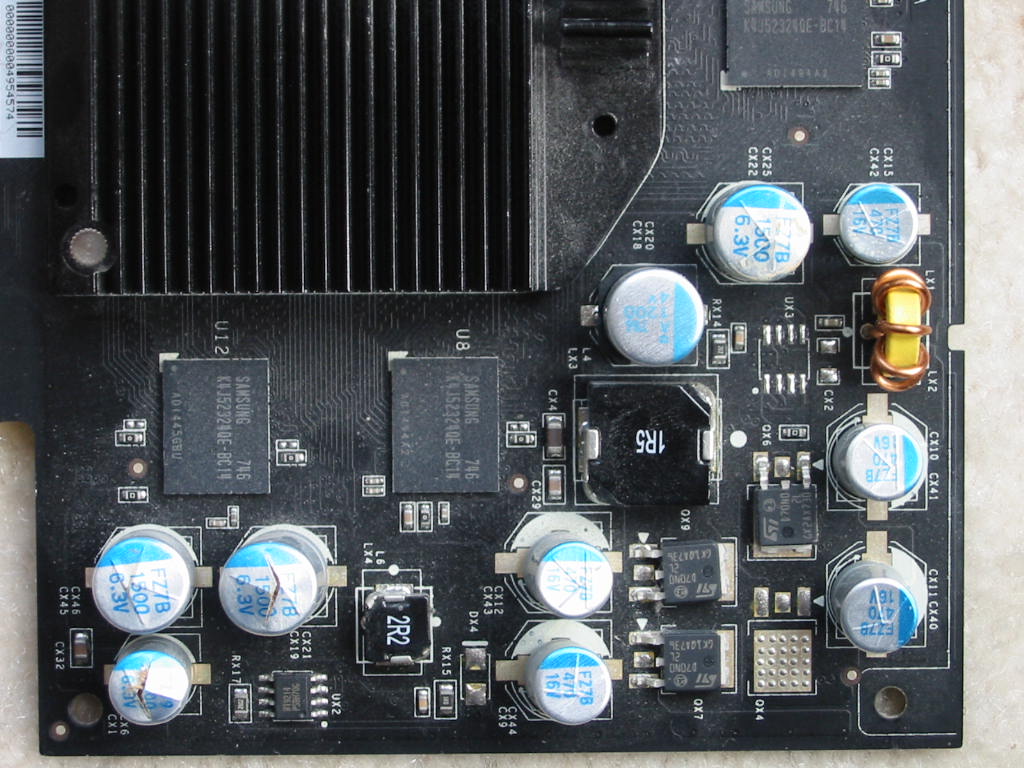

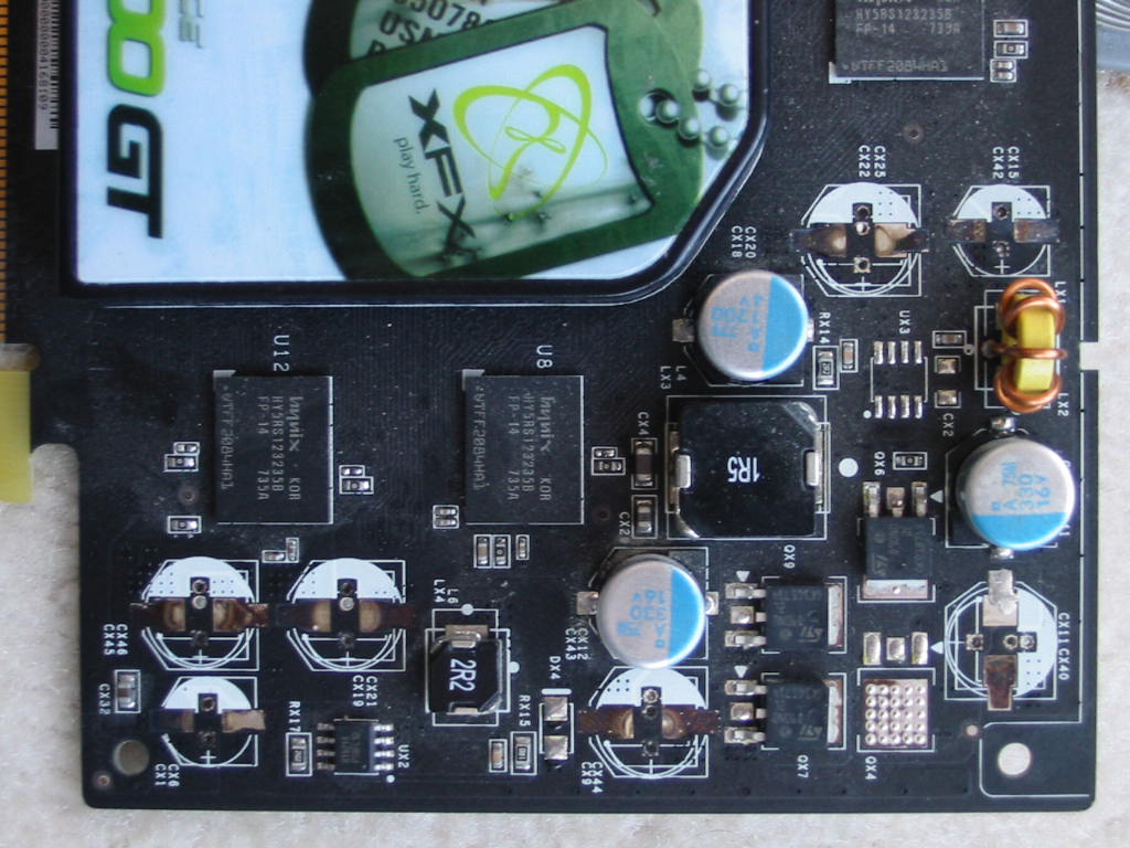

    Uh-oh - busted Sacon FZ all over again. Let’s have a closer look, shall we?
    Ugh! It's like a dejavu of the other 8600 GT. The RAM has both of its caps busted. That’s always risky, as I have two EVGA GeForce 7600 GT video cards that smoked their RAM due to this. But again, the seller of this auction reassured me that the card was working when it was taken out of service. So I took his word and began my recap.
    Step 1: Give the video card a Sacon-be-Gone treatment. My spray can of that stuff ran out, so I had to do it manually with a soldering iron
    - Ah! Much better!
    Step 2: Solder replacement caps.
    I probably went a bit more minimalist here than I normally do, as I did nothing to replace the bulged FZ caps on the 12V rail (only left the blue Chemicon PSA polymers). But this was just for testing, after all. I also used more Chemicon PSA caps as the replacement for some of the FZ, just for the sake of consistency and color-matching .
    By the way, note the corrosion on the SMD cap pads – not sure why, but it was pretty terrible on this video card. I cleaned them all before soldering my “new” caps.

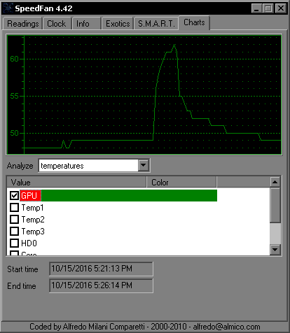

    Step 3: test.
    Well, it works alright. But for how long? –Probably not much if under load / gaming. Look at these core temperatures:
    At a 21°C / 70°F room temperature and open PC case, the GPU core temperature easily reached 62°C (and still rising) after about 20-30 seconds under medium-high load. Clearly, the heatsink is not adequate here, just like on the previous 8600 GT. It will surely need a modded heatsink of some sort.

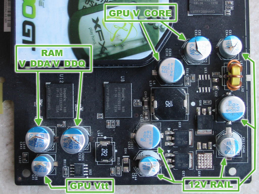

    So now that the card was working, I made a cap diagram for it, so you can see which caps are connected to which rail. Technically, I didn’t really need to make one, as this video card has the same exact layout and design as the v5.0 8600 GT – so if you’ve read through that thread, you may find the information here a bit redundant. On the other hand, the cap diagram in this thread may be easier to follow than the text description in my other thread.
    Cap diagram:
    If I remember correctly, these were the voltages for the rails above:
    GPU V_core: 1.4 Volts
    RAM Vdda/Vddq: 1.8 to 2 Volts, depending on RAM type (Infineon typically takes 2V)
    GPU Vtt: 1.25 Volts

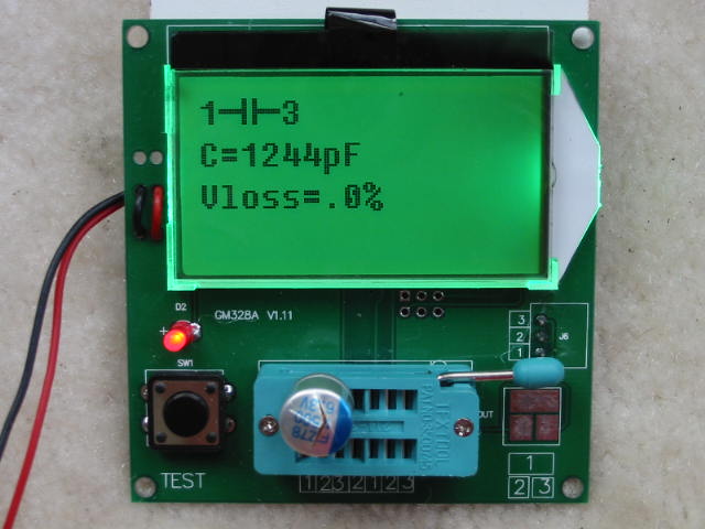

    Let’s see how bad those Sacon FZ caps are once they poped. Ladies and gentlemen, I present you Sacon FZ at their finest:
    Lol, look at these c[r]aps! They are a hair away from open-circuit. . Not even two (2) nanoFarads of capacitance in any of them! I think it is an absolute miracle this video card worked at all!

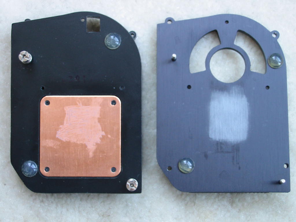

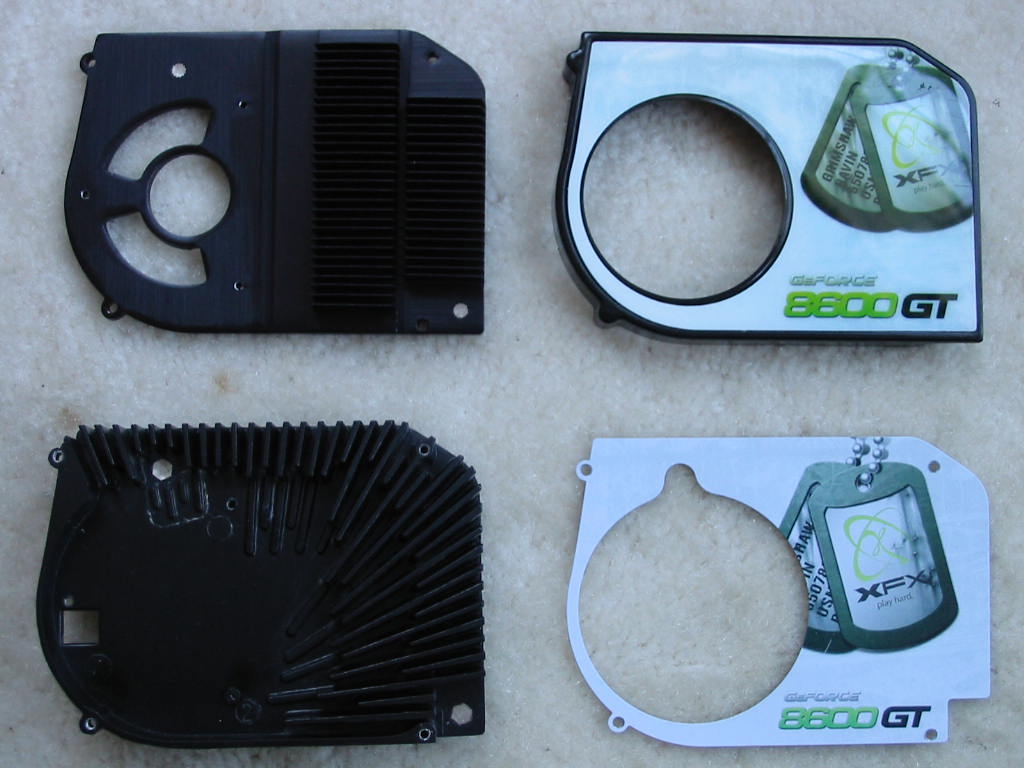

      Also, just to show that there is a small difference between the v5.0 and v6.5 8600 GT, let's have a look at their heatsinks.
      Here are the two heatsinks side-by-side (or one above other, I should say). On the top is the v6.5 heatsink, and on the bottom v5.0.
      https://www.badcaps.net/forum/attach...1&d=1499545505
      Version 6.5 uses a squirrel cage fan, so the heatsink has holes underneath the fan area to allow the fan to intake air. The fins on the heatsink are straight and air is allowed to go only through them (there is no opening on the top). Compare that to the v5.0 heatsink, which uses a regular style fan and the fins are placed like rays.
      The thickness of the heatsinks is also different.
      On the left side of the above picture is the v5.0 heatsink and on the right is v6.5. Overall v6.5 has much thicker base, which is better, because it allows for a better heat flow from the GPU core to the fins.
      But there is a twist. Look at the bottom of these:
      On the left again is v5.0 and v6.5 on the right. Version 5.0 has a thin copper heat spreader, whereas v6.5 does not. Makes one wonder which is better: thinner heatsink with a thin copper heat spreader, or an overall thicker heatsink without the copper heat spreader. Unfortunately, both of these heatsinks are too small for the TDP of the 8600 GT, so it is not possible to determine that with this GPU. Perhaps with a lower TDP GPU, it may be possible.

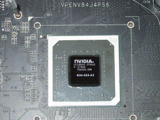

      And just for fun, the GPU core:
      Now here is something interesting: nVidia lists the 8600 GT as being 43 Watts TDP on paper. Meanwhile, they list the 9400 GT (a shrunk-down 8500 GT core) as being a 50 W TDP GPU. But something doesn’t quite add up, because I have an XFX GeForce 9400 GT with a heatsink somewhat similar in size to the heatsinks shown above. It also uses a regular 50 mm fan going at full blast on 12V. Yet, no matter what load I put on that 9400 GT, it won’t go over 52°C with its stock heatsink. So I think nVidia really underestimated the TDP of the 8600 GT – either that, or they just didn’t care to put a proper heatsinks on it.

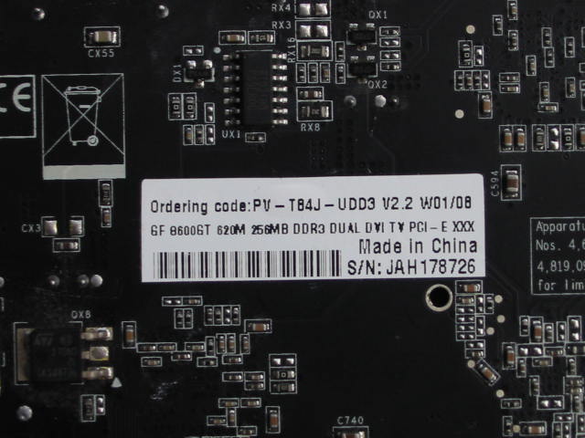

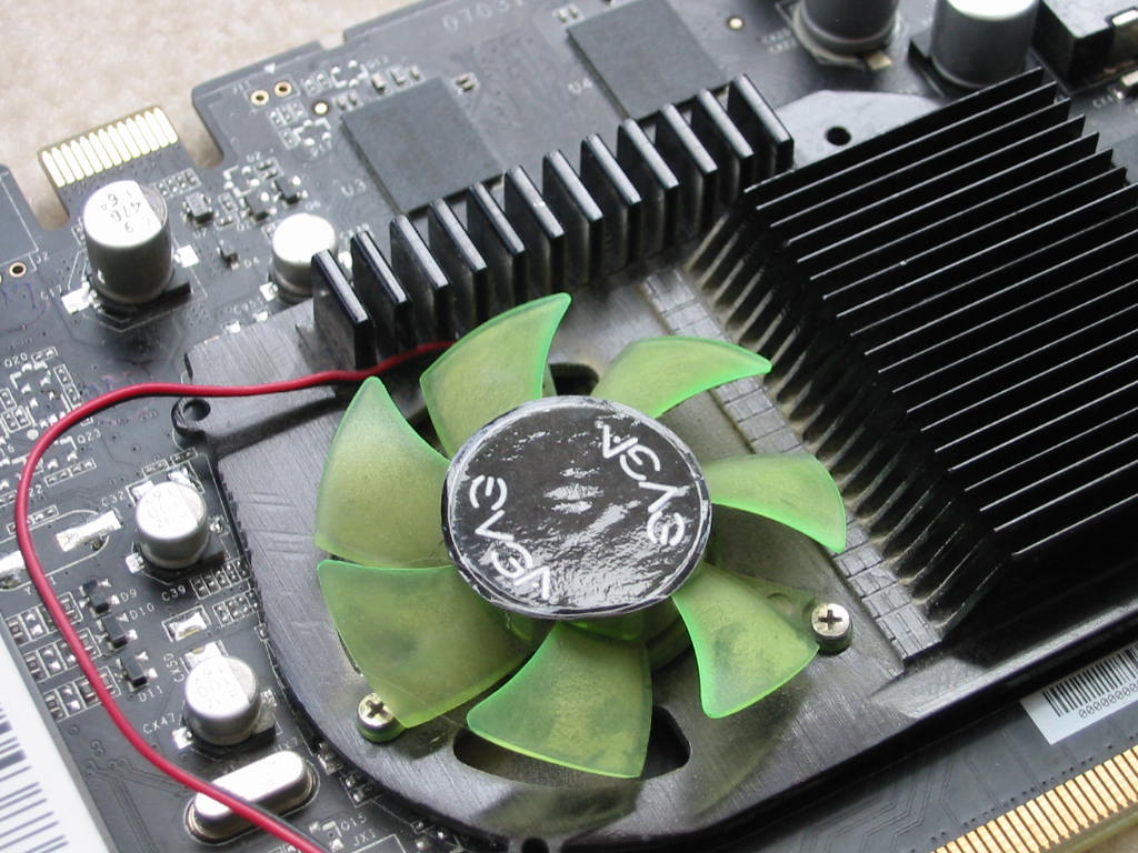

                Around March of this year, I found yet another of these 8600 GT video cards for pretty cheap on eBay ($8 shipped to my place). Needless to say, the urge to save it came out of me again, so I bought it. Besides, it seems like these XFX 8600 GT cards have been getting more and more scarce lately (probably because either most are dead from bad caps and/or overheating or because they are just too old now), so I figured I’d get another one (for the last time, I swear! ) “while supplies last”, as infomercials would say. Except that this one wasn’t XFX brand – it was E-VGA.
                Or was it? Here’s a picture from top:
                https://www.badcaps.net/forum/attach...1&d=1531500189

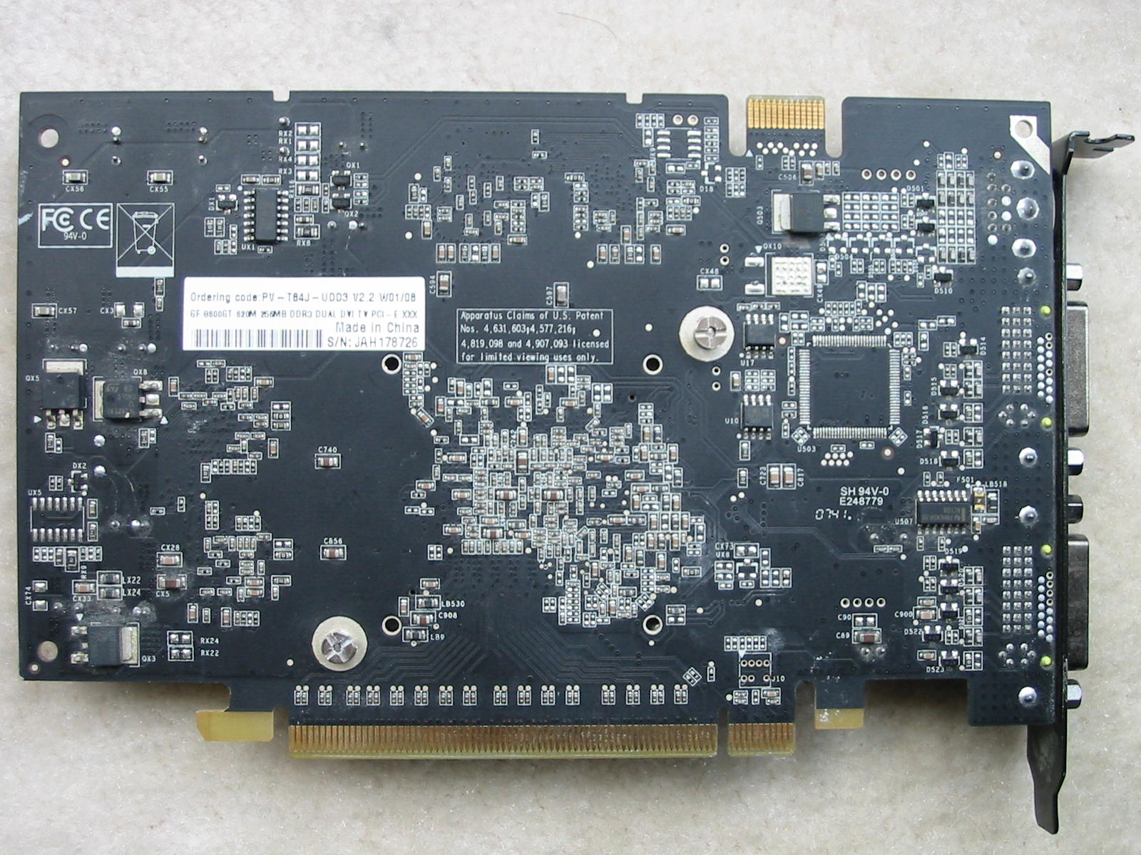

                OK, it’s an XFX, no argument there. Only the fan says E-VGA. Of course, it’s possible that the previous owner might have swapped the fan, given that the cooler came without its top cover.
                The back and the sticker confirm it’s an XFX too.
                Same model number (PV-T84J-UDD3), except this is apparently even an older revision: v2.2.
                Not that this changes anything. The card still has a 620 MHz core clock and 800 MHz RAM clock (gDDR3 memory) like my other two XFX 8600 GT cards. In fact, here is the GPU-Z shot, which also (rhetorically) proves that it’s an XFX card:

                The core is the same as before, too.

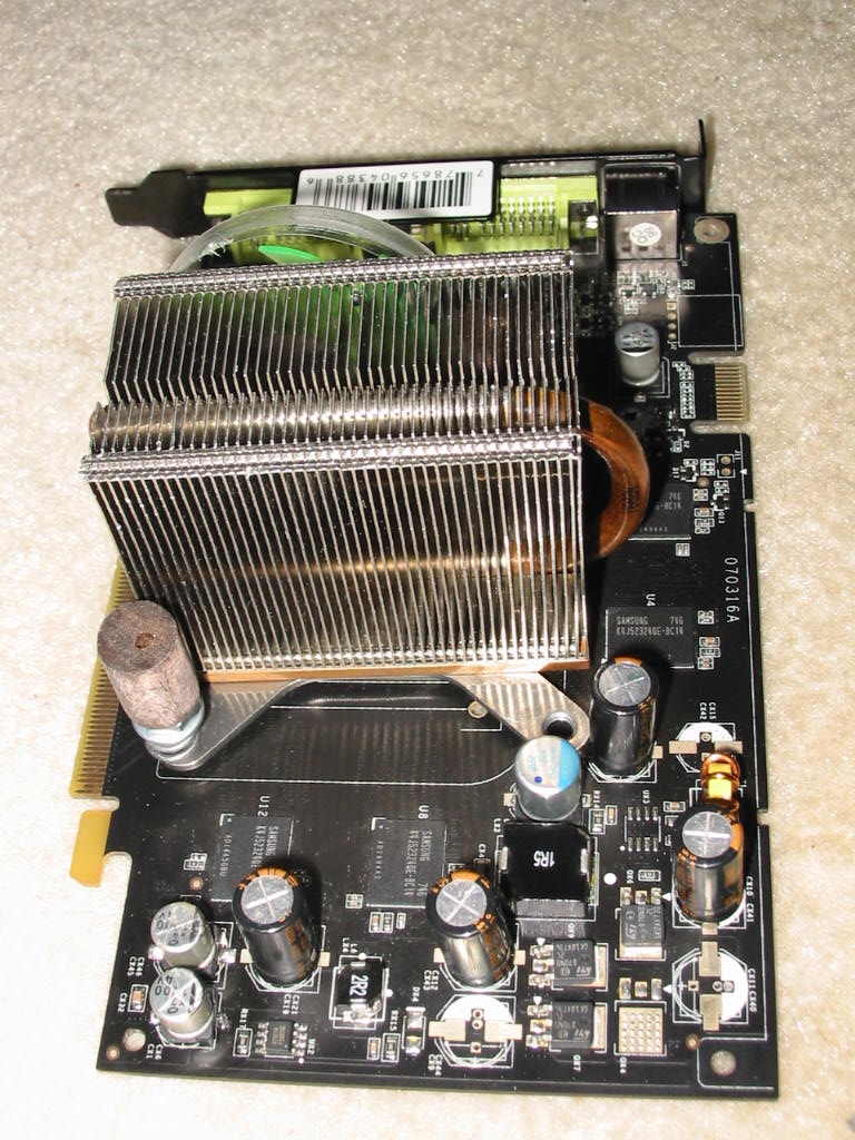

                A picture of the recap:

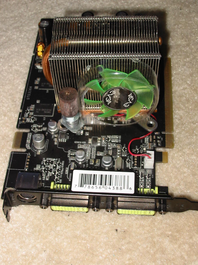

                And you can see I also installed my now-proven Xbox 360 CPU rev.2 modded cooler, as I knew the original cooler wasn’t going to cut it, just like with the other two cards. I only used the original cooler to see if the card would display any output and boot into Windows after the recap. But no further tests were done with it.
                A few more shots of the modded cooler:
                Actually, this is not a finished version of the modded cooler, despite looking pretty complete. I put the 50 mm E-VGA fan on there just so that the card has *something* for a fan, in case I need it for testing a PC setup. But in reality, that small fan is not enough to keep the card cooled under full 100% load at less than relatively cool room temperatures. At least that’s what I am let to believe, given the shape of the curve in this graph:
                https://www.badcaps.net/forum/attach...1&d=1531500598
                Most likely, any room temperature higher than 70°F / 20°C will result in core temperature close to or higher than 60°C (not good for GeForce 8000 series). At 64°F / 18°C room temperature, though, the card will happily do full load with the GPU core temperature remaining mostly around the 55°C mark or lower. And the 50 mm E-VGA fan isn’t actually too obnoxiously loud either – it runs slower (and thus more quiet) than the fans on the other two XFX 8600 GT cards I posted.
