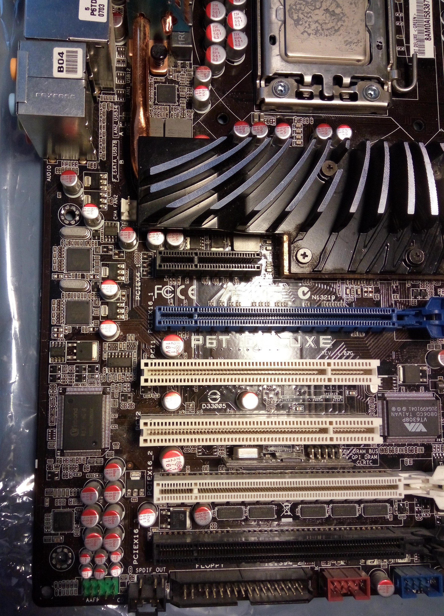

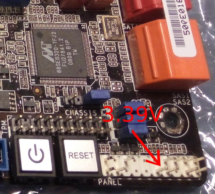

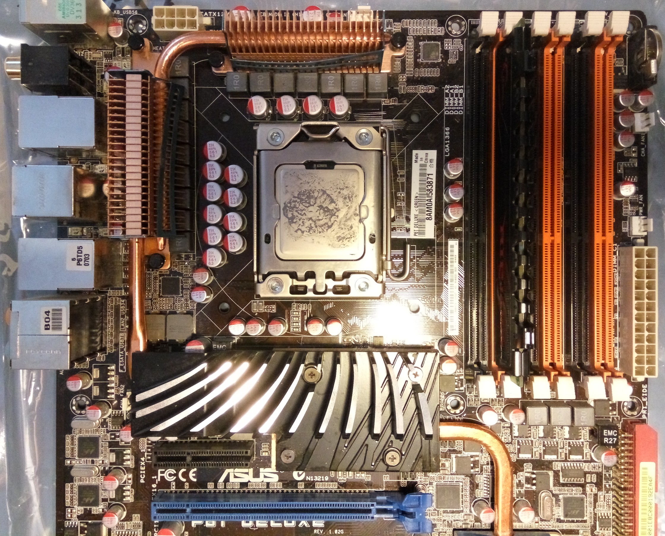

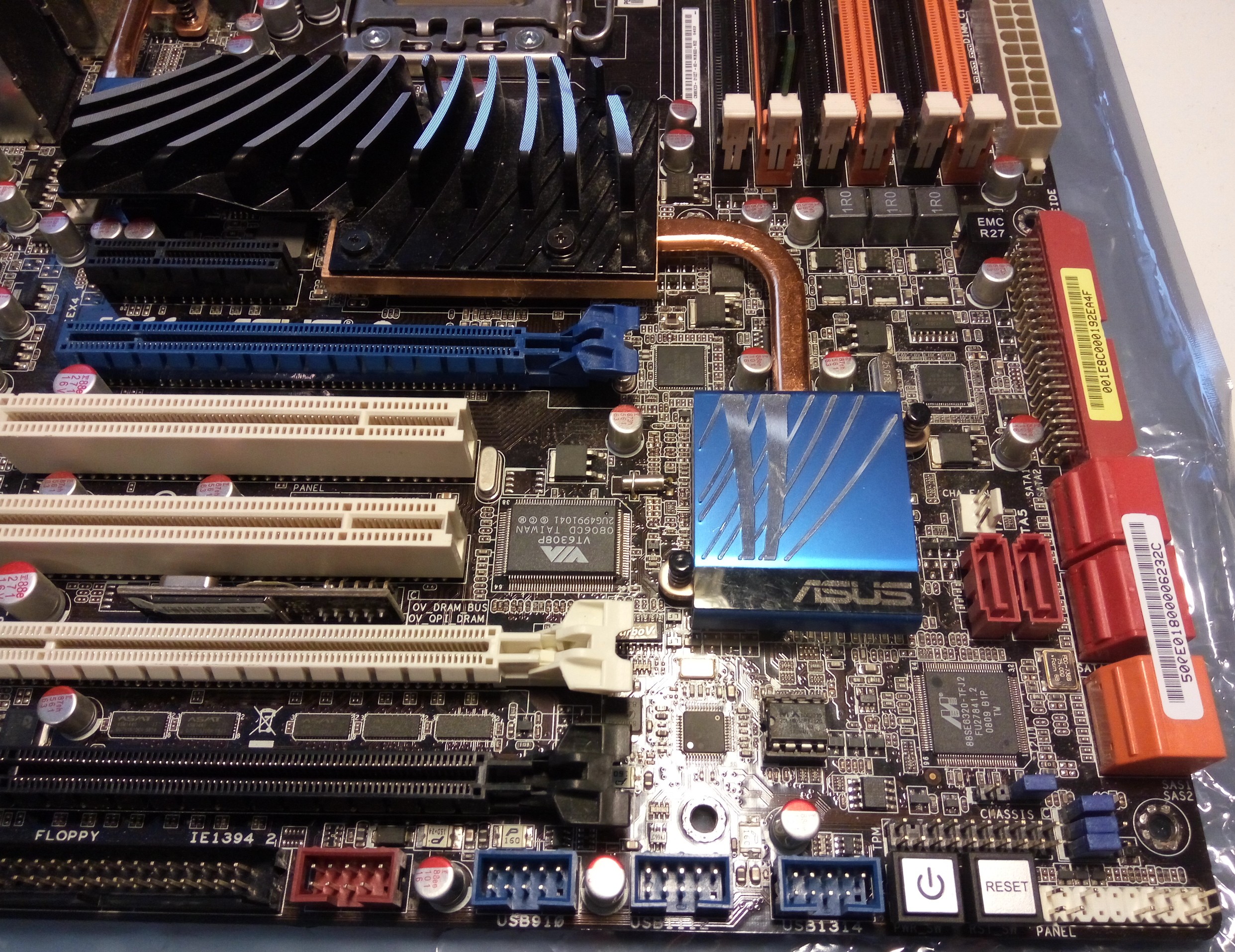

    Hi! I have a P6T Deluxe motherboard from Asus that does not power on at all. I tried to short the power on pins on the motherboard with a jumper and also tried the included power switch and neither of them does anything.
    However, if I short the green and black wires from the ATX connector the motherboard powers up normally and even boots Windows 7.
    I measured that the voltage between the PWR and ground pin is 3.3V when the motherboard is off and PSU connected.
    Do you have any idea what is wrong with the motherboard or which components should I try to replace?
    Pictures of the motherboard attached.

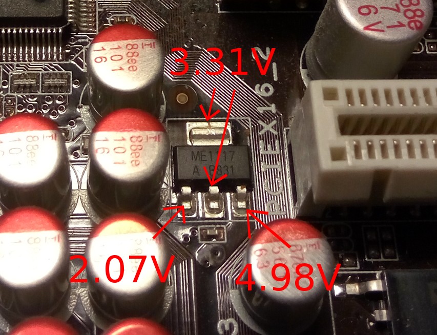

      I assume that the 3.3V stand by voltage comes from ME1117 voltage regulator. I measured the pads when 5VSB is fed to the motherboard and they looked OK in my opinion. The voltage on the other power button pin is 3.39V and the other one is ground.
      The 5VSB voltage from psu is 5.00V. According to my knowledge the PWR_OK signal is only on when the PSU is on.
      The problem here is that the motherboard does not start the PSU when I push the power button.

          I have not measured the PWR_OK signal. I meant that the pins on the motherboard that get shorted when you press the power button are 3.3V, sorry for being unclear. The PSU that I'm using is tested and working.
          The motherboard starts only if I jump-start the power supply. So I am trying to find out why the motherboard does not short the PS_ON pin in the ATX connector when I push the power button.

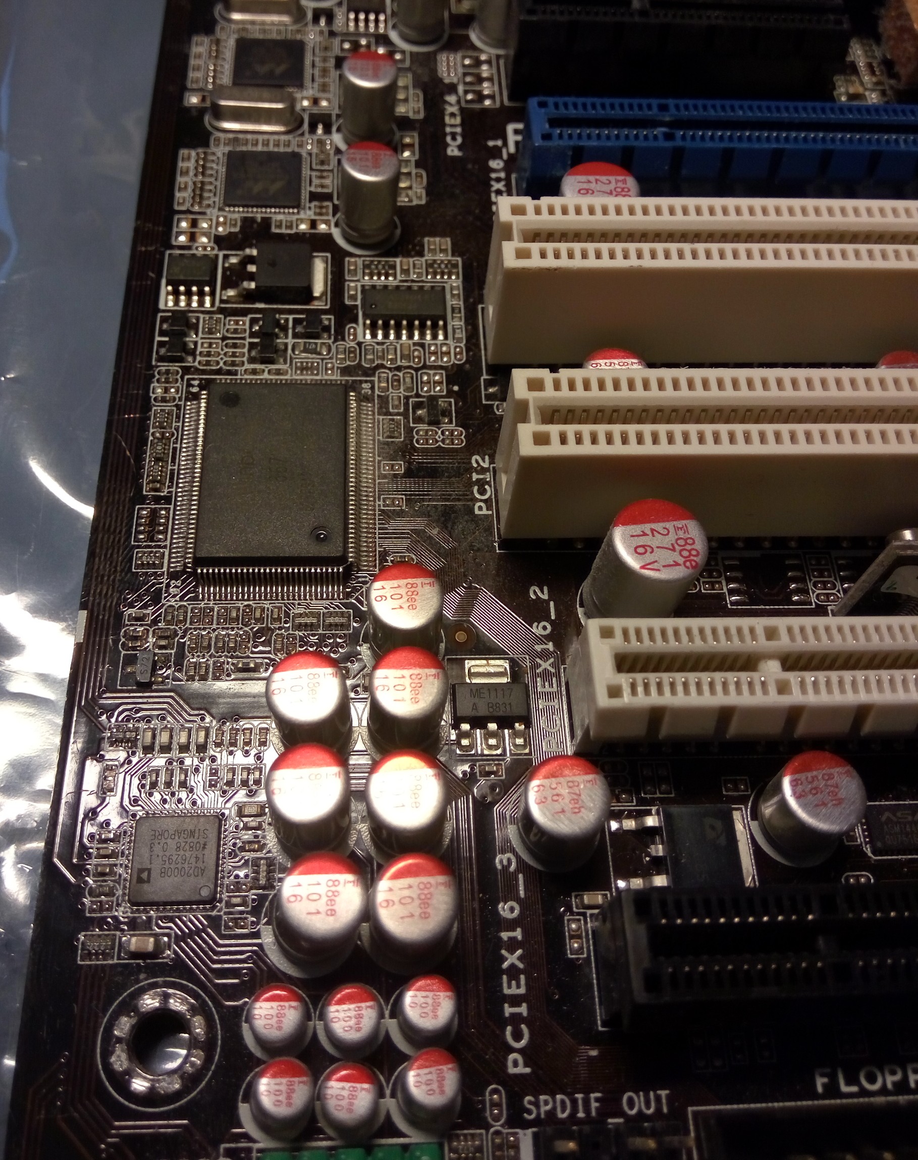

            The LPC Super IO chip is usually responsible for turning on the PSU.
            On your board, the Super IO (SIO) should be that Winbond chip in the lower left corner. Can you post its part number? I can't seem to fully read it from your pictures. Looks like W83____HG-A
            Around 3.3V on the Power Switch button on the motherboard is normal.
            By the way, any chance the LAN chip gets hot when the PSU is plugged in the motherboard? A lot of times, a lightning strike can take out / damage the LAN chip, and sometimes also the SIO.

              Re: Asus P6T Deluxe does not power on
              The Super IO chip is Winbond W83667HG-A
                  Welp...
                  I looked at its datasheet, and unfortunately, it looks like this Winbond chip does not control any of the motherboard's power functions.
                  ... so whatever is controlling the power, it's not the Super IO. Might be the Southbridge then, unless you can trace the power switch header on the motherboard and see where the traces go. Perhaps there may be another chip just responsible for power functions.
                            my guess would be that ASUS APU Chip next to the BIOS Chip.
                              Power on is handled by the EC, the Winbond chip. Power states are handled by the southbridge, but the EC gives the initial startup signal (RSMRST then PWRBTN) to the southbridge.
                              Boardview of P6T attached if it helps.
                                Very good chance that one of the FET's under the skinny blue heatsink that is NOT connected to the heat pipe has gone bad.
                                  I replaced the Super IO chip (W83667HG-A) on the motherboard and now it powers on normally. The power and reset buttons on the motherboard don't work, but it is not a big issue because the chassis power button is working.
