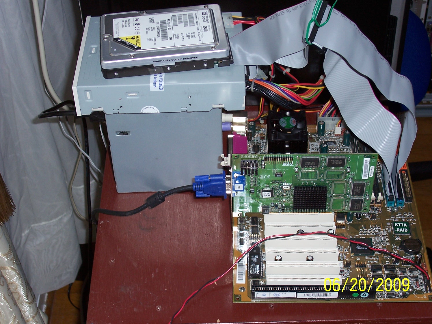

                          While at the local computer store, I found a KT7A with raid sitting on a pile of mobos ready for recycle. He let me have it and a nvidia TNT agp for $7. Probably too much for a dead board, but video card alone was worth the money.
                          Got it home, and dead as a door nail. No bulging caps. Put my blue esr meter on all the caps ... and turned up NOTHING! I figured I had met my match. Swapped out cpu with a good one, and still nothing. Even the fan wouldn't spin. Put in a POST tester - in a pci slot. Still nothing. I figured maybe it had a confrontation with a Bestec psu and came out second best! I was ready to throw in the towel and toss it.
                          Decided to try one last thing. Found a guy on ebay who does bios reflash for five. Sent him the chip, and a week later here it came back. Put that bios chip back in and now it POSTs. Added a 6 gig hard drive and a old CDROM to test with, loaded the latest Ubuntu, and it works fine.
                          Now I'm wondering ..............how many caps should I replace if it isn't giving any problems now? To be such an old board, it sure does run nice. To be sure, it IS worth the $7 I paid for the mobo and video card! I just wonder what happened to that bios chip that it needed reflash.
                          Old proverb say.........If you shoot at nothing, you will hit nothing (George Henry 10-14-11)

                            Re: Abit KT7 Raid
                            Depends on what you're going to use it for. If it's just something to play around with, you can probably leave it as is. Otherwise if it's something serious where you need good reliability, then recap it.

                              Re: Abit KT7 Raid
                              For now, just a play toy. Don't even have a case for it yet! Sure does work nice.

                                Re: Abit KT7 Raid
                                Awesome! Sounds like a sweet deal for ~$12. If you have good ventilation on those Teapos, they might even last for quite a while.
                                What processor are you running on it right now?

                                  Re: Abit KT7 Raid
                                  Just a 900 Mhz cpu right now. I think it will go a lot faster, and I might find a faster processor further down the road. For now I am pleased that it works at all - quite a challenge to get it running again. When I think about the TRS-80 I had years ago, this is a very impressive machine! I know there are faster and better machines, but hard to beat the price.
                                  I wasn't sure what the max speed was for the AGP slot, so for testing I put an old Voodoo 3 pci card in it. A few years back, everyone was talking about the Voodoo 3.
                                  Had a 512 Mb PC133 memory stick in my stash. Put it in and works fine.

                                    Re: Abit KT7 Raid
                                    Yeah, I was going to say, the video card didn't look like a nVidia TNT (now that I look at the picture again, you have a PCI card in there). The Voo Doo 3 is very nice, though, because it support wrapper/3DFX and older games look much better.
