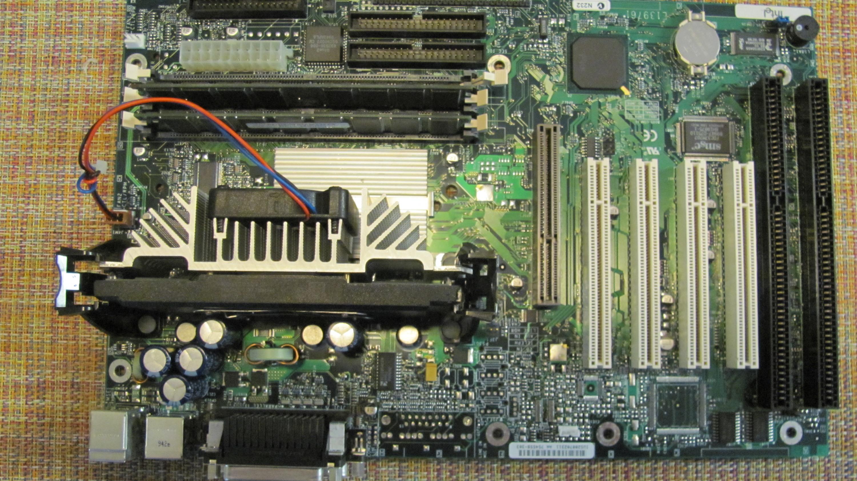

        Pulled the board out for another look today and to take some pics. Might've found my prolbem (Thanks ChaosLegionnaire!) as when i first checked for the power prolbem I didn't remove the floppy drive. It minimized it, i replaced the FD with another one from the parts bin, and it seems to have reduced the prolbem.

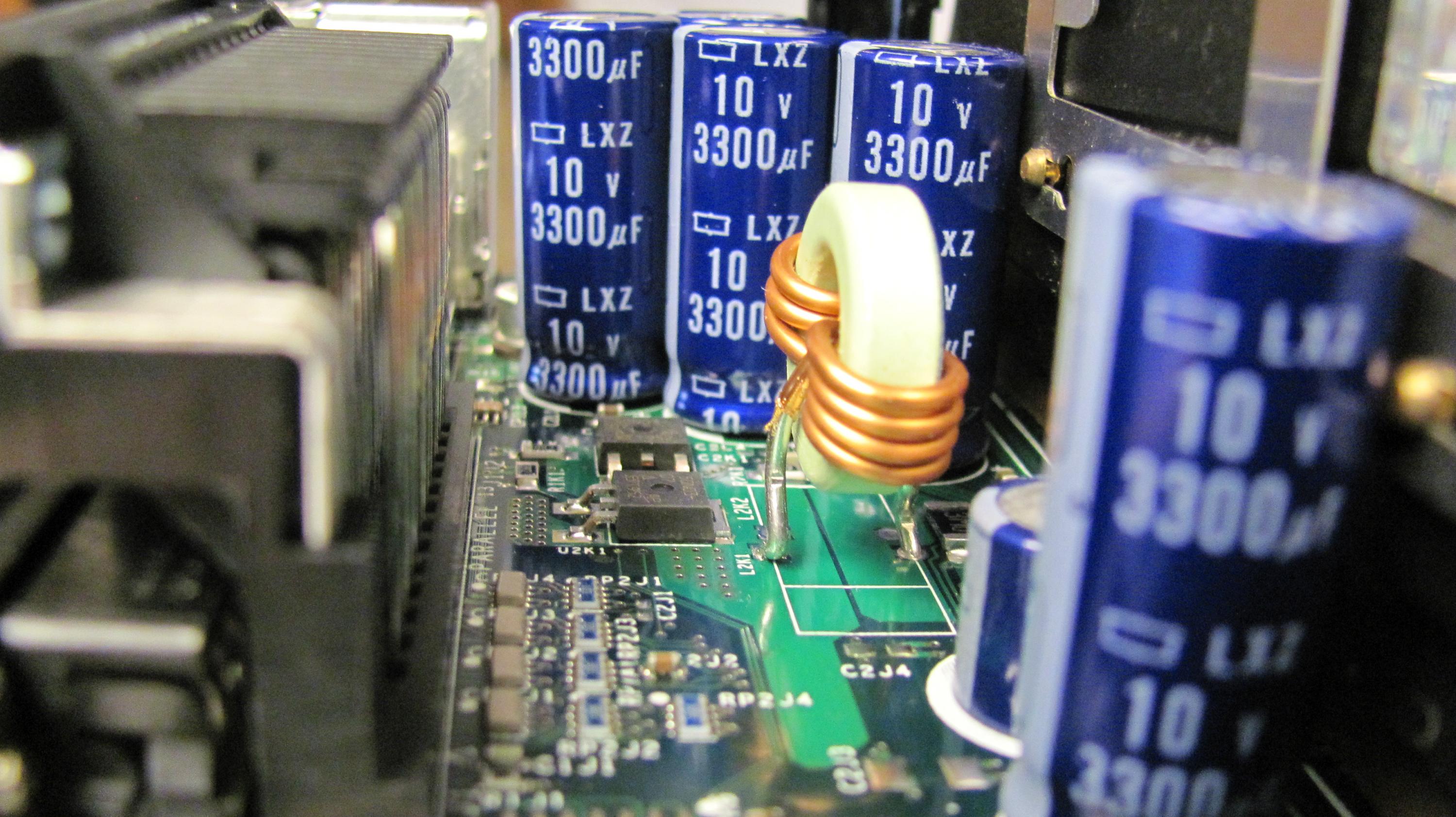

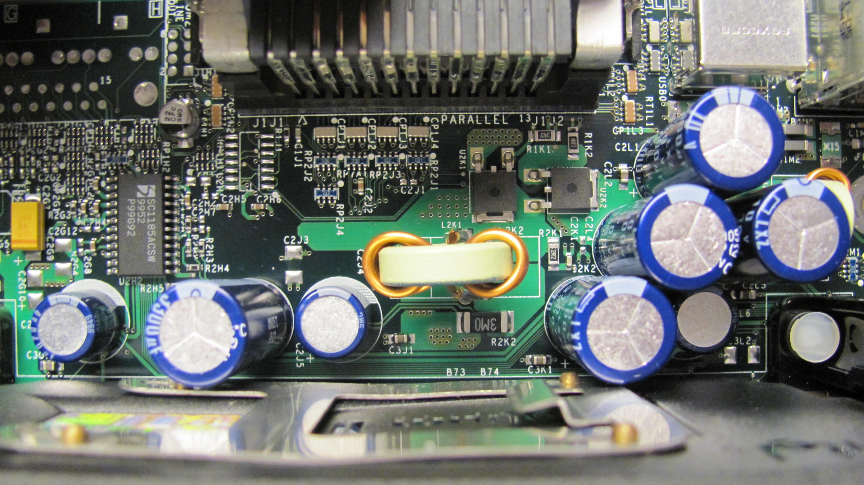

        This board seems a bit odd in that the electro's only number about 7. Other 440bx boards number 10 or more. Most of what would be electro's have been replaced with the tiny metal can ones (dont know their proper name)
        Overview:

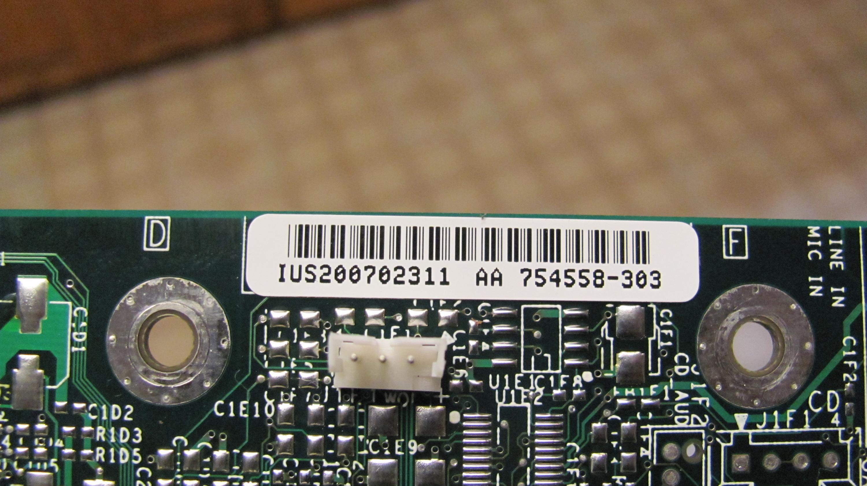

        Markings on board. Legit or not?

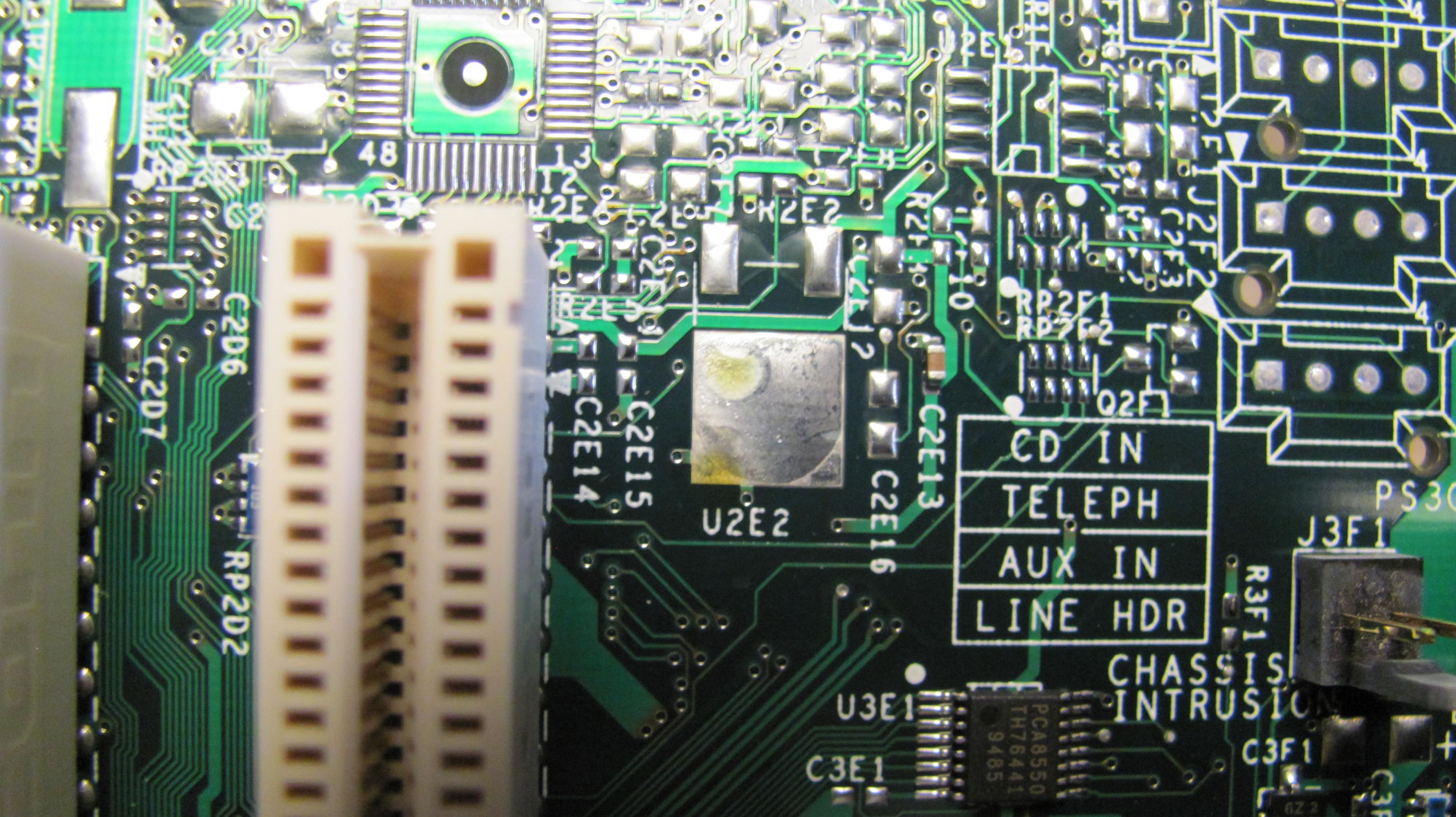

        And finally, some leftover flux, maybe from the board being recapped previously and a component missing (though its in the area where the audio card is usually onboard, so maybe i'm reading too much into this:
