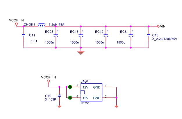

      I found a schematic for the 7125 board. It's not the same revision number as mine but I did find C11 in it, which is 10U. I've attached that part of the schematic.
      I removed that now blown smd cap. No holes in the mobo but part of one pad on the board for it is gone by the looks of things. An axial lead cap could probably be put back in it's place with some very good soldering. Not sure about another smd.
      Now for what I hope is the good news, after removing that smd cap I plugged the EVGA PSU back in. Upon shorting the ps-on pin to ground the whole thing sprang back to life. I plugged the video card and monitor in and saw the POST on the screen. Went into the BIOS and checked everything out and redid all the settings. In fact I'm using the mobo right now to type this out! The board doesn't seem to miss not having -5V.
      I measured just a fraction over 1.5V on the VRM Fets. The BIOS auto sets the vcore voltage and it's giving 1.5V; I don't overclock.
      So, if someone much smarter than me can look at the schematic, would leaving C11 off be of any real detriment or should I try and locate another one very soon? I'm still going to build a new system but having this one working again buys me some much needed time to do so.

        it looks like c11 is in parallel with the other electrolytic caps and before the CHOK1 inductor coil. its being used as an emi and noise filtering cap. its fine to continue running without it since u said u dont overclock. u just cant have the tv or radio near the mobo now because the lack of the emi filtering cap c11 *may* cause radio/tv signal interference. thats about it.
        if it was near the cpu tho, that might be a different story as it may be for clock signal decoupling. there is usually no redundancy for those. if one goes, the cpu's clock signal may have too much jitter, the cpu cant even boot. tho in some cases, if it *still* manages to boot, u can salvage the situation by quickly rushing into bios setup-> cpu config and reduce the multiplier or downclock the cpu by around 50%, then quickly save the bios settings before the system can lock up. that should stabilise the clock signal since its running at a lower frequency. the system should be stable even at load again.

              Yup, that small ceramic cap was the problem indeed. They like to go short-circuit when they fail, which is why your power supply was tripping. That said, your new 750 Watt EVGA SuperNova is much more powerful than the old junky PSU you had, so that's why it was able to blow ceramic cap before tripping and falling into short-circuit protection mode.
              As far as the value of that ceramic cap: if you want to put in a replacement, I'd guesstimate that cap is anywhere between 1.0 uF to 4.7 uF, based on the physical size. Probably rated for 25V or more. But it's not necessary.

              It's not redundant, but it's not critical if missing either.
              Like you said, it stops some of the EMI/RFI from the CPU VRM switching to go back in the PSU, but so do the other caps too. So with that cap gone, you will just have a bit more EMI/RFI than before. I doubt the lack of this cap will cause any problems, even with the CPU overclocked.

                From the circuit I posted back in message 22, The cap is apparently 10UF. Because there are no real obstructions in that area I'm probably going to try and find a leaded ceramic 10U cap to replace it (if it's worth doing that); with part of the pad gone soldering another SMD on will be quite difficult but I should be able to bend leads 90 degrees and solder them into the pads.
                  Ah yes, I forgot you found and posted a schematic.
                  If you haven't done any SMD/SMT soldering, then don't bother replacing that cap, especially with anything else other than a ceramic cap again. Either way, it will be a pain if you don't have good flux. And with the pad nearly gone on one side, it will be even more annoying to solder to.
