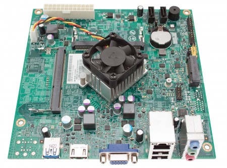

    Have an Acer J2900 based MiniITX mainboard that simply refuses to turn on and gives me *nothing* (tried different PSUs too, all items removed, different RAM, even popped the RTC battery and tried without RAM to see if I can get it to complain, PSU fan won't spin up even - tests fine with PSU tester).
    First place for me to start would be the turn-on circuit but while I have plenty of laptop schems/boardviews I noticed I don't have a single one for a miniITX or standard PC mainboard (I'm assuming that almost all of them will have a very similar turn-on circuitry setup).
    *edit: yes, I've tried a different switch for the on/off button, and just shorted it.

    Fun fact of the day - the CPU fan, if dud, will do this :-o
    Goes to show, even after all these years, there can still be simple but amusing things to learn.

      So it was just the CPU fan that was dead that was causing the motherboard not to boot (I am guessing due to lack of RPM fan pulse from the fan)?
      If so, I wonder what killed the fan. Perhaps someone tried to clean the motherboard and fan with compressed air and let the fan spin / spool up to really high RPM? I know from experience that some fans don't take it too well when you do that. The high RPM makes the fan coils produce a high back-EMF - sometimes enough to take out the fan controller/switch IC and possibly other components connected to it.
      So be careful if using compressed air to clean fans.

        On this particular client machine, I think it might have been something else, just bad luck - but yes, I've had some people do the compressed air thing and ruin the fans.
        To date, prior to this event, I was more used to a failed fan simply causing a BIOS warning and subsequent shutdown.
        Somewhat more amusing since this is a low-power system and could probably run for at least half an hour without the fan being needed.
        Lastly, if you swap it for a 2-pin fan (no RPM) it will boot
          Same here.
          Either shut-down, constant beeping from the motherboard speaker, or simply booting with just a warning.
          Interesting. I guess the motherboard does have some kind of a detection circuit to see if a fan is connected. HP loves to do that too on their motherboards. For example, I have an HP DC7700 motherboard (Intel Maverick/Silverado) that will give a "Front Panel not connected" warning if the power indication LED is not connected. Same with front USB and front audio headers. But at least the board boots (though I do have to press the "F1" key every time after POST, which is somewhat annoying).
