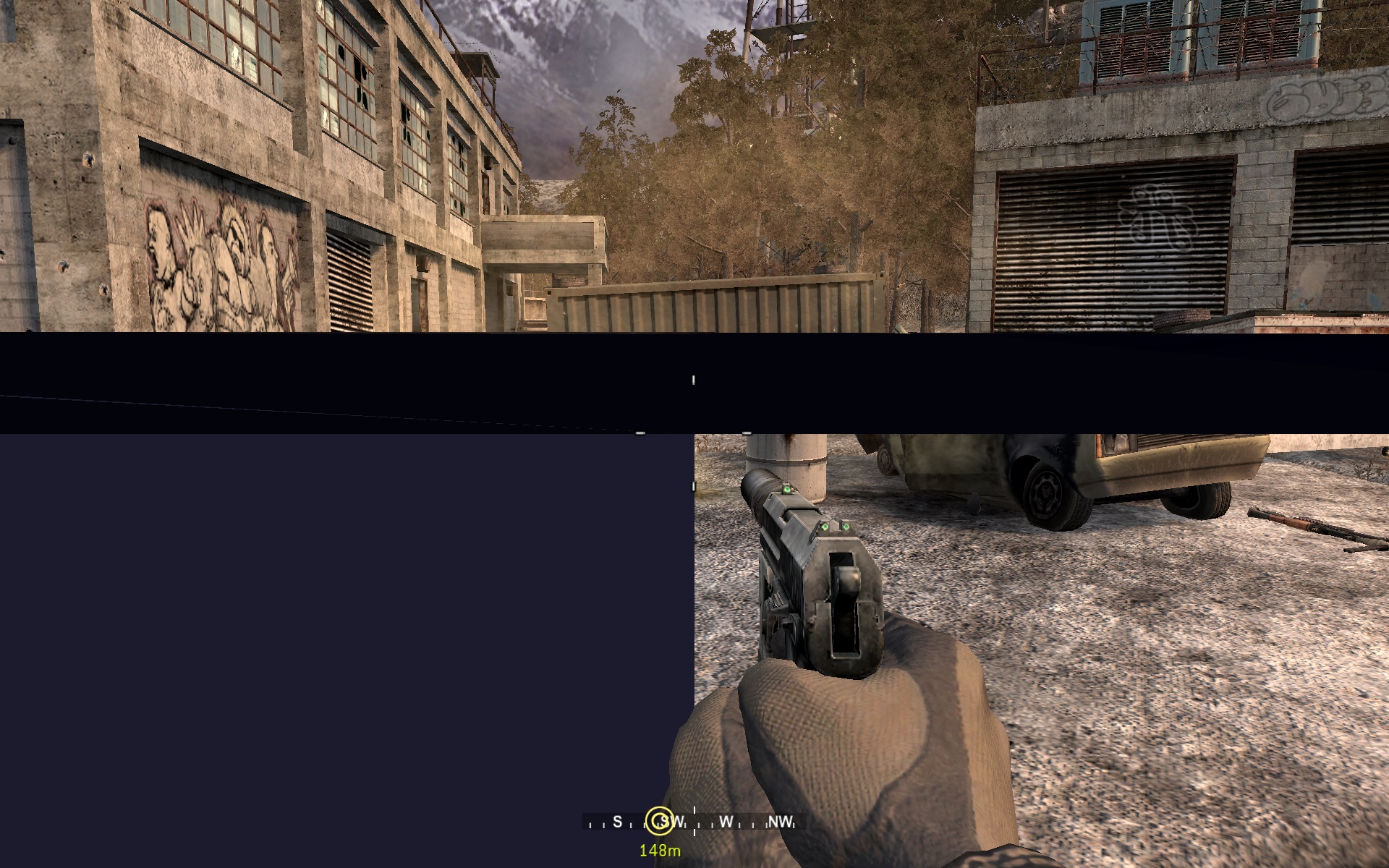

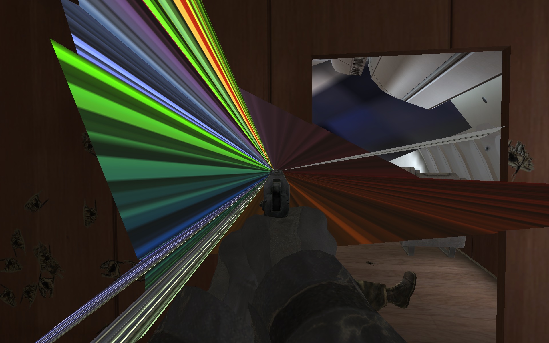

    I would like your help to fix a X1900 XT video card that doesn't work properly, in fact it never did.
    A little history: I bought the card in Oct 2006, it was fine in games and the various 3DMarks but it would display artifacts in ATITool (that stress test with the furry cube from 10 years ago if anybody remembers). I never RMAed it because I probably thought that they would send it back claiming that it worked fine.
    The artifacts in ATITool got worse over time and the card eventually started displaying them in games as well but I could live the occasional artifact at first, then they started being too many and too big and I changed the card in Dec 2010. I have attached a couple of screenshots of the artifacts that it displayed back then if they can help.
    After I replaced the card I used it in another PC for 2D use only for a few years, but now it has been sitting in a drawer for a some time and would like to try and fix it.
    I have tried it earlier and it does the following:
    - 2D is fine
    - if I run 3DMark06 it shows a few red dots on the black screen while the test is loading
    - when the test starts the card may either a) complete it fine, b) complete it with light artifacts, c) the card resets itself and I get a driver error, d) the PC freezes and I have to reset it.
    - the above happens before the card has time to heat up a lot, except when it completes the test, and it does not go above 65° anyway.
    I understand that this may be tricky to troubleshoot, we are looking for some component that degraded over time and I don't really know what to check (no lytics on the board, sorry, that would be too easy). Maybe a bad component in the power section, or a bad solder joint under a RAM chip or the GPU?

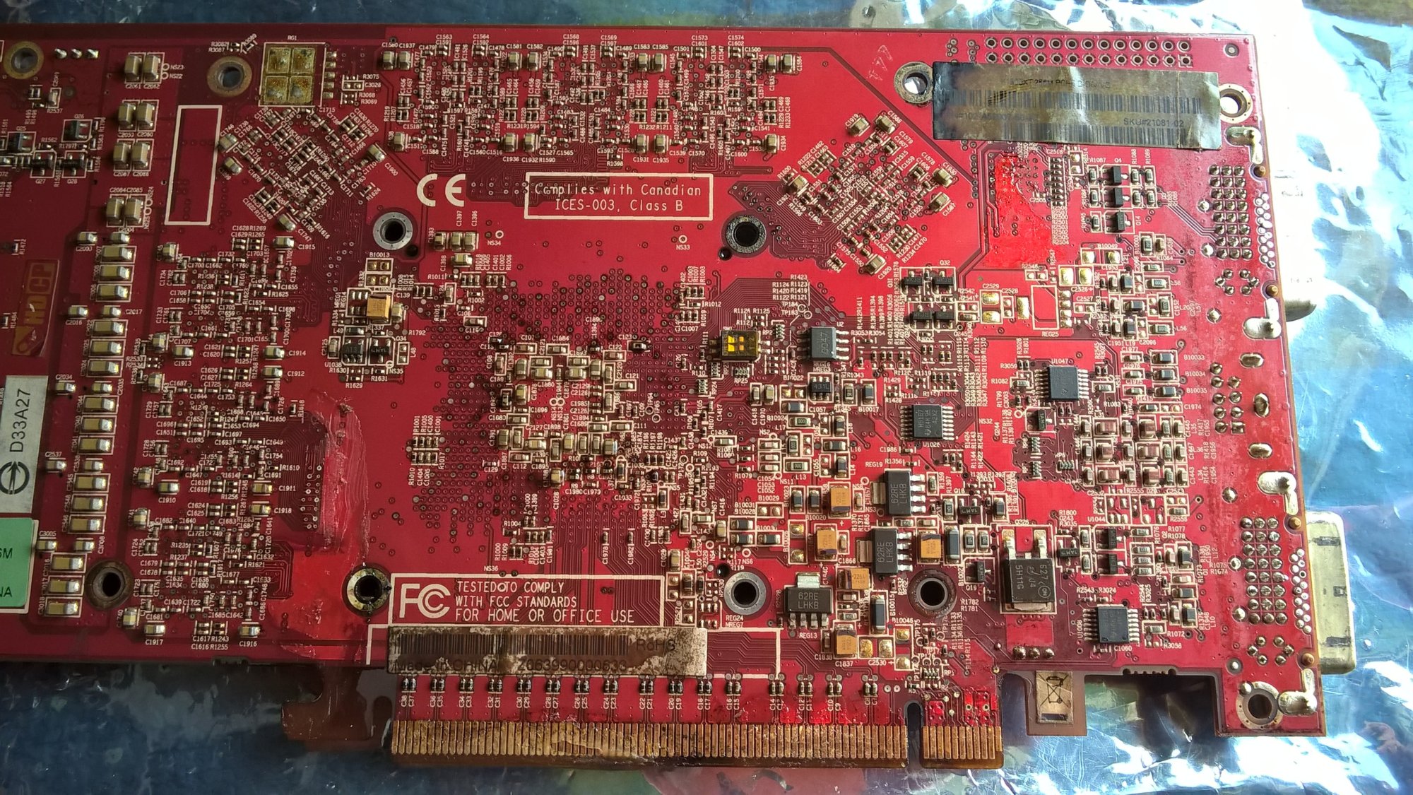

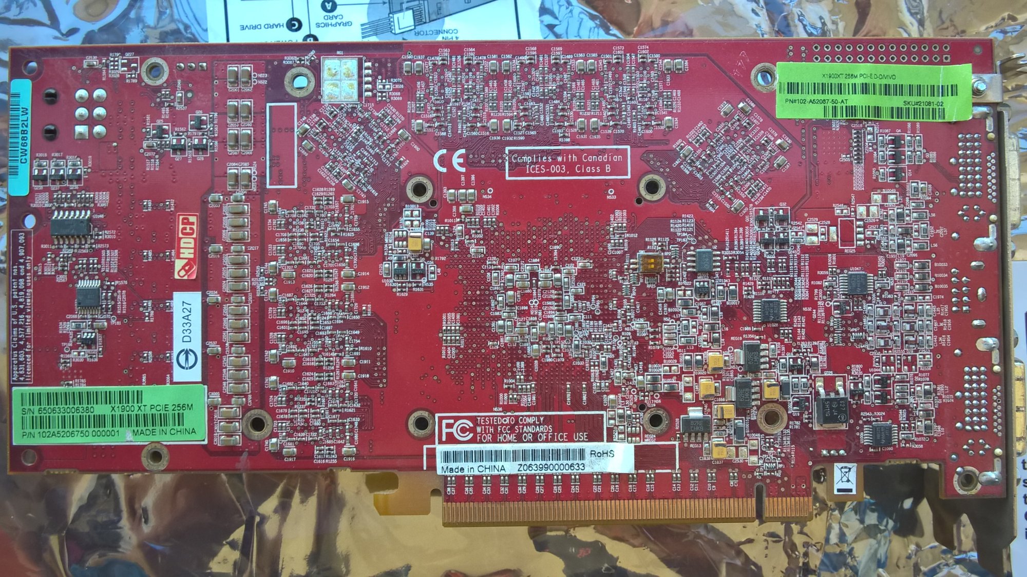

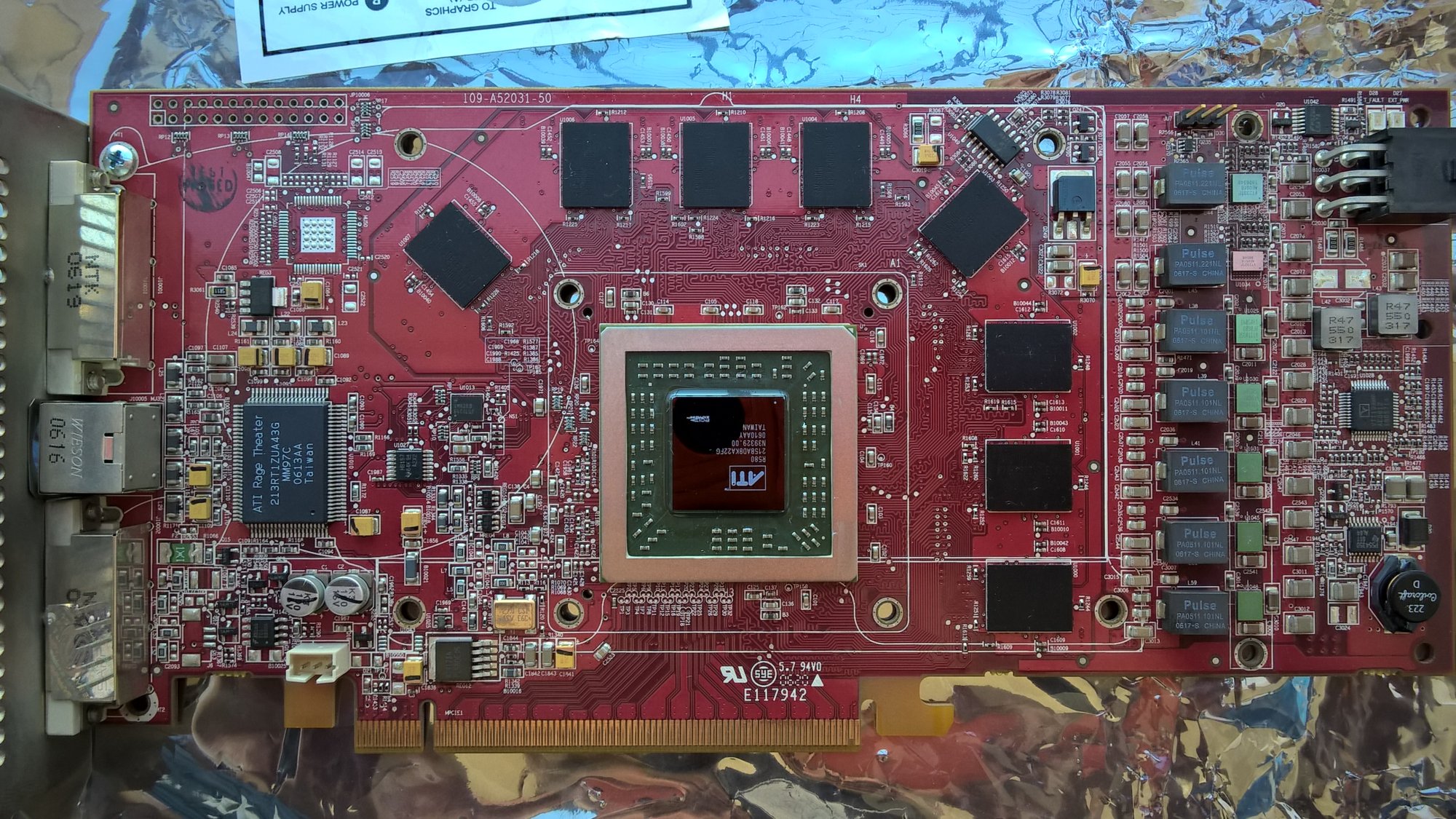

    Here you can see high-res pics of the front and the back of the PCB:
    http://www.vgamuseum.info/images/zaa...900XT_fwhq.jpg
    http://www.vgamuseum.info/images/zaa...1900XT_bhq.jpg

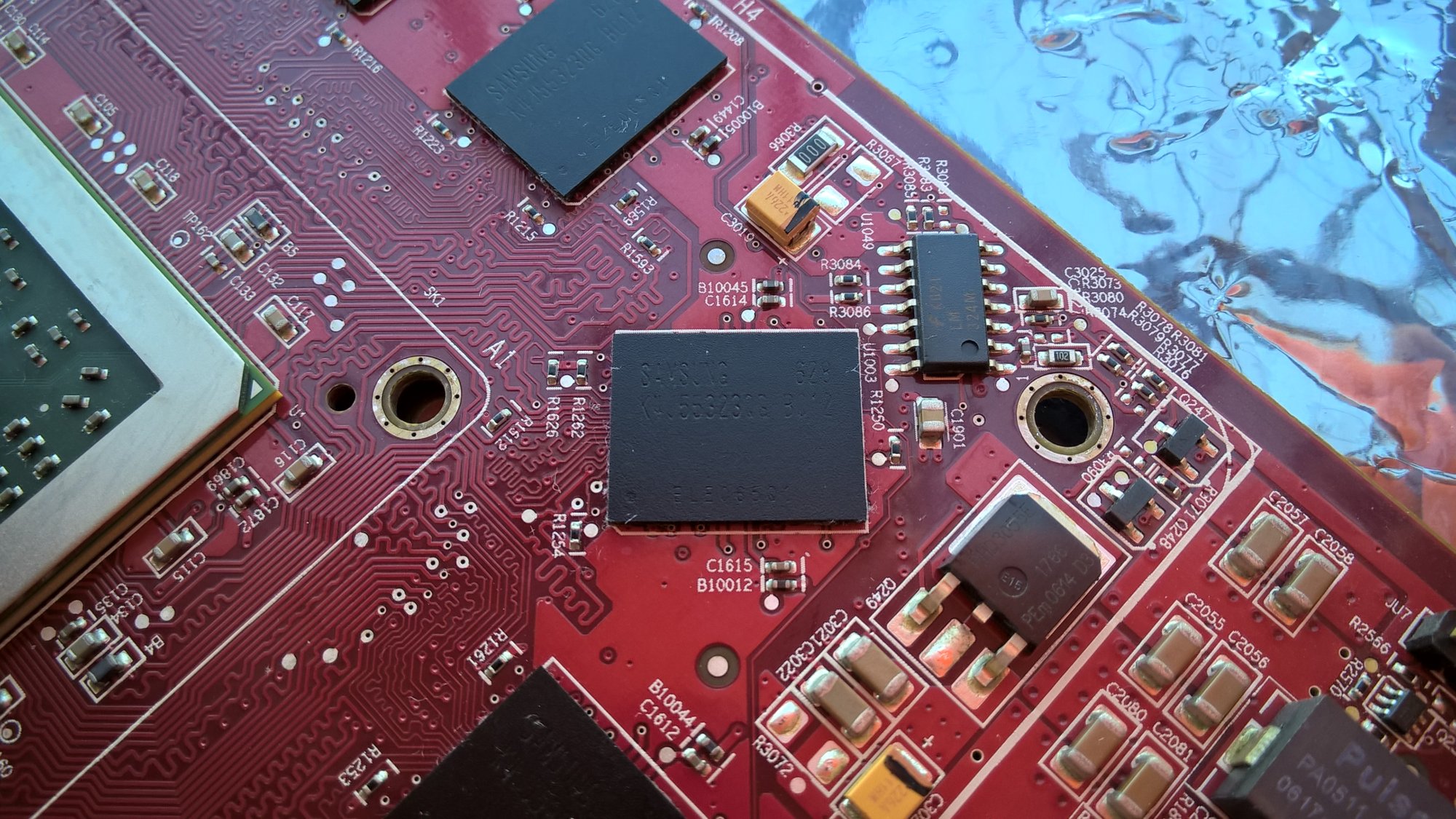

    Yeah, my guess would be it's the solder on the RAM chips. This looks like a card from the early days of lead free solder

      i suggest u post actual pictures of your card. i had the same problem with red dot artifacts as u with my msi 8800 gt oc. the problem turned out to be the qimondagate (infineongate) vram. problem was fixed by downclocking the vram 50-100mhz. check what brand of video ram is used on your card.

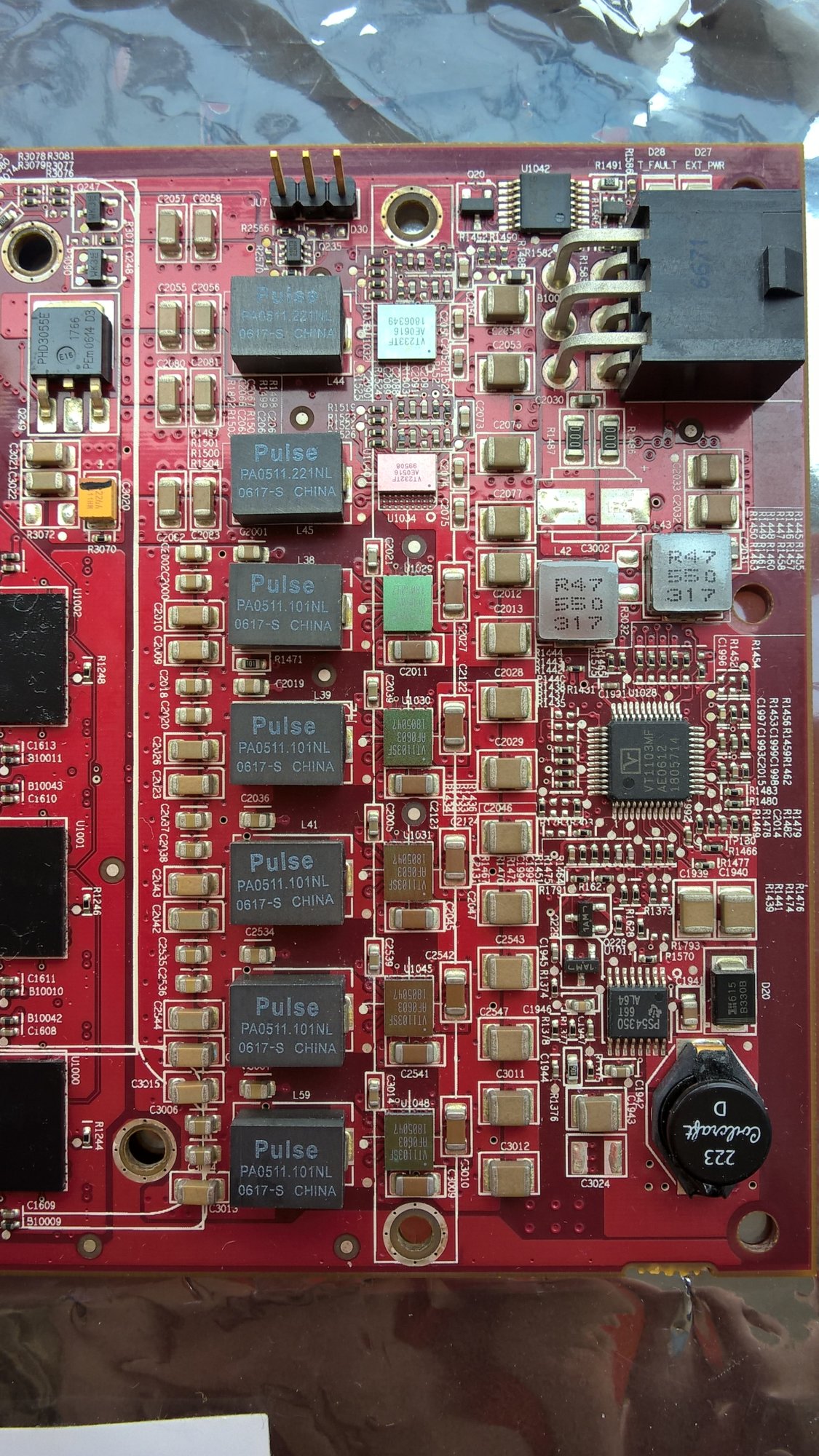

              I have attached pictures of the actual card since you asked.

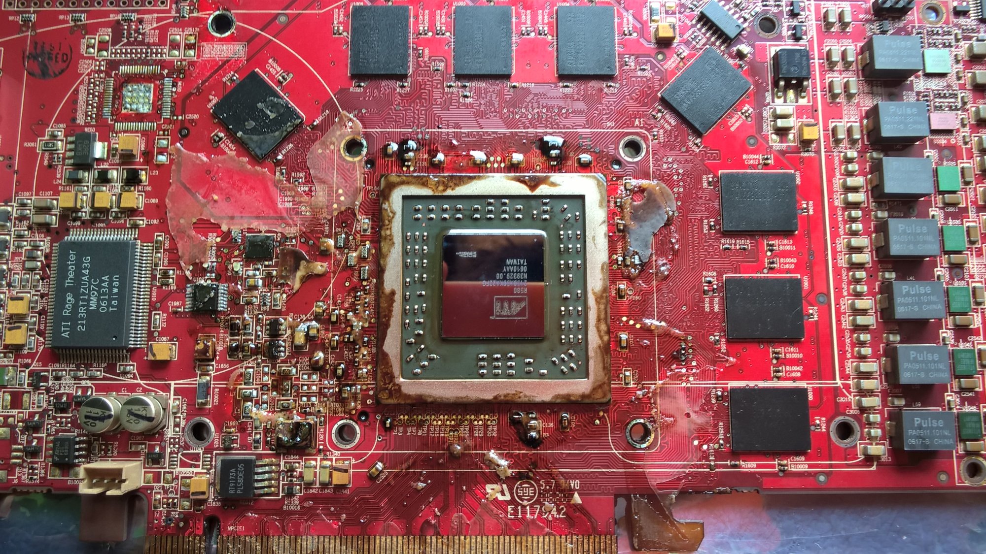

              So what I did the other day is:
              - I took off the stock heatsink
              - for the first time ever in the life of this card I took off the VRM heatsink and the crappy stock thermal pad, and I probably shouldn't have done this. The problem is that the thermal pad had a thickness to it and the heatsink wouldn't make contact with the VRMs using normal thermal paste. This because the two ends of the heatsink where taller than the actual contact surface so I sanded them off. I immediately thought that the heatsink could short something but it looked fine at first then upon closer inspection (when I took the hs off again after powering the card and seeing it didn't work any longer) I saw that the bigger SMDs are just as high as the VRMs so there may have been a short anywhere inside the area below the heatsink.
              - cleaned the card, brushed the back with a toothbrush to remove the dust that wouldn't come off with compressed air.

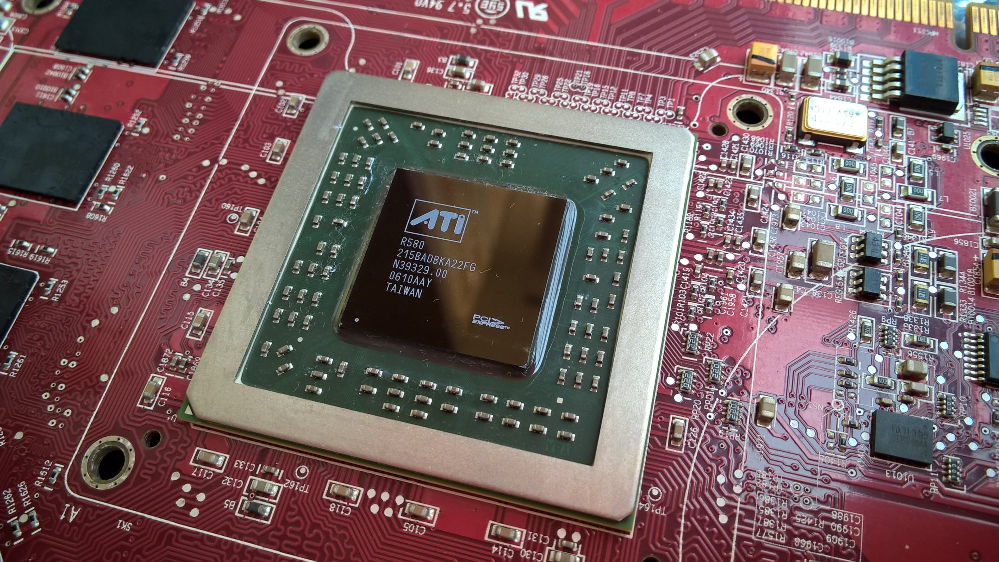

              - cleaned the GPU and the VRMs, I noticed that the GPU has two chipped corners, minor stuff, shouldn't be much of a deal. I think they have been there for years but I'm not sure, I don't have any old pictures of the card with the hs off.
              - applied new paste on the VRMs and the GPU, then mounted the VRM stock hs back on and a different hs on the GPU.
              Then I tried the card and it didn't work. I know, I did too many different things and now I don't know where the problem is but I was totally sure it would work as usual. The one thing I had never done before is removing the VRM heatsink, I had already removed the stock hs many times in the past and mounted the other heatsink as well, so it was nothing new.
                    dont really notice where is the chipped part is? is it at the bottom left and right corner of the die? (the die is the shiny/glossy raised black part of the chip) it looks more like either a cosmetic defect or a reflection due to the light to me. shouldnt affect the functionality of the chip. dont see any exposed copper on there.
                    or do u mean the square shaped silver metallic thing on the substrate (the substrate is the green part of the chip) called the shim? the shim is just to protect the die from cracking due to excess mounting force from the heatsink. since your gpu is protected by a shim, its not likely the die can be cracked or damaged from mounting/dismounting the heatsink repeatedly or by excess force.
                        I was talking about the die. You can see the two bottom corners are lightly chipped, the right one more than the left one.

                            Is the heatsink for the VRM also the same heatsink that goes on top of the GPU?
                            Yes, they look very small, so I don't think they will be a problem either. I've seen considerably bigger chips before with the hardware still working.

                              Re: X1900 XT displaying artifacts
                              No, it's a different heatsink.

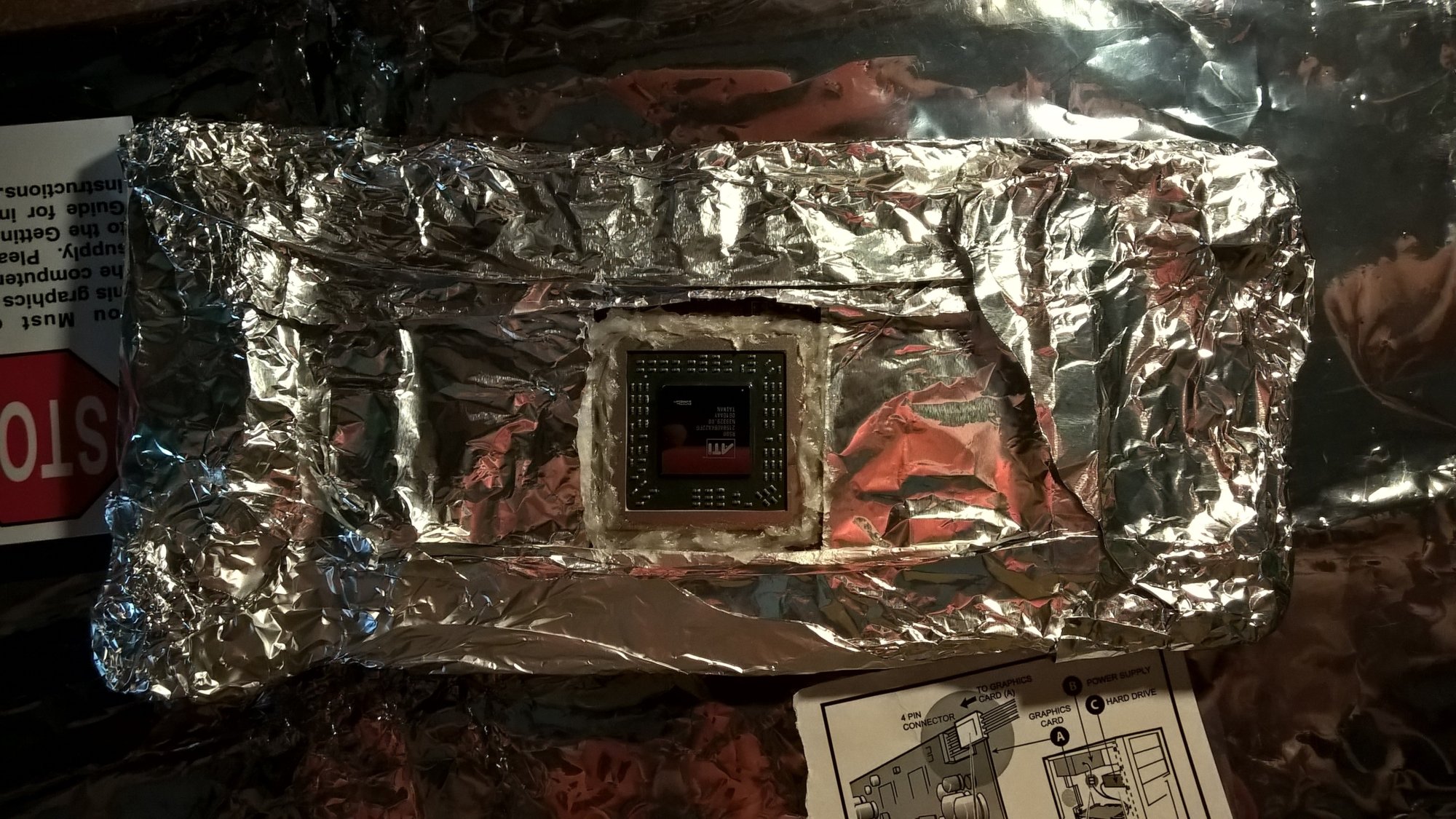

                              I was planning to shield the rest of the card with tinfoil and leave just the GPU and its rear exposed, that should do.
                              Now I have found some flux in gel form, but maybe a friend of mine can get me some liquid flux. Would you suggest me to use the gel flux or the liquid flux?

                                  Well, you don't have any aluminum electrolytic and polymer capacitors on your card, so you don't have to do this. The only thing you might want to cover with foil are plastics, since they can deform, melt, or become yellow.
                                  The form of the flux is not important. Both gel and liquid will work if they are the right type. That said, the flux should be be "RMA" type (preferably) or standard RoHS rosin non-activated (i.e. mean for lead-free soldering, which means it won't evaporate as easily at higher temperature). *AVOID* RA (Rosin Activated) types and any flux meant for plumbing / copper pipes - those fluxes are aggressive and will eat traces on the board over time.
                                  Now, if you are using gel flux, put a line of flux on each side of the GPU before putting the card in the oven. With liquid flux, again put some on each side with the board tilted so that the flux goes everywhere. DO NOT over-apply flux, because that can cause the balls under the chip to dislodge and bridge.

                                      Yes, sorry but I got busy with other stuff and then I just forgot to update you.
                                      I eventually did the reflow, and it didn't work.
                                      I shielded the board with tinfoil, applied flux on the sides of the chip (maybe too much) and attempted the reflow. I followed some guide I found here with temperatures up to about 230°C but something obviously went very wrong, as you can see in the pics.
                                      After I let the card cool I took off the tinfoil and saw that the flux was burnt and spread all around the PCB, which had turned to a darker hue of red. The stickers on the back were burnt as well, even if they were under the tinfoil. I though that maybe the temperature was too high but I had been checking it with an oven thermometer.
                                      I tried to clean the board with isopropyl alcohol but I couldn't remove the sticky flux. Then I still decided to try it, and obviously it didn't work. I kept it lying around a few more days, then I binned it.
                                      I guess I'm done with reflows for a while.
                                        uh oh... it looks like u tried to wrap the video card like a baked potato. the foil isnt supposed to be touching the card. the flux too isnt supposed to come into contact with the foil. most likely a chemical reaction occured between the aluminium and the flux causing the charring of the flux that u see. u are also supposed to remove all stickers too as they can combust and turn into carbon in the oven heat.
                                        sorry about the card. i hate to see good ol' stuff go like that too. should have kept it for display as a museum piece.
