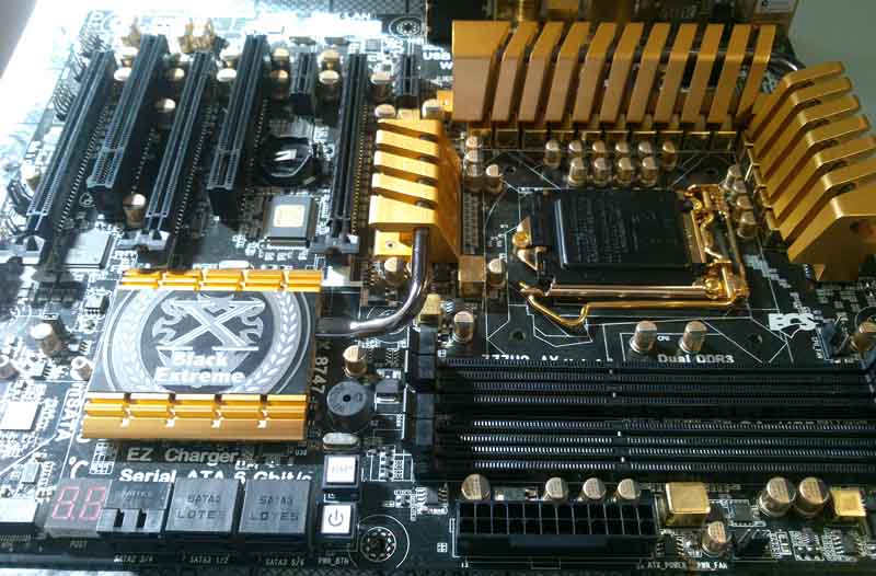

    I have an ECS Z77H2-AX motherboard with an i7 3770K and 8GB Crucial Ballistix Elite memory. I have had various minor issues with the board since I got it. However over the last 6 months or so I had an issue where I could not enter the BIOS. Everytime I went to the BIOS screen, any input from the mouse of keyboard would cause the system to freeze. Only way to change a setting would be to press the clear CMOS button - this would allow me to get past the BIOS splash screen and change settings though I would need to enter all my settings each time. Also when trying to put a small overclock on my CPU I noticed that changing the multiplier would not affect the CPU in Windows - at least not correctly. I have run the CPU with at 4GHZ with no issues but I found that attempting this again the system would display the CPU running at 3.7GHZ.
    So attempting to get to the bottom of this I went into the BIOS after doing a clear CMOS. Set all my settings to my preference, enabled XMP profiles and set my multiplier to 4.2 to see if I could run at that speed ( something I assumed a 3770K should not have a problem with). When I re-booted the system got to the Windows boot, blue screened and then powered off. Since then my PC will not boot. The system starts, fans and lights come on, the debug LED shows activity until it gets to code 32 where the system hangs. I believe that code is 'cpu/memory' issue. The BIOS chip is an AMI Aptio.
    Since then I have stripped the machine apart completely. I suspected maybe battery issue so I replaced the CMOS battery - no help. I tried running the machine with just the CPU and memory - no help. I tried using each stick of memory in all combinations of slot with no help. I tried each stick in each slot individually. I purchased a 2nd user Pentium g630 for testing and that made no difference. I have now purchased a second hand Gigabyte motherboard and my system appears to be working fine now so it seems the ECS board is definitely the problem.
    What I am wondering is if a repair is a possibility. I don't believe any of the caps are faulty, they are all good quality parts and appear fine. My intuition is that the BIOS has become corrupted. I posted on motherboards.org and they suggested someone here may be able to suggest a repair service or course of action -

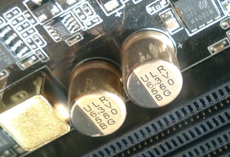

    do not assume anything. post pictures of the board and what caps it actually uses and we will be the judge. poly caps can also go bad and fail like one of our members here found out. another one of our pro tech members has also pulled failed good quality jap poly caps from a board he repaired. this type of failure is typically caused by using a junk psu.

        I've done a visual inspection of the board - checking for domed or leaning caps and they all appear fine. The board is advertised as a 100% solid cap board and this is the top of the line Z77 chipset from the manufacturer as far as I know...
        This is the board....
        The power supply is a Coolermaster Silent Pro M 500W. It is about 3 years old now. I did consider there may be an issue with it but short of buying a voltage meter it's going to be hard to find out. I am currently on a tight budget so I am looking to spend as little money as possible.

              hmm, i have identified the caps on your board as samxon x-con ulr series polymer caps or else the deckard cain of cap identification here, wester547, can correct me.
              btw, poly caps typically dont bloat, dome or lean when they fail. they fail silently. therefore, if any poly caps go bad, its like their failure has been swept under a carpet. poly caps arent as godly as they may have been made out to be.
              anyway, since the system works again with the used board u bought and since u're on a tight budget and lack the tools to fix the board, a cheaper and faster solution for you would be to just sell the board on ebay as faulty for parts or not working for 10-20 pounds.
              fixing a board with a corrupt bios chip is a technically challenging exercise, requiring u to desolder the bios chip, flash it with the proper equipment and soldering it back. the board cant even boot to display the bios boot up screen so swapping the bios chip is the only option.
