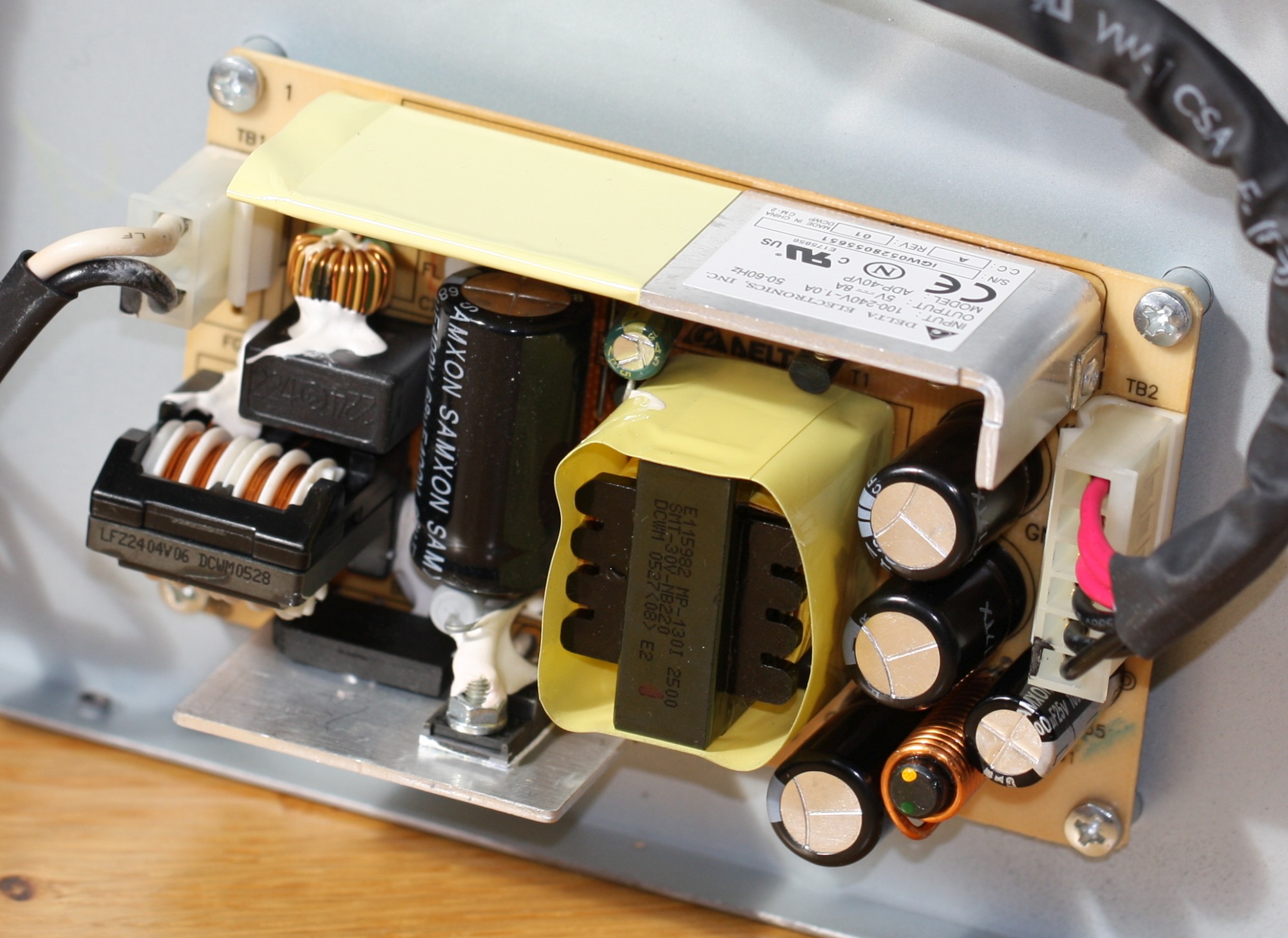

    This switch power LED was lit red and some ports with cables not even in them where lit yellow after a power outage, not a good sign...
    I checked the caps and they visually looked ok and even tested good in circuit.
    The startup and bulk caps where replaced in it some years ago.

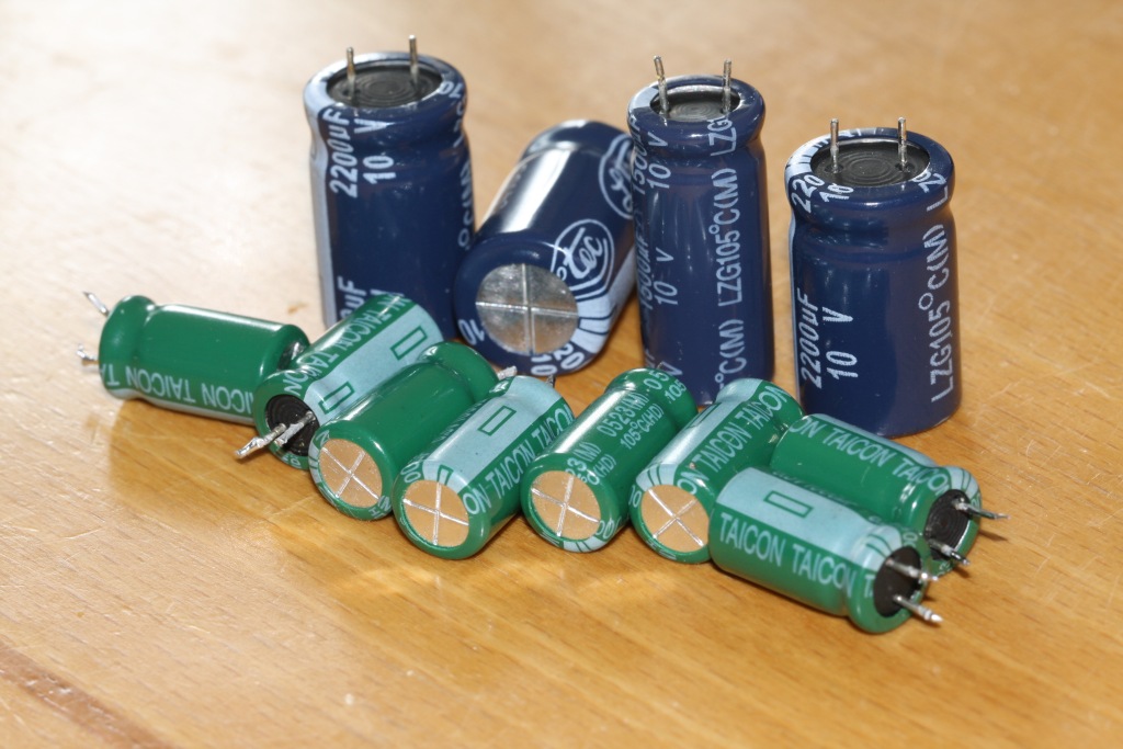

    I first desoldered all 1000uF 6.3v Taicon HD 8x16mm capacitors on the switch and tested them out of circuit and then it became obvious what the problem was:
    Their ESR ranged from 0.11 > 0.98!
    So I replaced them with Rubycon ZLJ 1000uF 10v 8x20mm caps (10000 hours lifetime!)

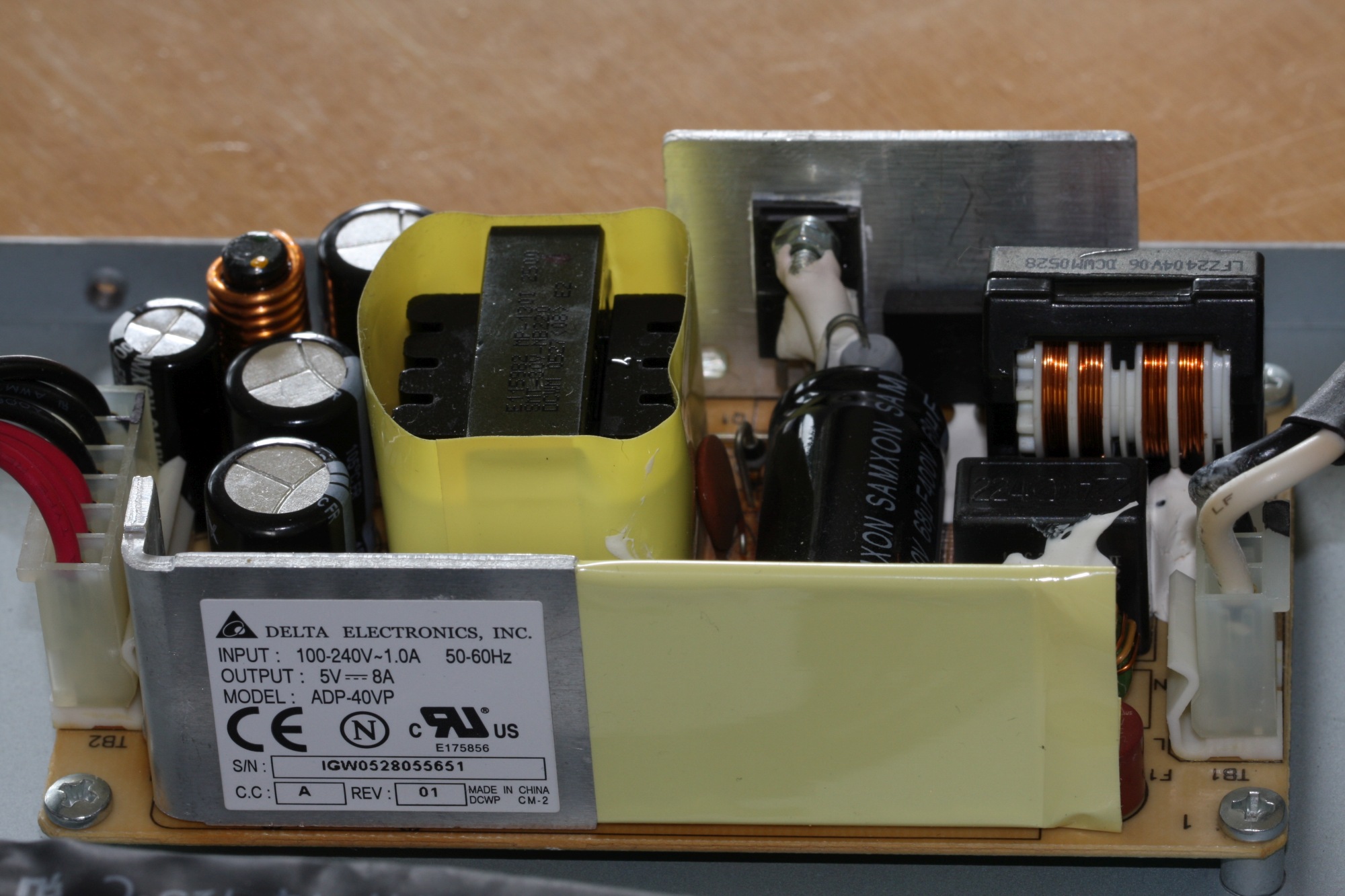

    Next I checked the ADP-40VP PSU where the caps also had measured ok in circuit.
    Not so out of circuit: The Ltec LZG 2200uF 10v 12.5x20mm ranged in ESR from 0.05 to 0.80 & the lone Ltec LZG 1500uF 10v 10x23mm measured 0.05.
    They got replaced with Panasonic FR 2200uF 16v caps in matching dimensions and the lone 1500uF cap got replaced with a Samxon GT 1000uF 25v cap in matching dimensions.
    I checked ripple before and after the recap and it was an improvement at idle.
    Though with a load the ripple is around 80mV which is not so great... (Did not check the load ripple before the recap).
    I can't really fault the original caps, the switch is 10 years old now and has been running pretty much 24/7, but with the new caps rated for 10000 hours I'd be surprised if they fail within my lifetime
    I also saw when Googling this PSU that there exists a direct replacement from Artesyn: NLP40-7605J which RS, Farnell, Mouser and Digikey stocks.

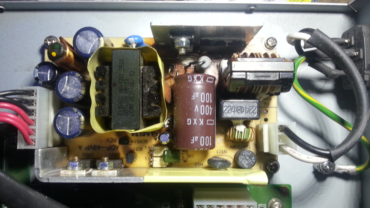

      That PSU should indeed last a very long time. The only thing I am concerned about is the heat/burn marks under the primary bulk cap. Does the PSU run hot, especially in that area? If yes, I wonder why only the primary side and nowhere else. SMD snubber network on the solder side, perhaps?

        I have an identical PSU in a Dell PowerConnect 2724.
        It also has a heat mark in the same place, a bit worse.
        The big primary cap on mine was visibly bulging, so i wonder if that would cause the resistor to heat up ?

            momaka: Yea the heating on the primary side was caused by the primary capacitor failing, which is a very common failure mode in this PSU.
            There even exists "rebuild kits" on eBay for it...
            TechGeek: Heh, left that part out didn't I? Yea it's working fine after the recap
            I was a little skeptical at first because I know from Linksys routers that when ports are lit randomly without a cable plugged in it's usually CPU damage...
            diif: I think the failing bulk capacitor causes the diodes to work too hard with resulting overheating.
