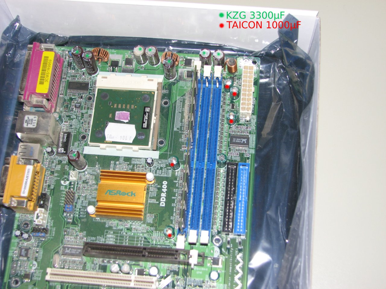

    Hi all
    my first post here
    found this in my brothers computer,
    the mainboard is still working fine in spite of the 5 open caps.
    all big brown KZG 3300uF caps still seem to be fine.
    well the smaller taicon 1000uF caps are
    I guess taicon is a rather bad company?
    I will try to replace them, would Yageo caps be o.k. for that? (looks like its rather difficult to get something different in europe)
    Btw: would be a temperature controlled (150-450°C) soldering iron enough for that or do i need more equipment?
    Thanks for helping me & sry for my bad english
    olaf

    Re: Asrock K7S8X R3.0
    Depends on the specs of those Yageos. Do you have any other info on those?
    Re the soldering iron: if it has at least 30W, it's fine. Make sure you have enough solder, it's much easier if you use LOTS of it.
    btw, it's not impossible to get decent parts in Europe...where exactly do you live?

        Just checked on Yageo and found out that they own Teapo.
        ewwwwww...... wouldn't trust these in a mainboard, probably they are identical to the Teapos, as they use the same series numbers.
        I sent you a PM about availability in Austria.
          those Yeago / Teapo would probably work, but not much longer then those Taicon.
          So if kikkoman can`t suit your needs, there is www.rs-components.at, which probably can (ok, 20€ min order ...).
          I would suggest some decent Panasonic FM`s or Samxon.
            Check out your PSU. The odds are pretty good that the 3.3v rail (and maybe other rails too) has failed caps on it, which in turn contributed to the failure of the Taicons (which are known bad caps) on the mobo.
              Failure of Taicons on this particular board (or better the series of K7S8 boards) is inevitable.
              Sure checking the PSu never hurts with this current sucking board (only 5v powered), but even the best would not influence the well being of this shit caps in this particular bad design (hot temperature due to linear voltage regulator).
                    I would fix it once, thus replace all of Taicon caps.
                      That board is a joke. 2 Phase VRM? I would replace ALL the Taicons. Sure, replacing the dead ones alone will get the baord up and running, but eventually you will have to replace the other Taicons as well..
