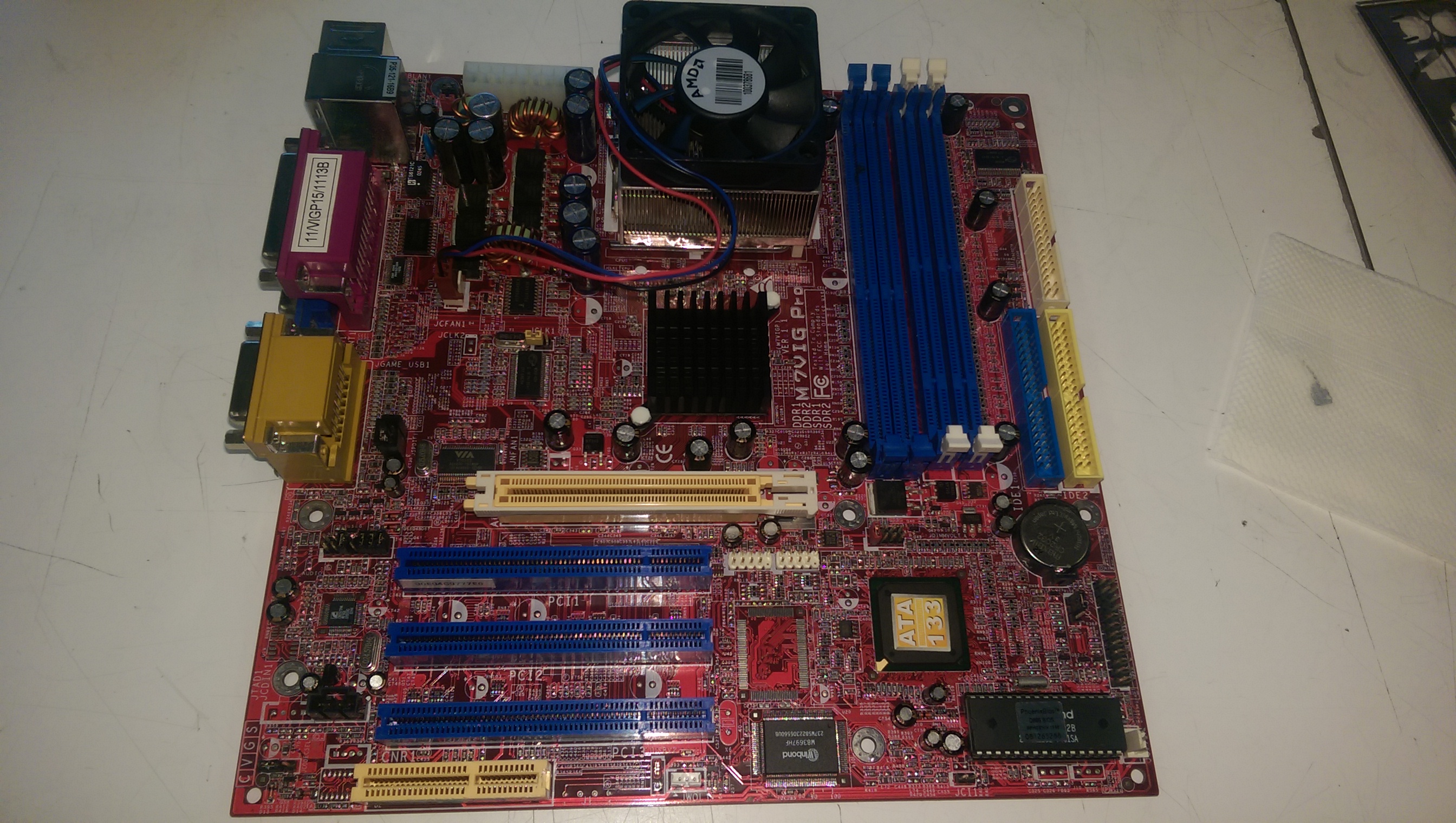

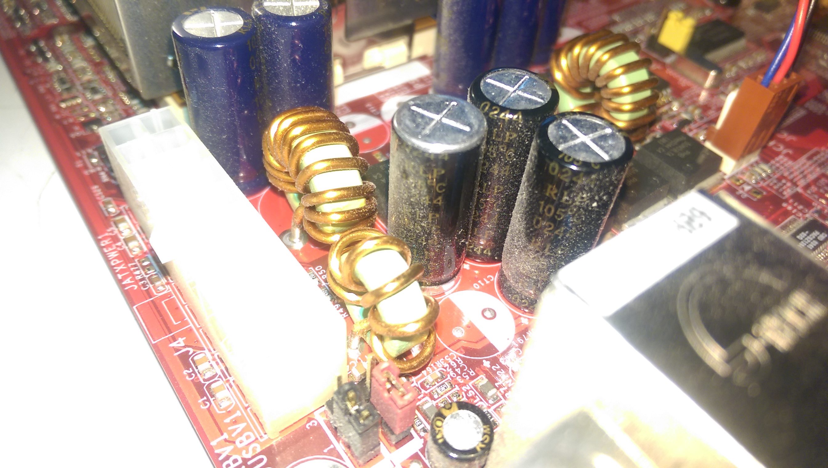

      Re: Biostar M7VIG Pro
      Originally posted by Pentium4

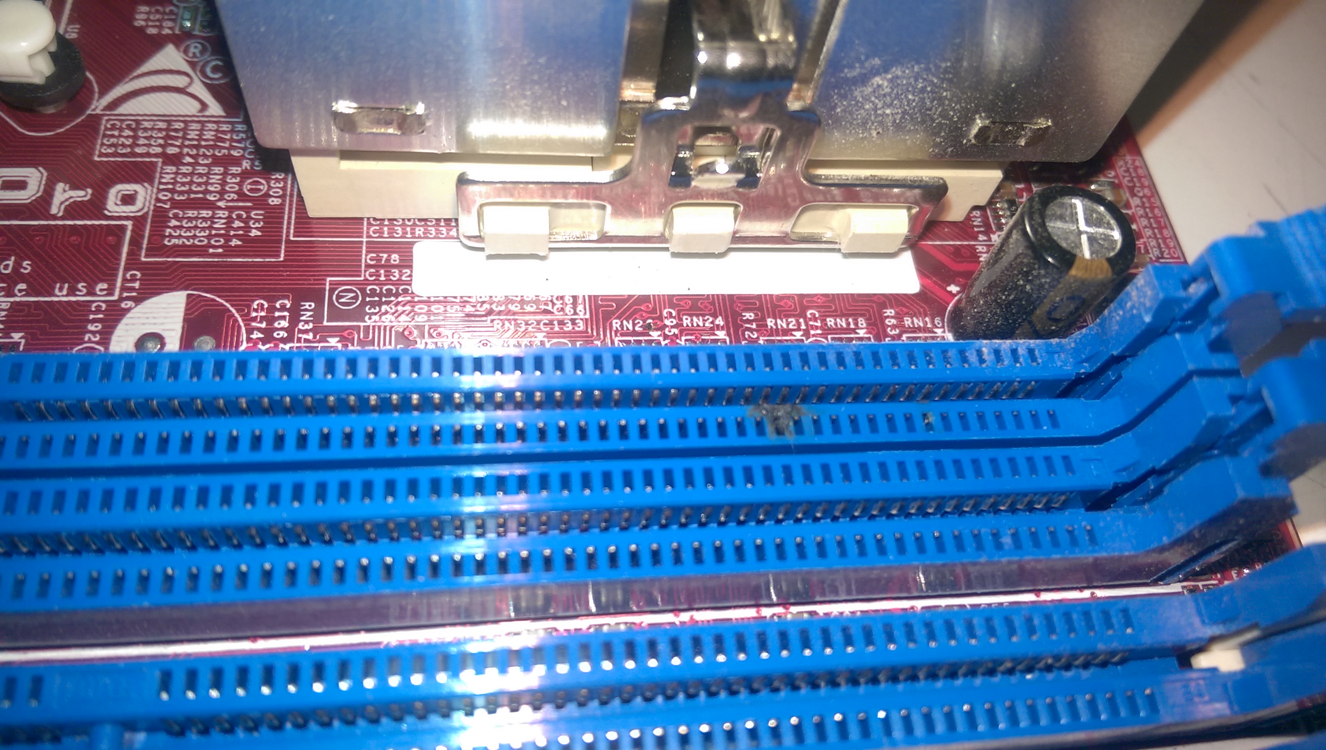

      Only thing I could spot wrong with it was a potentially fried DDR RAM slot, and an OST on the VRM high that got so hot that the sleeve shrunk. Interesting how they used 16V caps for 5V in for the VRM. Probably just for the lower ESR. Just sitting at the BIOS, the exterior of those VRM high caps got to 63C. That's pretty warm...
      63C? Ouch.
      Yes, they likely used the 16V caps for lower ESR. My JetWay N2PAP-Lite was like that too, except it used GSC ME caps (none of them were bad at the time of replacing, though).
      By the way, this is the first BioStar motherboard I see with more than 5 caps for the VRM low side. Those empty spots look ashamed. Fill 'er up .
      My vote goes for Panasonic FR of FM. Or even Chemicon KZE / Rubycon ZL will work. Save your valuable HM. HN, and HZs for something else that needs them. Those old Athlons run at 1.6V core or thereabouts, and they don't consume a whole lot of power, so it takes for quite a bit of ripple to appear on the VRM low side before things go bad. That's how they got away with using nearly general purpose crappy caps back in the days.

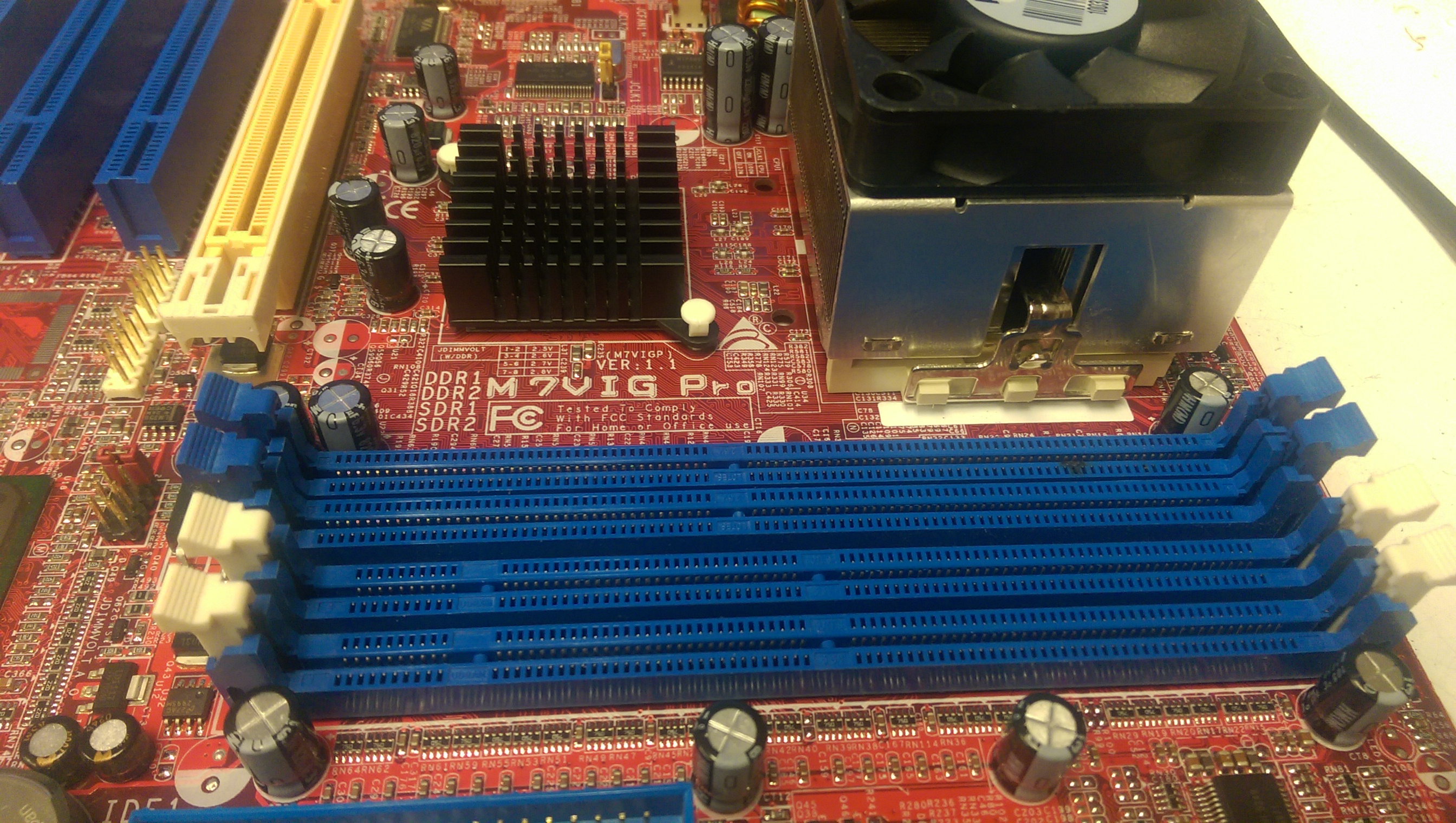

      Besides the VRM, all the other caps on the board are GP. Was it just not necessary on older boards? They're all OST RLG. Would regular motherboard grade caps be too low for this old thing?
      Except the CPU VRM (and occasionally Northbridge on some motherboards), most stuff back in the day used linear regulators like 1084 or discrete circuit with MOSFETs. Therefore, general purpose caps worked fine for just about everything on those.
      That said, there would be no harm from using very low ESR caps on these boards. In fact, even polies should be fine. I bet that burned RAM slot was a result of either somebody trying to remove the RAM while the PC was plugged in, or just those crappy OSTs.

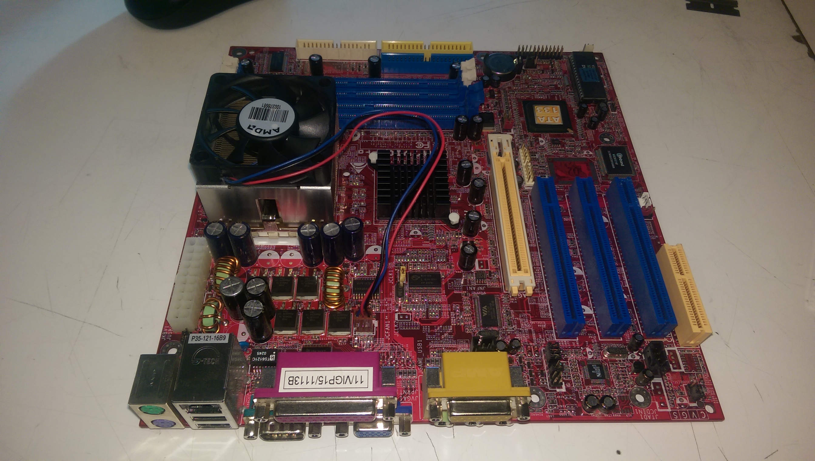

      I think this board is pretty neat. It does not have a fan controller
      Yeah, looks like a decent board indeed. After all, this is the last generation of boards that used through-hole CPU sockets and leaded solder. Should be indestructible with a recap.

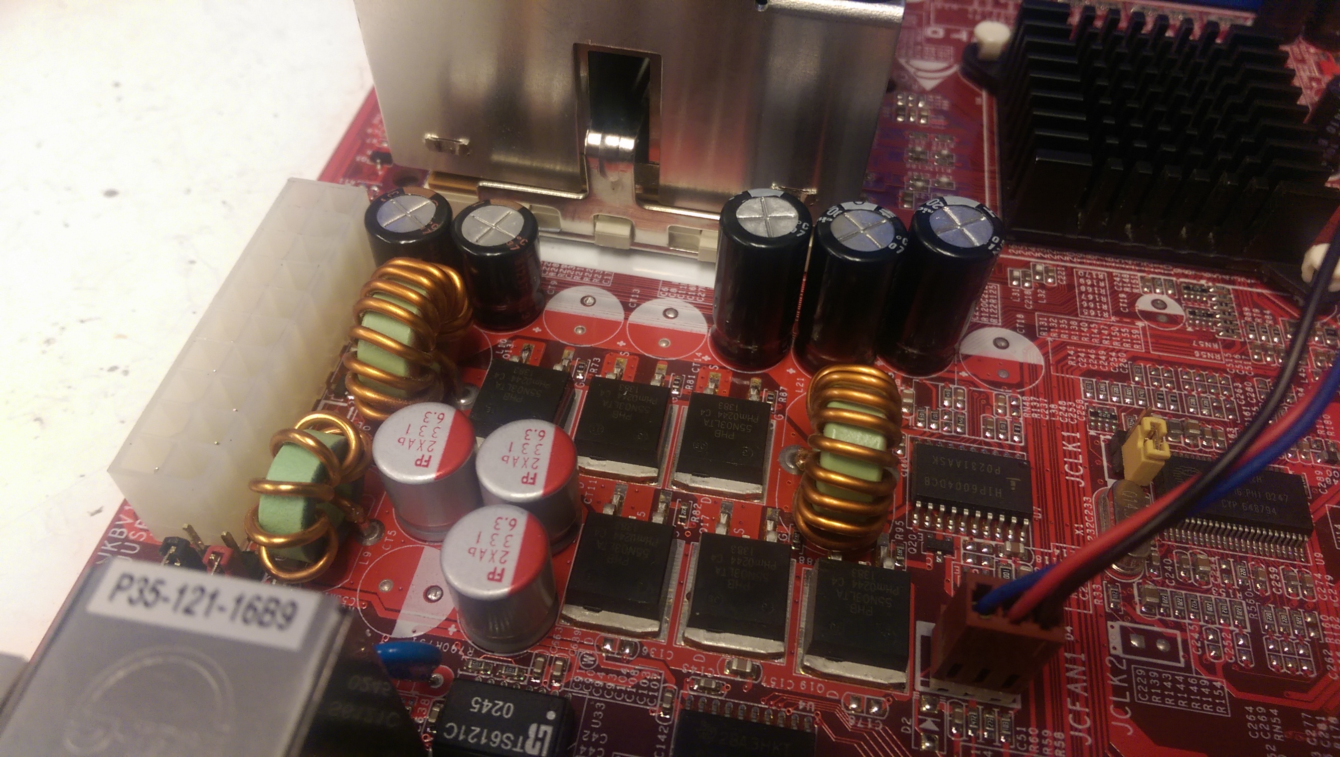

        Originally posted by momaka
        63C? Ouch.
        Thanks for bumping this thread, I had forgotten to update it. I ended up recapping it I think later that day. I ended up using polymer caps for the VRM high since oddly, those caps ran much hotter than the VRM low. Maybe because of those FETs? Ouch, GSC ME? I just replaced some of those also (Well, GSC LE) on the VRM high of a VIA P4 board, and even though none of them bulged, they ALL tested bad. They were all 1500uF 16V 10x25mm. They all tested between 900-1050uF and all were above 0.5Ω ESR. What did yours read?
        I tried! For some reason, I had trouble getting the negative holes to clear. So I left what I put in there, since their ESR is lower than the original. By the way, every single OST cap tested good. The VRM high were closest to being out of spec.

        Very good to know, thanks for the info As you can see, I replaced all the GP caps with nichicon HM.

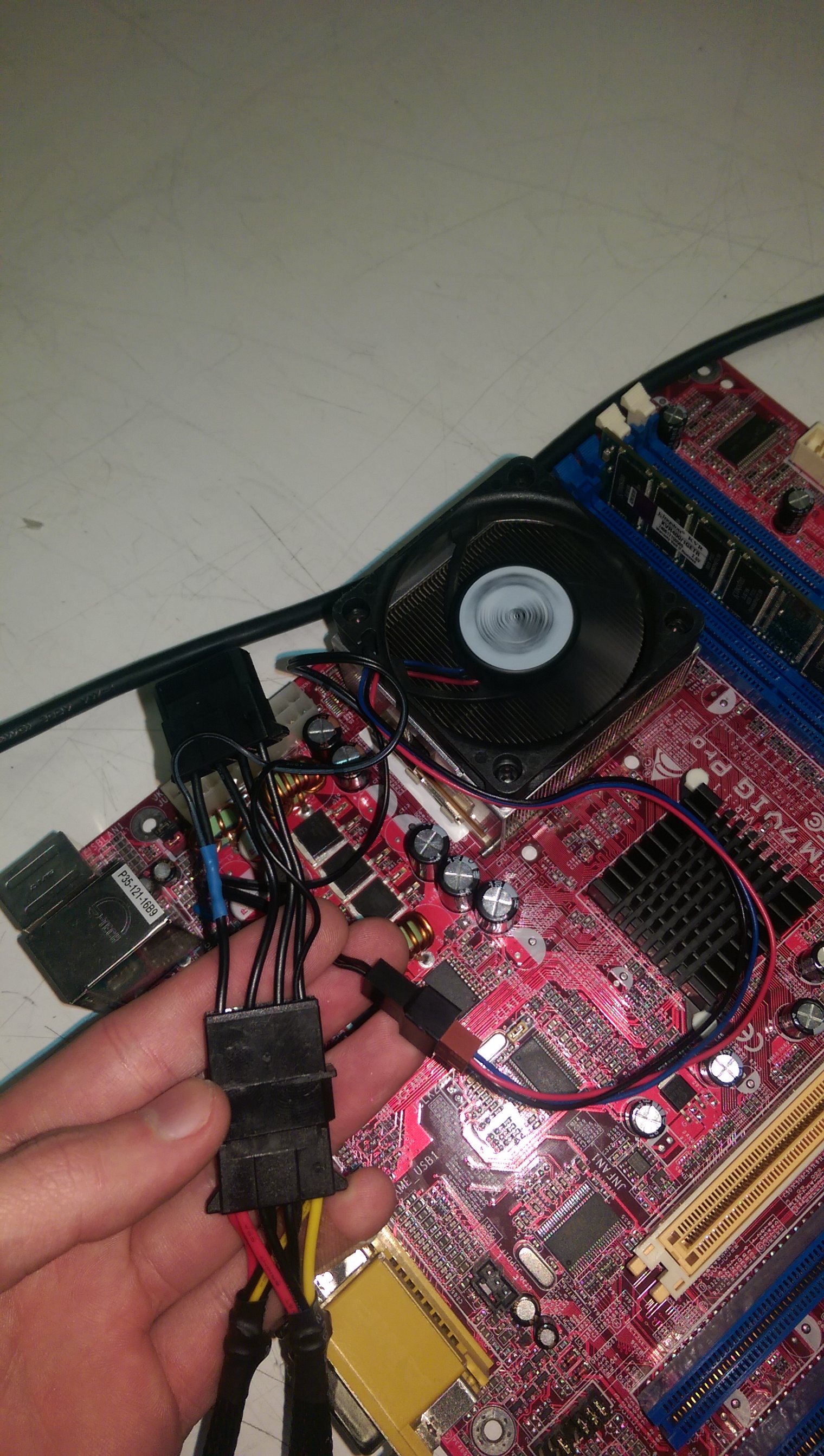

          By the way, I used our simple little voltage trick to get the CPU fan to run much cooler, but still be adequate
            master hoarder
            • May 2008
            • 12175
            • Bulgaria
            ^ 7V trick? I have that on a few "misbehaving" loud PCs as well .
            Yes, it's possible. Both my Jetway N2PAP-Lite and ECS P4VXASD2+ are like that.
            Ouch, GSC ME? ... What did yours read?
            ESR *appeared* in spec, but the capacity on many of them was high and lingering on the border of +20%. I think one or two were above that. That tells me they were likely becoming leaky and ready to go soon (and GO they did ). And when caps go leaky, the ESR will appear fine on an ESR meter.
            That's how early Nichicon HN and HM from the defective batches seem to have failed.
            Interesting.
            I guess this further proves that OST hate the heat.

            Here's something interesting to note from a little experiment I did. With the exact same scenario (Just sitting at the BIOS) with the same PSU and ambient temperature, before and after the recap, the CPU idled 4C cooler afterwards.
            Interesting. So seems like another theory is proven here - that good caps can lower your temperature a bit.
              Gah, I said "cooler" and I meant "quieter" This trick is a lifesaver. I can't stand loud PC's anymore, which is one reason I like Topower PSU's so much, they're always incredibly silent.
