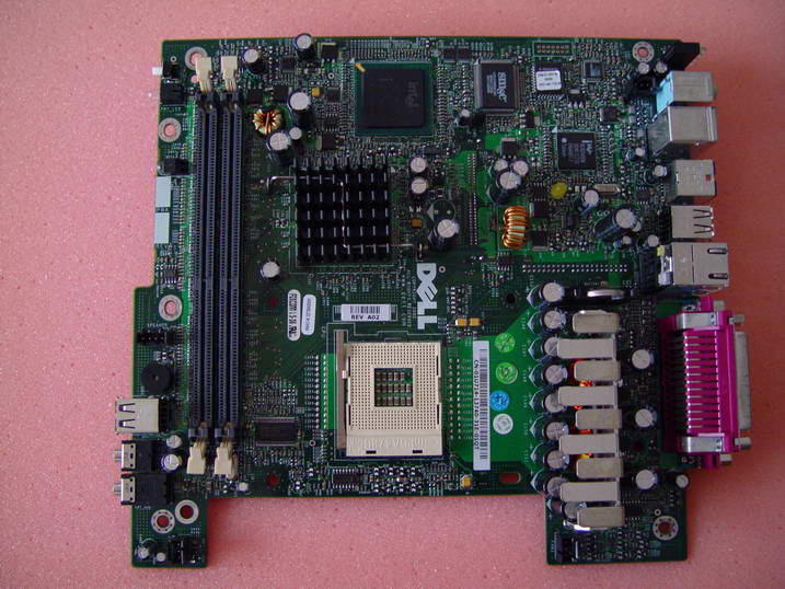

      Re: Dell OptiPlex SX260
      Ultra Small Form Factor Case
      4 years old
      2200uF 6.3v
      3 of 13 showing swelling failure

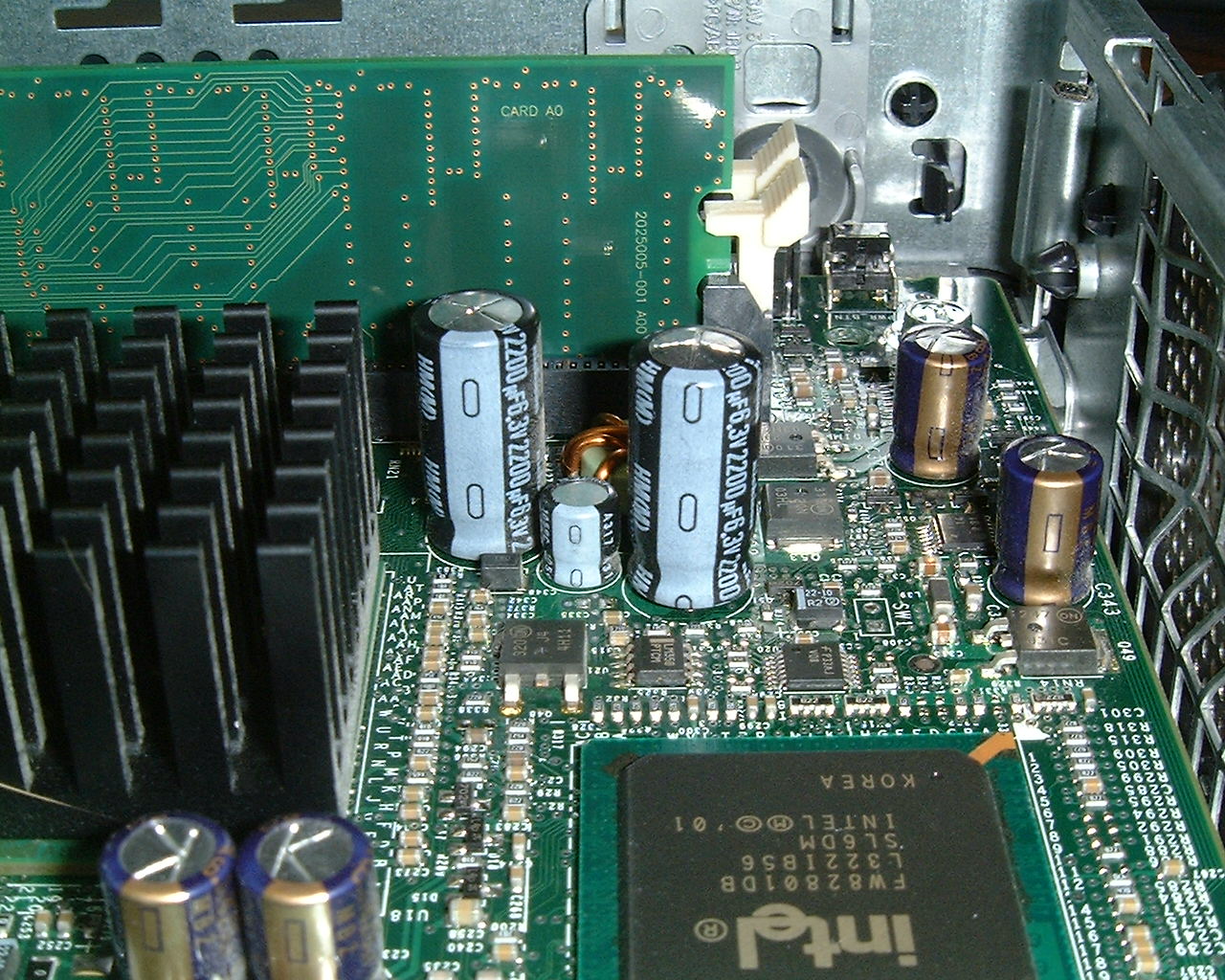

        It took me a while to find a decent picture.
        Nichicon HM from somewhere around 0249, December 2002. It's not unexpected. I'd get the parts and solder it but I like soldering. If you don't mind inspecting every so often you can just replace the 4 that aren't under the heatsink and assume that the heat sink caps are in parallel so they create less heat or they are better cooled from the airflow. For something more turnkey replace them all or get $55 eBay boards.

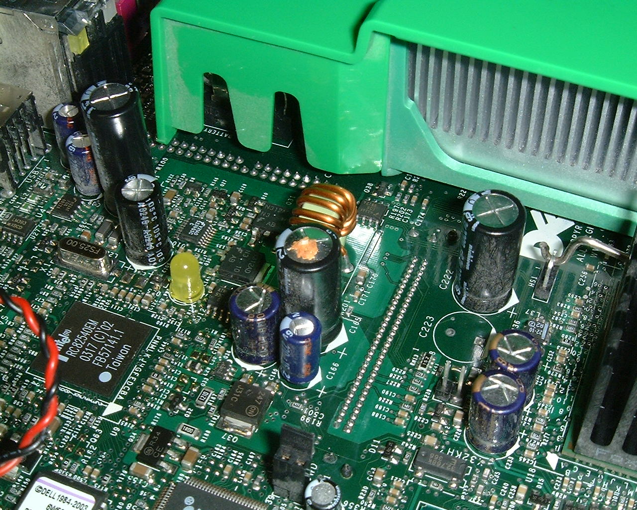

              I'm new here and have never participated in a forum before.
              I have a Dell SX260 machine which stopped working (suddenly). I found several bulging, swelled and a couple of leaking caps.
              Q: Can I use the SX270 kit for this Dell model? If not, I presume I must specify a custom kit.

                This is what I ordered as my version of a SX260 repair kit:
                13x 2200uF 6.3v caps
                4x 1800uF 16v caps
                I have had a lot of success. Five of my machines dropped dead, installed new caps, and had them up and running in an hour each. (5 for 5 so far)
