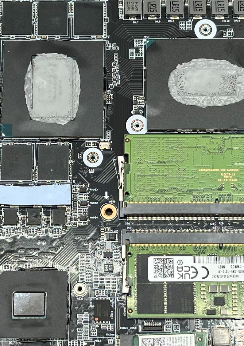

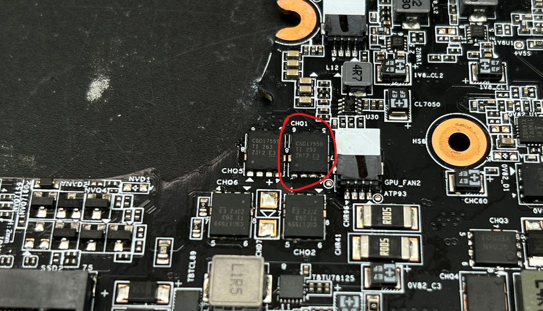

    Hi guys,
    I’m working on an AORUS 17X (unknown board model) that won’t power on. I’ve tested with two original chargers with the same result. On the thermal camera, I can see one MOSFET pulsing/flashing as if it’s trying to switch on.
    Both MOSFETs (1 & 2) show 19.5V as expected. I also replaced this MOSFET (CSD17559Q5) one which flashes, no difference.Click image for larger version
