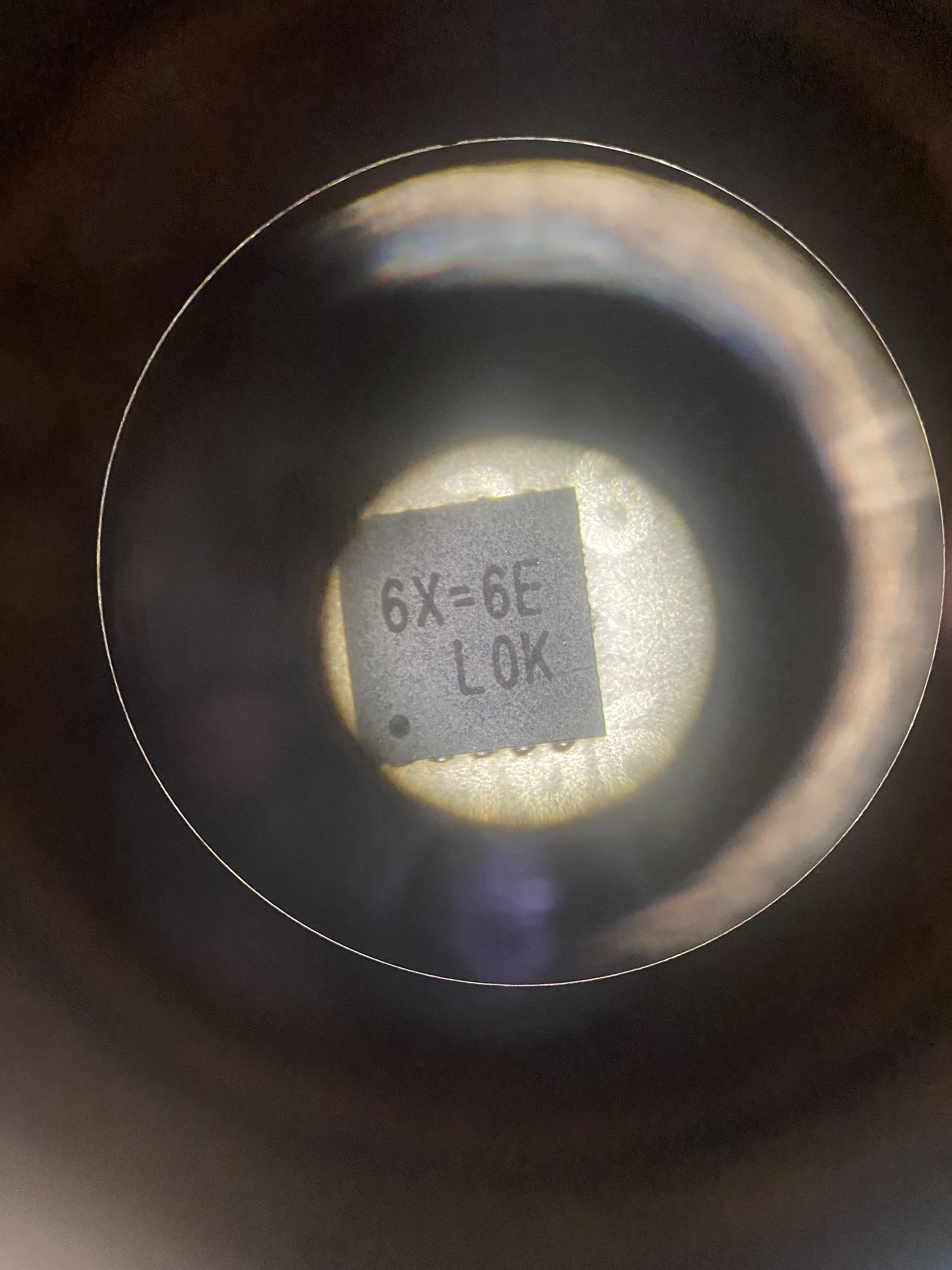

Halo,

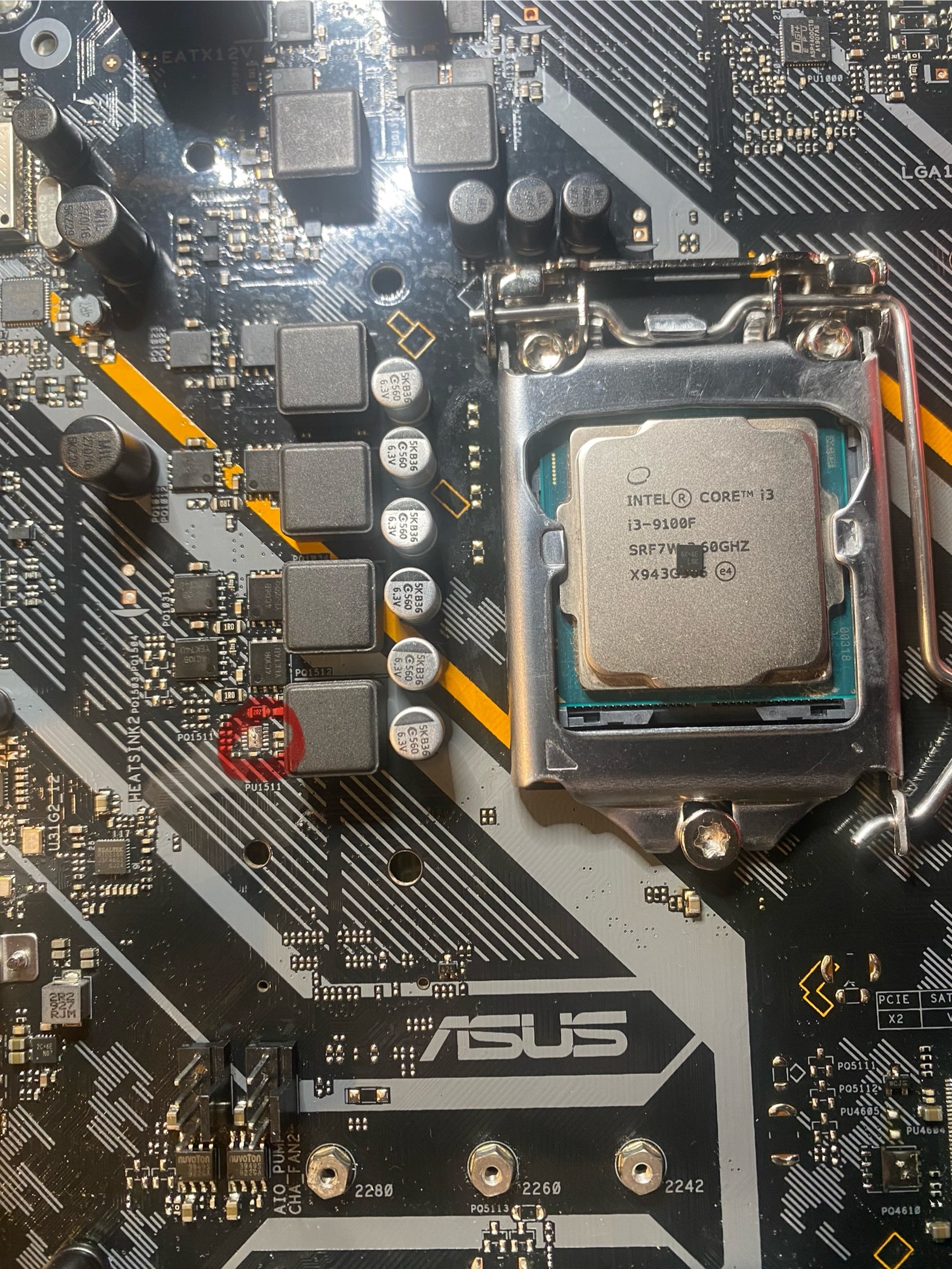

I have to identify this chip. Its coming from a Asus Tuf B360 pro Gaming.
Thank's

PWM CONTROLLER RT8125DGQW

Thank you. May I ask how did you find out, google search didn't found anything.

Parts with an = are usually made by Richtek
https://www.badcaps.net/forum/troubl...19#post1482819
, you just have to google the name and marking code Richtek 6X=
Some parts have the same marking code but are different IC`s in different packages
https://www.badcaps.net/forum/troubl...ic-6x-4x-z3-3k

Thank you for the explanation.

A lot of information! Exactly what I need it.
Thank you very much.
