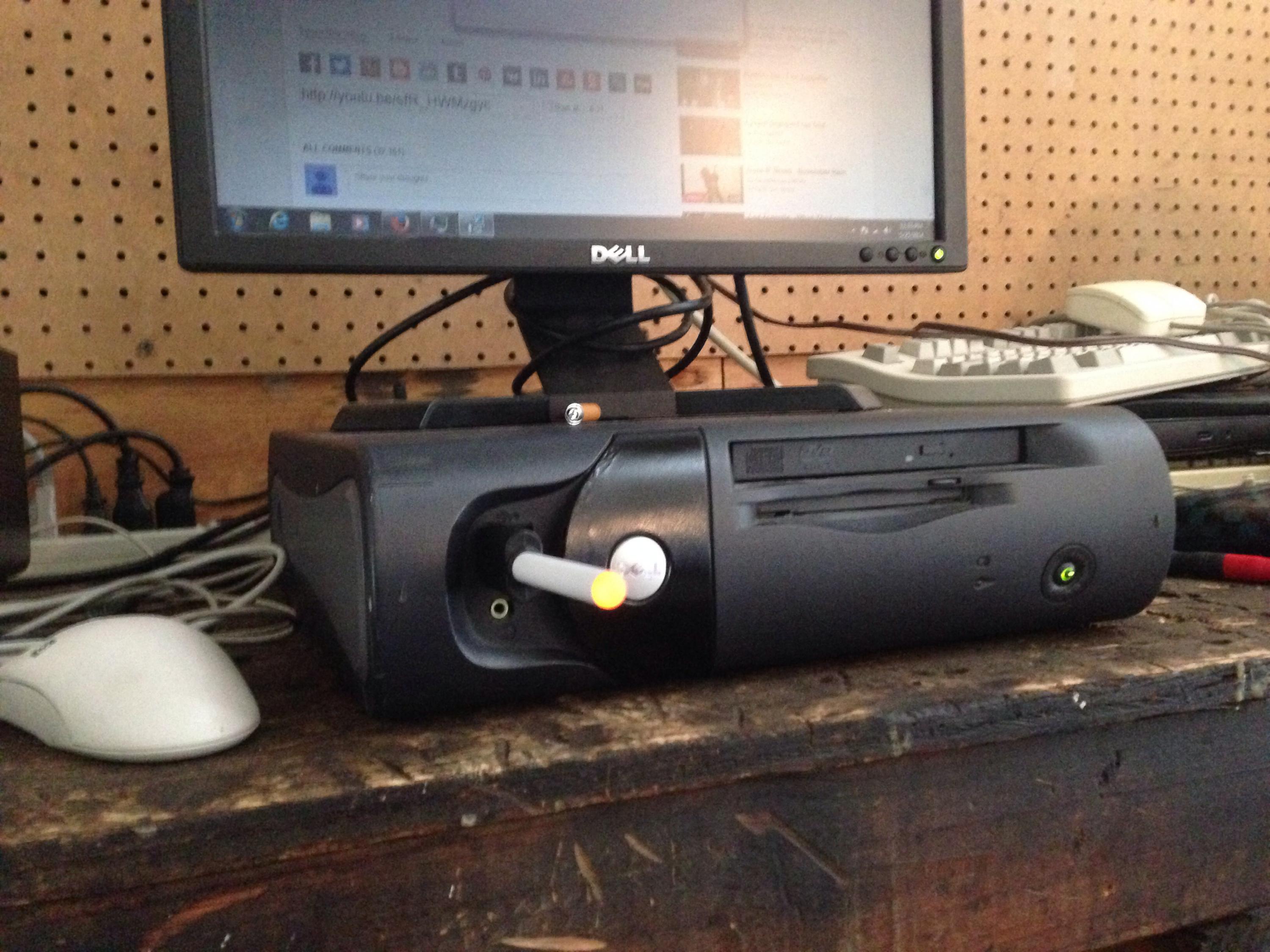

                    My gx270 is smoking, literally.
