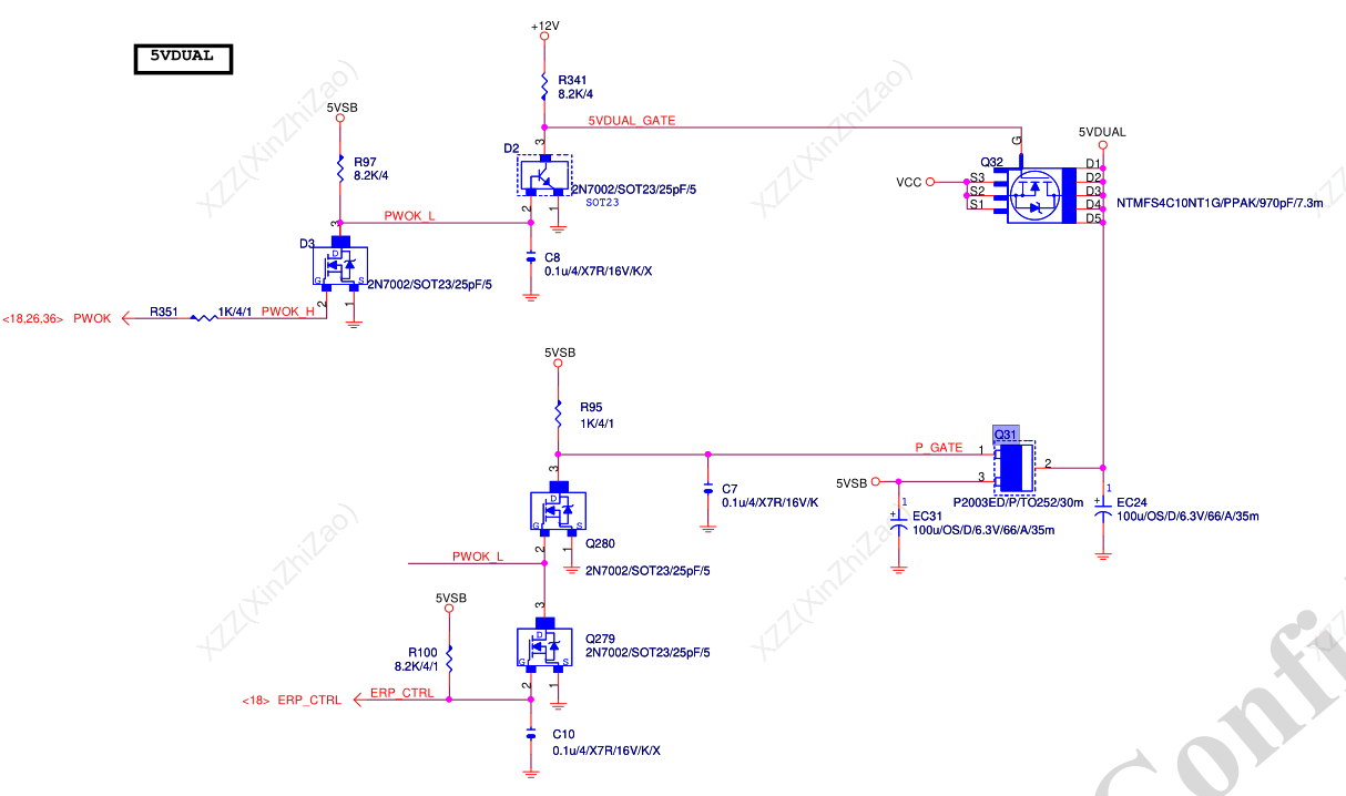

    B450 Aorus Elite r1.0
    basically the board does not boot and have a rotating cpu/dram led on
    all voltages present and everything is in place
    nothing burnt nor ripped
    except for a strange behaviour (ram rgb is on despite the board not switched on and only have 5vsb present only)
    and 5vdual is always present and i don't know why
    cpu&ram are fully functional so not doubt about that
    any help will be accepted

    I have a Gigabyte B450 Aorus Elite Motherboard.
    Originally would not power on
    Reprogram EC eeprom and Bios eeprom with known good from this forum. Now error lights cycle between CPU and Dram.
    I have checked for shorts on all coils and found none.
    I have checked all power rail voltages and chips for pgood signal all good
    Checked CPU socket and found a damage pin, managed to clean and fix it should be making good contact now but no change. Dram and CPU are known good. Dram sockets look good.
    I can't see any...
