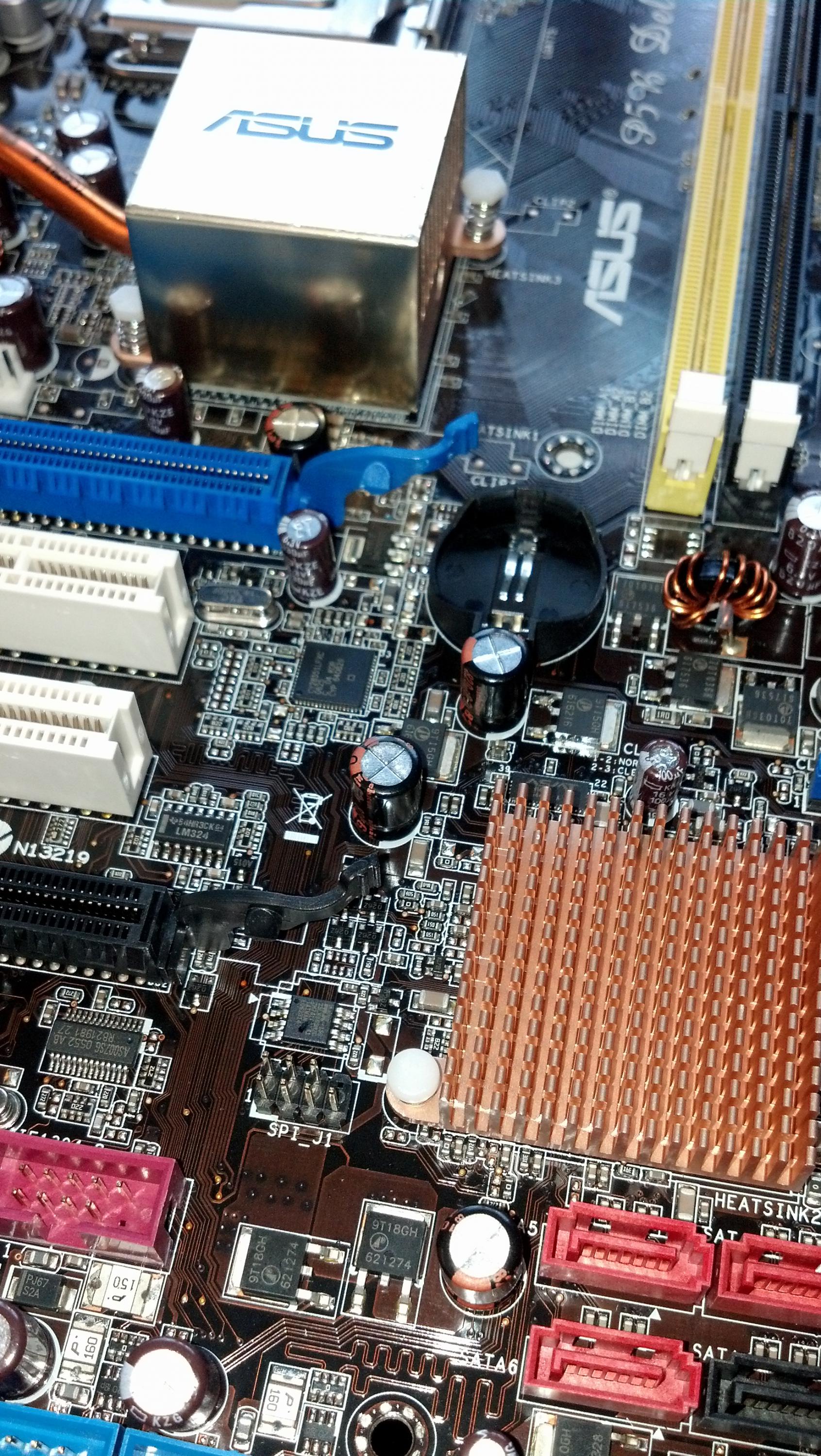

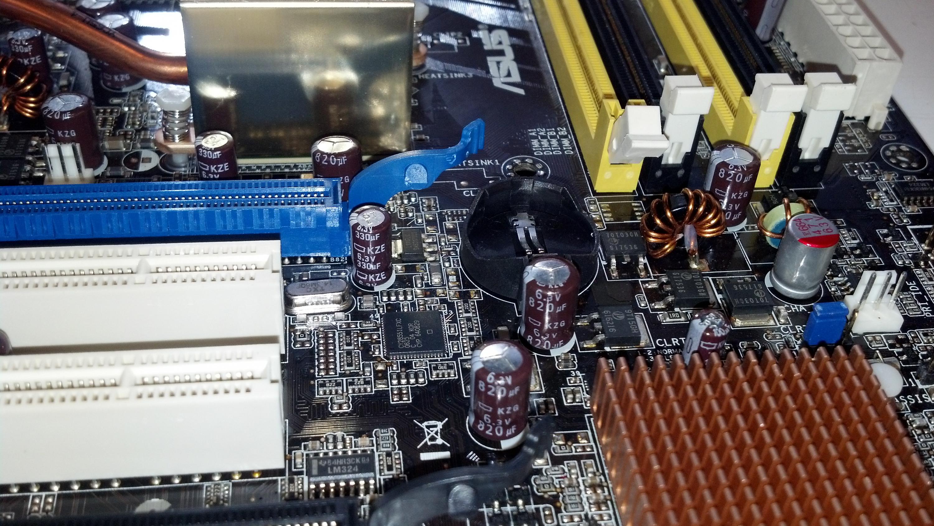

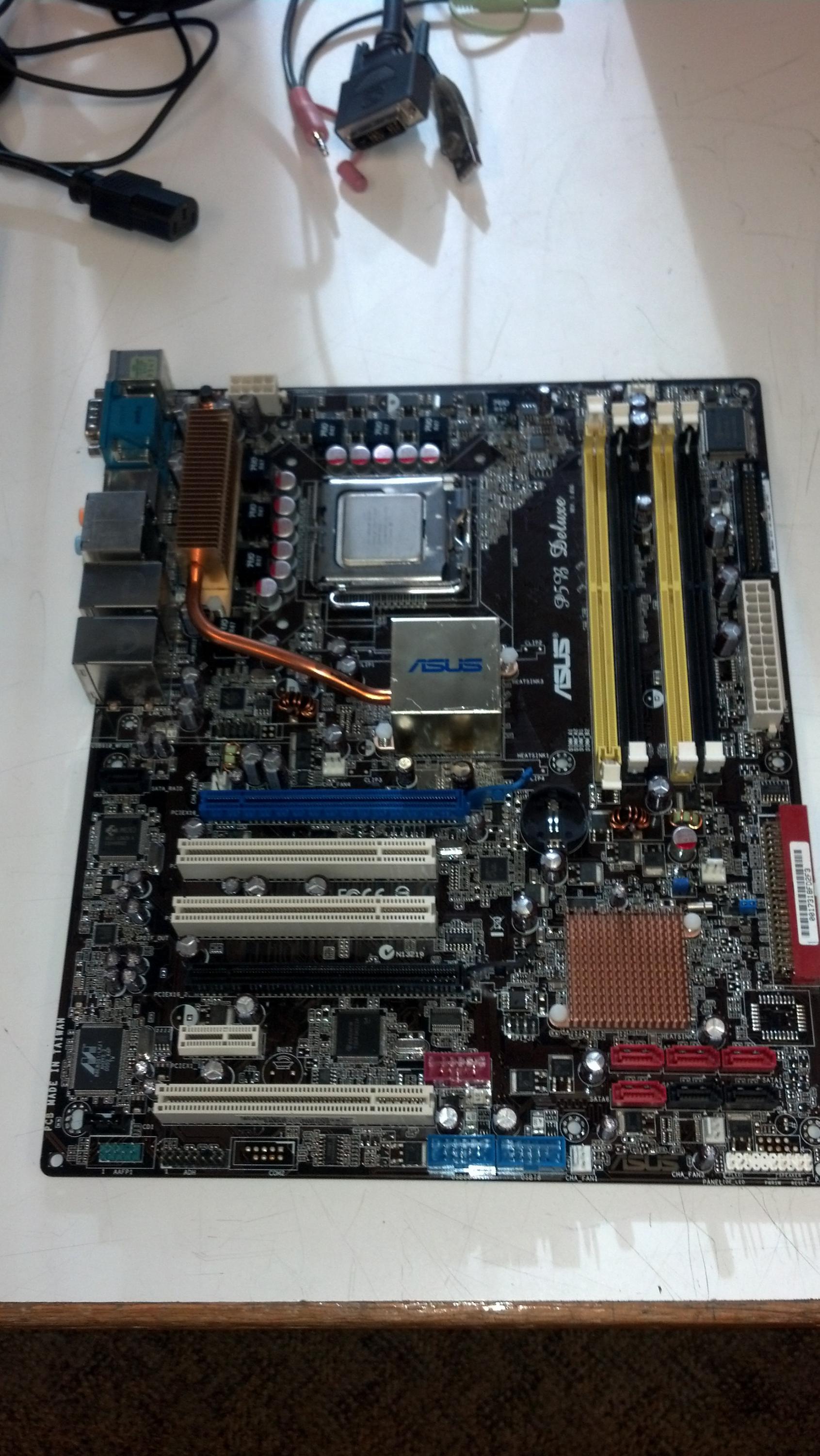

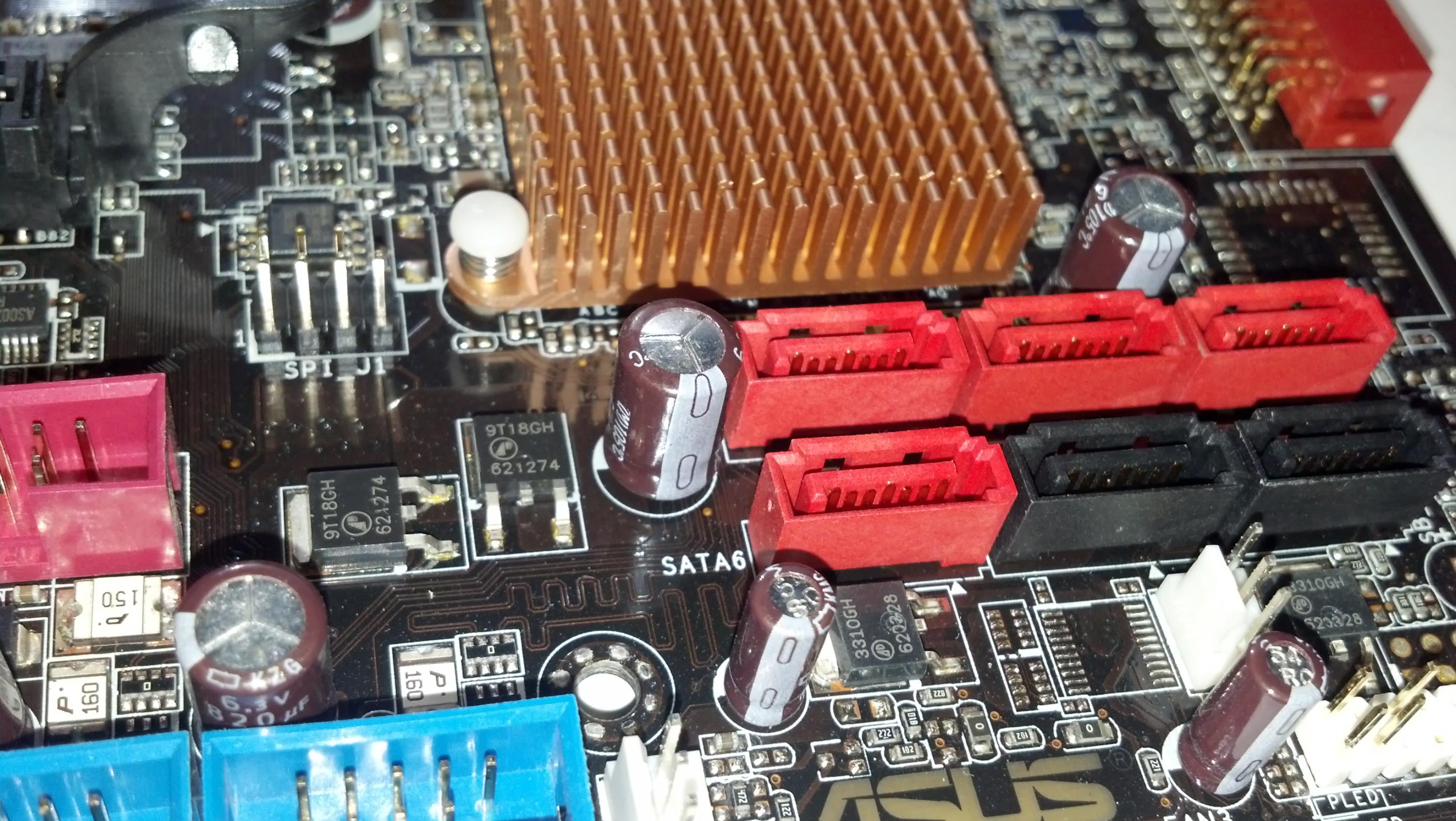

    Nice score at the local recycle place! Picked this up in the "AS IS" bin for $4.95. Usually in that bin boards are chucked around and the CPU sockets usually get damaged. This one looked in good shape with just some vented KZG's, and for $5, why not try?
    I plugged it in as is, and it powered up but gave no POST, no video, and ran all the fans at full speed.
    I replaced just the four bulged KZG and it fired right back up! So I'll be replacing the other twenty eight KZG caps, and I plan on replacing one of my main P5B boards at home so I can get SLI GTX 260. Or is this from the era where only nvidia boards could SLI nvidia cards? Either way, nice board

    This is a crossfire only board, sli will only work with the sli modified nvidia drivers.
    Nice board.

      Yup, and the kicker is, the nvidia chipsets from that era all had the substrate defect.

        That's what I was afraid of. But thanks for confirming! I know the local shop has some used 5770's for $29, might pick up a couple of those. I never bought the second GTX 260 so I'm guessing two 5770's would perform better than a single 260.
        I love the heatsink on the VRM! And I'm still baffled by KZG sometimes. Those on the VRM look fine but not the ones down by the south bridge chip. Maybe they had a really hot running GPU installed in it that cooked them.

          Please don't forget that Asus places their caps in oppositeland. Check the polarity and markings before you fire it back up. Good find!
