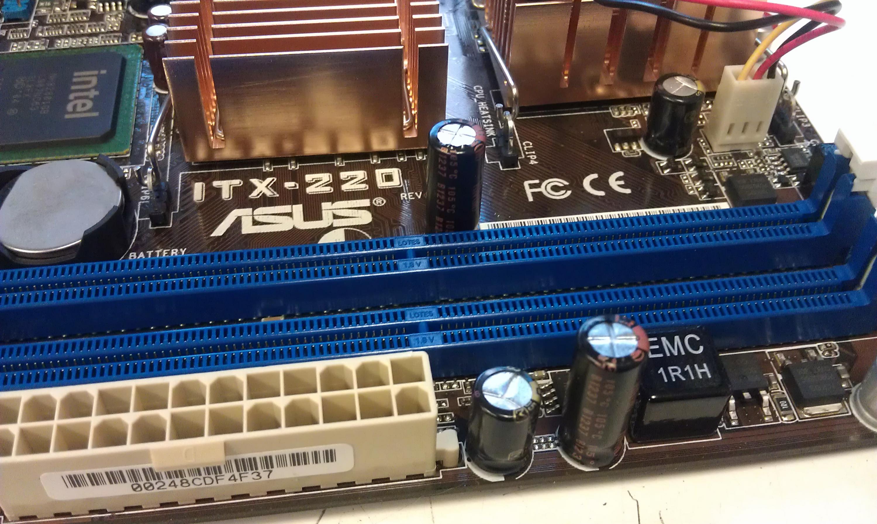

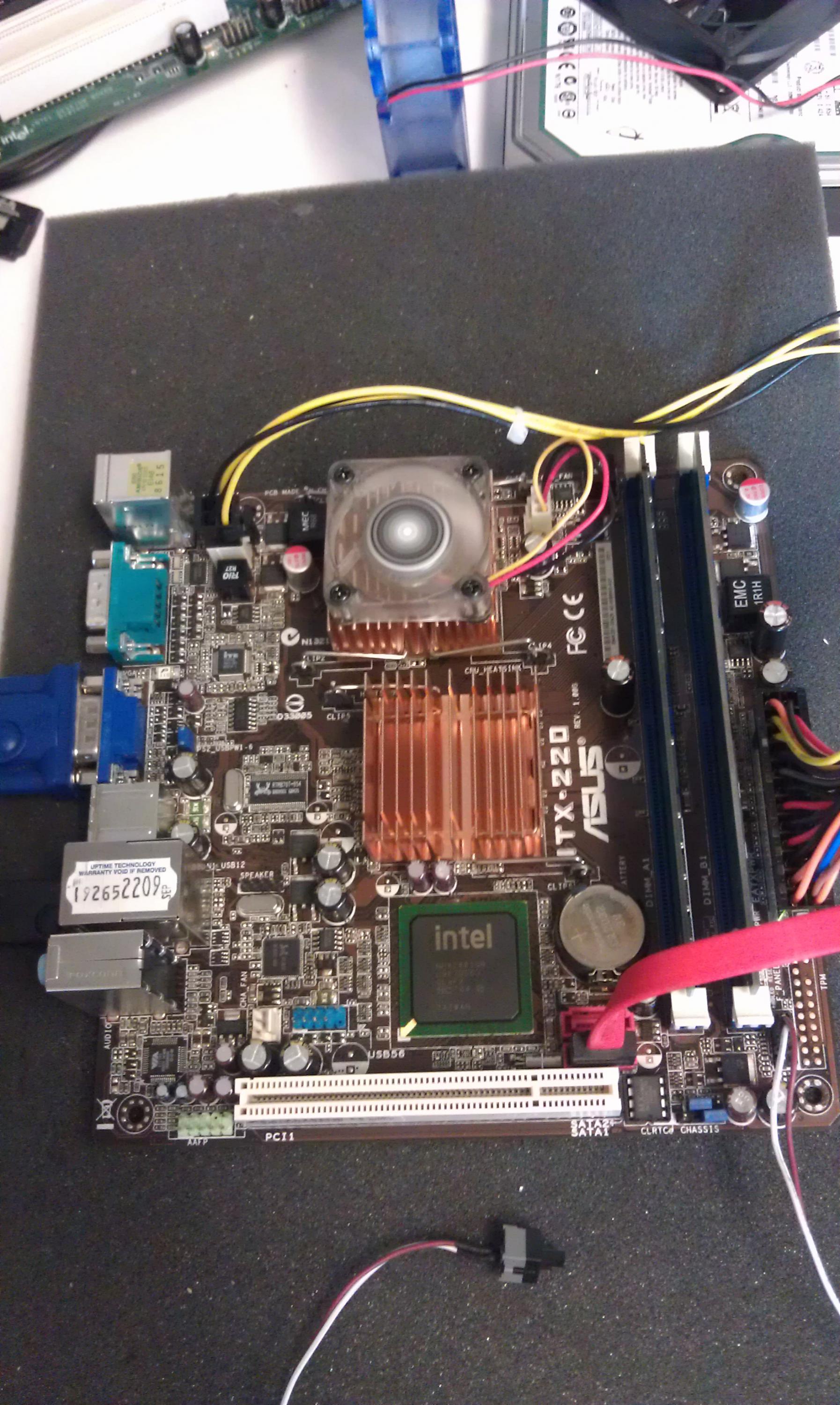

    Asus ITX-220
    This thing had no video when I got it. Turns out the fan (Y.S. Tech) was seized, and both 1500uF 6.3V KZG caps were out of spec but not bulging. Relubed the fan, which brought it back to life, and replaced the KZG's with 1800uF 6.3V nichicon HN, and it's alive again
    The reason the fan failed I'm guessing, is because it ran 24/7 for 3 years @ 5,500RPM, and the bearing was bone dry. The Allied SFX PSU powering it also had a YC cap go bad on the 5VSB + the 5V rail. So I'm going to recap that too and use this as an OpenBSD ISF for my home network

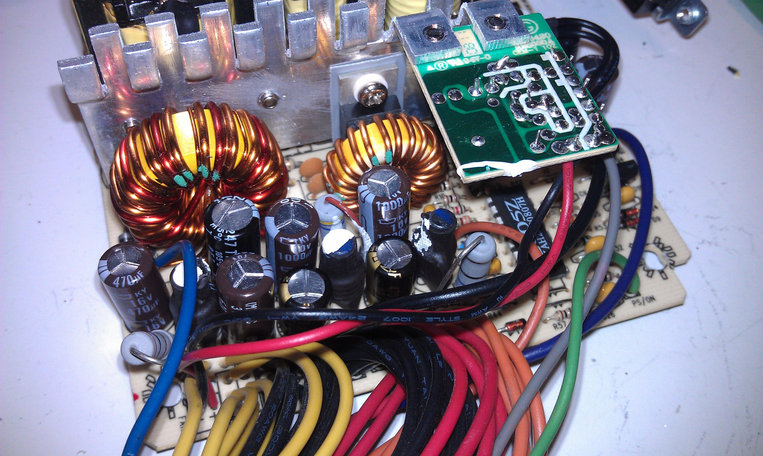

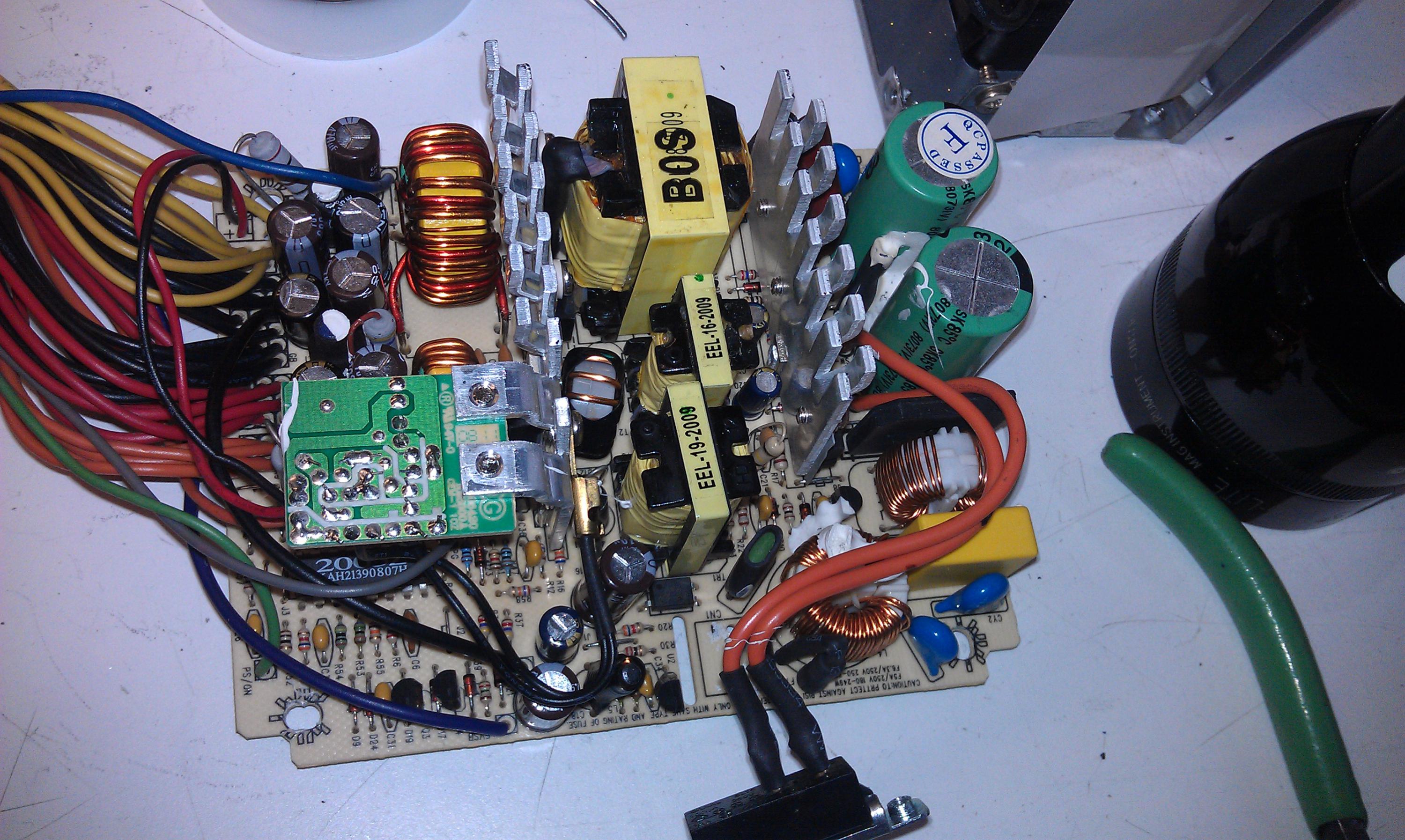

    Allied AL-8250SFX
    Not a bad PSU, and actually honestly rated! Almost all the YC caps were out of spec, but only the two were bulging. These things do run hot though. Slow fan + small form factor + half bridge = plenty of heat The Globe Fan needed oil badly, and spins great now.
    Rectifiers: 12V @ 20A, 5V @ 16A, 3.3V @ 16A

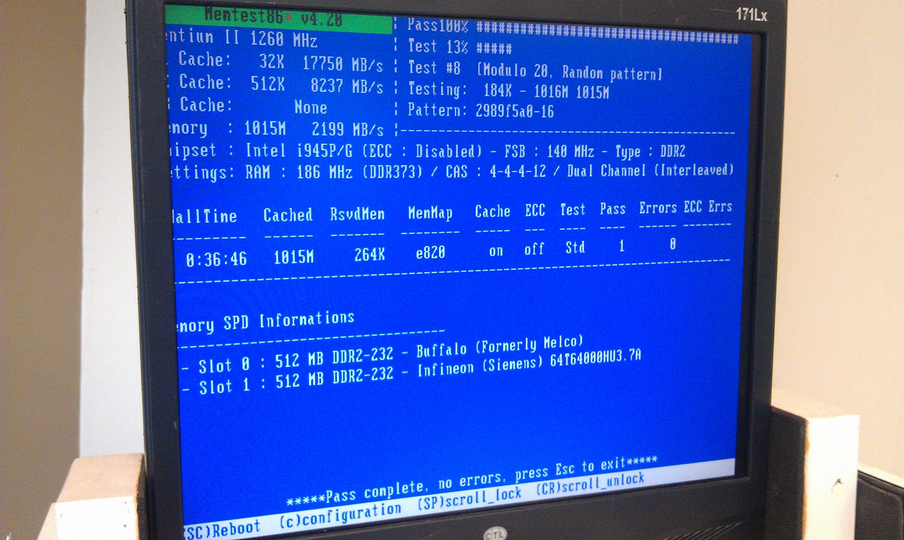

          Re: Asus ITX-220
          Yeah. I probably should have. Nice job repairing it
          Lol at memtest: Pentium II at 1.26GHz
          EDIT: Only 3 yr lifespan? Even for 24/7, that's not great. Typical ASUS junk I guess.

              Re: Asus ITX-220
              That toy fan should perhaps be on the northbridge, in this board the NB has a TDP 3.3W higher than the CPU .
              If case internal volume allows, I'd ghetto-mod a 120mm fan blowing on everything for good, something this style:
              Less noise and a gazillion times better overall cooling.

                Re: Asus ITX-220
                I noticed that too
                Yeah, the board is decent, but with that low quality fan it was doomed to fail. I've seen Y.S. Tech fans in In Win cases and they're fine with oil in them.
                That's awesome! I wish but I'm using a mini ITX case, that's why I recapped the Allied SFX PSU

                  Re: Asus ITX-220
                  Anyway I'd try to improve cooling with something more resolutive. Size matters.
