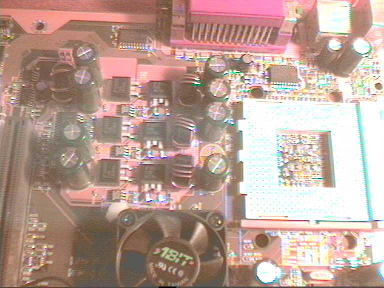

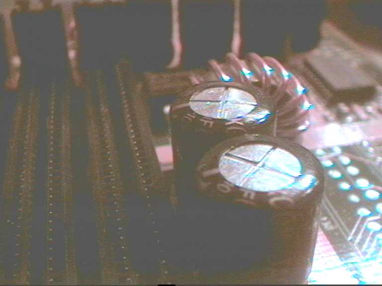

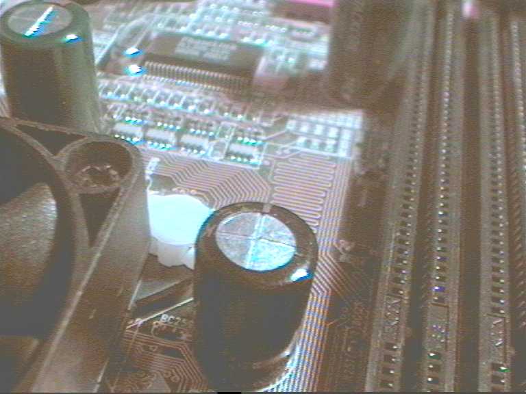

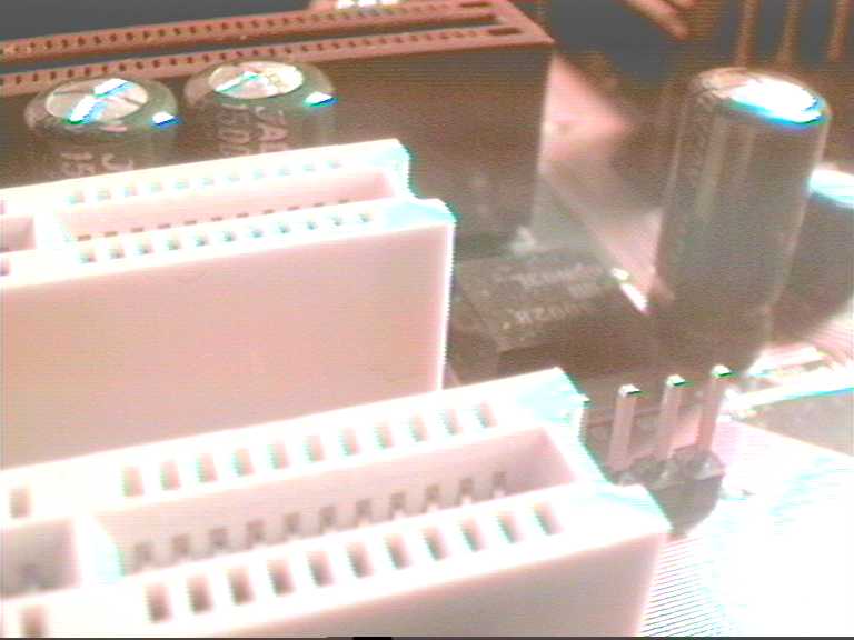

                      Bought really cheap non-working KT7 (non-RAID) - of course because of bad caps. Everything is Jackcon except the small 1000uF/10V Teapos. The bad ones are 1500uF/6.3V Jackcons - both the green and black ones.
                      Bad caps near AGP:
                      And also other bad caps - they're bulged only very slightly but they are:
                      (the one on the front is not bulged, the one on the back is).
                      The big and the smallest ones are OK:
